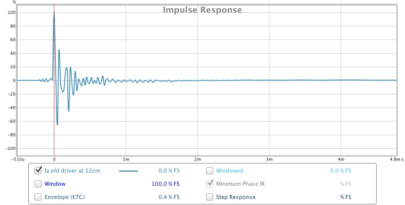

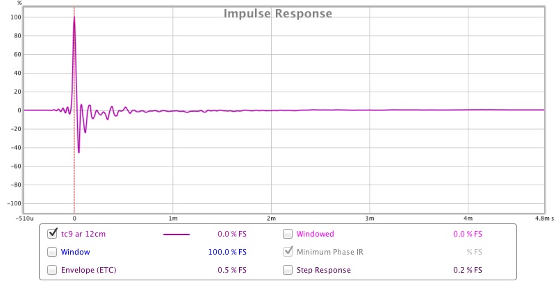

So, got the mic setup and ran sweeps with almost everything I had in the 3" category.
The TC9 looks just about right, I think, if I look at graphs online.
Do you think it's close enough?

I applaud your enthusiasm! The graphs look pretty good at first sight. Just a little question though. Did it come with any kind of calibration? A calibrated mic. would definitely have my preference. Part of the knowing what you have philosophy.
Another question that entered my mind, which IR looked cleanest of all the 3" tests you ran? This is not necessarily a serious question, but I am curious. How did the Aura wannabee do?

Unfortunately, no calibration. The reason I made the deal to return it if it was a little too wild. I guess it's close to the behringer ECM8000, if not the same mic.
You were right. Nothing else I have was as clean as the TC9.

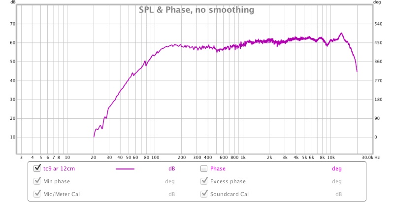

Congratulation looks you got nice measurements now.

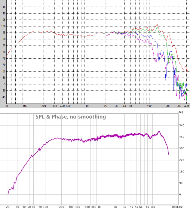

Behringer ECM8000 seems has higher output impedance but as seen below looks like ECM999 is same as EMM-6 but without a calibration file, here in EU EMM-6 is at €50 and ECM999 is at €39.
Also below a TC9 measurement with EMM-6 and supported calibration file verse your ECM999.

The measurement looks good for the TC9. As I said before, you can use the manufacturers quoted spec for the SPL fo the TC9 and a DMM to set the absolute calibration of your mic. Set REW to generator mode to make sine wave at 1khz and adjust amplitude until 2.83v (AC volts) at driver. Put mic 1.0 meter away and then use the "SPL meter" function in REW, there is a "calibrate" button. Click that and then type in 84.6dB (from spec sheet for 2.83v).
Btw, I just noticed that the TC9 has a new April 2015 spec sheet out now. I wonder if anything has changed?
http://www.parts-express.com/pedocs/specs/264-1062--tymphany-tc9fd18-08-spec-sheet.pdf
Then to make sure the number makes sense, adjust the volume until music sounds loud enough to be a dance club level where its hard to hear yourself talk. that is about 89dB.
Your mic won't be calibrated for SPL variation along frequency, but based on your measurement, it looks pretty good (flat). Good enough to design speakers with within +/-1.5dB I would guess.

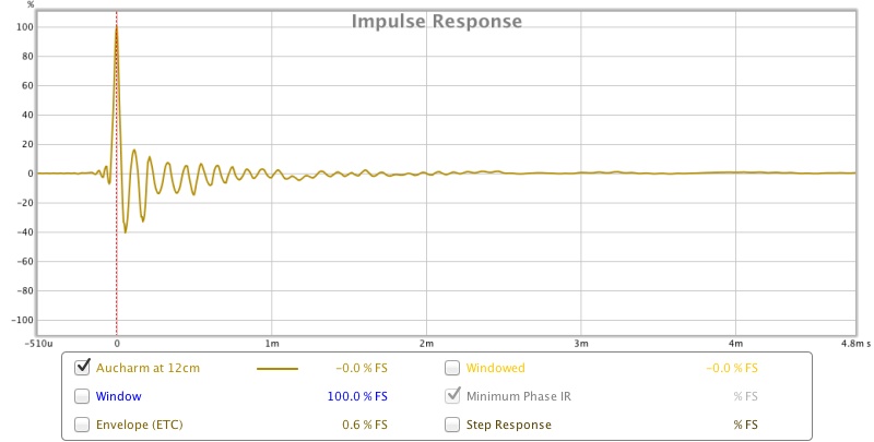

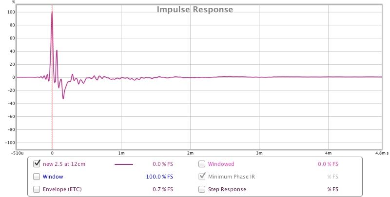

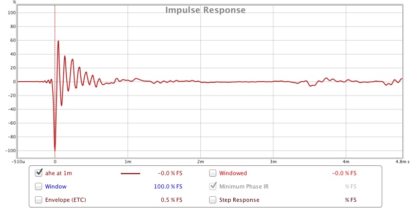

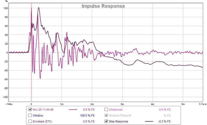

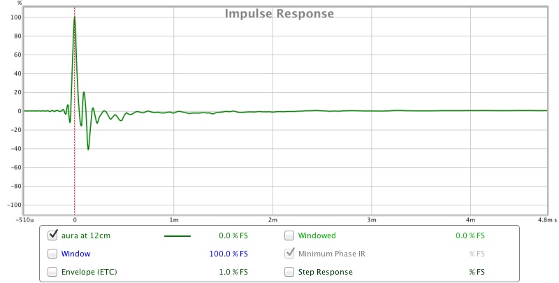

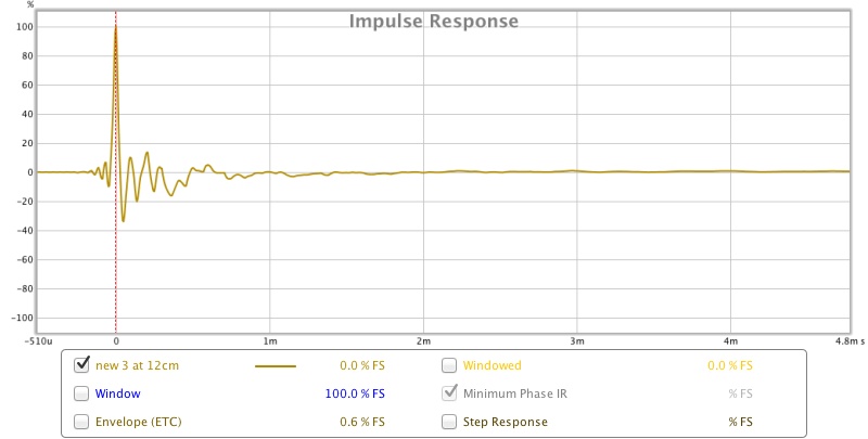

Here's a bunch of impulses from the drivers I have lying around.
They are from the TC9, a new 3", a new 2.5", the Aura, the awful Aucharm, the AHE and the little 3" I used in my old Line Arrays.
PS. Sorry, the AHE has an inverted impulse as I forgot my little 3116 amp has inverted +/- outputs!

Thanks IR plots, the last three look advanced having kind of room reflection build in to output waveform : )
New mic did made big difference, looks like at TC9 FR plot start/end frq sweep is set to 20-20kHz if possible will like to see it from DC to 22,05 or 24kHz, also is soundcard I/O response calibrated inside REW before taking those measurements because if not ringing scheme should improve when compensated pointing to a calibration file actual sample rate mode.
Ok, I'll go up to 24kHz next time.

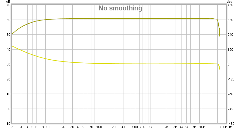

One is guided with help and explanation at bottom in window, just go to "Preferences" then "Soundcard" tab, then "Calibrate" and guide starts at bottom in window. Do it for every sample rate and save file with a logic name example "Presonus_WDM_48kHz" so its easy to be recalled or imported to another computer if it's a remove able sound card. Before taking a measurement check current active calibration file is the one belonging to actual soundcard hardware and actual sample rate.
Nice measurements Perceval - the mic looks like a winner. I think the sound card calibration is as simple as connecting a loopback and clicking "calibrate" sound card under settings. What did your mic cost in USD? If you get a chance, order the UMIK-1 and a miniDSP - you will find a billion uses for the miniDSP - it is a game changer and let me get into 2-ways, 3-ways, and FAST without knowing how to build a passive XO.

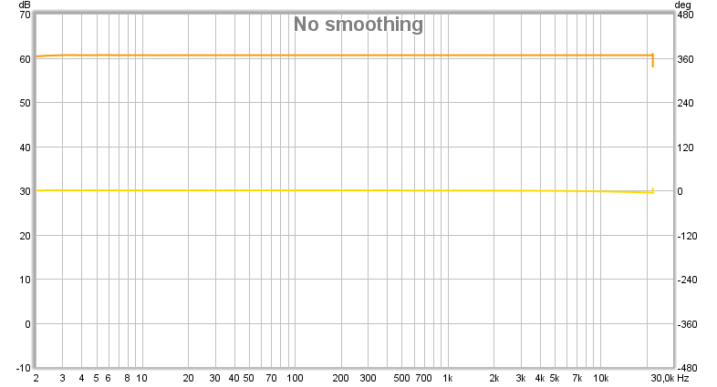

Example UCA222 loopback WDM 16bit/44,1kHz.
Picture 1 soundcard I/O wire loopback with no calibration showing soundcard real response.
Picture 2 soundcard I/O wire loopback with calibration file loaded which corrects for system non linearity so system now truly a reference measurement system and ready to put in a DUT. (In both plots "Estimate IR Delay" button had been pushed to correct phase)
