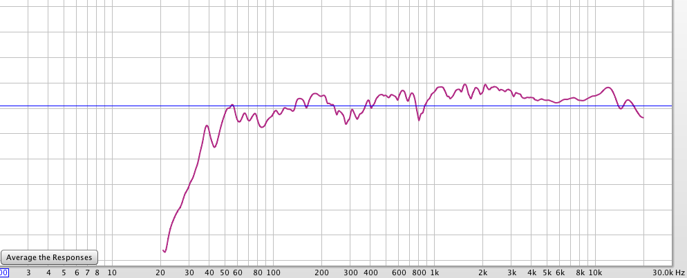

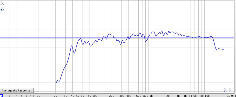

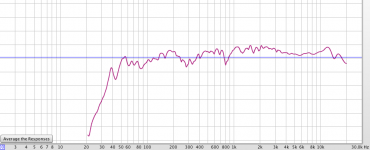

Ok,
forget the other posts, this driver was just in the wrong enclosure for it.
I placed it into my TABAQ and measured. It's not bad, has a nice lower extension in the TABAQ, but there is still that abrupt fall at 12KHz. (first graph)
I tried a bunch of EQ combinations trying to bring the upper end to at least 15k (the limit of my hearing), and the best I could get is this second graph, using a 15db (!) boost at 15k with a Q=6 (!!)
Looks like this would be a good candidate for a tweeter helper from 12K and up.

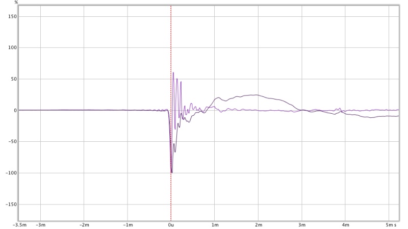

The thing that worried me about your measurement was the ringing in the impulse. One driver could sound very pleasing (to a lot of people, look at the subjective rounds) but what would that do x25 or 50 even. It's harder to get rid of such behaviour than to add it later on. Just my opinion. Kind of why I said you need to try at least one TC or TG. It may even sound boring compared to your current find. Knowing what and why you hear it is very important to me. If you know what it is, you can use it to your advantage.

wesayso, I couldn't find if you posted an original freq response and impulse from a single TC9 driver. Was it anything close to what X posted? like this:
If so, then indeed, there is some ringing with the impulse of the Aura. Funny I couldn't really hear it, and it seemed pretty sharp to my ears... but I didn't really have a listening session with it yet, having done a single driver only. I need to add the second one and sit down to have a real listening session. I only did sweeps with it today.
It's correct that I haven't posted a single one. It is like the one posted by X, and pretty much every one else who measured it.
I doubt you could easily tell on your driver without comparing it to another (cleaner) driver directly. As said, it can even sound pleasing to some. But if you have 25 firing at once, but not exactly hitting the listening spot at the same time it might well be a bit too much. But you'd need to be sure it is the driver, look at BYRTT's posts about this, electrical components can add their own signature to an impulse. I've seen that when I was using my DAC trough USB. The impulse was much cleaner when connected with optical.
I first blamed other things as I didn't expect to find that kind of difference. Like I said, knowing what you have is important to get what you want 😉.

As wesayso writes ones electric gear can have some of the ringing flaws build in especial DAC/ADC can be guilty for this and if this is case we can't compare perceval Aura IR verse xrk971's TC9 IR, but it can be discovered by hardwire looping back ones measurement gear chain by a REW sweep to see if electric gear colour anything.
Looking measurements the two drivers the two nasty rings that make Aura look bad compared TC9 after we with eye have polarity inversed, think ther's a possibility its just because the 12kHz cut off slope is so steep and probably steeper than normal BW2 roll off, therefor think there possibility two rings would be repaired and go away if a tweeter is blended with perfect set IRR filters plus acoustic blending.
