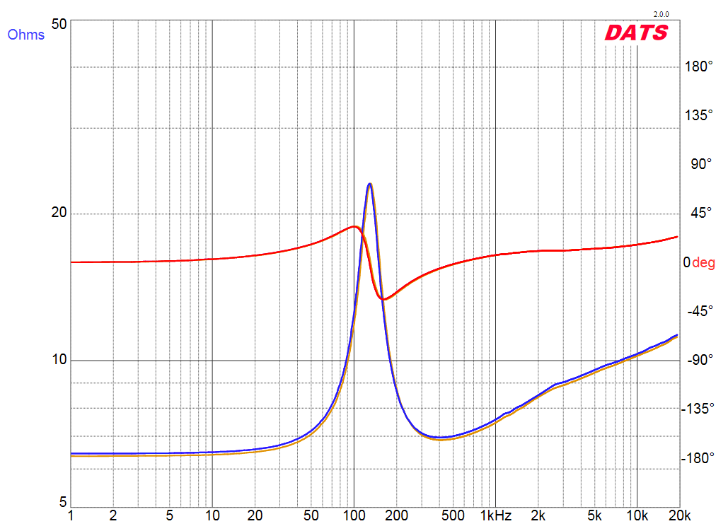

Todays afternoon got made some progress regarding the drivers in that got all eight analyzed their TS-parameters and impedance curves with DATS device so could match them best possible as 4 pairs. The pair prepared for Taiwan is on weight below and also impedance curves and TS data is attached, their history is they from a 4xTC9FD order europe-audio January 2015 and brand new only breaking in is DATS sweeps. Weight drivers is 0,646kg and will try make package 12x24x10cm <1,0kg because at www.pakke.dk they offer that data shipped to Taiwan within 2-4 business days at around 35€. Its expensive compared their cost was 17€ a piece inclusive shipping, but compared the US $79,15 it did cost shipping a pair DCR's from xrk971 to Denmark back in april seen picture 4, think 35€ sounds as is at least cost expected. In short time will PM you and tomorrow get back with data regarding ringing and HF extension for Aura driver.
.....You are truly dedicated!...

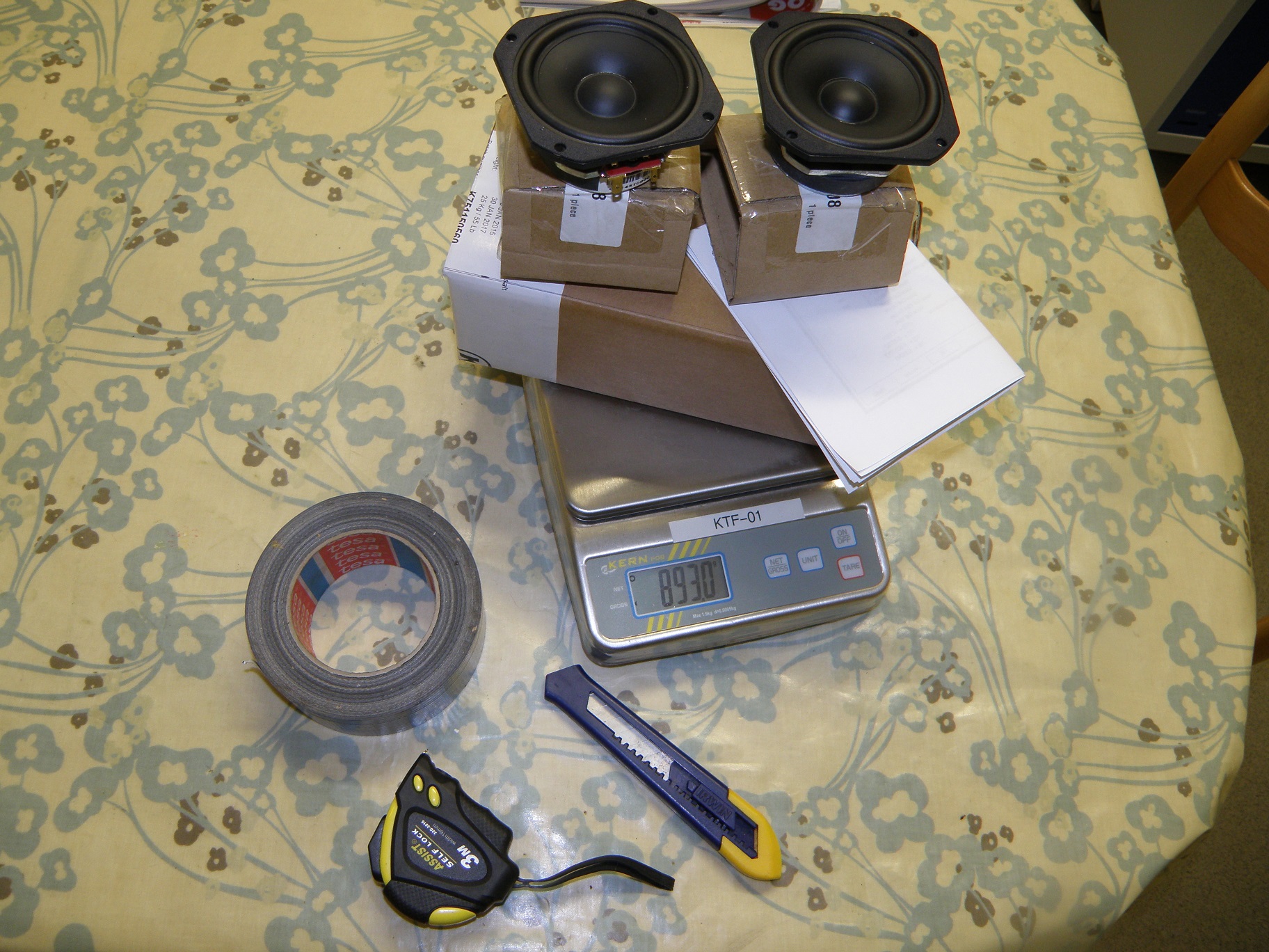

Because there is eight TC9's and have that DATS device can't stop try make the best pairs from pool : )

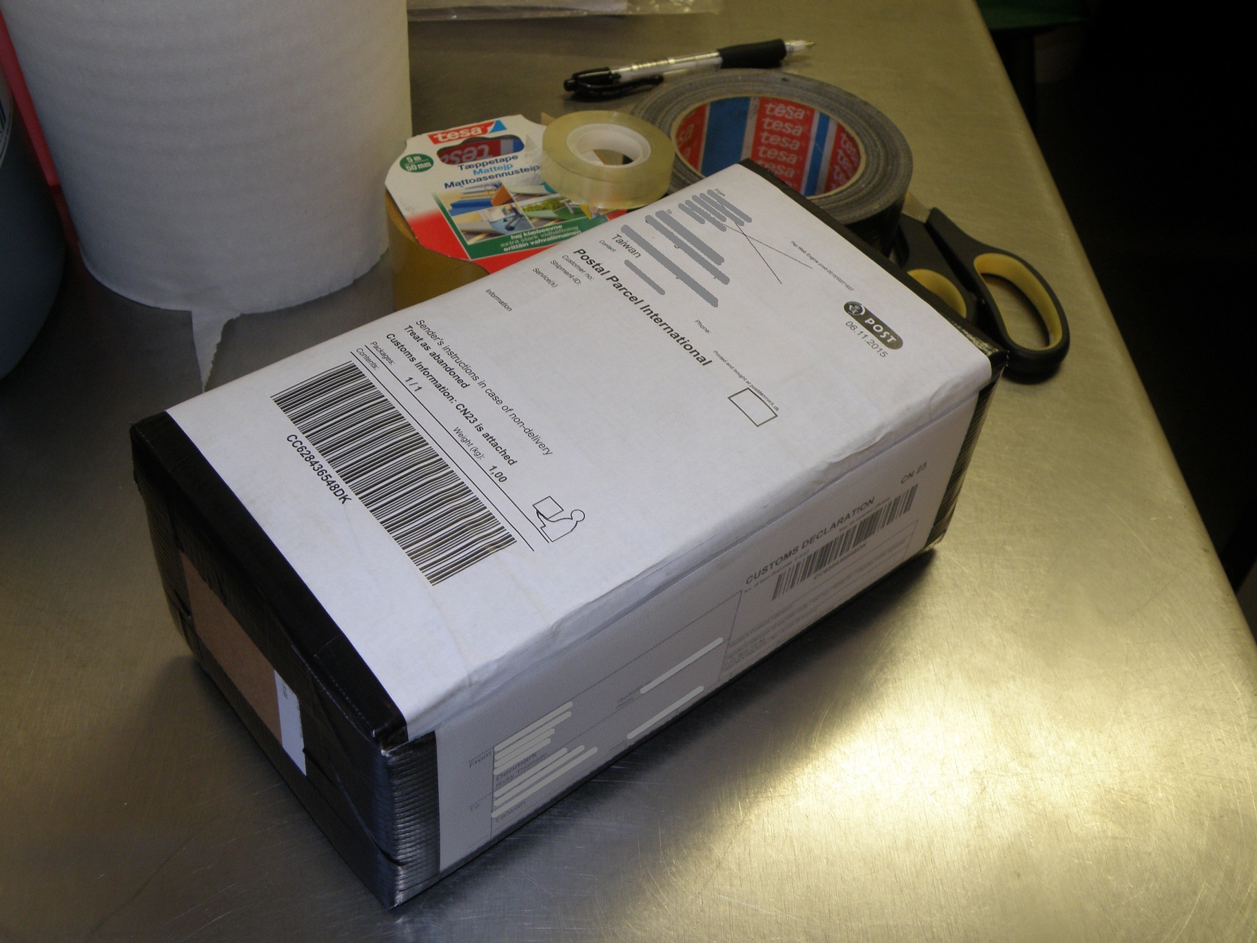

Closer to shipping now have made a cardboard box that when filled and closed will be near 1kg target.
TC9FD-18-08 pair started trip to Taiwan
Got lazy yesterday having a little hang over but today delivered package at the shop and expect within 24 hours update on servers so tracking number starts working. Shipping company say destination delivery within 4-7 days depending also on the customs declaration expedition.
TC9's have some local foam support inside box and a wrapping with black gaffa tape to reinforce cardboard box, shipping label on top and customs declaration in a plastic window at side, hope bits and pieces arrives safely and flawless : )

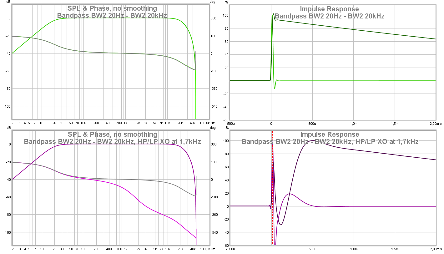

Yes because ringing always is happening at bandpass devices rolloff the steeper the worse and if rolloff slope is corrected to a good known textbook slope as example a LR4 for Aura high frq cutoff and then tweeter low frq cutoff slope is corrected to have same textbook LR4 slope, Aura ringing is repaired and new high frq ringing is transferred up in frq bandwidth where added tweeters high frq cutoff slope is probably >20kHz area, and thats even higher up in bandwidth as the 12kHz where Aura bandwidth did stop so measured system ringing will begin look good. In electric chain we have no ctc spacing and acoustic problems and if we mix electric two bandpass devices as talked about above will mix perfectly and repair the ringing, drawback is sum of 360º phase turn 180º at XO point LR4 filter add to system phase. Such a phase turn normal ruin transient response (step response/square wave reproduction) specs but it could be argued that at 8-10kHz no speaker is native very good here, and if not afraid of FIR filters will take very little CPU processing lag to repair phase distortion from a LR4 at 10kHz.
System setup gets more complicated to setup than if Aura had been 16-20kHz performer but should be possible. Thinking over experience wesayso shared, it must be something ala at design axis at listening position you shall have above mentioned LR4 textbook slopes right acoustic at mic listening point in space, so in electric domain do whatever it takes with weird electric XO and PEQ to get textbook LR4 acoustic slopes at listening position. Hint it is a pretty good helper to have the actual textbook LR4 XO slope as a visual target trace overlayed in REW when tuning in electric domain to hit that target trace, for this free Rephase is very convenient in it takes 30 seconds to create a IRR LR4 slope IR-wav file and then import it to REW before starting measurements.

Picture 1 show ringing a IRR bandpass device where all have low end stopband set as high pass BW2 at 180Hz but stopband in high end is a low pass BW1/BW2/BW3/BW4/BW6/BW8 set at 12kHz. Look the more and more ringing the steeper the cut off, and if compare to Aura measurement looks it is very steep cut off at high frq.
Picture 2 show ringing a IRR bandpass device where all have low end stopband set as high pass BW2 at 180Hz and stopband in high end is a low pass BW2 at 20kHz. So bandpass filters is same, the difference here is if DSP runs inside a 44,1kHz, 48kHz or 96kHz chain. Sampling rates fs/2 affect system bandwidth and 20kHz slope will ring more at lower bandwidth DSP chain. Also the lower the bandwidth predicted minimum phase do not track phase 100% anymore and little excess phase is present in HF area.

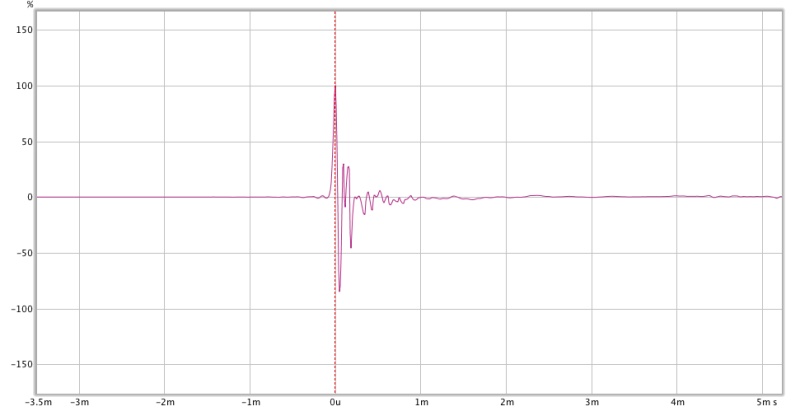

Picture 3 is to show force line array having no XO, both systems having system bandpass BW2 20 - BW2 20kHz, first have no XO and second one a 1,7kHz LR4 XO. While FR and predicted minimum phase is same, excess phase 360º turn around 1,7kHz point distort IR/SR. With FIR filter and CPU processing time lag XO version could have phase turn repaired.

Yes sorry it got long and maybe not well written and understandable. In short its idea show that Aura measurement can be influenced from and/or the steep roll off filters in picture 1 and sample rate (bandwidth problems) picture 2 plus other factors mentioned in text, calibration files, mic bandwidth etc. That will be revealed your side by side measurements, also if it happen your measurement TC9FD's don't look ala X's plots reasons can be those from that post.
Long post is also meant to help us understand if we believe in good objective system data that will help output is same as input in audio band. Nice smooth frq response combined soft as possible stopband roll offs improve phase timing distortion and thereby transients/square waves starts look same at output as for input. Bandpass roll off at low end as long we inside a room think can be some corrected to be nice by create a roll off slope that is a matched to suit particular room gain profile. Bandpass roll off slope at high end 15kHz and up if we want correct there needs bandwidth and if done digital DAC's need at least 88,2/96kHz resolution. Some of the bad looking filters and XO is in a way no problem if system wise upstream or downstream they combined some correction be it IRR or FIR.

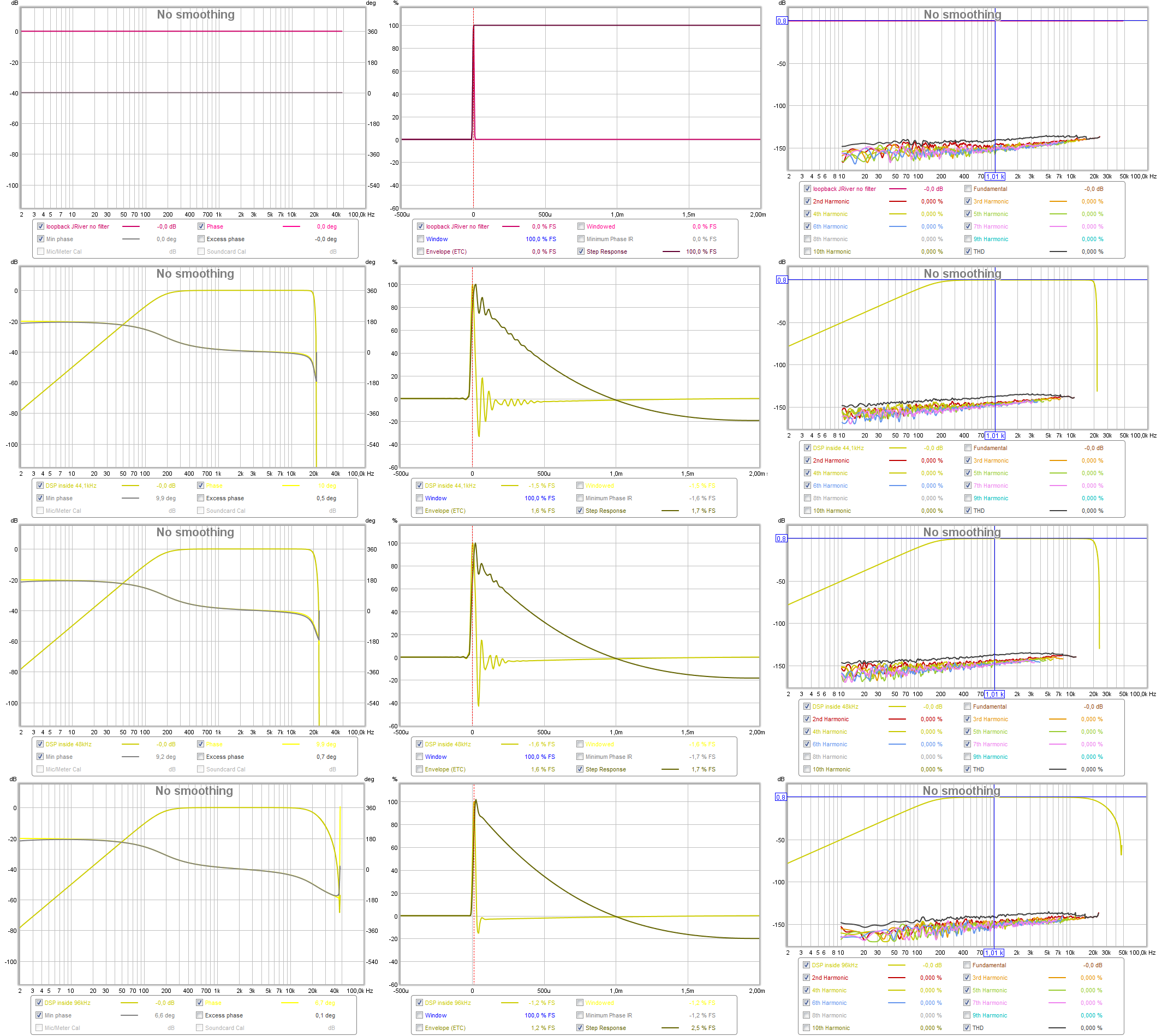

TC9 is cleaner, but not as clean as other measurements I've seen of it.
It might be worthwhile to check your electrical path, including the DAC in a loopback measurement.
While this won't sound bad, it's not what you want when thinking about an array of either of these. How do they compare to you?
Also consider the box, is there damping inside?

If the hardware device or cascade of devices that is responsible that ringing scheme sits in your audio chain system when enjoying music playing tracks, then there should be audio able improvement and precision in the horizon when eliminated. But it could also just be a device or route you only use under measurements causing the problem such as microphone lack of bandwidth and/or abrupt HF slope cutoff, or lack of active calibration for system and michrophone inside REW settings. If REW haven't a calibration file for active sound card sample rate profile and also calibration file for microphone it expects unlimited bandwith and the devices real HF cutoff filters ringing wont be extracted in the sweep.
Suggest over time bench al devices in audio system, its is good to have confirmed if devices have good audio band specs as written in manual or perform bad in some area. Boxes with line level is easy to test in loop at sound card I/O but be care full with power amps having a resistor network at output and start at very low volume level and then up it until REW spl meter show expected dynamic. Also regarding power amps watch out for the ones that is bridged use only their cold and hot speaker connectors wired to resistor network and chassis on power amp even it has ground symbol somewhere must never get in touch with soundcard ground in this temporary test setup. REW is best test suite to look at flaws in IR/SR but when at it one can make a Rightmark Audio Analyzer sweep which can output a nice html report including dynamic range and others, but it won't see the IR flaws even it report a nice FR.
There's a chance culprit is just soundcard related as a example have a XONAR U7 and a UMC204HD they both Rings and Bings as crazy and distort wave shape at all sample rates except 176,4/192kHz where they go HQ. Problem is probably manufacture at this product price point only optimized their combined digital and analog output filters to be textbook at highest sample rate and for rest of sample rates choose cheap way setting digital filters to be steep which gives little less bandwidth plus ringing and distorted waveform output. Have a cheap UCA222 and old AP192 they both perform textbook output filter at al supported sample rates.
Checking soundcard in a loop suggest use ASIO under REW if possible and look just at IR/SR plus HD plots if there is any un-linear flaws under repeated sweeps, if this is case then tweak buffer settings in sound card device ASIO control panel until perfect plots under repeated sweeps. If ASIO then end works good suggest use always those buffer settings for that particular computer and then shift to ASIO too inside JRiver.
