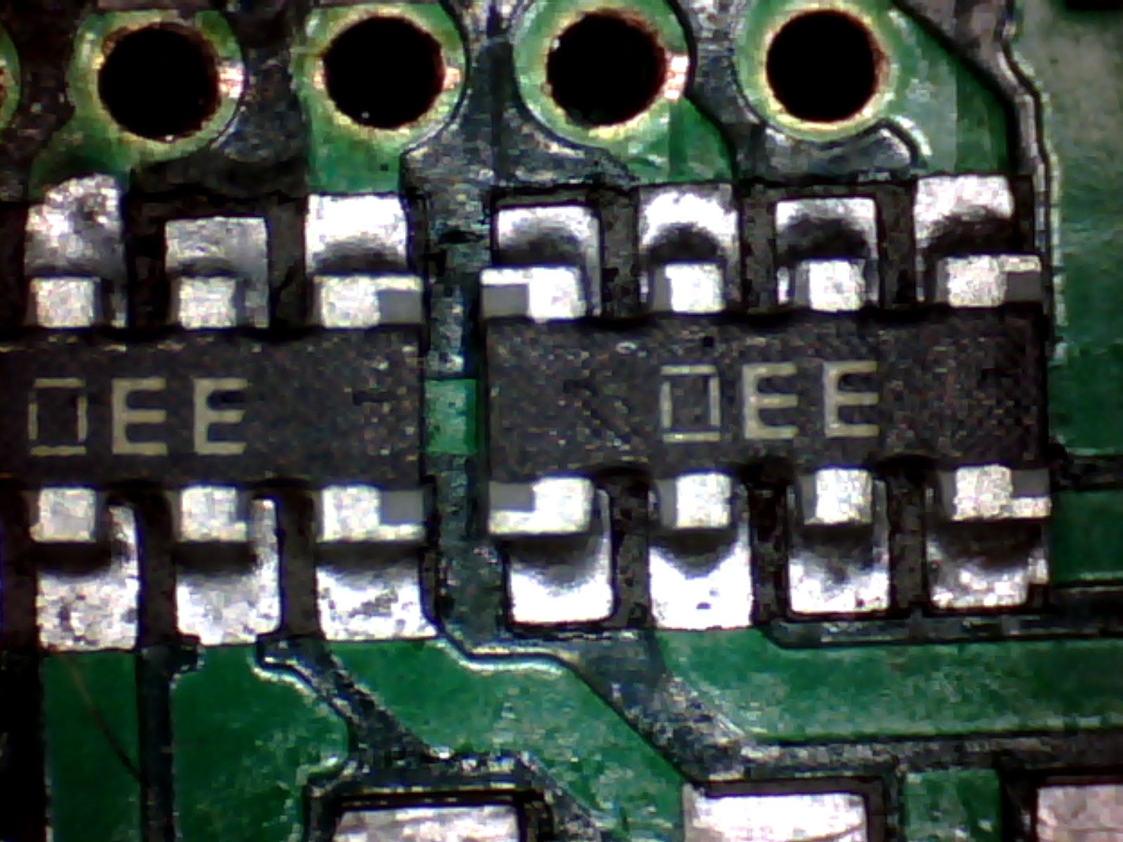

I'd like to share the way I solder the resistor array, may not the best way, but it works.
1. Heat the pads by hot air to roughly 80C, plate very thin solder to each pad by iron with needle head, I use 0.4mm solder wire.
2. File the pads having thick solder by a small fine file or sand paper and making them flat, clean left metal powder completely by PCB wash cleaner or alcohol.
3. Place flux (clean free prefer) on both the pads and the resistor array.
4. Heat the pads by hot air from SMT solder station till the solder on the pads get melt, meanwhile, pick up the resistor array on the long side with a tweezers, place the resistor array accurately over the footprint with solder melting. Remove hot air but don't move the tweezers to keep the resistor array at the position till the solder curdle. (have to wear glove on the hand holding tweezers, avoid un-stable hand under hot air)
5. Place a bit flux on the pins of the resistor array which is already on the pads, heat it by hot air from the SMT station again and making the solder melt on each pads, the tension of the melt solder from each pad will draw the resistor array into the center balanced position. Use the pin of the tweezers touch a little bit if not exactly at the center, remove hot air
6. Clean PCB again and make sure no any short or disconnect on each pin by a multi-meter.
7. Cross your fingers🙂.

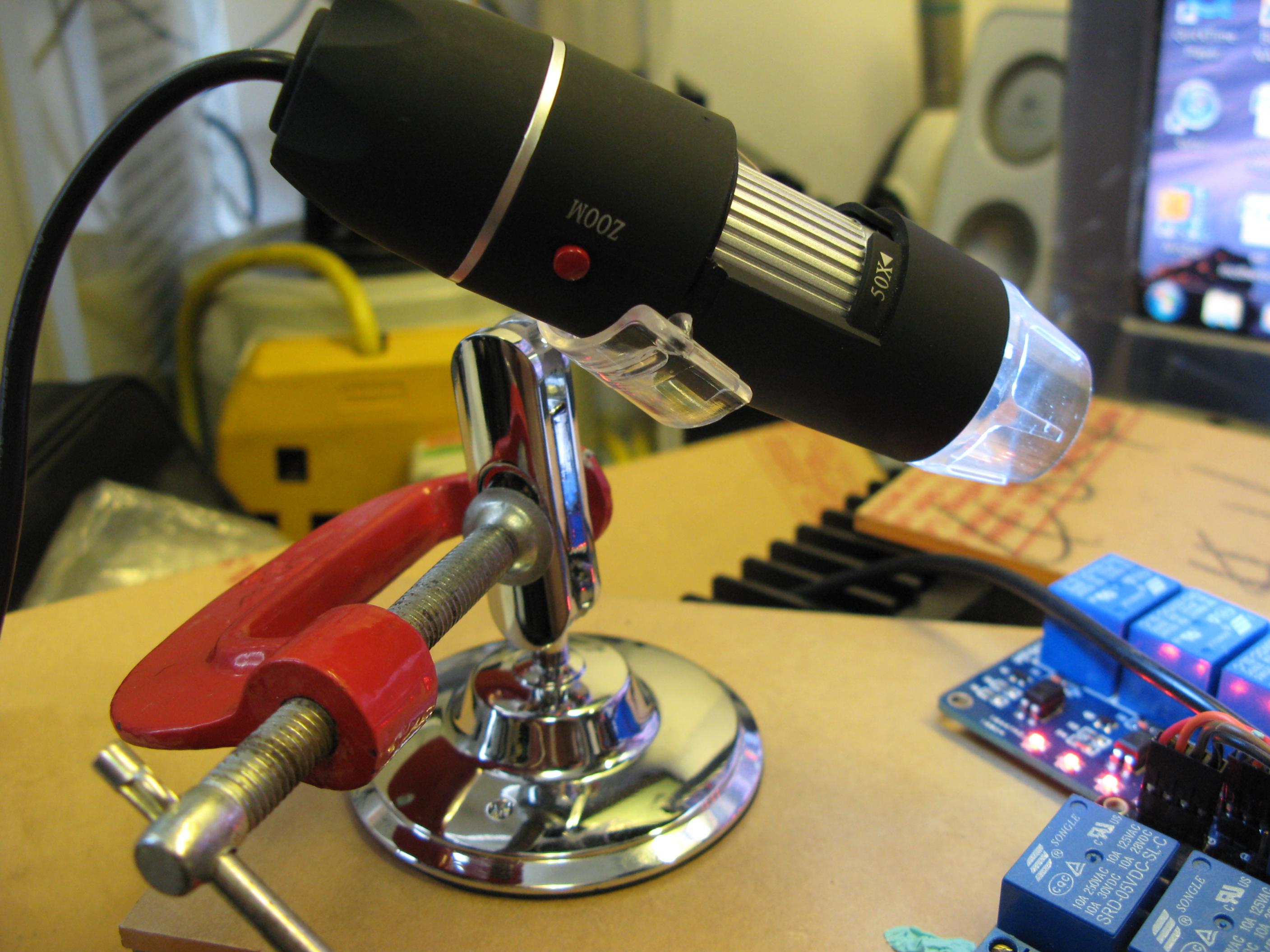

Followed Ian's procedures and with the help of microscope, I finally soldered the resistor arrays without any short. The isolator board is working now and sound GREAT.
With the board, I can clearly hear a much better bass. Will report again after run-in.

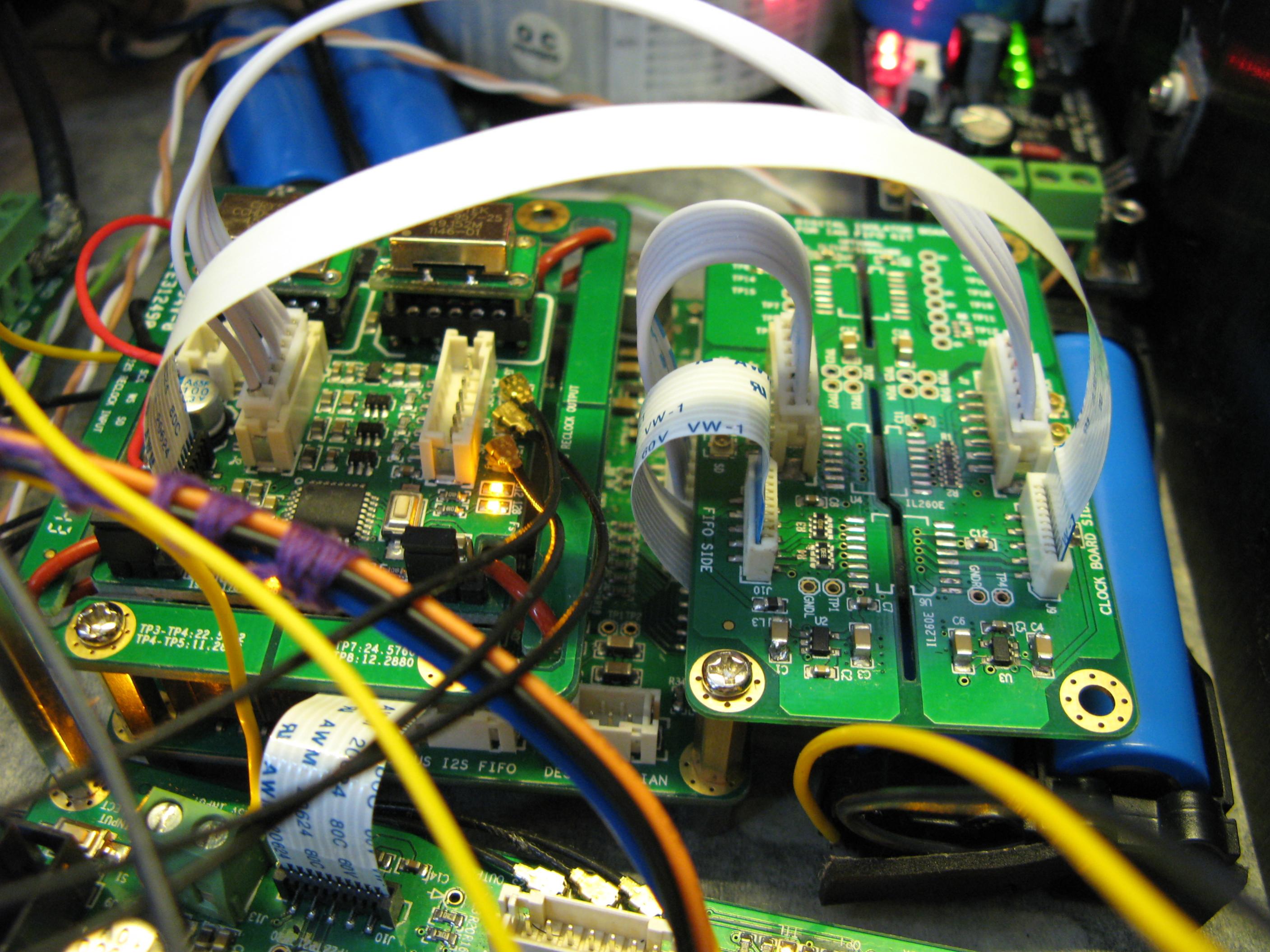

I like the isolator board, it makes the grounding design much easier for a DAC to get rid of ground loop. The clock should always be treated as an analog part for a DAC. The isolator board makes them together.

Yes, the board is a great design, I will use the additional isolator for I2C and see if there is any further improvement.
