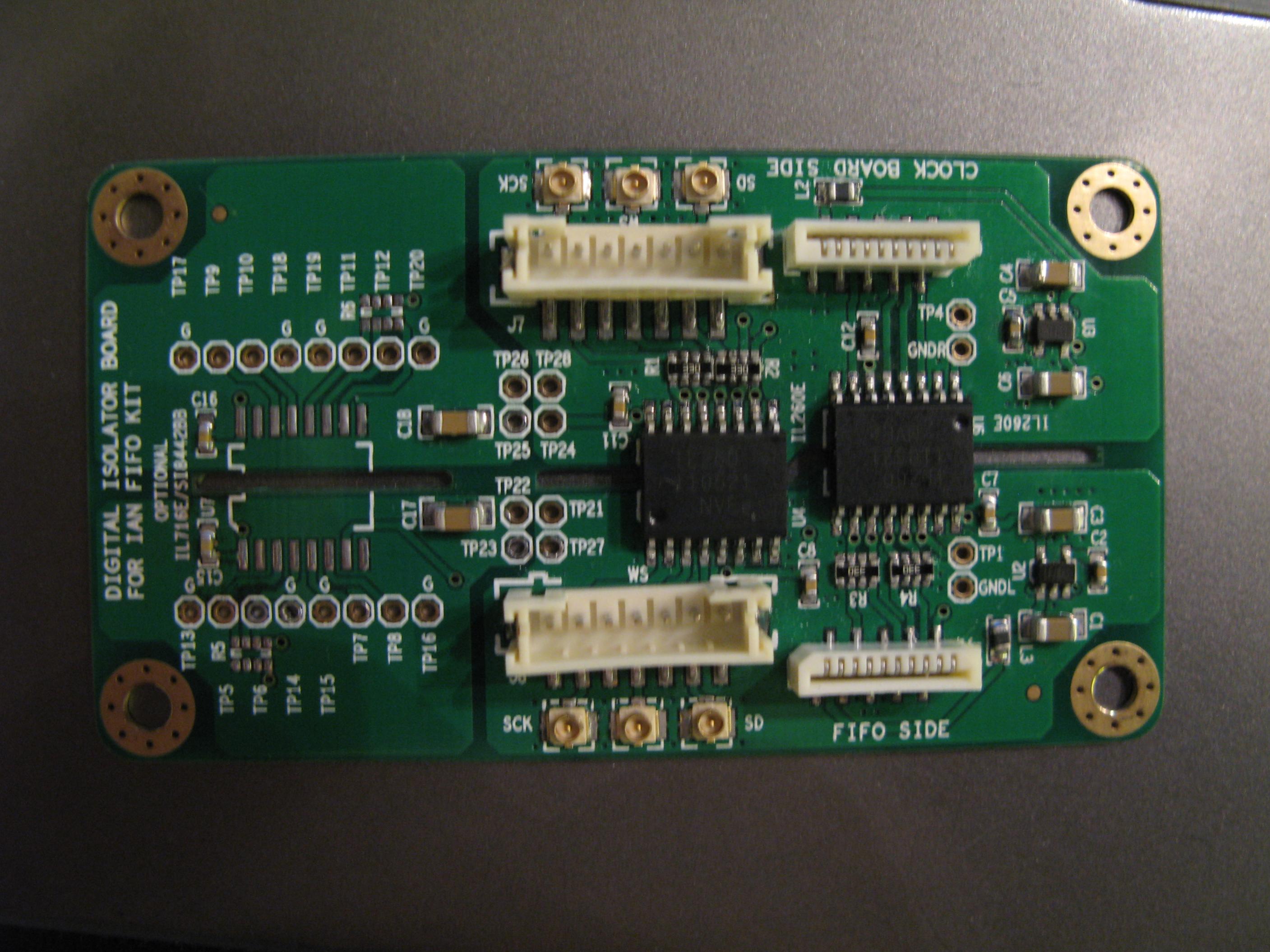

Here is the picture.
Looks good from picture. You need confirm no any short by a multimeter.
Make sure FFC cable on it's correct contact side, the two 10P sockets you bought from Digikey are single side contact. I use double side on dual clock board to avoid this kind of issue.
Another thing I'd remind again is, powering the clock board prior to the FIFO, if you don't have the battery management.
Good luck.
Ian
did you by chance have both the spdif and clock boards connected to the same arduino? half asleep now, off to bed, that would probably just circumvent the isolation, rather than anything dangerous... boards look OK from a glance
obviously something wasnt right though....

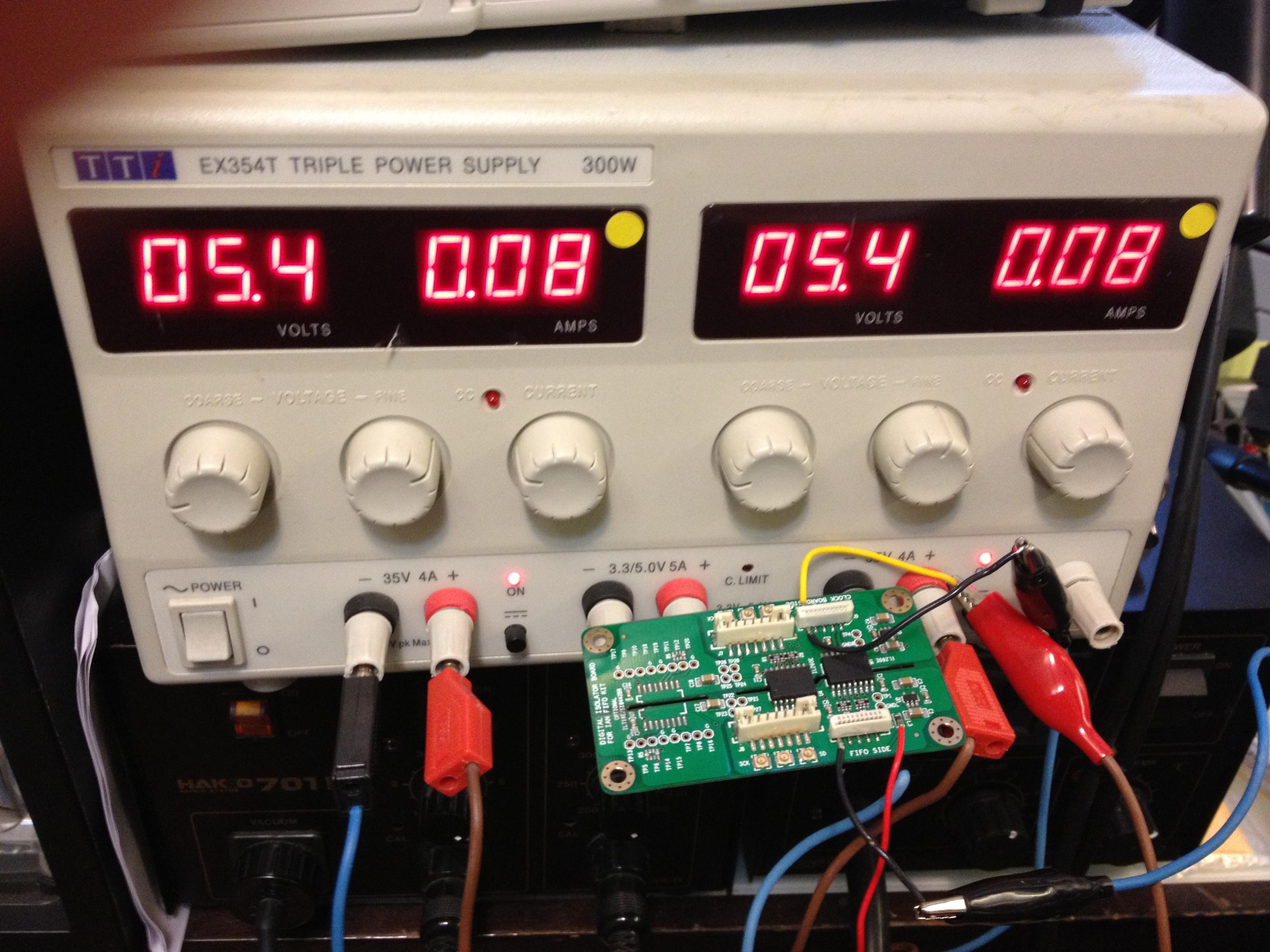

Power the isolator board by bench PSU and both sides draw 80mA at 5.5V and seems fine. Will check the signal path later.
Think about the incident last night, the L11 burnt when I was fixing the bad contact problem with the battery. The LED on the clock board flash couple of times and fire started on L11. May be the transient overloaded the L11.

wow those regs arent as efficient as I thought, the isolator itself should only be drawing about 10ma a side maximum, especially with the inputs and outputs unloaded. or you mean thats where you have the current limit set? if there is now no problem with the iso board, its very doubtful just a transient did that as there simply isnt that much current draw or capacitance/inrush under normal operating conditions, you must have shorted or reversed the battery somehow.

The displays showed the current load not limit set. After confirmed no short on the isolator, I put it back to the circuit. Found that no signal at two outputs that provide clock to FIFO. That may explain why SPDIF not function. Replace the IL260 with i8650, SPDIF function again. But I2S still have problem. Replace the second IL260 with i8650. SPDIF not working again🙁
To avoid making further mistake, I should take a rest and plan the step for trouble shooting. May be my skill is too poor for DIY😕

Did you confirm no any short of disconnection. Since you have the schematic, doing this job would be easy. Than I suggest doing the high-low test to each channel by jumping the input to GND or vdd to confirm they all working.
I don't thinks 80mA on each side is correct, will check up it on my IL260 board.
Just conform my IL260E isolator board consumes only 5.2mA on FIFO side (6V input, without signal connected), so please test the current again after remove all isolator and confirm you LDO is working correctly.

yep thats more what I was predicting based on the datasheet, seems like something is causing short circuit on both sides for both fifo and clock side to be drawing the same 80ma.... strange, but it could be the resistor network on both sides perhaps?
Bigpandahk, I would suggest that you check your 4 resistors network wich soldering could shorten to ground Input and /or Output Signals.
Only the following resistors of the network are connected to Gnd :
R1 : 2nd and 4 th resistors
R2 : 2nd resistor
R3 : 1st and 3rd resistors
R4 : 2nd and 4th resistors
First resistor of every network is the one that is the nearest to the inscription "digital isolator board"
If you find with your multimeter any grounded resistor which is not listed hereabove it means that there are some soldering shortning on the resistor networks
Yes, the main problem is related to the resistor arrays. I remove all 4 arrays and check the current again. both sides reduced to less than 5mA. I replaced all 4 arrays and everything seems fine. The resistance to ground raised above 500K. But when I connected it to the clock and FIFO for couple of minutes, the resistance dropped to less than 100K again.
I may need to find a better way to solder the arrays. But anyway there is progress.
Thank you for ALL of YOU.
