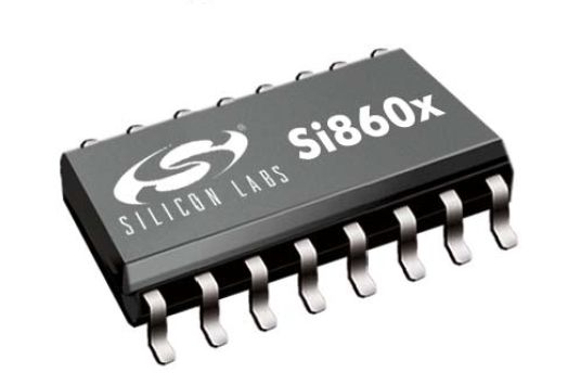

I2C isolator for FIFO isolator board, Si8605
To provide I2C isolation for ESS9018, as well as optional serial port isolation for later on Si570 clock board, I recommend:
SI8605AD-B-IS, 336-2053-5-ND
It's pin to pin compatible with the reserved footprint on the FIFO isolator PCB, with providing both I2C isolation and serial port isolation at same time.
That would be a good news for those who use external controller for ESS9018 DAC.

Great suggestion, Ian. I can use the second isolator board for the DSD input from Teleporter. Still have two IC positions to use😀
what about the additive jitter? the reason I suggested the isolator for where it is, is because its directly reclocked afterwards, with DSD it wont be, but I suppose it will mean the whole system is isolated and you will rely on ESS jitter rejection
That's also why I think the isolator is less advantageous if you've got the PCM converter in your system after the clock board, or does the PCM conversion happen before the clock board?
