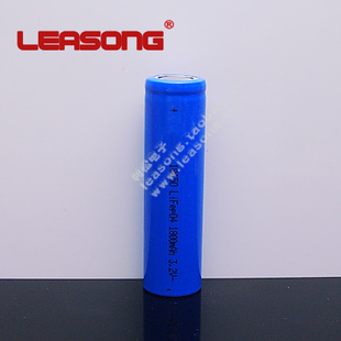

not at those charge voltages it isnt LiFePO4, anyway yes Lipo are ok, bit noisy and many packs have switchmode limiting circuit
THat's the reason not buying this kind of battery pad. This is what I am using :
18650 LiFepO4 1800mAh 3.2V

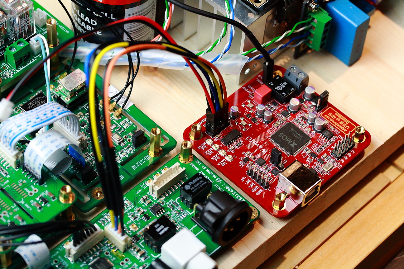

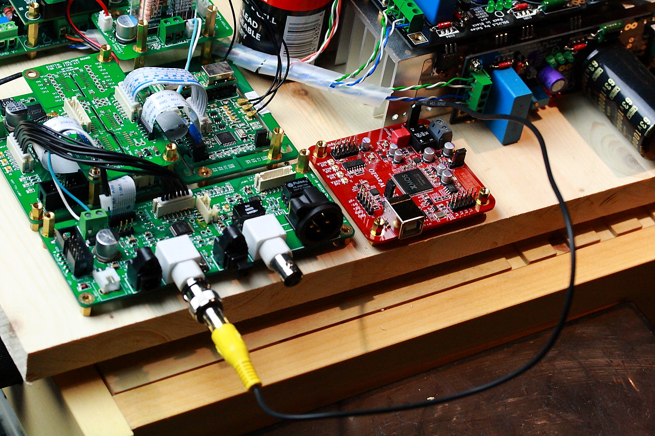

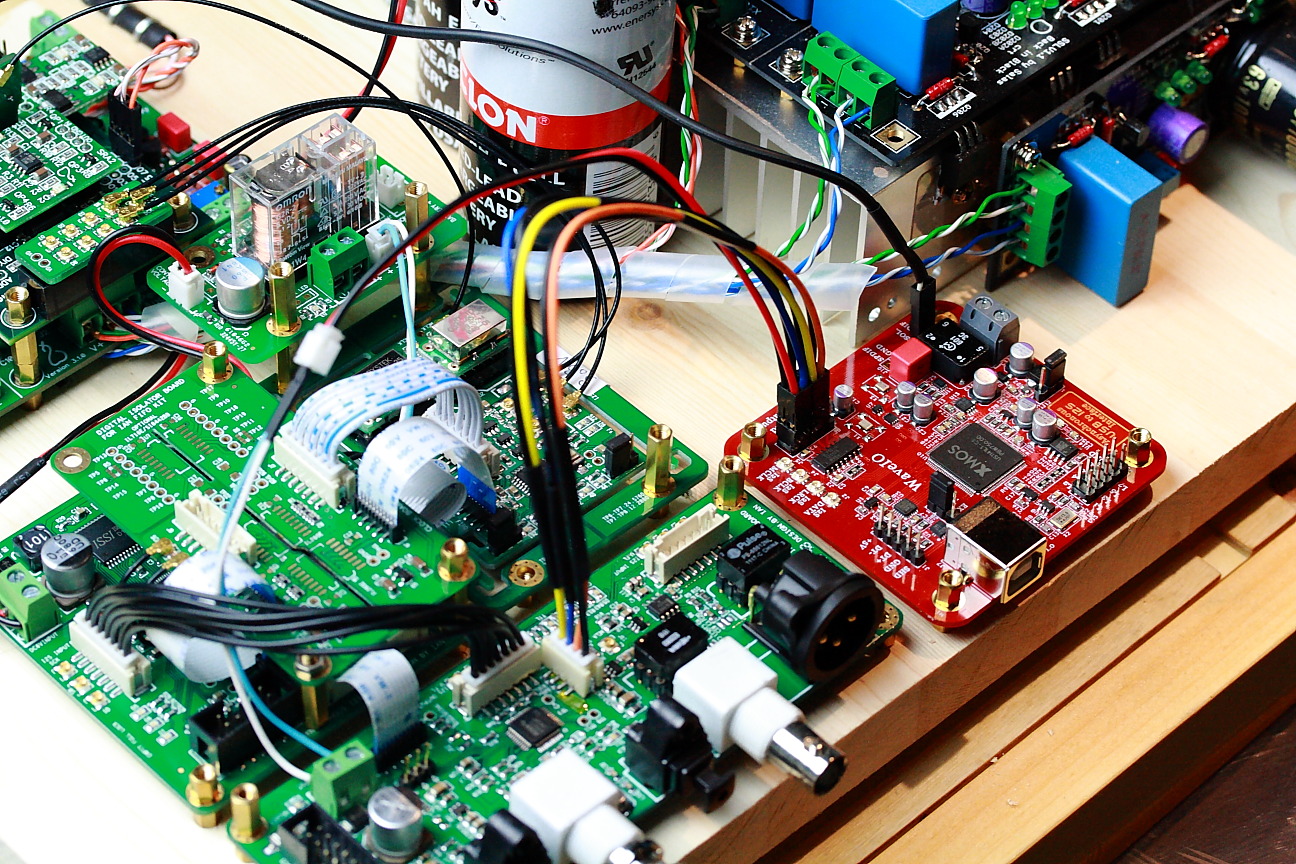

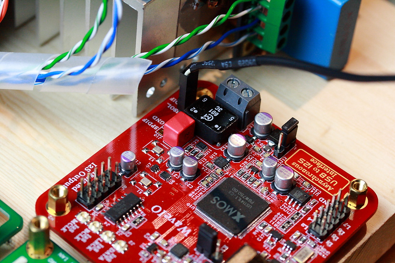

Hook up XMOS WaveIO USB interface to Ian FIFO KIT
I know a lot of people did this configuration before. I just confirm it by myself once again.
There are three ways hoop up XMOS WaveIO USB interface to FIFO KIT, Please see the attached pictures for details:
1, Connecting the isolated I2S output into the I2S backdoor on the S/PDIF Interface Board. The configuration is highly recommended. But you need an additional Vdd for the isolator. You can feed it with the 5V power supply from J13 on the S/PDIF board.
2, Connecting the isolated S/PDIF output into COX input on the S/PDIF board by a 75ohm coaxial cable.
3, Connecting the isolated I2S output into the FIFO input directly. But please do not use this configuration unless you need only one source from XMOS interface. You can get the isolator power supply from J5 of the FIFO board for this case.
Please never use the un-isolated outputs of the XMOS. PC ground from USB is noisy and not safe enough.
The XMOS WaveIO USB interface sounds great on my system and works perfect with different kinds of player software. To connect it with the FIFO KIT is very easy as well. As a USB based I2S or S/PDIF source, it would be recommended.
