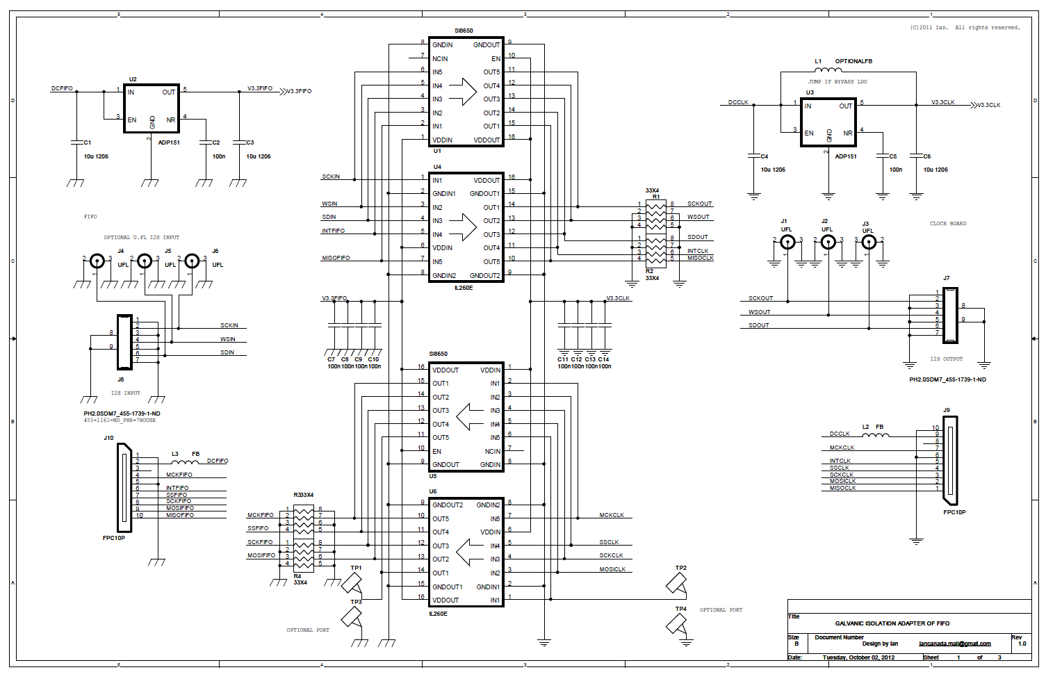

Received the isolator board yesterday and soldered all the components today. Connected it to FIFO and clock board, use separate batteries (2xLiFe=6.6V) for clock and FIFO. All LEDs "on" but the SPDIF input card not function. Remove the isolator board, everything fine. Voltage to the ICs on the isolator board are 3.2XXV. While still finding the fault, smoke came out from the clock board🙁, a component next to the FIFO letters on fire!!!Looks like a capacitor.
What shall I do?
1. SPDIF board has no buiness with clock board. No function means no correct clock came from clock board to fifo. Check up your isolator board for any possible short, wrong IC P/N, wrong soldering position or ffc cable side or soldering dircetion;
2. If you power the FIFO and Clock board from separat PSU without isolater board in between, certainly the two PSU will short. That why you get the smoke. You have to fix the PCB, I saw the DC5V trace burn up already.
Do not need remove L11 for working with isolator board.

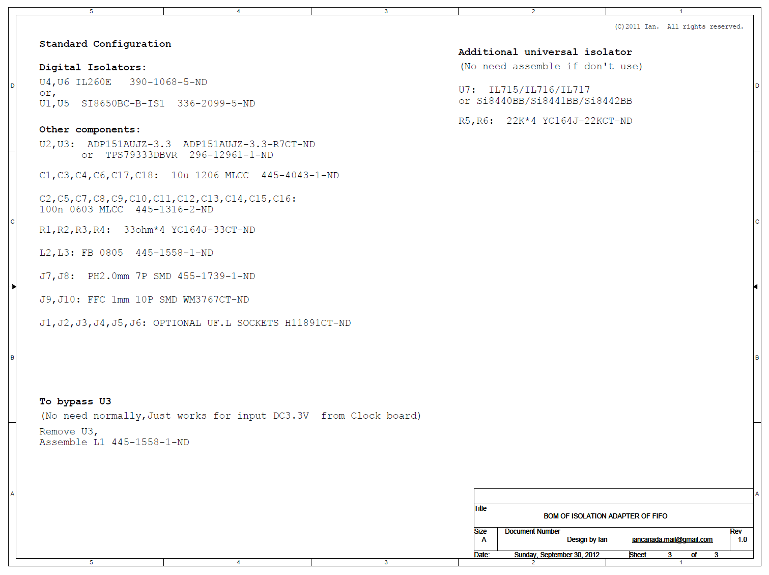

I attach the schematics again for reference.
Always check up for any possible short after maunal SMTA.
Believe you can make it. Don't worry, it's just a small case🙂. Let me know for any help.

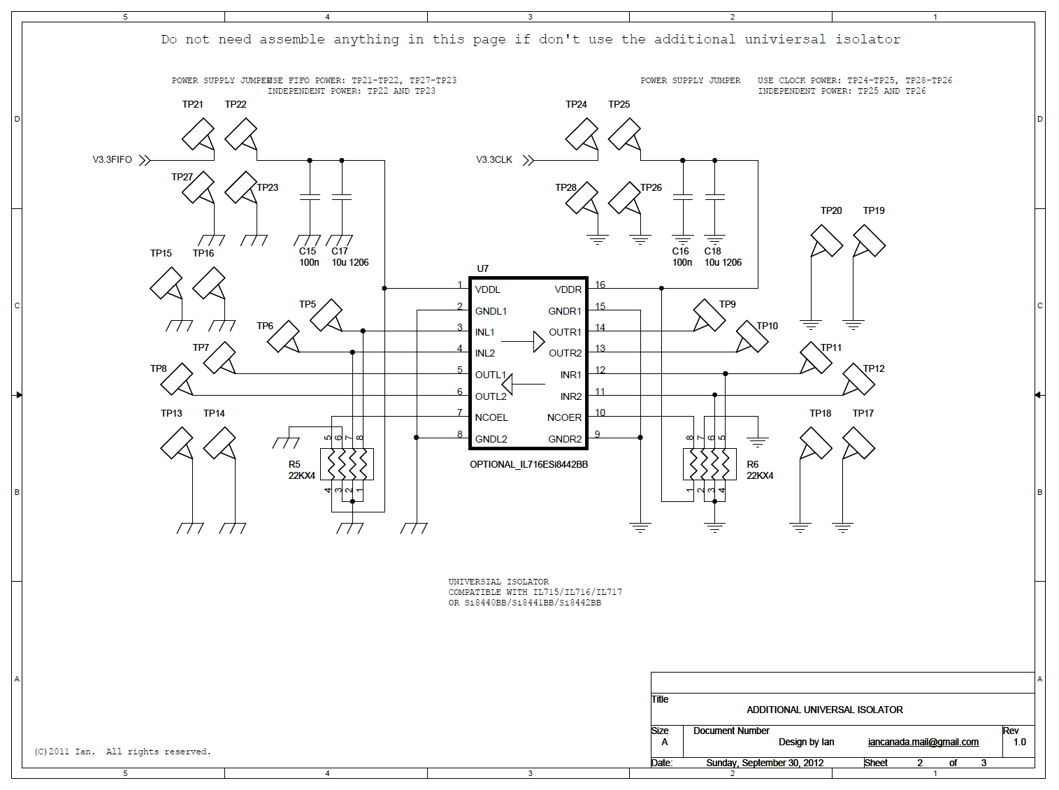

cracra, you could populate the extra optional isolator (U7 and surrounding components) and make up your own pinout for i2c, thats what its there for, but you have to decide what connects where.

1. SPDIF board has no buiness with clock board. No function means no correct clock came from clock board to fifo. Check up your isolator board for any short, wrong IC P/N, wrong soldering position or ffc cable side or soldering dircetion;
Always check up for any possible short after maunally SMTA.

Since the L11 already burnt. can I just short the 5V to pin 2 of J4? What is the value for L11?
dont even think about connecting anything to that isolator till you rule out or fix it.
supply your own 5v to pin 9 of J9 and pin 2 of J10, preferably with some sort of current limiting ie, not batteries that can put 140A into a short...

There is a optional isolator footprint U7 pleace on the isolator board, may have chance trying the I2C isolator on it 🙂.

something about 10ma above the operating current of each side of the isolator chip, say 30ma total for both sides (I presume you will supply both sides with the same bench PSU for this testing?) the input has a quiescent current of 2mA and the output 6mA, then be generous and give the regs 10ma, which they will probably not need. actually which isolator are you using? those numbers are for the NVE part. theres not much by way of capacitance on the board so inrush wont be much of a factor
My bench PSU has two output, so I can use individual output to power each side (15mA). I am using IL260E.
