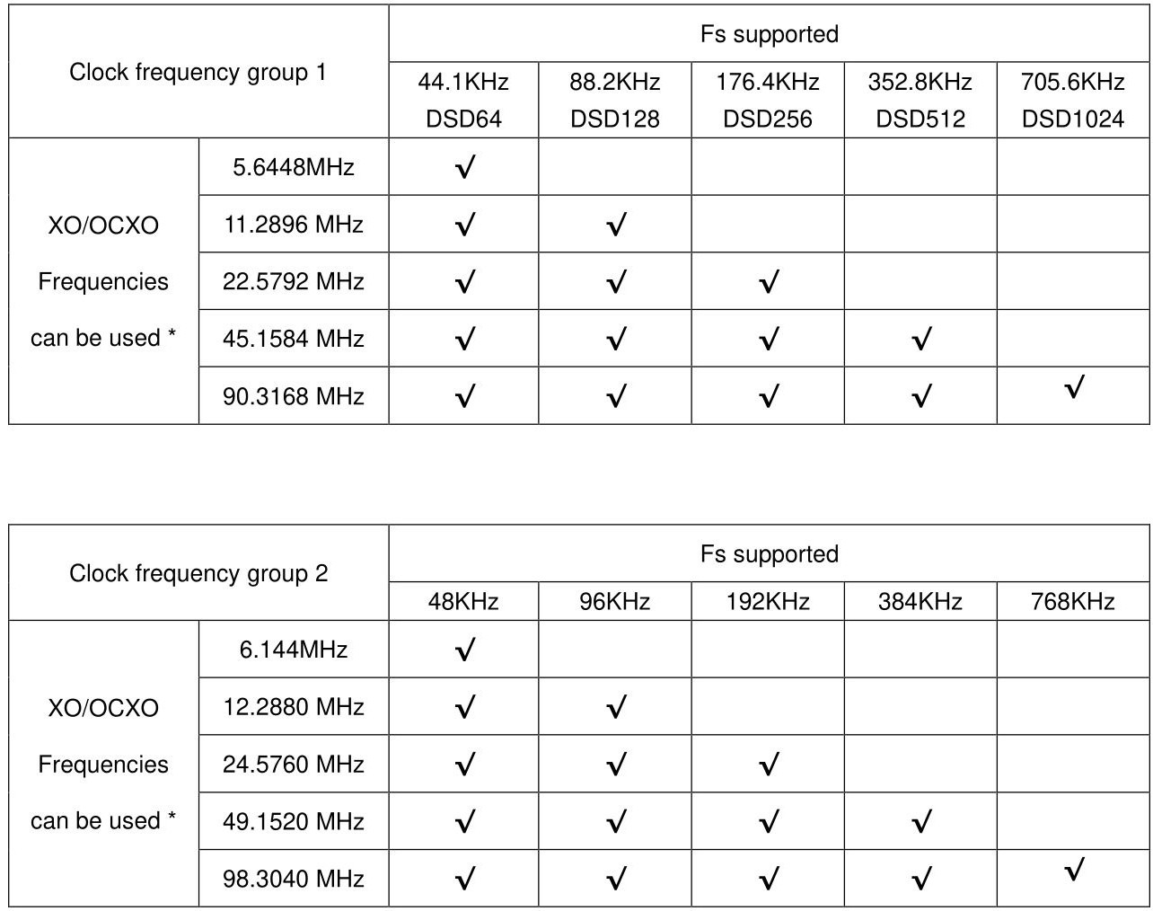

@tubo I'm just using the default clocks that came with the FiFopi Q7, the only identifier on them is "2520". The clock appears to be presenting on the u.fl cable ok. It's a bit unclear as I am using a 200MHz DSO of hobbyist quality so between the scope and the probes the clock signal is not what you'd call square. It may well be if I were to use pro gear. Top trace (yellow) is the MCLK measured taken from the end of the U.FL cable. Bottom trace, (Blue) is the Data pin (pin 40) on the 40 pin header

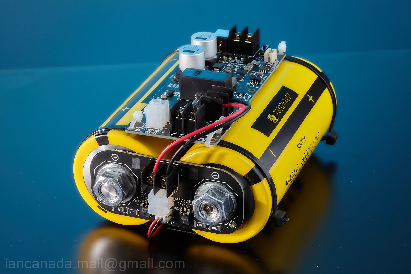

UcBalancer (#41F) is now released.
https://www.diyaudio.com/community/...fo-kit-group-buy.207438/page-240#post-7385114

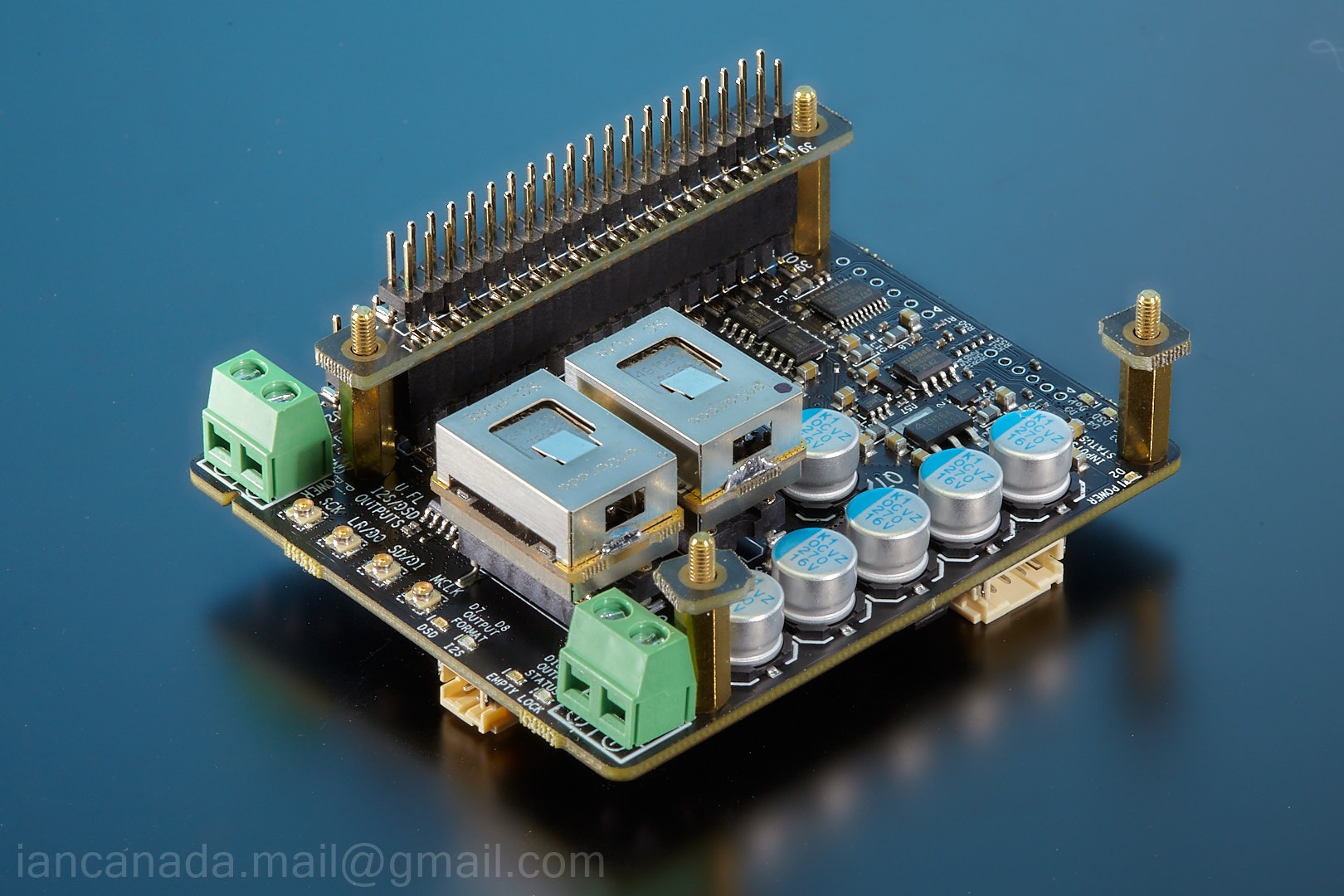

I try to run exclusively in "Pure Mode" for everything. My UcPure 5V is mostly ready and I plan to start charging as soon as next weekend.
I noticed the UcBalancer has output connectors (Molex Mini-Fit) so I can further share if using UcPure continuous output (Molex Mini-Fit).
Since my UcPure 5V is ready, my next step is to craft Solid Core USB cables for Power-Only this week. But I don't know if I am using Switched Output (Terminal) or Continuous Output (Molex Mini-Fit) yet depending on "Pure Mode".
Awesome, suggesting <=AWG16 and single core (solid core).
Crossing fingers this runs in "Pure Mode"
That's great I don't have to short to get into 3V as I'm just focused on 3.3V and 5V applications ATM.

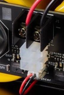

• Has two direct ultracapacitor output connectors to get the best possible low ESR performance in
continuous output mode rather than indirectly from a UcPure
- If I run Continuous Output (Molex Mini-Fit) off the UcPure is that running in "Pure Mode" 24/7?
- If I run connectors (Molex Mini-Fit) straight off the UcBalancer, any chance that runs in "Pure Mode" 24/7?
Need to be connected to UcPure input J7 with the supplied red and black wires. To reach an even lower
ESR, AWG16 or bigger single core wires are also recommended. Never reverse the wires.
J2 and J3: Direct ultracapacitor outputs
Alternative to the J10 and J13 on the UcPure to get continuous mode ultracapacitor power supply outputs at
even lower ESR.
J2 and J3 are connected to the ultracapacitor terminals directly. They are equivalent to each other.
J2 and J3 don’t have fust protection. So, in the real applications, I suggest using the UcPure J10 and J13
first and later on change to J2 and J3 after system gets stable.

1. 2.7V and 3V configurations
By default, UcBalancer is in 2.7V configuration.
To change to the 3V configuration, you just need to short S1 and S2 on the bottom side of the UcBalancer
PCB with solder balls.
Please note, for 3.3V and 5V applications, I don’t suggest using the 3V configuration even you have 3V
ultracapacitors. For safety reason, never use the 3V configuration for 2.7V ultracapacitors.

I believe Ian runs the Pulsar 90.316800 / 98.304000 MHz as his "Gold Standard" pre-SC-PURE / pre-RFX.
Since I run Redbook-only in it's purest form, my Gold Standard is Andrea's 5.6448 MHz as nothing out there will even come close for now with the exception of extreme costs and you will have to run on Mains. Both exceptions I draw the line, so I feel fortunate here too. Ian and Andrea was a amazing collaboration. It's as if Steven Speilberg and James Cameron were to do a film together. So beautiful that 5.6448 MHz only supports 44.1 KHz.
The SC-PURE 22.5792 MHz will be for my second Ian Stack.
My plan for a third Ian Stack in a few years was a backup copy of my primary Andrea/Ian rig, but I want to see how the SC-PURE / RFX plays out before I start building a third stack.

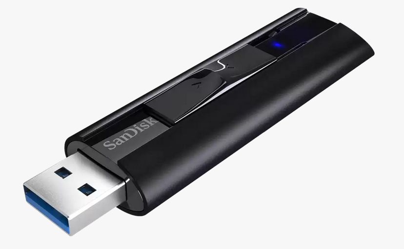

For maintenance, reliability, ease-of-use, robustness of Raspberry Pi 4 storage I recommend booting with a SanDisk Extreme PRO® USB 3.2 Solid State Flash Drive instead of a microSD card.
It is just so much more friendlier than microSD.
https://www.westerndigital.com/prod.../sandisk-extreme-pro-usb-3-2#SDCZ880-128G-G46

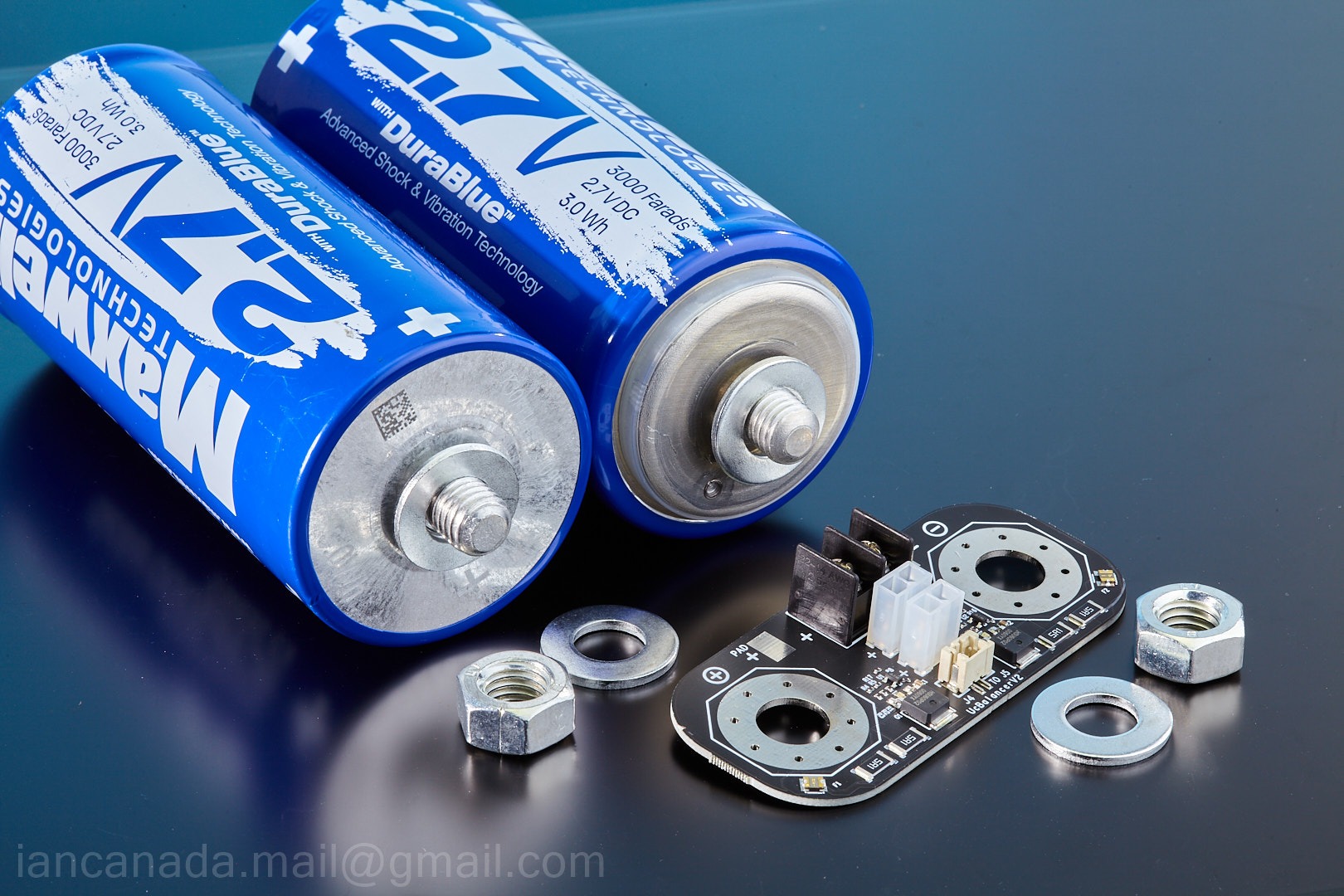

Newbie question here? I have tried to look at the specs but this information was not found.
I am building a DDC with Ian’s boards using the UcPureMkII.
Anybody could point me what is the nut size for EATON XL60-2R7308T-R ultracacitors? I’ve seen on @Gabster 2000 videos they are M12, but what is the thread size? 1.25, 1.5 or 1.75?
Thank you!

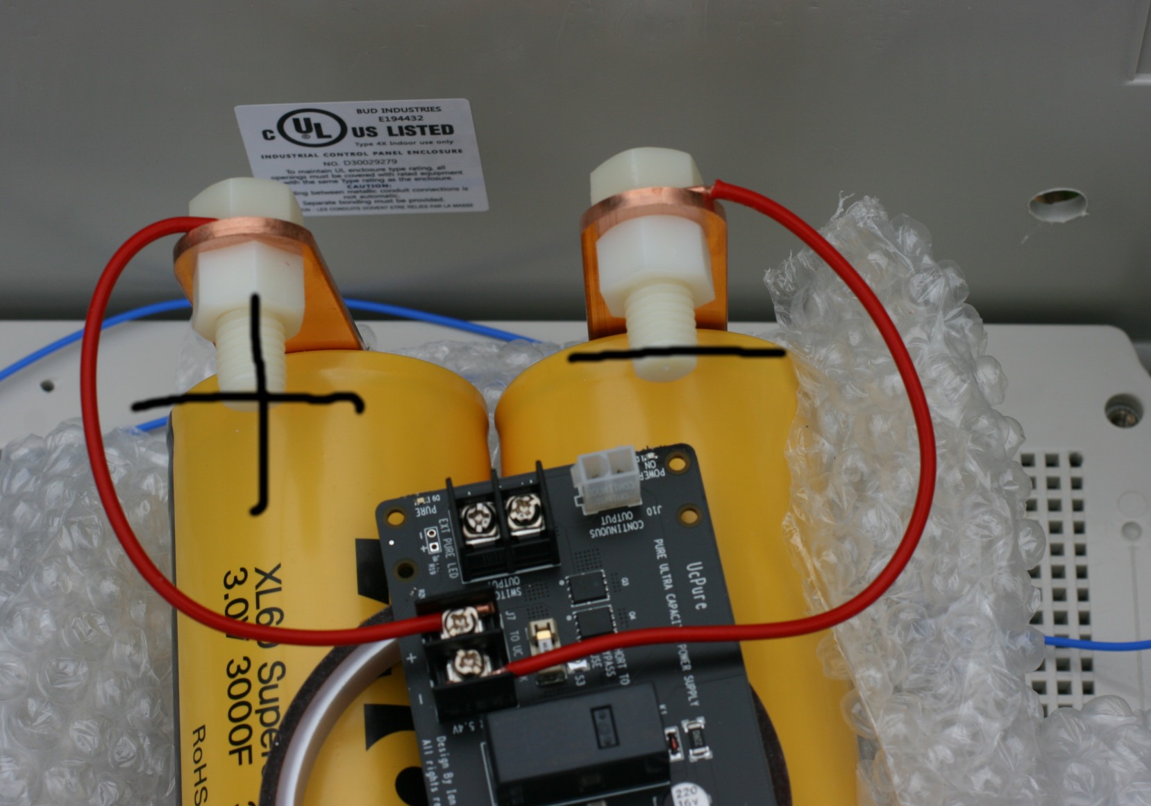

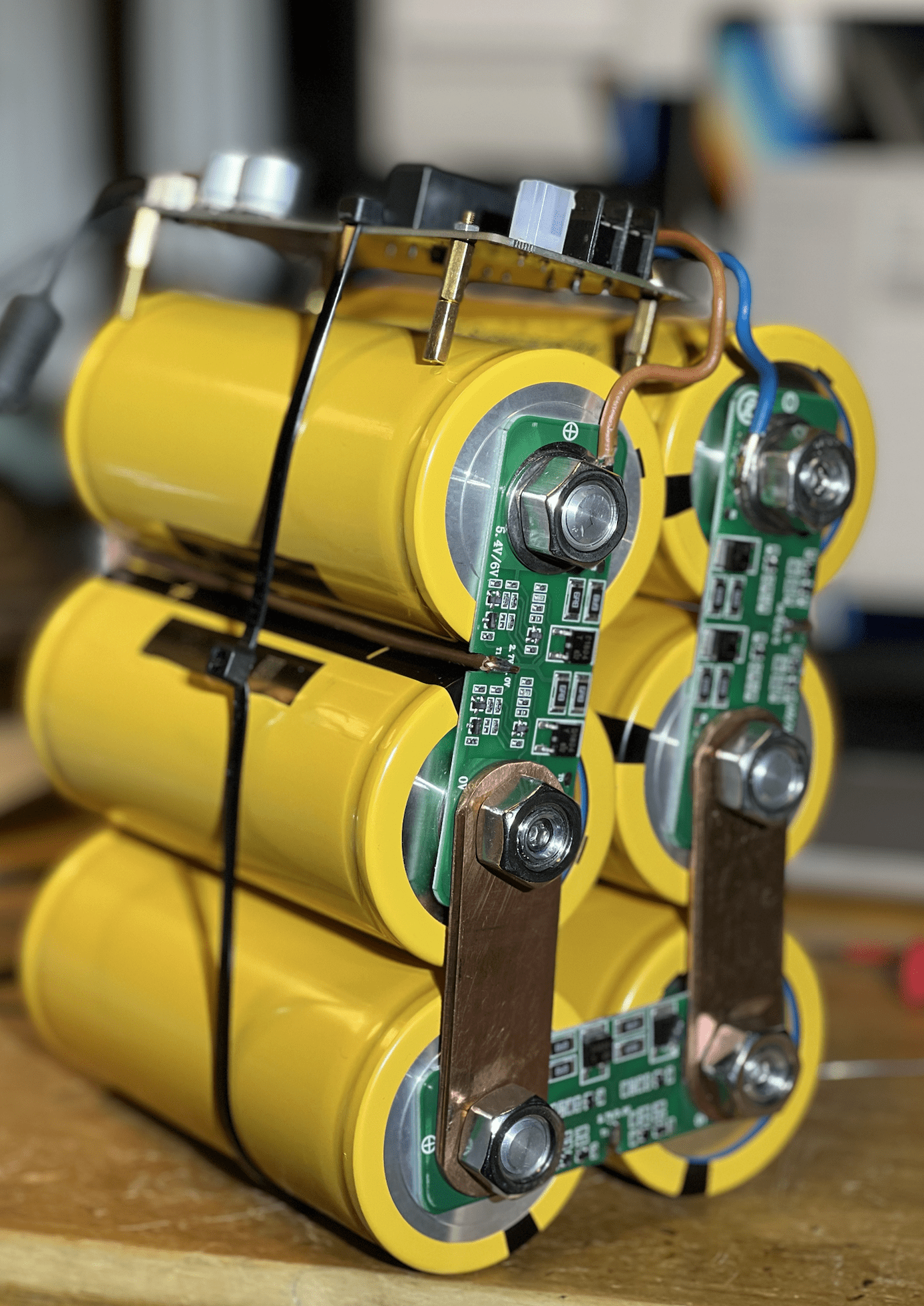

I'm just a simpleton that would never dare to put together a transformer (maybe survival instincts kicking in), but I ignored the thread size when procuring M12 Nuts as there was only one thread size available (1.75mm) for Nylon (Plastic) so I took a chance. I only wanted Nylon (Plastic), but I'm going with Cooper Washers because I think it would make a good fit with the UcBalancer.

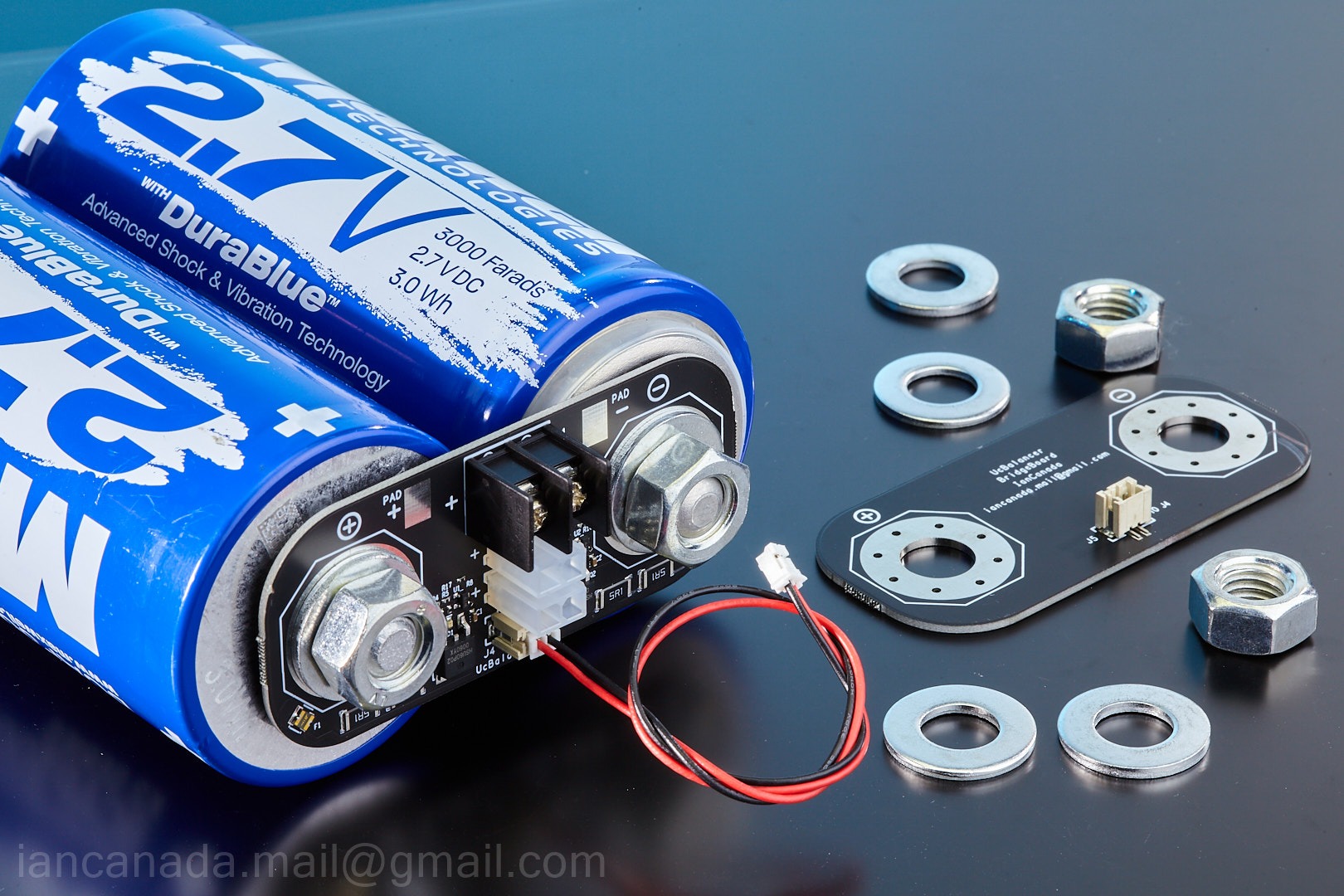

You will need four M12 Nuts and eight M12 Washers for each Eaton XL60 when paired with a UcBalancer.
I haven't notice any problems so far:
I'll have new photos next weekend since I found my DIY supplies, so my UcPure build should be mostly if not fully complete. The Eaton photos does not represent it's current state.
But if posters experienced in this field has a better suggestion, it is definitely welcomed as I can learn from the experience in the long run.
Thank you for the tip for the washers, I did not think of this one until now. If you are able to remove the nuts and put it back, it could be the correct thread size. Nylon is more flexible than metal thou, it may not be the exact size too. I’ll wait from other DIYers comments. Did you use a balancing board? I ordered the one suggested by @Gabster 2000, it is not very expensive, better safe than sorry.
In that case, I can't comment on the amount of washers needed for non-UcBalancer balancing boards.
I can only comment on UcBalancer. I recommend 8 washers because the Eaton terminals are not both flushed. One will be flush, the other will not. So having two washers should give it some more even headroom. Also on the UcBalancer, the ends of the Main +- terminal are pointy and can touch the Eatons if not given proper space.
The backend of the terminals can touch the Eatons on the Yellow plastic covering. With proper washers, there should be space.
Also the design of the UcBalancer on both sides seem to scream for proper washers so that's what I will try to do.
Yes, the M12 Nuts freely loosen and tighten. I would of ordered another set of M12 Nuts along with M12 Cooper Washers if I didn't think it should work fine, but experienced DIY'ers may point to something we never considered.

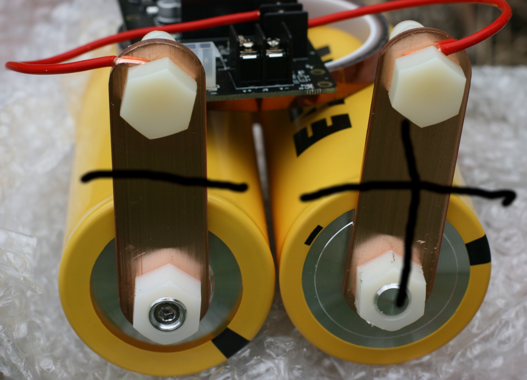

I was planning on cutting up my Cooper bussbars for Cooper Washers, but too much variance so I just placed a solo, separate order for M12 Cooper Washers this weekend. I had M12 Nylon Nuts for a month. So my recent order, I didn't feel the need to tack-on alternative M12 Nuts as I'm happy with the M12 Nylon Nuts.

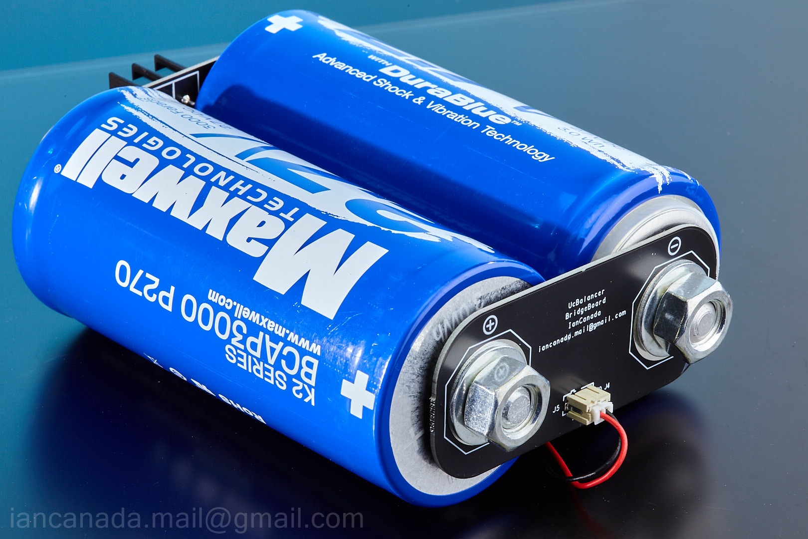

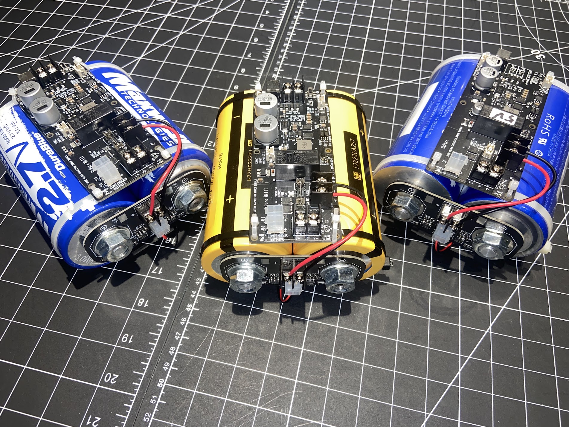

UcBalancer KIT comes with 8 washers and 4 M12 nuts. I replace all of my 5 old balancing boards with the new UcBalancer boards one night after I got them. I have to say they are really great and make things much cognized and easier.
https://www.diyaudio.com/community/...fight-the-jitter.192465/page-439#post-7385115
Please see the attached pictures for the steps of the installation.

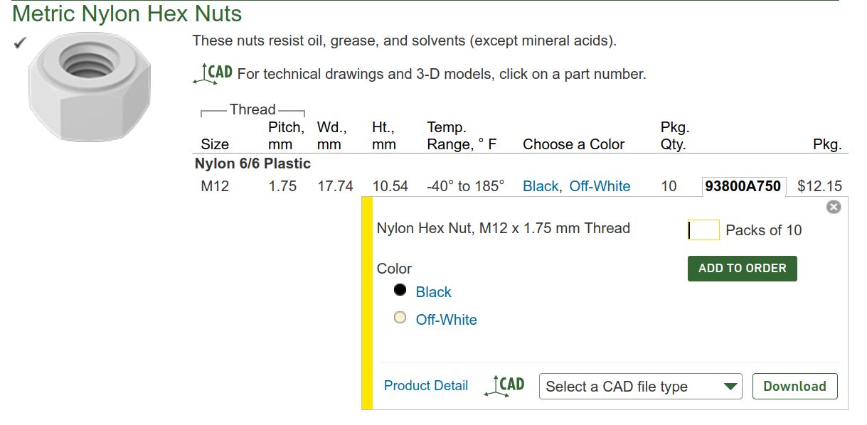

@Yveskoala
M12 1.75 thread

ConcernIng the bolts of the supercaps:
It is always a good thing to integrate collecting all the datasheets of the (more complex) components we are planning to use.
In the datasheet for the supercaps the correct norms are listed: M12 with 1.75.

Mixing of aluminium with a metal like copper can cause corrosion especially if there is a considerable current flow ( during charging 3A) Aluminium and galvanised steel is a pretty corrosion proof combination.. So i guess the easiest thing to do is used the hardware provide by Ian.
Maybe (ultrasonic) cleaner and adding a contact enhancer could improve things even a little more.
That switchout from your 5 old balancing boards to UcBalancer boards sounds like an awesome night. I really look forward to the day I get the UcPure up and running since I've been patient with finding the right Balancing board ever since the UcPure was first introduced. I'm glad the Eaton Balancing Boards Supply Chain never caught up because I would probably be replacing the Eaton Balancing Boards with UcBalancer this Summer.
Thanks for the confirmation of included 8 washers and 4 M12 nuts. Usually when I see accessories in the Main photo with the Main products, I usually assume the accessories included but this confirms.

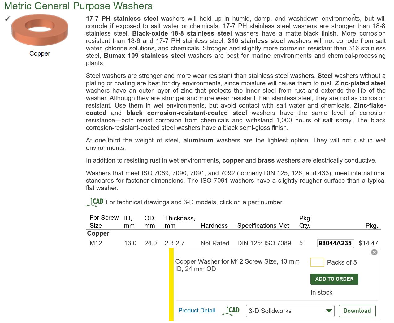

I think I'll stay the course with Cooper. I always envisioned I would have a Cooper Bussbar in the mix. When I build my 16V UcPure, I'll use the standard Nuts/Washers.
Cooper is suppose to be more electrically conductive?
7-7 PH stainless steel washers will hold up in humid, damp, and washdown environments, but will corrode if exposed to salt water or chemicals. 17-7 PH stainless steel washers are stronger than 18-8 stainless steel. Black-oxide 18-8 stainless steel washers have a matte-black finish. More corrosion resistant than 18-8 and 17-7 PH stainless steel, 316 stainless steel washers will not corrode from salt water, chlorine solutions, and chemicals. Stronger and slightly more corrosion resistant than 316 stainless steel, Bumax 109 stainless steel washers are best for marine environments and chemical-processing plants.
Steel washers are stronger and more wear resistant than stainless steel washers. Steel washers without a plating or coating are best for dry environments, since moisture will cause them to rust. Zinc-plated steel washers have an outer layer of zinc that protects the inner steel from rust and extends the life of the washer. Although they are stronger and more wear resistant than stainless steel, they are not as corrosion resistant. Use them in wet environments, but avoid contact with salt water and chemicals. Zinc-flake-coated and black corrosion-resistant-coated steel washers have the same level of corrosion resistance—both resist corrosion from chemicals and withstand 1,000 hours of salt spray. The black corrosion-resistant-coated steel washers have a black semi-gloss finish.
At one-third the weight of steel, aluminum washers are the lightest option. They will not rust in wet environments.
In addition to resisting rust in wet environments, copper and brass washers are electrically conductive.
