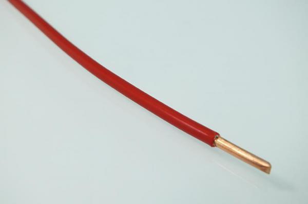

Hello,
Solid core can be difficult to crimp properly, You will need a serious connector with the right crimping tool to get it right.

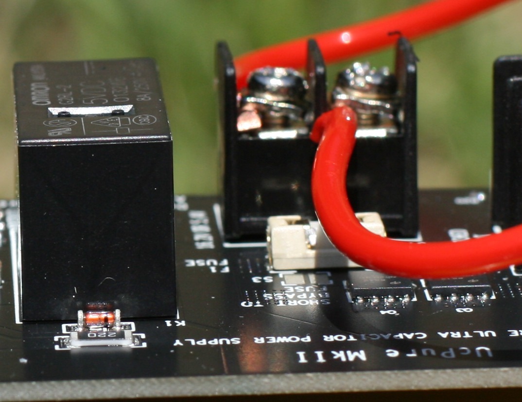

I can see how that can me an issue depending on the termination.
But for Ian Canada Products, I have used 18G Silver Solid Core over the years without a hitch for DC Connectors (Andrea's Clock) and 30G Silver Solid Core for microUSB connectors (3rd party).
Recently, I have moved onto Cooper for UcPure and USB connections. The 12G Cooper Solid Core fits seamlessly on the UC* terminals and screw tightly with ease once it flush fits. I will try 20-22G Cooper Solid Core this week as I am making USB cables to prepare to use with the UC* this weekend.
So I was able to easily solder 18G for Switchcraft DC connectors and they easily insert and screw tightly in the power terminals on the other end. The 12G will likely be too difficult to solder as an endpoint, but between two heavy duty devices they easily insert and screw tightly in the power terminals.
I'll have photos at the end of the week with the 12G in the power terminals. Yes, Solid Core is stiff depending of the Gauge.
The only time I had to worry about crimping was with the Molex Mini-Fits, but I think I can avoid since Continuous Output does not go into Pure Mode. Only Switch Mode seems to go into Pure Mode, so I'm sticking with the Power Terminals.

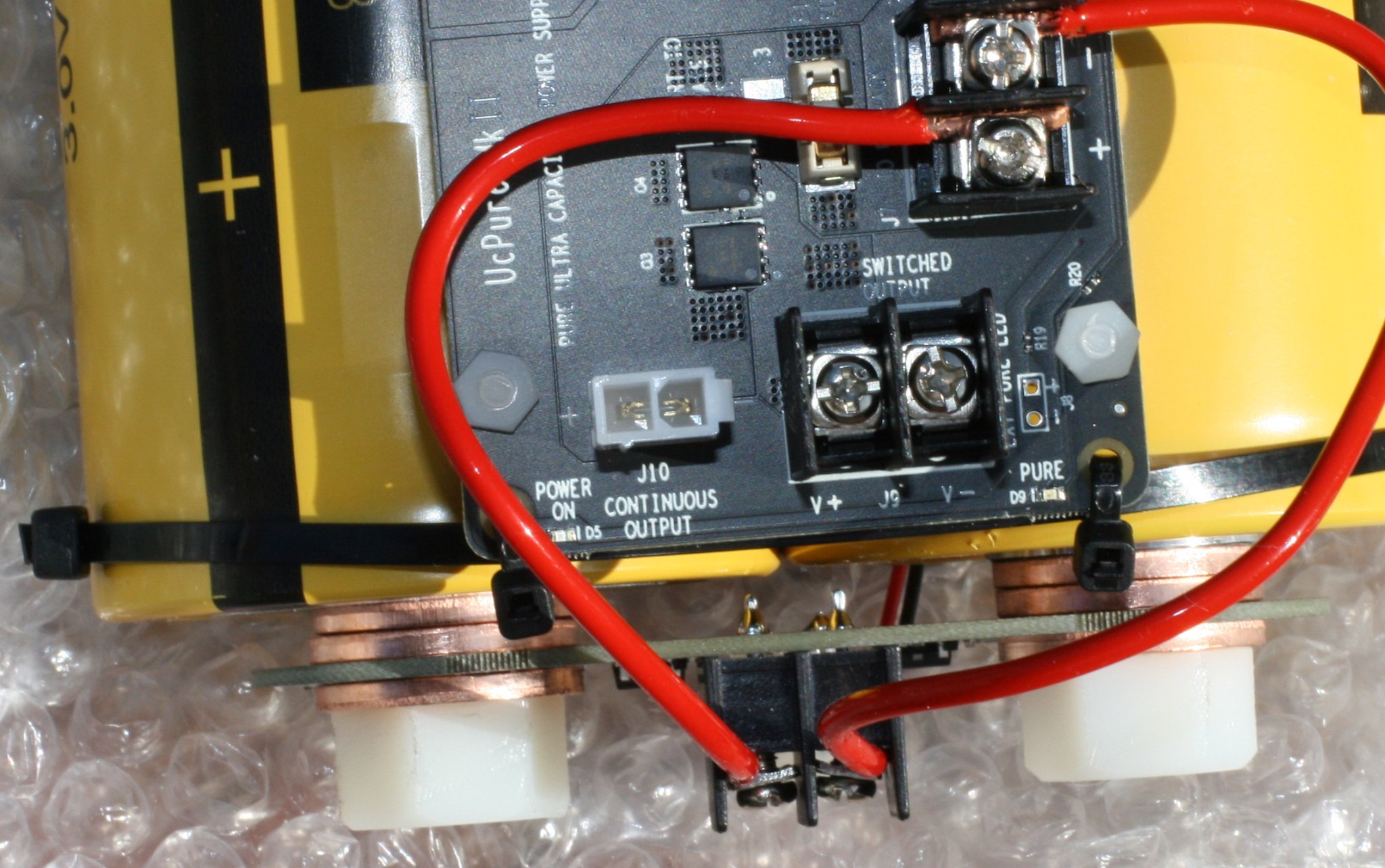

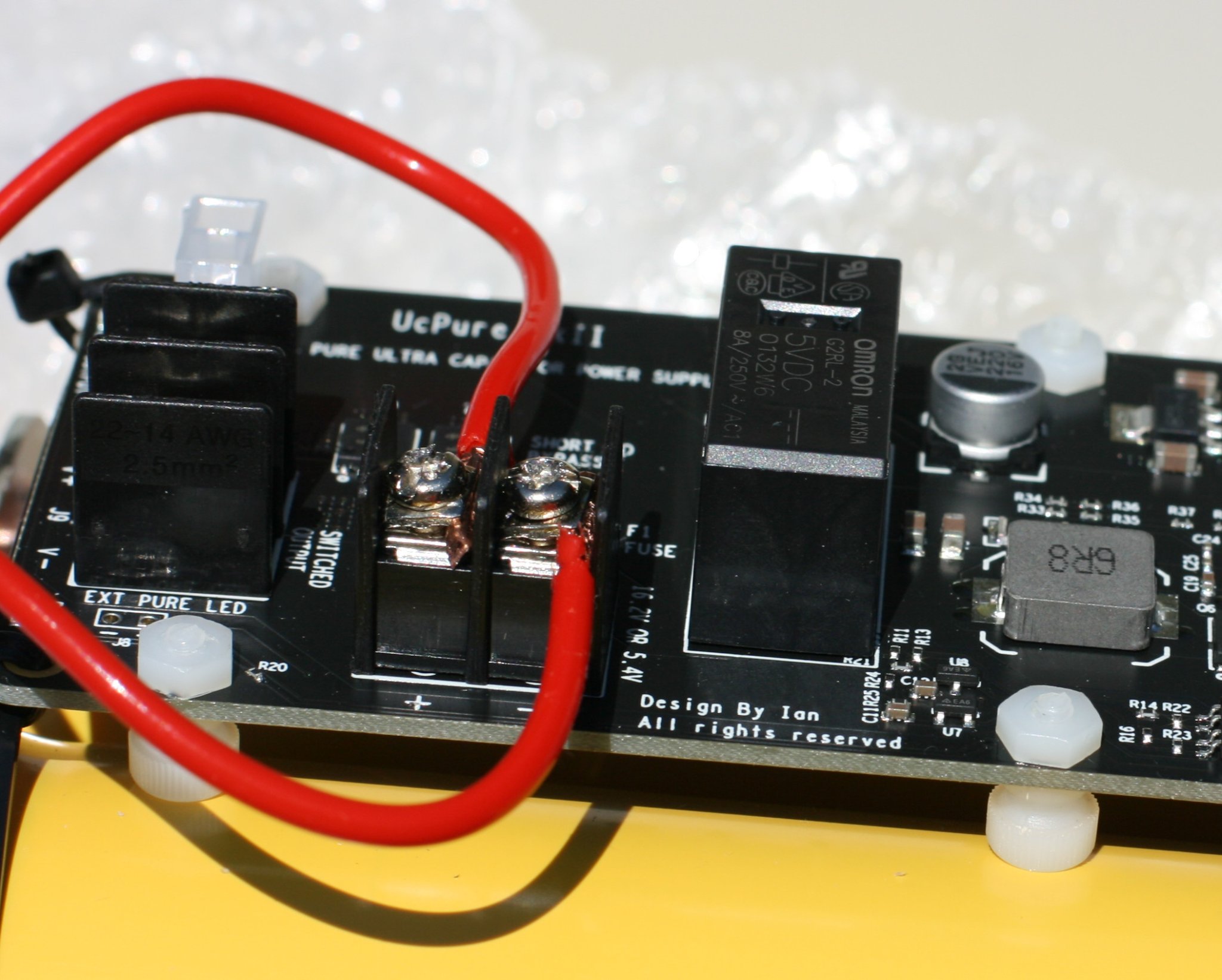

I decided to take some photos early with the Neotech Cooper Solid Core 12G in the mix. I only use a Torque Screwdriver, so the Terminal Screws were screwed in firmly but not overdone.

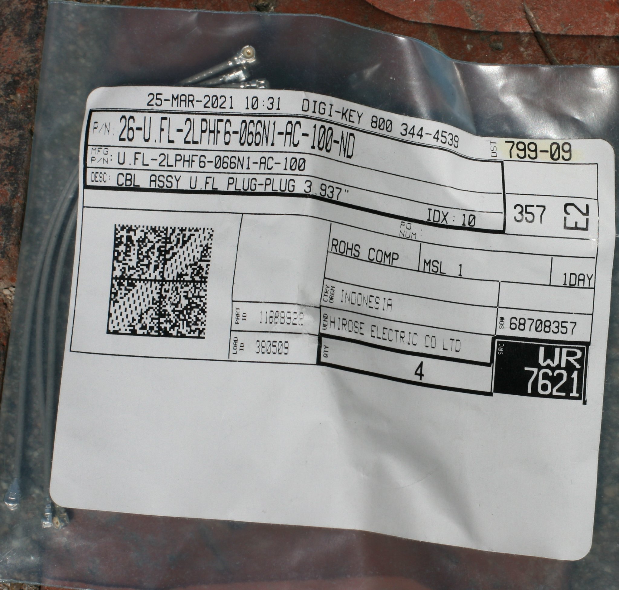

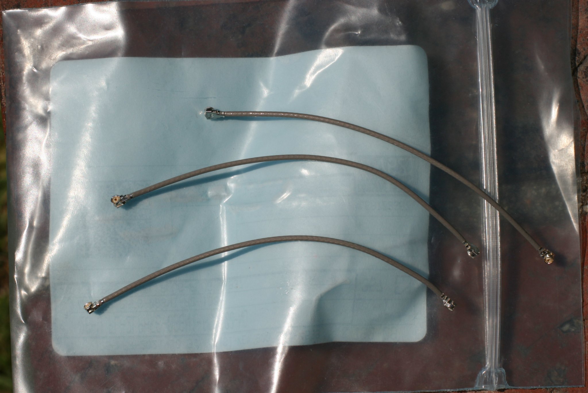

I also found my Genuine Hirose U.FL Stash:
I'm so glad I have extra as I will need another one for my 2nd Ian Stack. Genuine Hirose just makes life much easier in my case. Could be an anomaly, but I already have extra cables and switched over so it's here to stay.
I can't recommend this specific product as this product is now obsolete. There should be alternatives.

Hello,
You could make a '' loop '' to get a much bigger contact area. It will also create a more even distribution of force/load upon the head of the screw. It is not a dynamic load but it will be there all the time.
Or you could use two wires extra compared to the set up in the pictures above. It would reduce ESR by 50 %.
Very probably most of the ESR will be in the connection and in the connector.
You could do a test with a big diameter wire and a connector or a thinner cable directly soldered at the board.

Hello,
If i would use this one i would rather solder a solid core cable than crimp it.. Use a powerful iron, pretin the connector and pretin the solder core before soldering it. Remove the heatshrink before doing this so you heat up the metal where you want the heat to be.
Probably making a loop yourself will be easier and will create an easier highway for the current. Of course you can use a tool to flatten the solid core to create more surface area.

Thanks for the advice fellas. I just focus in the context of implementing Ian's products, not Engineering Theory.
As long as the Solid Core Wire is flat to the bottom surface and flat to the Screw Washer, I'm set. Even if the Washer is angled as long as it's flat it's making solid contact direct to the Solid Core Wire. So both sides making direct, flat contact should be good.

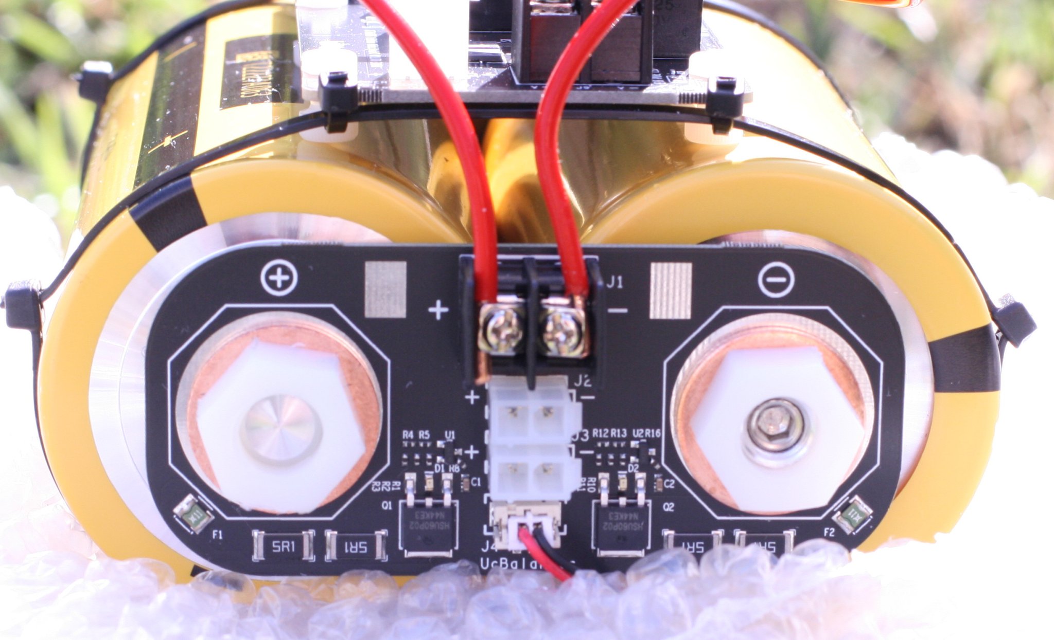

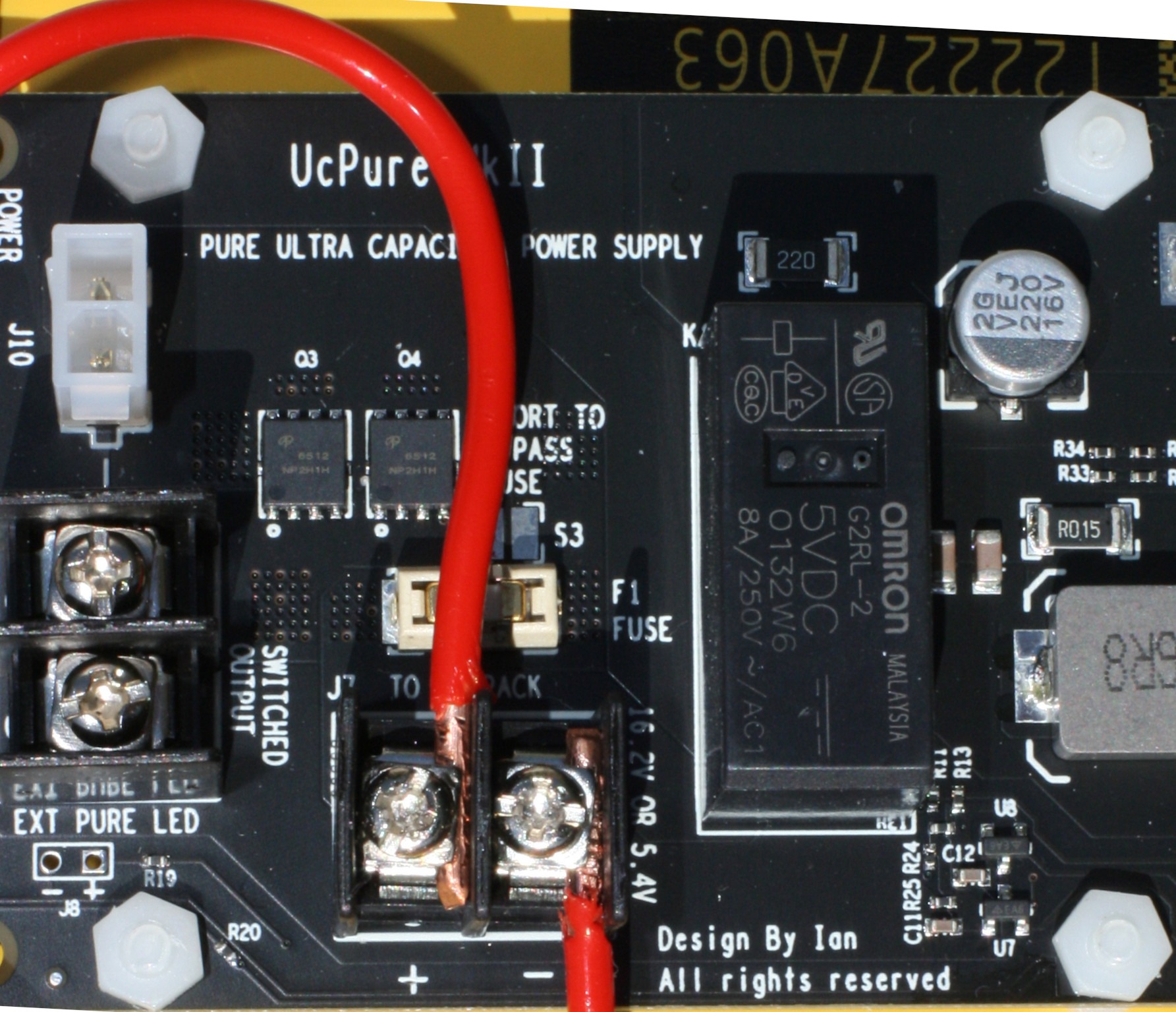

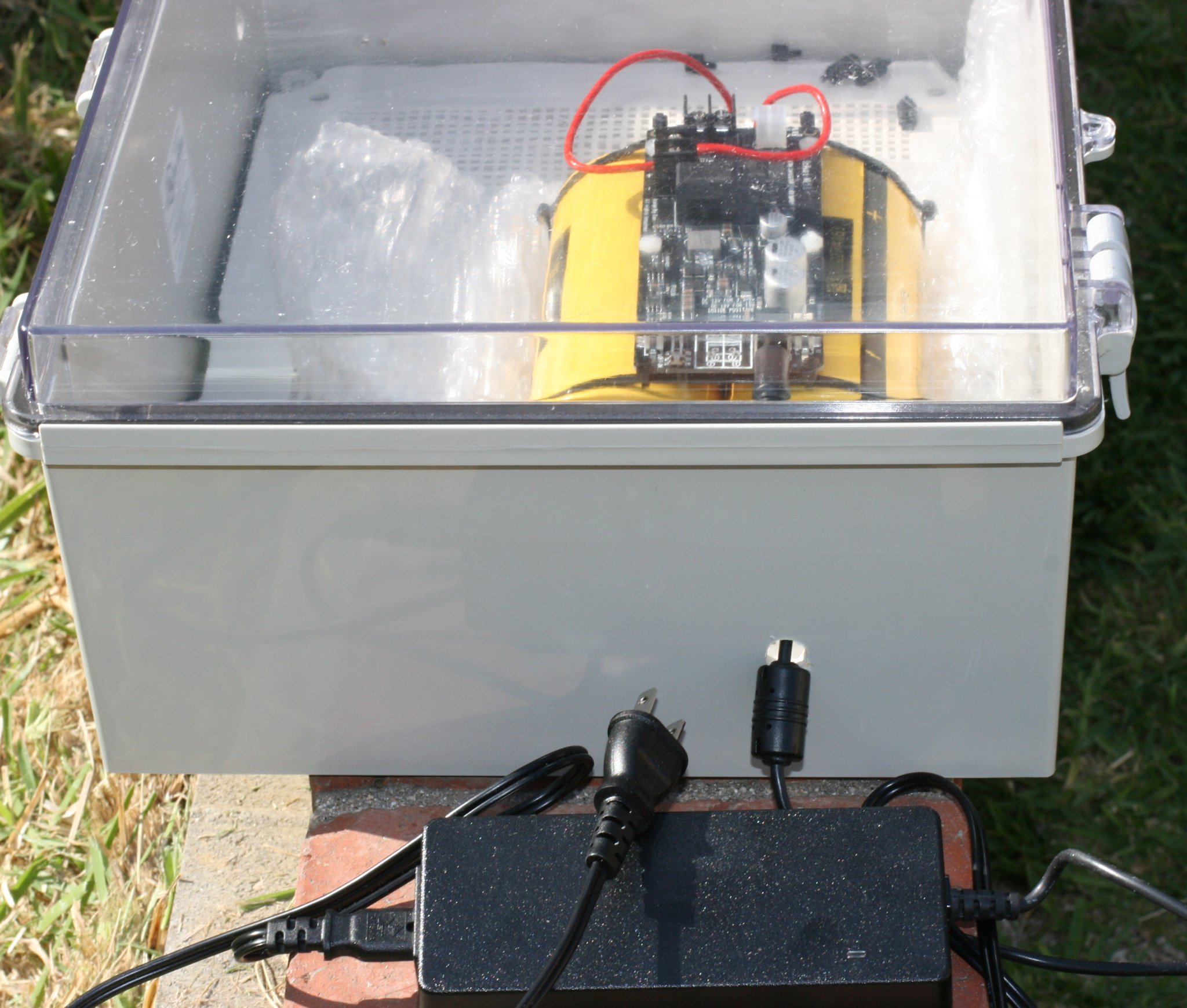

Mission Accomplished! Packages arrived. My main goal for the Summer Project was UcPure 5V. I'm offline on this site all of July for holidays now that the Main Summer Project is out of the way.
This UcPure 5V will replace my triple stack 5V to power a USB optical cable. This frees up my triple stack 5V to focus on getting the StationPi up and running since RPi needs PWWWR.
I'll try to report back in August how well the "Pure Mode" works with the triple stack 5V powering both the RPi and Audio side of the StationPi.
This freed up some time as right now I'm isolating CPU cores with specific Audio Apps on my realtime low latency system. I dedicate 3 cores to Audio apps and 1 core to RPi tasks. Need to prepare it for the StationPi transfer and Q7, so I updated the OS and kernel.
^^^ I've been using this Plastic Case that locks for all of my Ian's Power Supplies to break in. Now, it's time to break in the UcPure 5V.

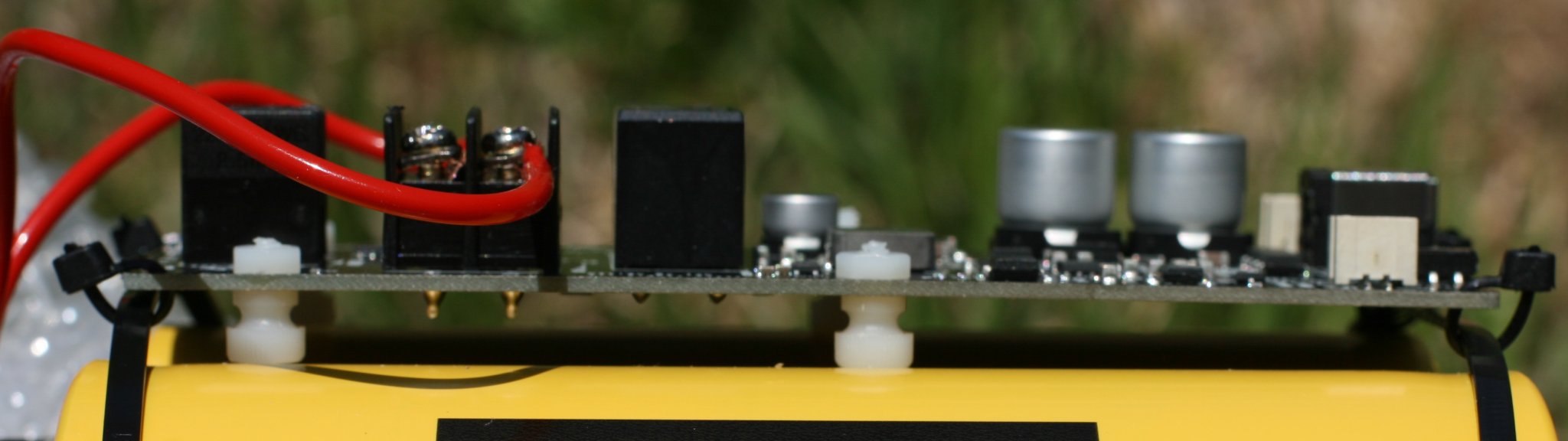

^^^ You can see the other side of this beautiful, thick Neotech 12G Cooper and how it seamlessly integrates with the UcBalancer. I was determined to Heat Shrink, but with the plastic nylon M12 Nuts there's absolutely no need.
^^^ I'm glad I procured third-party Cooper Washers because it included a few extra. As I suspected, I had to double up on the Washers as the pointy end of the UcBalancer Terminals hit the Eatons with a Single Washer. I like spacing and I'm overly-cautious. For the 16V build, I'm going to try to get Cooper Washers from where I get my Cooper Bussbars. The Cooper Bussbars are so nice and thick. The Cooper Washers are okay, but a bit thin for my taste. They are Machinists so should be able to custom build.

@Drive Shaft
The UcBalancer direct output will be super pure mode as long as the UcPure is in pure mode with the blue LED lights up.
But I would suggest change to that direct output only after the system got stable because the direct output is super "PURE" without any fuse for protection.

WOW, that's good to know. I want. I have a dozen Molex Mini-Fits leftover from LiFePO4 MKIII, so I'll eventually try this solution. The Mini-Fits take up to 20G, so that's my MAX for USB so it works out. The UcPure 5V will power a few+ Solid Core Cooper USB cables with No Mains in theory.
Yes, I picked up "No Fuse" from the UcBalancer Manual. I try to re-read all the Manuals before going into Production. I'll weigh all the concerns, so thanks for the reminder. After a period of stability, I'll likely feel comfortable like I have with previous Ian Canada Power Supplies. All of those have been running solid in "Pure Mode".
I plan to run UcPure 5V 24/7/365 so this should work out well. Same once I go UcPure 16V. UcPure 3.3V will be Switched.
