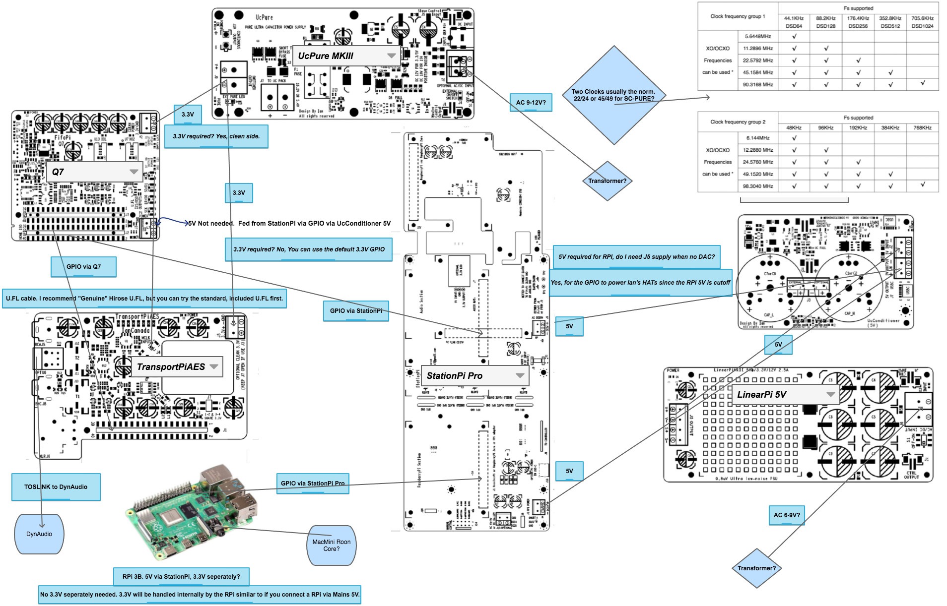

I've asked some questions before, because I want to build "ultimate" (Roon) streamer to go in between my MacMini M1 running Roon Core and my active (SPDIF input) Dynaudio speakers. After a lot of reading and searching, I came to the following list of Ian Canada products I think I need to achieve my goal:
1. TransportPi AES (#20C) (3.3V required)
2. FifoPi Q7 (#1D) (3.3V required)
3. StationPi Pro (#35B) (5V required for RPI, do I need J5 supply when no DAC?)
4. LinearPi 5V(#32A) (for RPI)
5. UcConditioner 5V (#25A) (for RPI)
6. UcPureMkIII (#41C) (2 Pcs or 3 Pcs if RPI can have seperate 3.3V)
7. UcBalancer (2 Pcs or 3 Pcs if RPI can have seperate 3.3V)
8. RPI 3B (5V via StationPi, 3.3V seperately?)
9. 2 clocks SC-Pure (Which frequencies, 44.1 up to 192 kHz required)
A few questions I have:
Thanks in advance for any advise.

Hi Mark!
I'll try to answer most questions. As I also want the same, I also did a lot of reading, but I still have a few open points, see https://www.diyaudio.com/community/...eapon-to-fight-the-jitter.192465/post-7380841 if you are interested. Hopefully @iancanada will help out, if he has a minuted.
Have a nice day,
Matthias
- Additionally you may need a MonitorPi (Pro). Otherwise I think the list ist fine.
- The RPi doesn't need 3,3V. So, 5V is fine. If someone can answer this: Is 1 LinearPi 5V enough for a RPi?
If you filter the 5V from the LinearPi with a UcConditioner, the power for the RPi is for sure clean enough. - I can't answer the question, which purpuse the StationPi Pro's J5 is serving (it's called 5V Audio in the documentation).
Maybe someone can help me/us our: @iancanada
StationPiPro accepts 2 5V in, the first for the RPi (J3 or J13), and the second J5 (for Audio). Which modules or parts are using this 5V supply? It is (for me) important to know, so I can decide on which power supply I'll use for this position. - If you want this frequency band, you can use clocks from 22Mhz and higher. I'll go with the 22.5792 / 24.5760 MHz, as clocks with lower clock rate tend to have lower noise.
- Depending on how you plan your build, a (few) GPIO extenders are nice to have.
- You could add a touchscreen to control the StationPiPro (see documentation). It's 4D Systems GEN4-ULCD-24PT.
- You'll need a few transformers. I think I'll order mine at Toroidy, to get shielded ones. Ah, and a case, obviously.🙂

Again, ever since I put into Production Andrea's 5.6448MHz clock I've just been listening and collecting CD's so I haven't thought about gear at all and really rusty at this hobby. I'm also completely ignorant of Roon Core and SPDIF input for Dynaudio speakers.
Since I worked on my own draft, I was in a good rythm so I created you a very, very rough draft below so please confirm with others or via the manuals as needed.
You may need addtional power supplies as in the draft I just SHARED power roughly to keep it simple. I haven't confirmed if SHARING works yet.
For each UcPure 3.3V or 5V, you will need a set of UcBalancer.

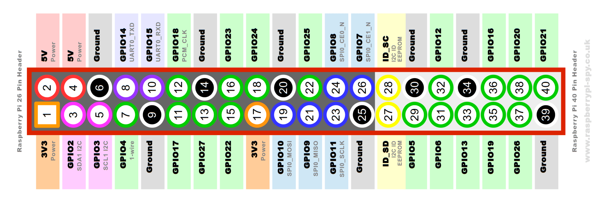

The concept of StationPi is to separate the Raspberry Pi power from the Audio HATs power, so if you feed only the RPi side where do the Audio HATs get their power?
If this is the GPIO foundation of the Audio Side of the StationPi, I don't think you will get any power without feeding J5? I think there's Data communication between the RPi and Audio HATs, but the PWR doesn't come into play. Even though DACs don't come into play, Q7 and AES do and they will need power.
For example, I use a single 26650 Battery to Power a RPi. 5V direct to RPi GPIO, 3.3V to Q3 clean side via Battery PCB 3.3V OUT. So the 5V from the RPi flows up to the Q3 which is stacked on top. Then 5V flows up to TransportPi which is stack on top of Q3, but the internal RPi 3.3V flows up to the TransportPi too not the Battery PCB 3.3V OUT. So TransportPi or TransportPiAES is optional for external 3.3V. Only when you want to plug holes do I recommend powering separately. The TransportPiAES is fully functional without external 3.3V power. But Q3 clean side absolutely needs external 3.3V PWR.
The Q7 Manual hints at some of this... I'll try to post if there's any interesting tidbits from the Q7 Manual or if I remember anything else.

Drive shaft,
Do you use a lifePo4Mini to feed the lineairePi or is it a diagram error? The opposite would not be effective? I have the same configuration as you, but personally I use the LineairePi for the 5V of Raspi/Stationpi and the LifePo4mini/Uconctionner for the 5V of the Stationpi/Q7.
I think it is better a power supply for each entry, rather than using a UConditionner for both as on your diagram.
Yes, that's correct. I use a LiFePO4Mini 6.6V to feed a LinearPi 5V.
- Mean Well Medical Desktop AC Adapters 90W 12V https://www.mouser.com/ProductDetail/MEAN-WELL/GSM90A-12-P1M?qs=1GAP6L74MtRRyqrlYfxo9w==
- LiFePO4Mini 6.6V https://github.com/iancanada/DocumentDownload/tree/master/LifePO4Mini/LifePO4Mini6.6V
- LinearPi MKI https://github.com/iancanada/DocumentDownload/tree/master/LinearPi/History
- UcConditioner 5V https://github.com/iancanada/DocumentDownload/tree/master/UltraCapacitorPowerSupply/UcConditioner
Since I don't want to have anything to do with Mains, this triple stack works out better for my use case so I did not mind giving it a shot.
LifePO4 Mini outputs are 100% isolated from the input when it’s turned on. And the on-board CC-CV charger is
also disabled in pure output mode. So theoretically the quality of LifePO4 Mini outputs will have no business with
the quality of the input DC power supply.
But since my use case was very lightweight (powering a USB optical cable), I have not pushed this stack yet.
Since this triple stack is already a Sunk Cost and I'm in no hurry to implement the StationPi, I want to experiment how this triple stack will work powering a Raspberry Pi. So that is one of my DIY goals this Summer.
Unless I can be Off of Mains in Pure Mode, this won't work for my use case. The UcPure was hope, but I have to rule that out of the equation until I can find a more power-efficient 8GB RPi that doesn't go out of voltage range. How does your LifePo4mini/Uconctionner get to 5V? Doesn't it stay stuck at 6.6V without a LinearPi?
Traditionally, this might be the case to separate 5V on each side. There has been chatter on this thread this past year about Sharing since Ian's Passive Power Supplies are getting more robust, so I want to experiment. I want to see if I can use the Triple Stack to power both sides of the StationPi with 5V. Ian also privately mentioned this may work as a solution, so I will try this out by the end of the Summer. But now I'm thinking if Ian may have overlooked that I have a LiFePO4 Mini 6.6V in the mix? I guess I'll know soon.
Since the Raspberry Pi is resource intensive, I'll get a better idea once I start testing this solution. I think my focus should be on acquiring a Compute Module 4 8GB for a more power-efficient Raspberry Pi than to find another 5V solution because of this experiment doesn't work out, the UcPure 5V is all that is left to go Off Mains.
At this point, I'm focused more on functional and just getting everything to work at this time. At a later time, if it's worth scaling than I'll adjust.
I'm okay if this triple stack doesn't work out with the Raspberry Pi as I treat this DIY hobby as a marathon than a sprint. I get to learn and I can re-use the Triple Stack for another 5V use case if needed, but I draw the line with not being in some kind of "Pure Mode" off of Mains as a solution as Ian has spoiled us. As long as I don't have any downtime from Andrea's clock, I'm willing to experiment a bit before procuring more goods.

Some Tidbits StationPi Manual:
Independent power supplies directly to the GPIO of each stack.
Connect a DC 5V input to J3 as RaspberryPi power. Connect another DC 5V input to J5 as Audio GPIO
power.
^^^ No getting away from not powering J5 as Audio GPIO needs PWR.
If this was a thing I would consider, but:
The voltage range must be within 4.9V to 5.3V. To power Raspberry Pi, rated current 2A or higher linear
power supply would be recommended for this input. Voltage higher than 5.5V (even at short time) may cause
damage to UcConditioner.
UcConditioner doesn’t regulate the voltage. The output voltage will be as same as the input voltage. So, the input
voltage must be within range of 4.9V to 5.3V. If it is lower, the UcConditioner will not go to conditioning state. If it is
higher, the ultra capacitors can get damaged or reduced the life time.
So I have no idea how if you are feeding 6.6V into a UcConditioner 5V directly would this work? I'm open to this solution, but this never crossed my mind that this can be done.
