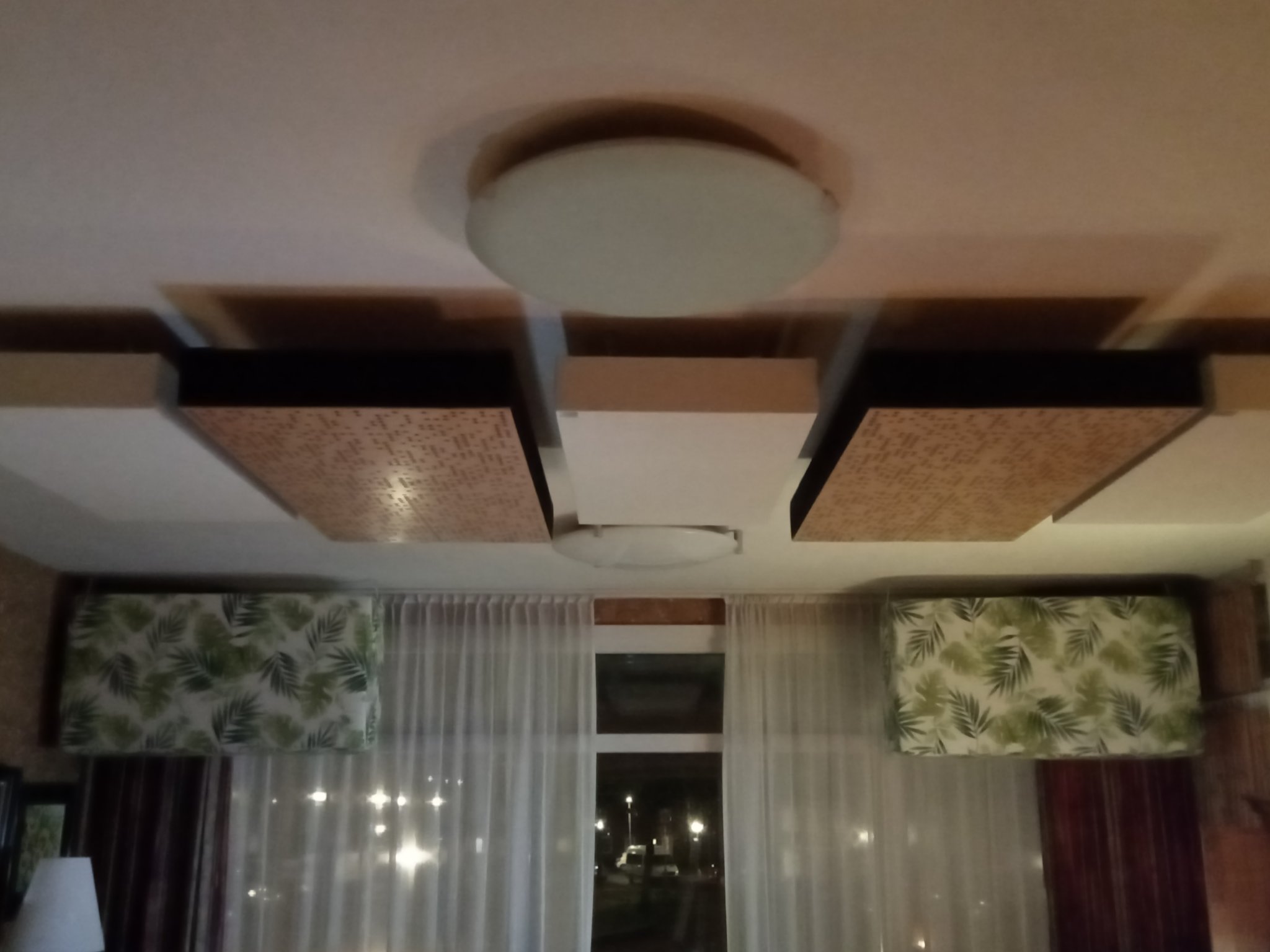

You have a wonderful wife who would accept you adding something like this to the ceiling. 😂Hello,
Suppose you would go on a nice two week vacation and during your absence an audiophile friend with access to your mancave would exchange the clocks would you notice it?
I remember enjoying a nice high efficiency system in a tropical country. Before leaving i asked my friend if i could take some pictures and then i noticed the transparent speaker cables were at least 80 % of the surface tarnished.

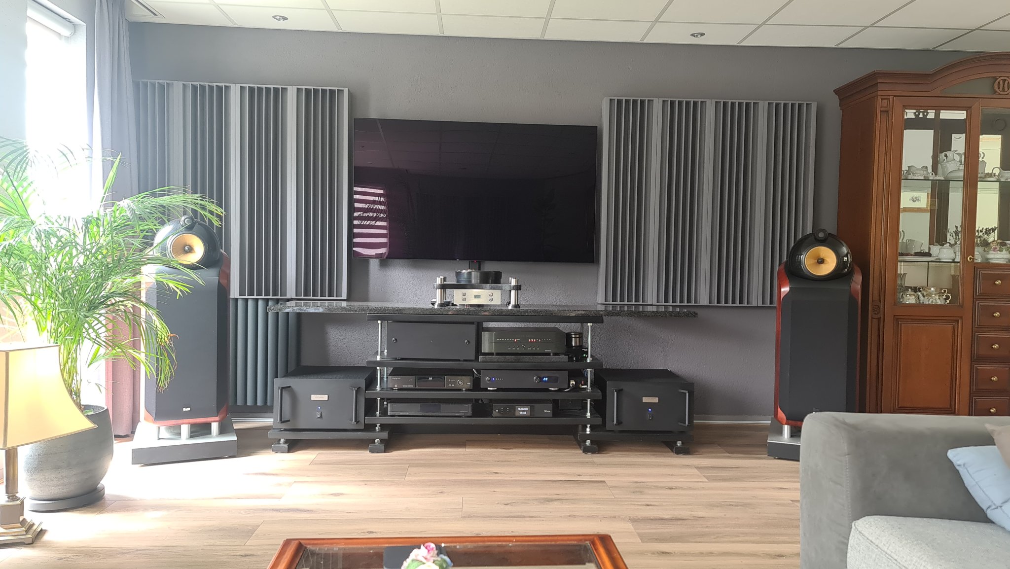

The last few months i installed some diy bass traps after putting some acoustic panels on ceiling and side walls. I am sure the latest clocks from Ian will be better with bass traps then the sophisticated Italian clocks without the traps.
For 1000$/Euro you can get a pretty impressive improvement by installing some panels. Almost every cinema, theatre will invest time and money in acoustics and they already have the advantage of having a big number of human bodies inside.
It is pretty easy to achieve some improvements with just some basic materials. These black foam egg crates don't work for us
The ones with the leaves printing on the outside are the bass traps. In order to be effective they need to have some volume.
The perforated ones are a bit difficult to diy but the white ones is just a wooden frame with some kind of rockwool inside covered by some fabric.
Greetings, eduard

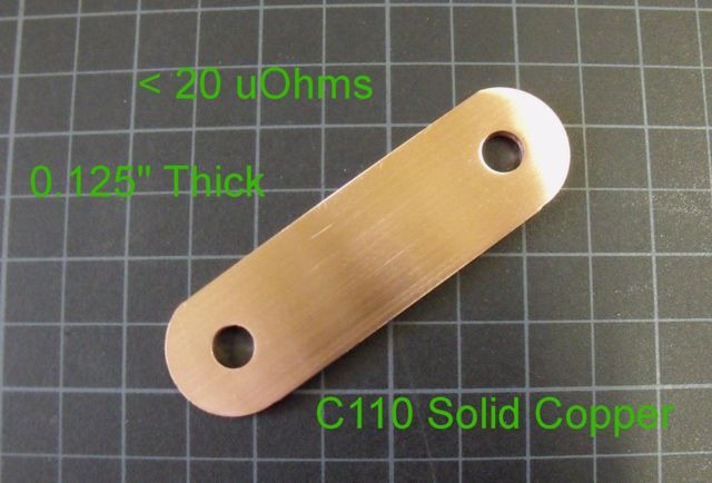

I'm trying to cut Cooper Bussbar in (2) Cooper Washers as sets of M12 Cooper Washers are too expensive at this time. With the UcBalancer available to order in GB2023, Cooper Bussbars are not needed anymore so it's a no loss proposition. I'm glad we can agree on Nylon M12 Nuts at least. So we have similar end goals and safety concerns, just different ways to get there. Good Weekend.

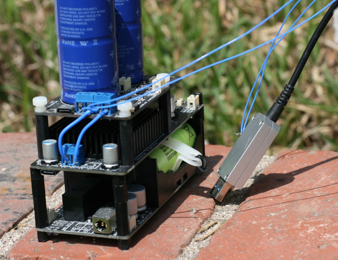

Hi @iancanada , hello @Gabster 2000, hello world!
I've got a very similar question like BMW850. Here is what Ian's link shows, which can be also found in some of the documents of his modules:
C. Flagship RPi I2S/DSD network streamer transport
1. HdmiPi Pro (#17B) or TransportPi AES
2. FifoPi Q7 (#1D)
3. StationPi SMT (#35C) OR Pro
4. LinearPi 5V(#32A)
5. UcConditioner 5V (#25A)
6. LifePO4 Mini 3.3V (#42A)
7. UcConditioner 3.3V (#26A)
8. MonitorPi (#49A) or Pro
For 6 and 7 comes the new UcPureMkIII.
The manual for the StationPi Pro states, that there are 2 inputs for 5V, one for the Raspberry Pi (dirty side), and another one. For which purposes are the (other, cleaner) 5V used or meant? (If e.g. clocks are using 5V, then a UcPureMkIII would make sense.)
Which power supply would then be ideal to power the Raspberry Pi? The listet LinearPi 5V?
Is it capable of powering a Raspi 4, because it's max I out is 2,5A?
If the LinearPi 5V can power the Raspberry Pi, this should be really top notch, or does an additional filtering has other benefits which could improve the streamer's overall performance (RFI, noise, xyz)?

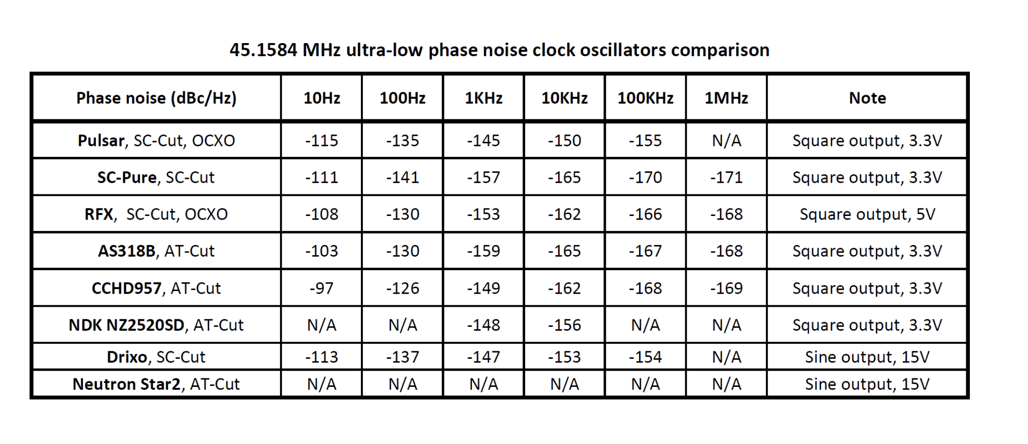

Hi Ian,My setups are:
FifoPiQ7 with Pulsar 90/98MHz OCXOs, UcPure 3.3V for the clean side
ESS9038Q2M Dual mono with three 3.3V LifePO4/UcHybrid power supplies
OPA861 I/V with dual LinearPi 5V + UcConditioner 5V
I'm really happy with the sound quality. I listen to this system everyday as my reference setup.
