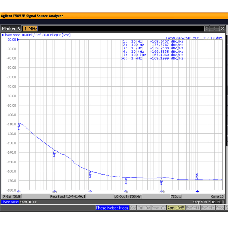

One clock i tried with very good result and very low phase noise,and drop in replacement. https://www.aliexpress.com/item/100...dfa33090f41cbb78fffb26c2a240d&ck=in_edm_other

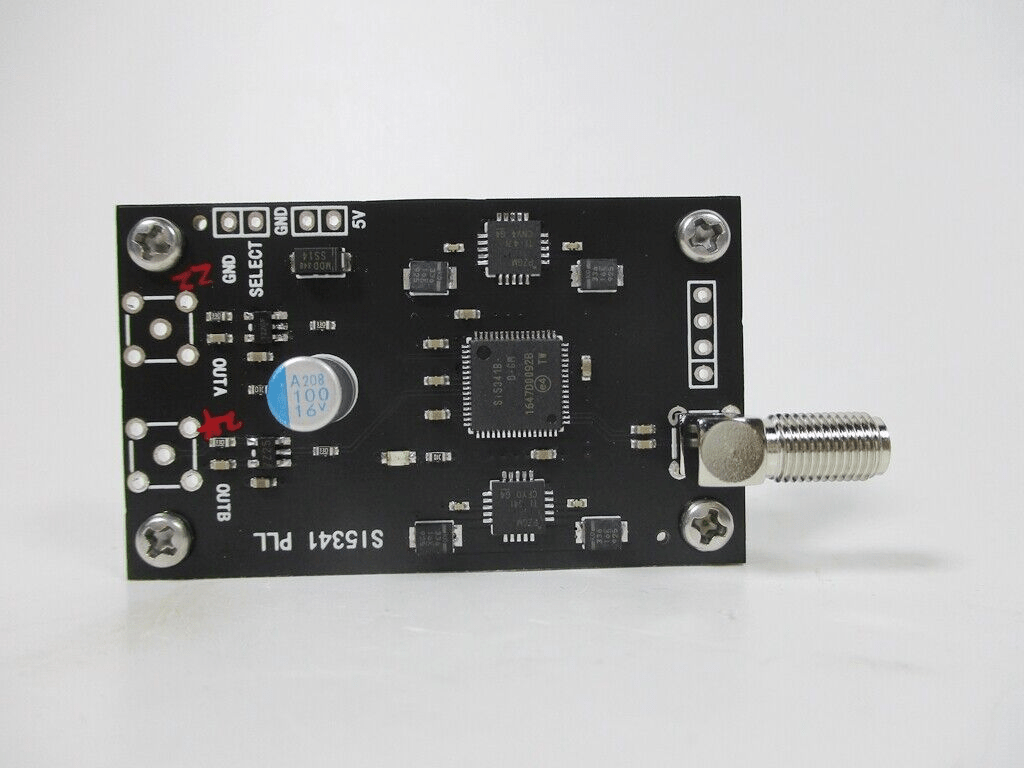

Another way to go if you have Symmetricon sattellit GPSDO with antenna 10mHZ input,PLL card and sinepi.Still have it in my drawer,but going to try soon,also put low pass filter before input card minimise jitter.But mayby the PLL card create to much jitter,but you never now the sound until you have tried. https://www.ebay.com/itm/3144932361...55&cnvId=700003&recoId=314493236152&recoPos=5
