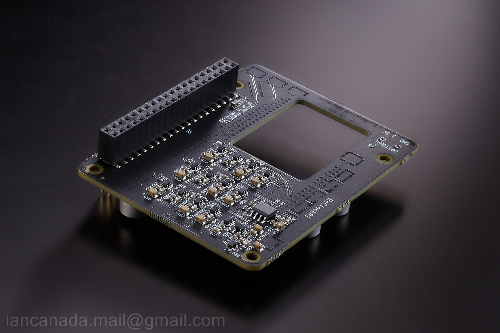

ReClockPi SCK signal quality and measurement
Please find the attached measurement results of ReClockPi SCK signal quality
1.RcClockPi SCK waveform
Same as RcClockPi LRCK, the SCK signal is almost as an ideal square wave. Rising/falling time only 0.9ns. Rising/Falling edges are super clean. No any ripples on both high and low logic levels. That ensures the lowest possible EMI noise will be transferred into the DAC along with the LRCK signal. It’s the newly designed discrete logic circuits that results in this low noise re-clock performance.
2.ReClockPi SCK time jitter
ReClockPi SCK time jitter was also reduced to a best possible level when upgrading a FifoPi with a ReClockPi.
When playing a 88.2KHz music, the FifoPi Q3's 5.6448MHz SCK signal RMS jitter was 6.78 ps. After a ReClockPi was installed, the same 5.6448 MHz SCK signal RMS jitter had been reduced to 3.76 ps. That’s a very big improvement. It would be great news for those DACs that rely on SCK for the performance, such as ESS DACs, TDA1541 DACs, DDDAC and many others.
3.Calculated phase noise plot.
When converting the RMS jitter into phase noise, the SCK phase noise plot was also very promising. Though in the real world, it’s impossible to get -6dB improvement at each time divided by 2, but this calculated RcClockPi 5.6448 MHz SCK phase noise plot could be the best SCK phase noise I have ever seen. Down the road, when replacing the CCHD957 with a better XO or OCXO, there will be still more room for new improvement. Please note that the integration bandwidth was wide from 0.1Hz to 1MHz.

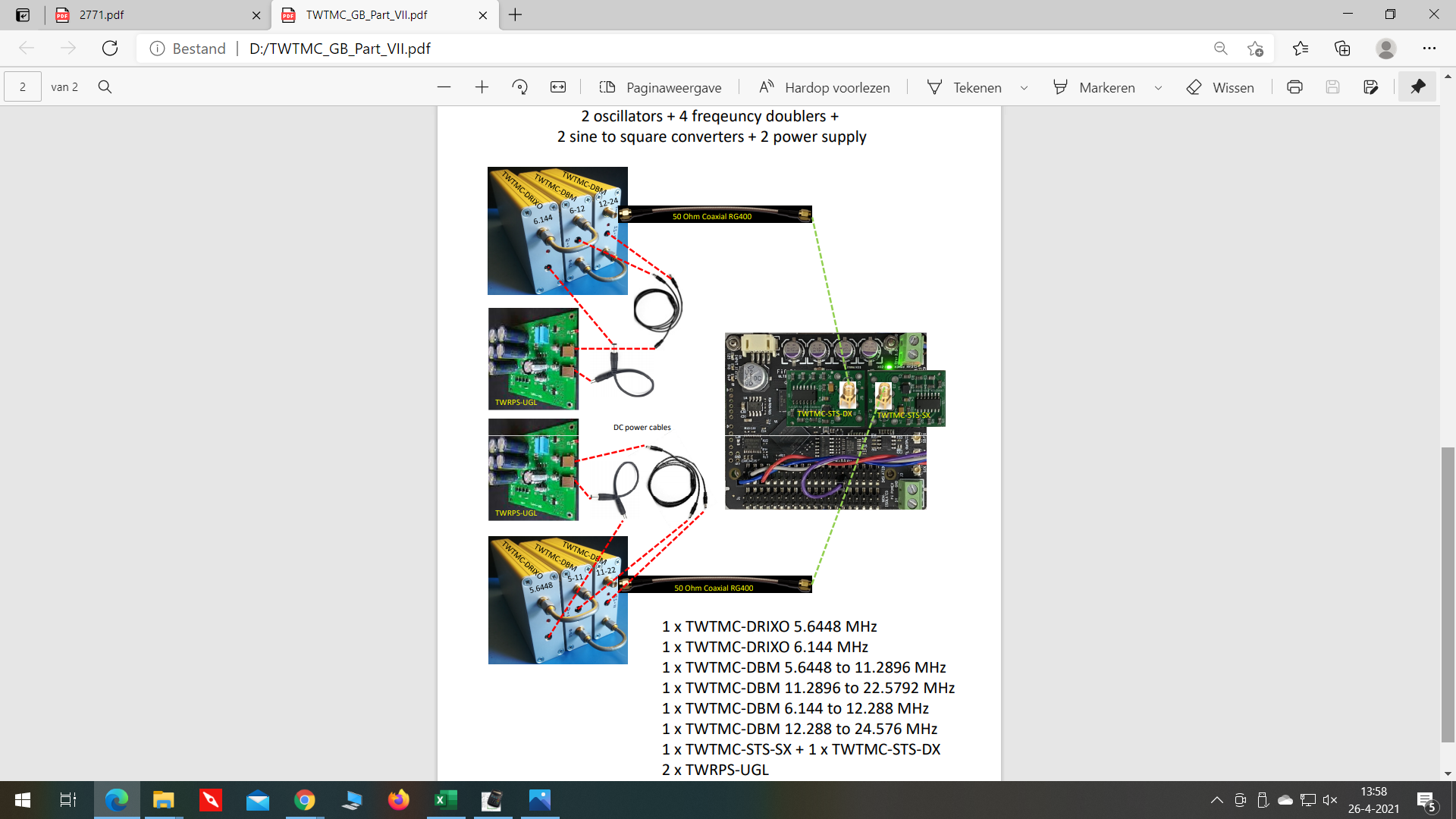

I will go for what seems to be state of the art clock circuitry as posted in the attachment.

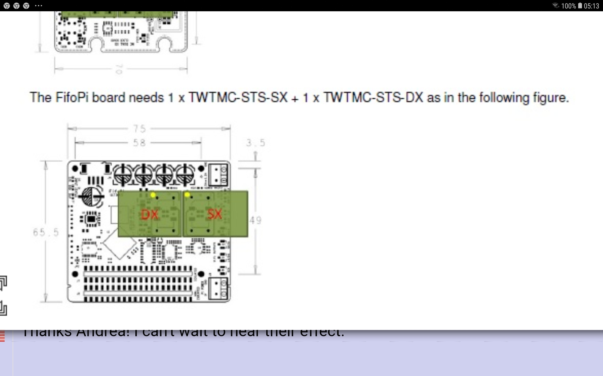

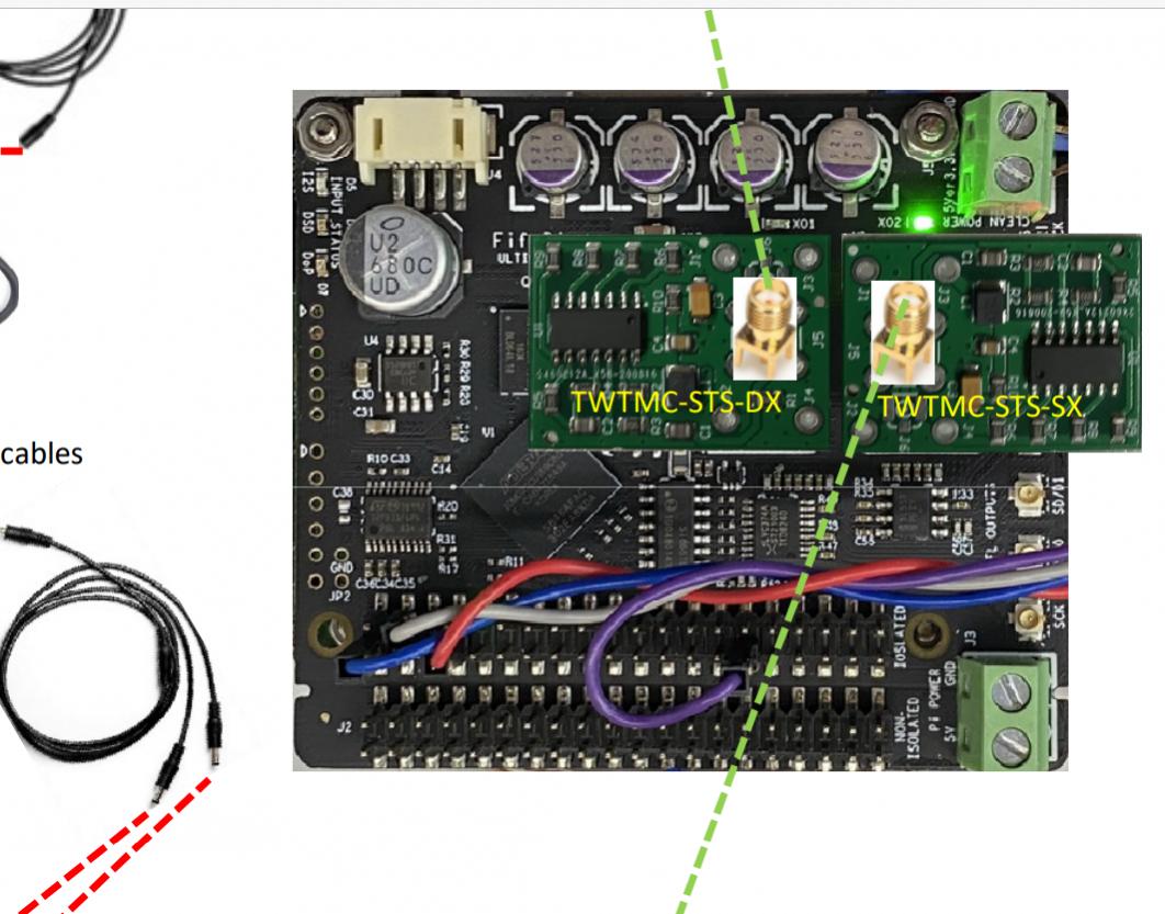

Can i physically combine the latest reclock pi board and still mount the two tiny boards from Andrea. Or do i need to adjust some mounting hardware?
Will i need the so called '' mini circuit transformers kits '' from Andrea? Do they provide galvanic separation?
Will i need a TWTMC STS FSDO F or S board if i will use the
IAN CANADA FIFOPI Q3 ULTIMATE FIFO Reclocker Module PCM 32bit 768kHz DSD1024 DoP ?
Greetings, eduard
