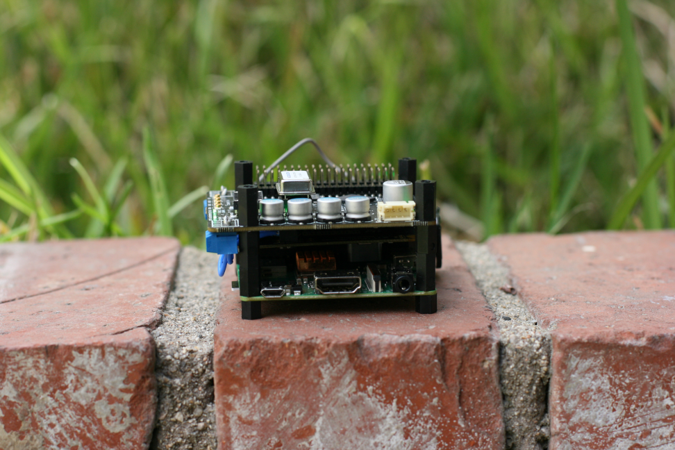

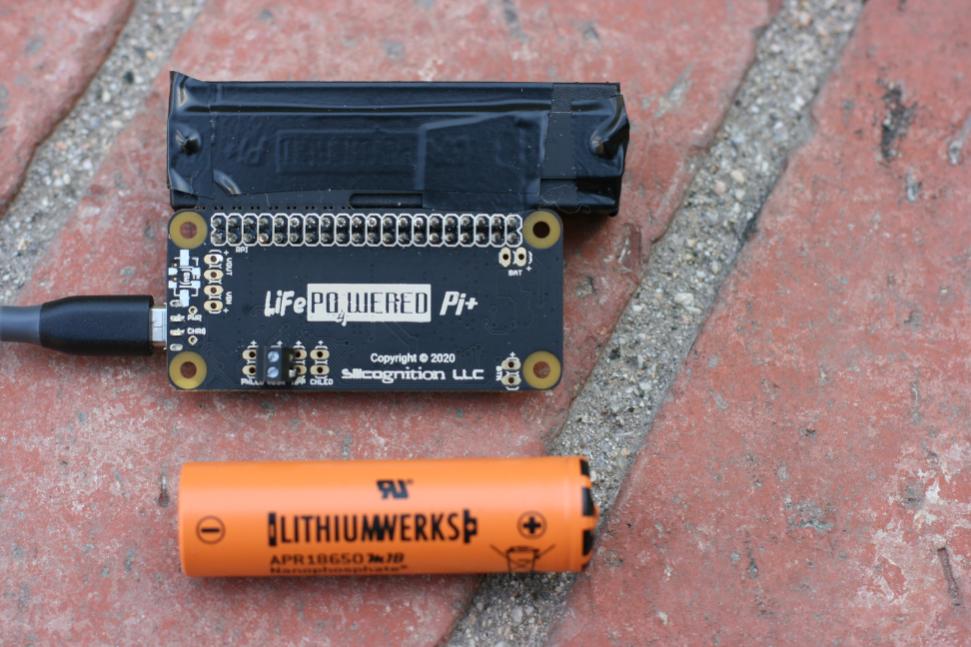

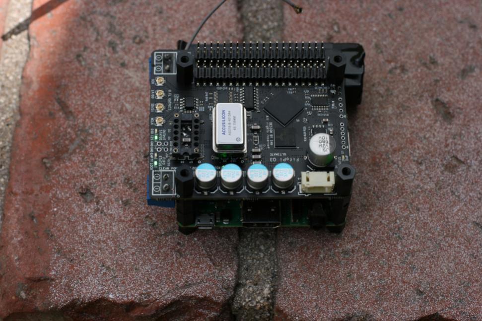

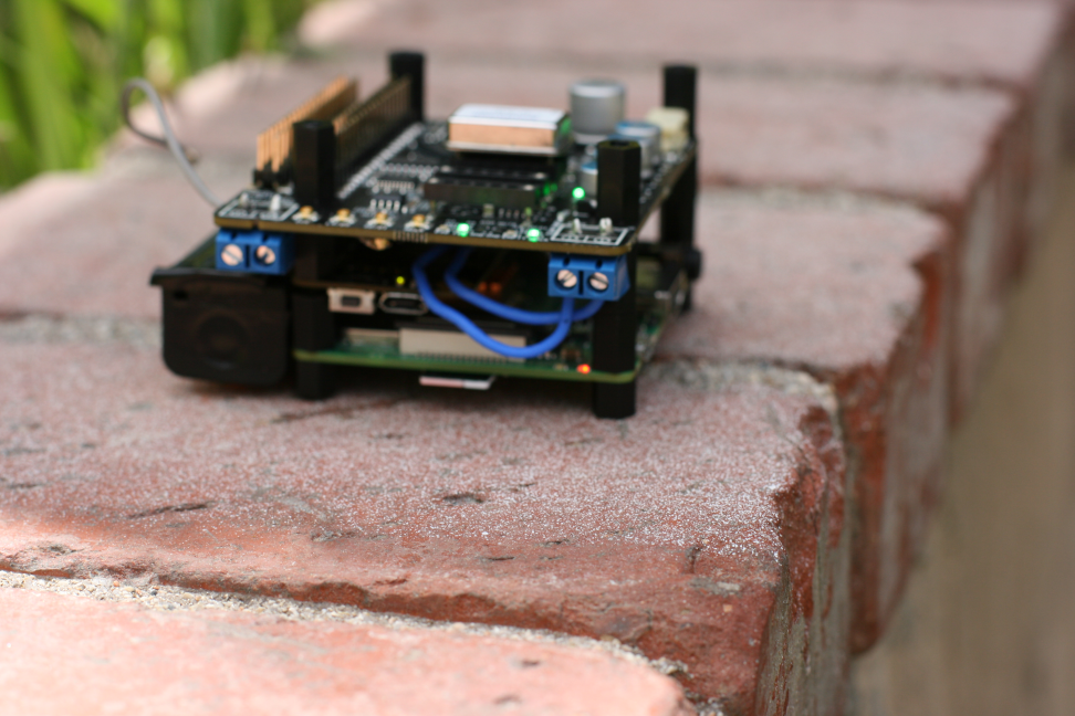

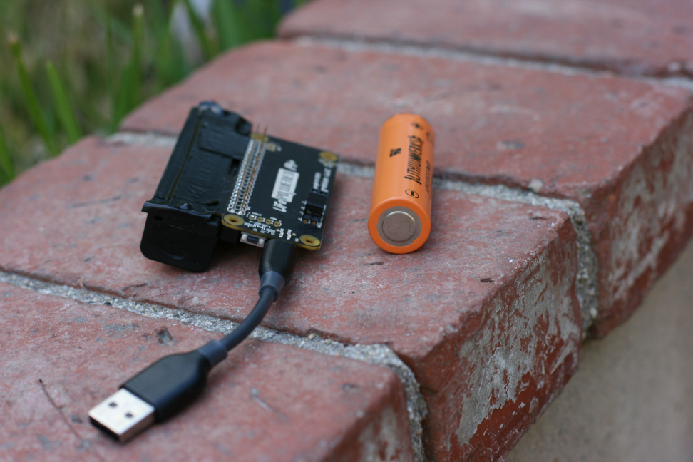

I know it's hard to grasp a portable Q3. Here's some photos to get a better idea.
I'm using a LiFePO4 BMS + A123 18650 battery + RPi 3A+.
The soldered terminal on the BMS is for 3.3V. The Q3 gets 5V via GPIO.
You can see the solid core silver from the side. It doesn't stick out and stays within the Q3 parameters.
The TransportPi (not shown) has only HDMI and TOSLINK. The others are removed. It's minimalist.
If this was my only Q3 build, I would be more than happy. Especially with RCP added. But it looks like I'm going FiFo desktop too.
My first attempt used 5 pairs of solid core wires and a A123 26650 battery. It got too bulky and complicated, so I settled for simple. This build just one pair of wire as shown.
With a 1TB microSD full album WAV redbook, I can just throw the Q3 in my loose shorts and a Chord DAC is my fitness belt connected via glass optical cable and control via IR remote. I just use bedside for now, but after pandemic will take it outside for walkabouts. I can also control via iPhone via hotspot on 3A+.

It's a really good idea to move the FifoPi Q3 power connectors that way. Very smart idea!
