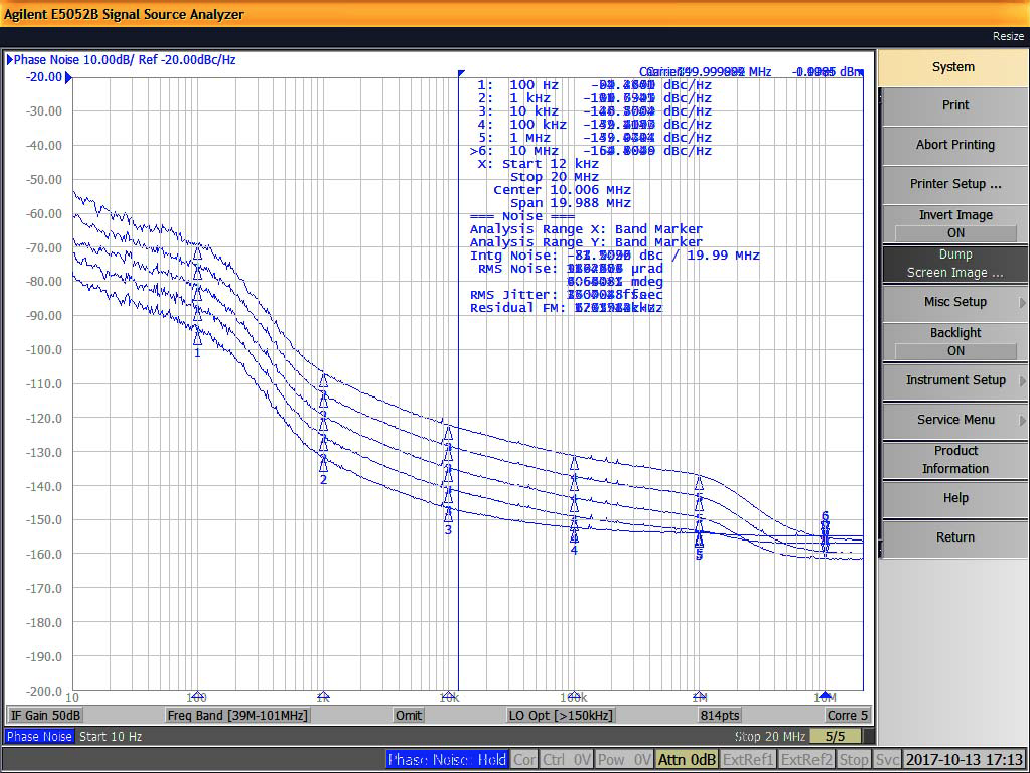

... i don't really want to argue because my grasp of the topic is surely inferior to yours, but
Analog Devices says the contrary, i remeber i had red a FAQ on their site.
searched back again and reported here for convenience :
Q : If jitter can be calculated from phase noise measurements, is it possible to calculate phase noise from jitter numbers?
A : No. Only the total integrated phase noise power over the bandwidth of integration can be calculated from the jitter number. The shape of the phase noise spectrum, and the offset limits used, are lost in the calculation of the phase jitter.
If jitter can be calculated from phase noise measurements is it possible to calculate phase noise from jitter numbers? | Analog Devices
... is it opinable ?
@gionag
I understand what’s your concern. I thought I described the principle. Now just let me make it more clear.
MCLK is the parent clock. SCK is the child clock which was divided from the parent MCLK by a high speed synchronized logic and finally generated at the last flip-flops re-clock stage. I used a 22. 5792 MHz CCHD957 as the MCLK in the test, so that SCK for 88.2 KHz music was the MCLK divided by 4.
There is a 20log(N) rule which means If the carrier frequency of a clock is divided down by a factor of N then we expect the phase noise to decrease by 20log(N). So each time MCLK is divided by 2, the phase noise plot will be improved by 6dBc/Hz. The whole phase noise plot will be shifted -6dB down with integration RMS jitter kept the same.
Timing 101: The Case of the Jitterier Divided-Down Clock
However in the real world, there is no ideal divider. A good high speed discrete flip-flop chip normally has around 1ps additive RMS jitter (can be better with carefully designed PCB trace and really good low noise power supply). So, the phase noise plot of the child clock will be traded off and the shift will be less than 6dB. That’s why we need to estimate the phase noise from jitter to figure out what's the real case and to confirm.
With this principle, to estimate the phase noise from jitter, we need to shift the MCLK phase noise plot lower to make sure the integration of RMS phase jitter is equal to the RMS time jitter. Have to use the integration bandwidth as wide as possible to make the result more accurate (I use 0.1Hz to 1MHz). If necessary, make some compensation to the noise floor.
The disadvantage of this method is that the estimated phase noise floor could be better than a real phase noise analyzer because the phase noise calculator doesn't have a physical input noise limitation. However the good thing is that the close-in phase noise estimated result will be more accurate because the close-in phase noise weights much higher than the noise floor to the final RMS phase jitter result. Yes, there is no perfect way to get the phase noise from time jitter. But for me I think this method is pretty acceptable.
Ian
