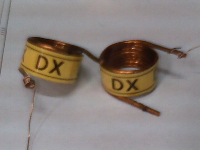

Internal diameter - 5 milimeters
External diameter - 7 milimeters
Wire diameter - 1 milimeter
Coil length - 17 milimeters
Number of turns - 15 plus half and plus half...this represents 16 turns
Inductance - aproximatelly 0.692 microhenries (692 nanohenries)
Resistance in paralel was increased to 15 ohms, 18 ohms or 20 ohms / 5 watts... can be a coiled wire resistance.
During tests i have used the coiled wire resistance of 18 ohms and 5 watts...some inductance is provided by the resistance windings.
Blue boards have holes into the coil position, that accept 1 milimeter coil wire without problems.
regards,
Carlos
my coil just recently made 😀

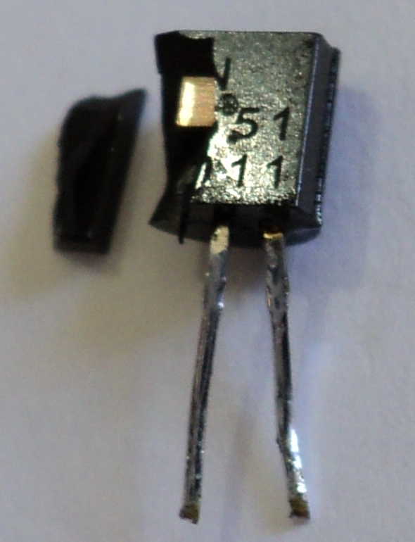

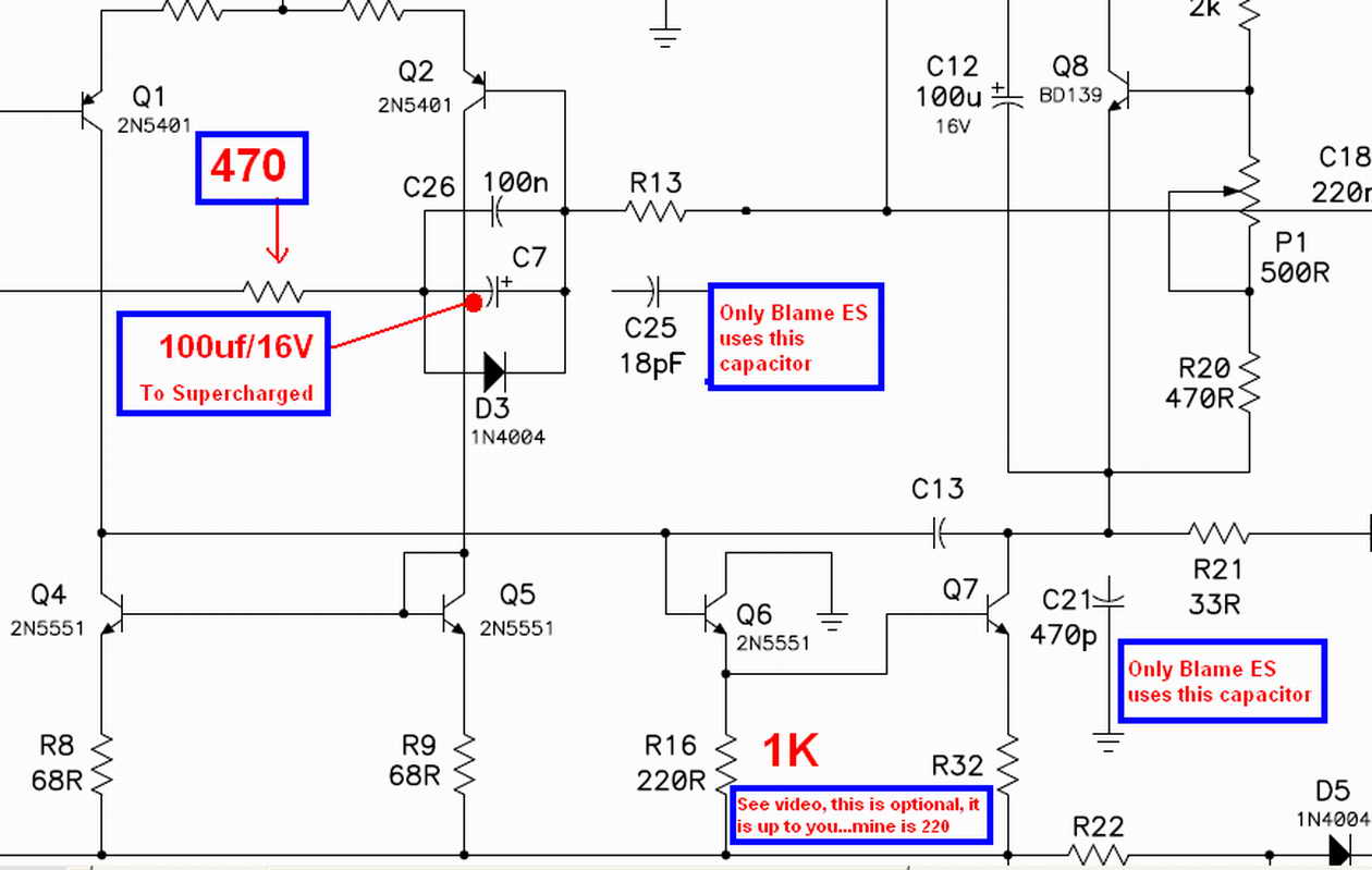

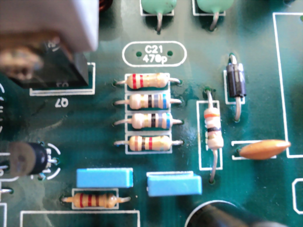

ATTENTION please!.... first VAS emitter resistance increased
back to Doctor Self original value.
By the first time i had a transistor burned, was a ground disconnected from an active filter that produced huge hum... the transistor exploded... first time...but seems the resistance should be increase.
Some folks have said that...but real life test have not proved to me that need, nor simulator and nor calculations...but now, no doubts must be increase to 1K or even bigger value.
Only the first VAS, the 2N5551 was destroyed... this resulted in an open circuit there, i had huge off set and speaker fuse have protected the speaker... after replacement all worked fine
regards,
Carlos

it would be better to add a collector resistor rather than increasing the emitter resistor.
Increasing the emitter resistor increases the degeneration of that transistor and reduces the gain of that stage.
Adding a collector resistor has the effect of reducing the working Vce of the transistor and has very little effect on the amplification of the stage. Ost chose a very low value of collector resistor (220r) because the simulator told him that gave the least effect on distortion.
I think it can go upto 1k to 2k with little if any effect on the sound.
When the fault condition occurs the Vce drops massively to reduce destructive power in the transistor. A larger value of collector resistor provides more protection. But it must remain small enough in normal operation that the transistor has adequate Vce to amplify as intended.

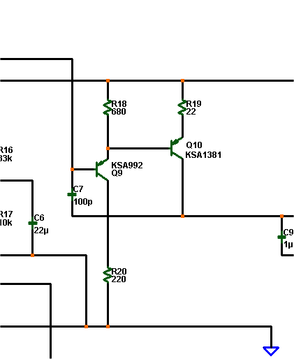

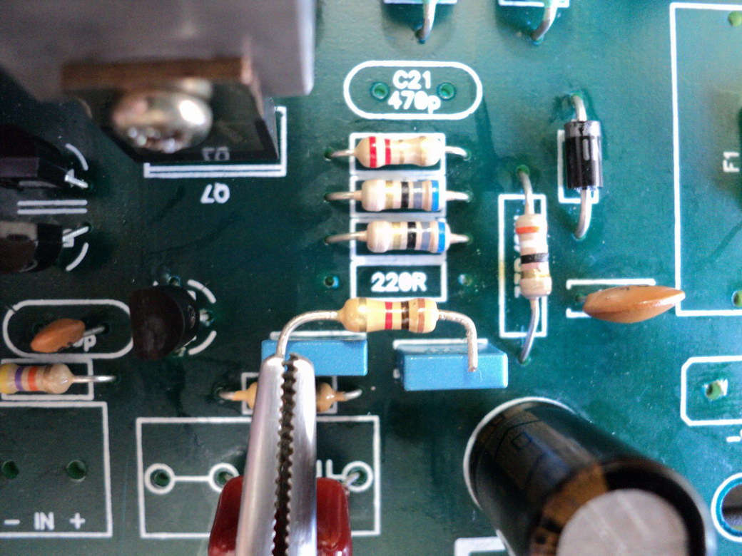

Back when I designed my clone , I had my "first VAS" get warm after clipping for long periods in the "doghouse" . It never let out magic smoke , but something had to be done to make it "bulletproof" (below). With 680R = E / 220R = C , 45V rails tests could not even get the device warm and my original specifications were preserved. I can't test for 75V rail clipping (too much for my load), but all devices stay cool even with heavy use.
Don't feel bad , I smoked a few trannies ... oscillated with wrong resistors , even put a device in backwards. 😱 We live and learn !
OS

Allright Ostry..thank you.
I am suggesting Supercharged builders to use a small heatsink to the second VAS..i have increase the first VAS emitter resistance to 1K (Dr. Self original blameless value)...and people can cut a small piece of thin aluminium foil (0.5 milimeters thick) to fix into the MJE15032/15030 or other model from this series)
A hell transistor these ones...well, at least the ones i have are very different in gain.... PNP is twice the gain of the NPN....grrrrrrr!

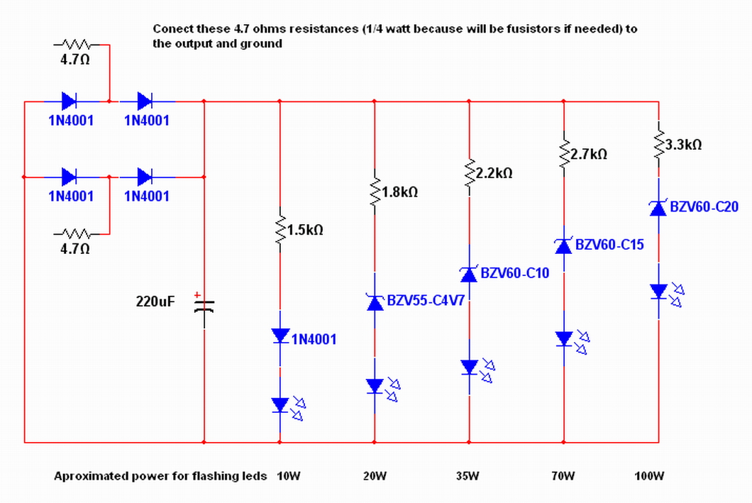

Playing with flashing leds and informing last and final modifications to the
Supercharged....
Gain resistance (R13) was decreased to 470 ohms in my home to match the satelite receiver...original is 1K...it is in series with the 330/470uf electrolitic...but i found much better to use 100uf..sound was more precise, more clean...better!...i found 470uf there sounding undefined...bass loss the punch...was strange.
Also here you have the flashing leds toy:
http://www.youtube.com/watch?v=1R4RLM6wFBYMore youtube links to come soon.

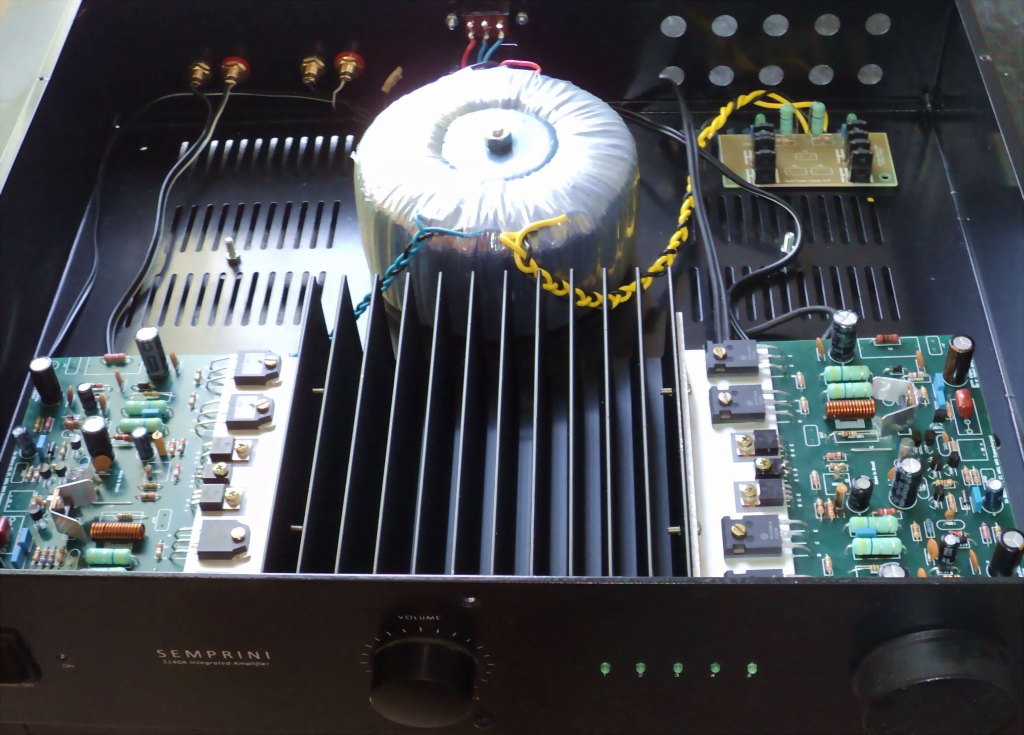

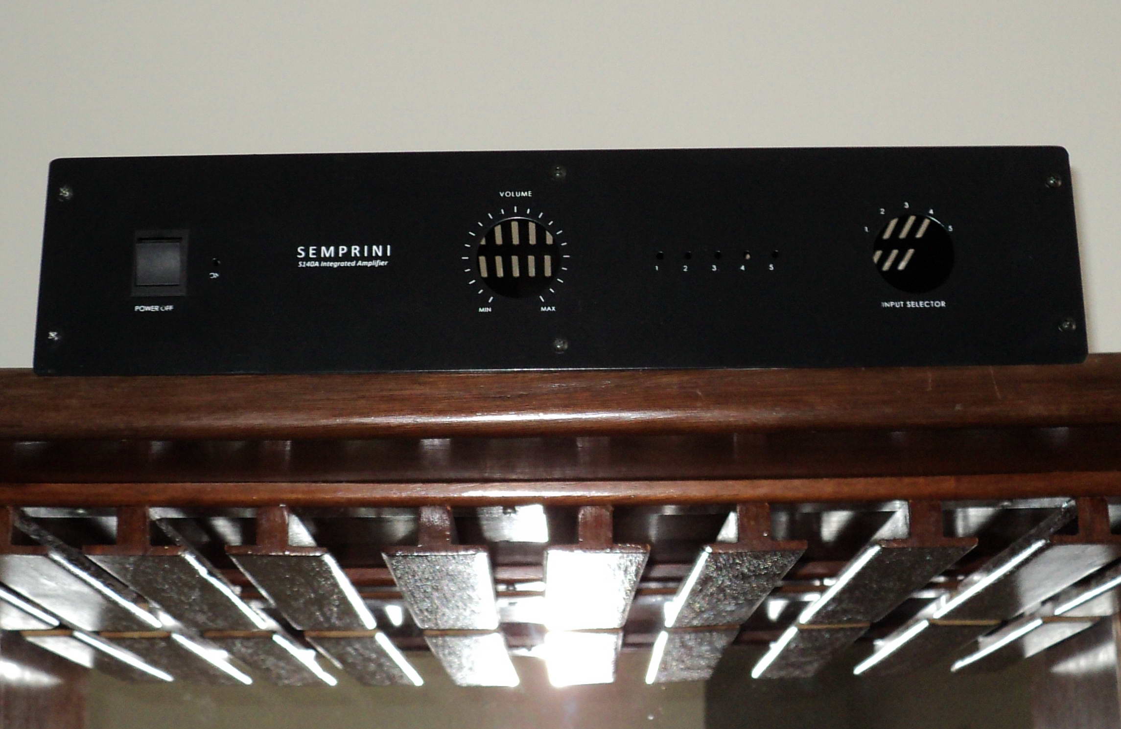

Here you have Bigun....not a very good idea but i could use
the enclosure i could find.
I am just starting....studying positions and cables...anything interconnected...just posted in place.... the filters was missed and some details..i am still waiting knobs from China, and input golden RCA.
This one is to my own use....usually i build to myself or family... sometimes to special local friends...these ones you know 30 years long.

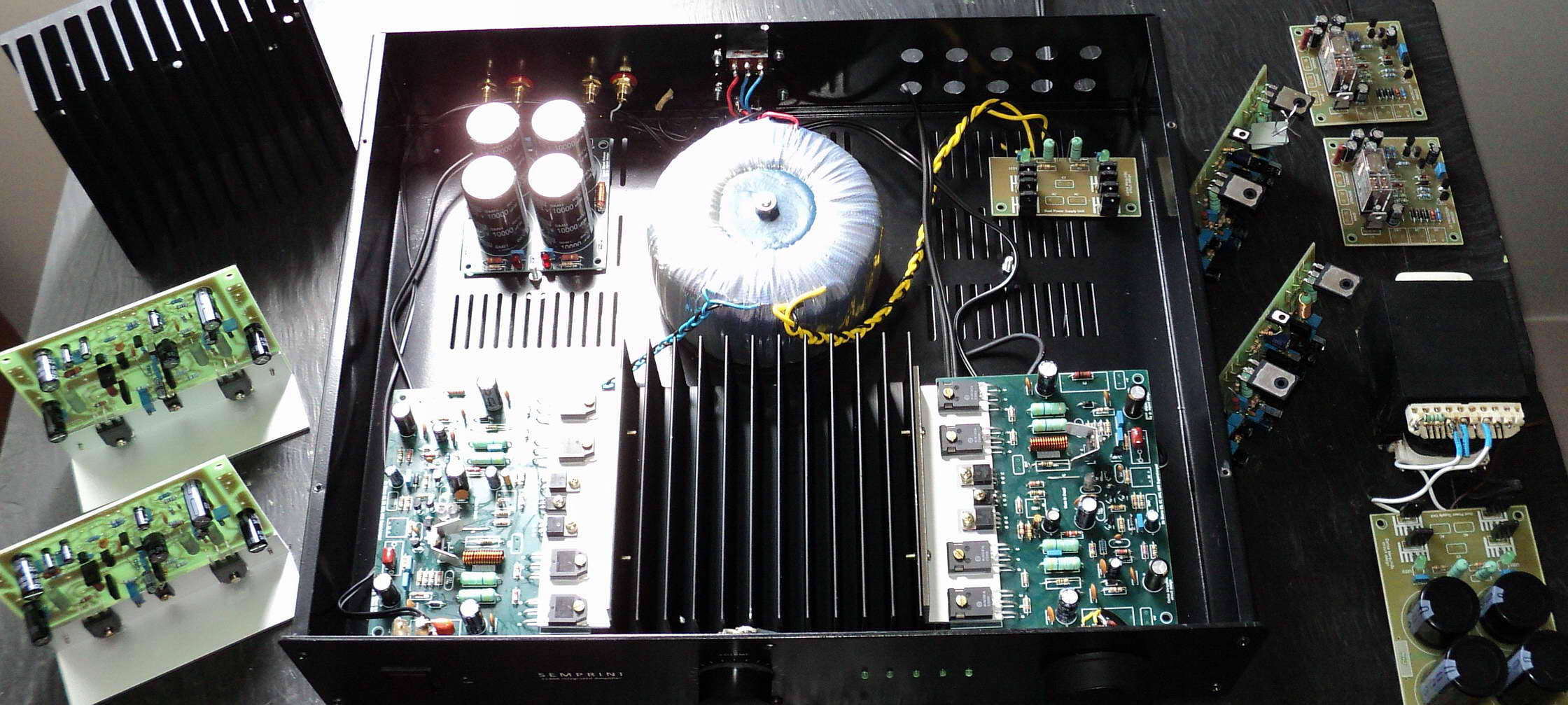

My transformer is a 550 watts unit....so, i can produce 370 watts of audio
draining full power from this transformer....but i will use 8 ohms...so, it will put out 100 to 130 watts rms to each channel.
Filters are only 30 thousand plus 30 thousand microfards to another Supercharged...this one will have only 20 thousand plus 20 thousand.
I have another 2 cases. one for another Supercharger (boards already assembled and tested), and the third one will go to a Dx Blame ST (brazilian green boards... i still have tob find another fourth enclosure to the Dx Blame ES (board assembled and tested) the one without " L " adaptor.
