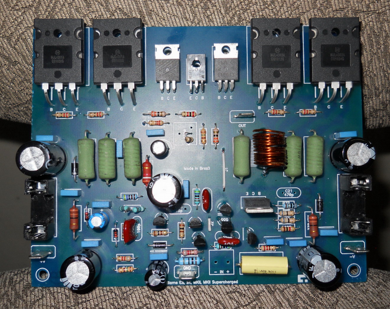

I like the way you have used the "area" under the output devices to run the various traces.
I like the much closer spacing of the +ve, -ve and Pground.
I wonder if radial emitter resistors would reduce the PCB width and output device spacing even more?
I do not like the feedback tapping off the wrong end of the output rail.
This has the potential to become a smaller and better performing PCB.

zharmo it is nice PCB, but feedback point should be as close as posible to the output.
This is according Self and as this is something as "blameless". Read Self book about how mutch distorton increases if FB was taken from wrong place on PCB.

Wonderful pcb.
A possible solution is moving the point where the output is taken to the point where the feedback is taken. Then use the resistor-coil combo at the output to take the output to the right side of the pcb again.
I believe with a bit of pcb-trickery this can be done.

The L//R part of the Thiele Network does not need to be on the PCB.
I believe it is better to locate the L and it's magnetic field away from the PCB and away from the metal chassis panels.
The first Zobel part (R+C) should be located very close to the output devices to minimise inductance in the HF return route.
Good point.
When placing the L//R part offboard,one can use wire-jumper(s) to take the output to the right side of the pcb.

What are the advantages (disadvantages) of those 1N4007 paralleled with OPs?
They do not appear in the original schematics.
Consider the reverse biased diode at a relay coil. The speaker is a much larger coil (back EMF). The 2 diodes shunt this EMF to the rails , sparing your outputs the abuse. Fast switching , 3 amp diodes are good for this purpose. 🙂

As OS said... in my boards I used 1N4007 near Collector-Emitter outputs pins.
See photos in these posts:

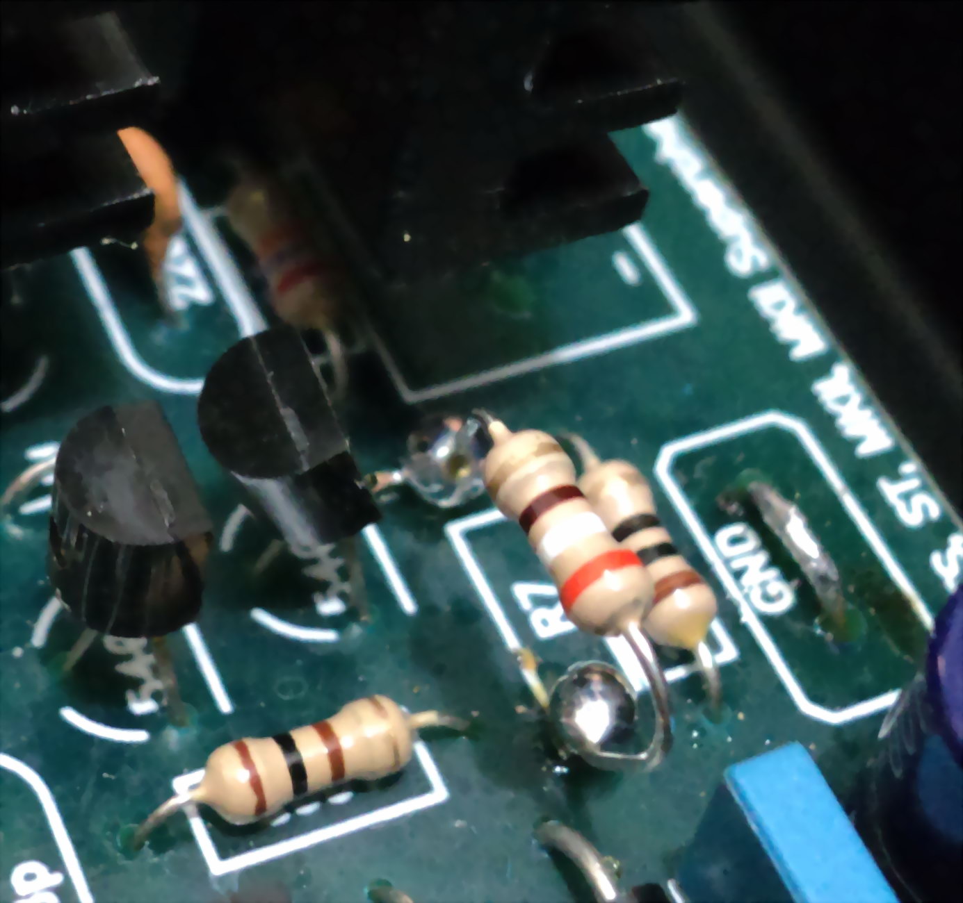

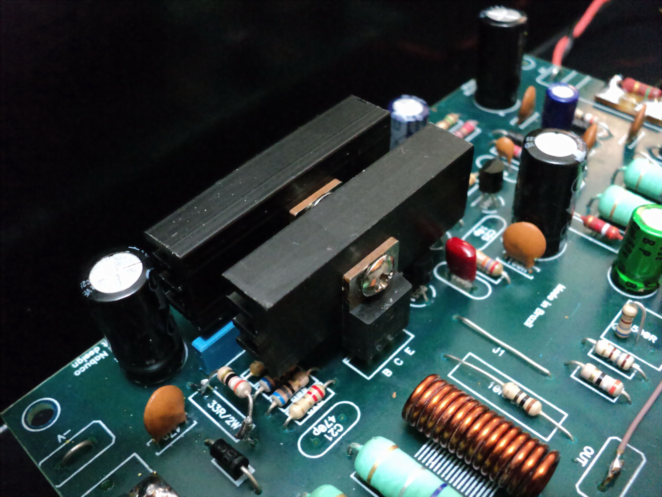

Boys, please, use heatsinks to both VAS transistors and use
Big transistors in this position.... something alike MJE15032 is fine.
If you want to push above the limits you can increase the Supercharged sensitivity replacing R7.....try 390 ohms.
Was tested full power over 4 ohms speakers, both channels operating into clipping.
