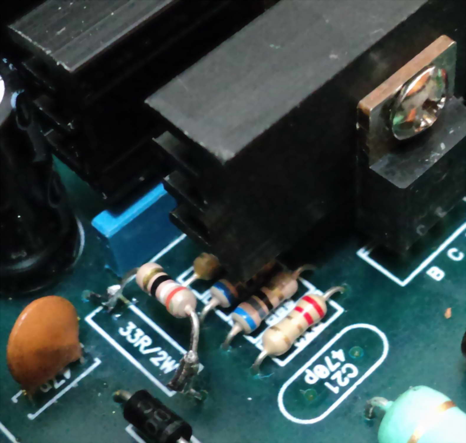

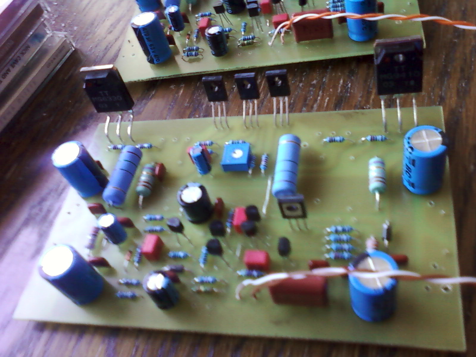

Are you ready to face strong emotions?.. Dx Blame MKII and the Supercharged release!
Supercharged blue boards already have higher watt resistances in the
rails....so, main change is to use MJE15032 in Q6 place and the use of heatsink for both VAS transistors.
Watch the picture....i had mo high watt resistance to use...you see 1/4 watt unit
regards,
Carlos

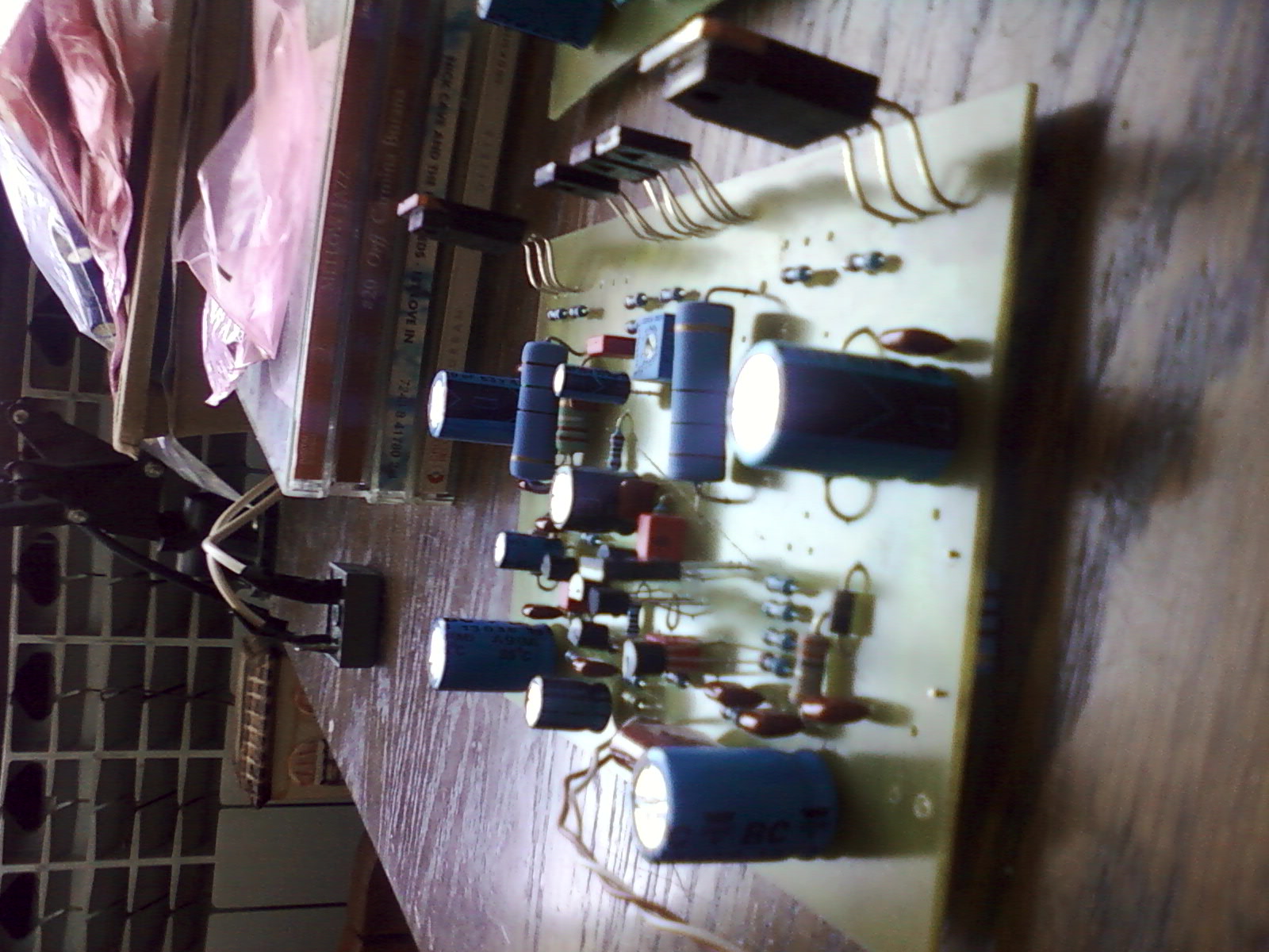

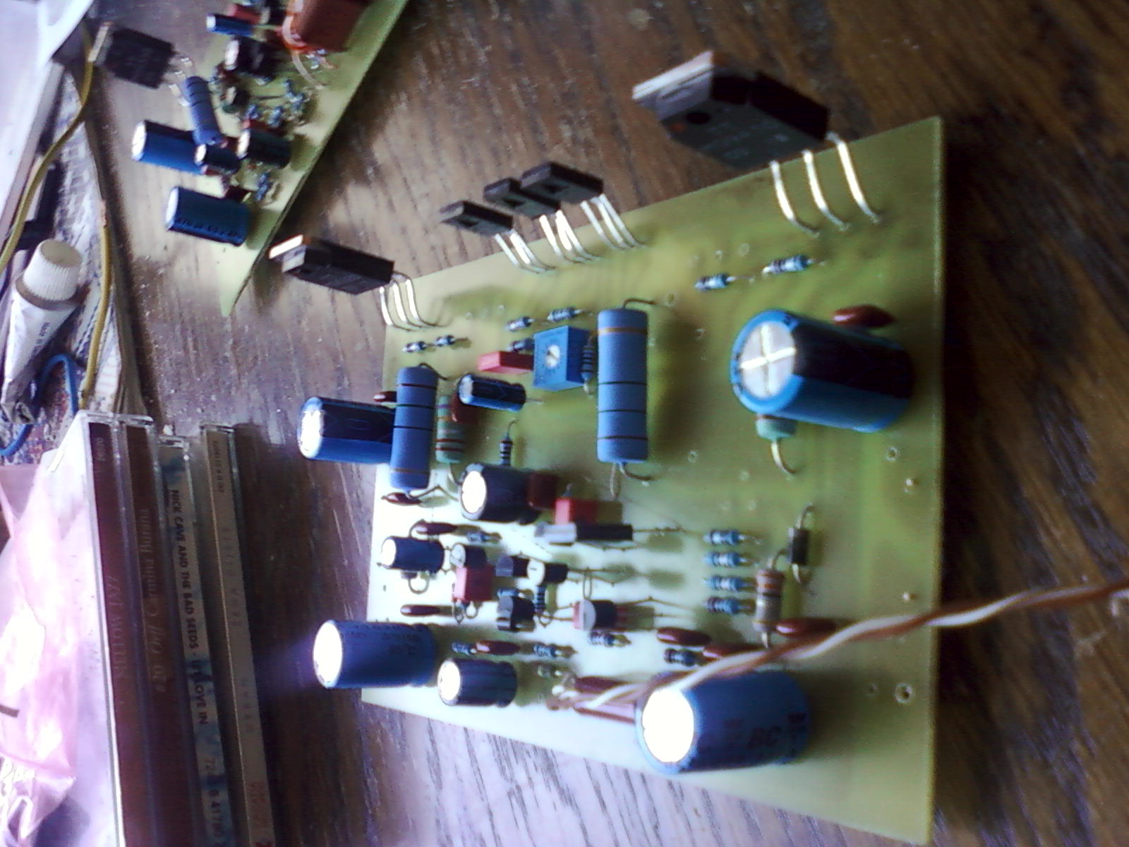

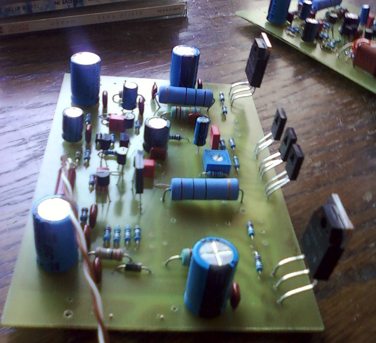

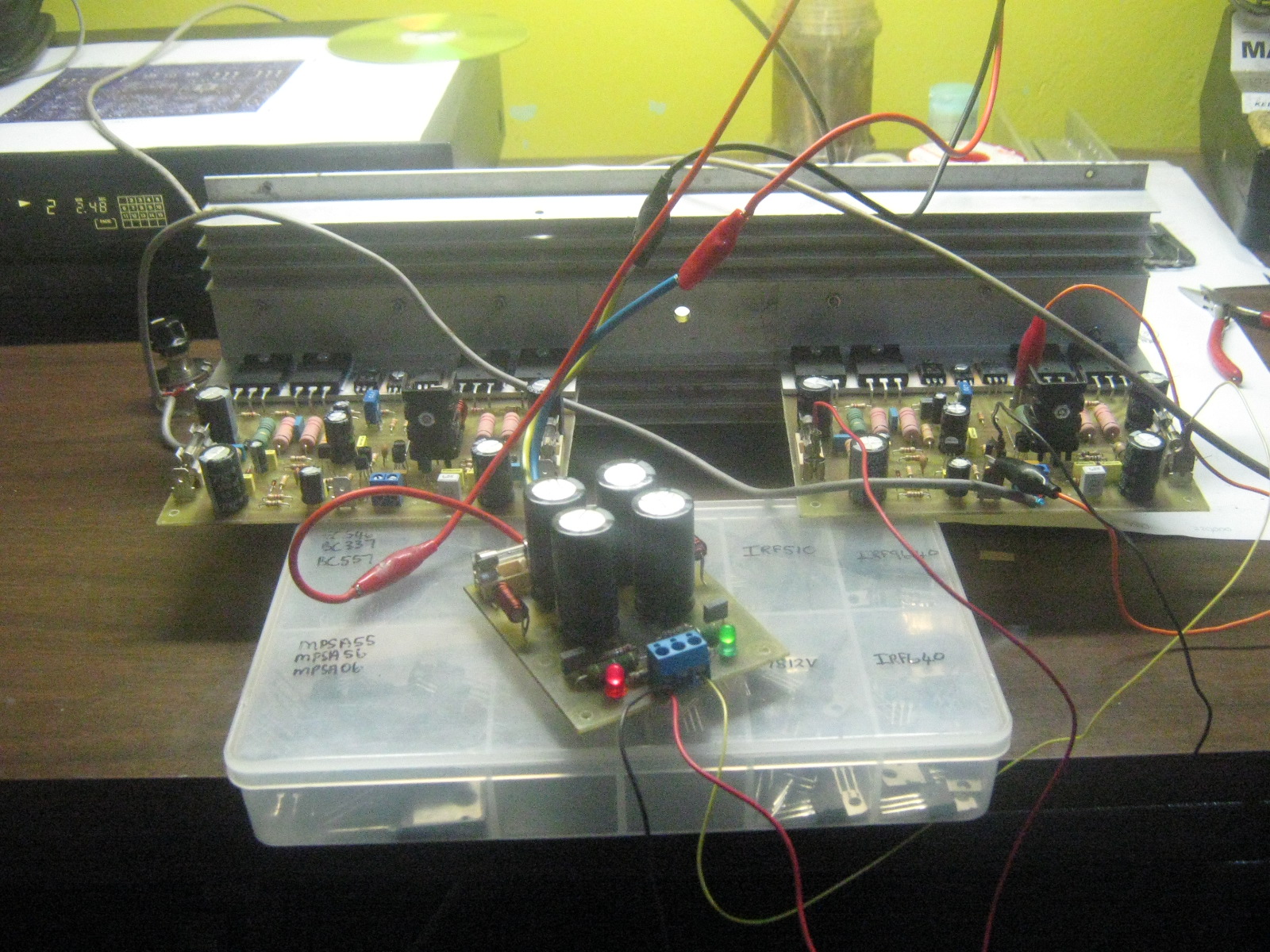

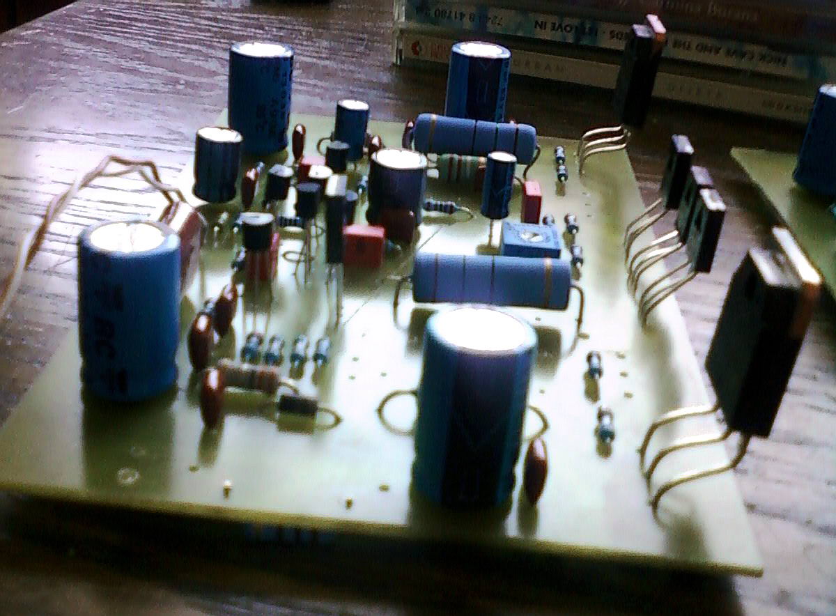

DX MKII Supercharge Complete......
Hello Uncle Charlie......😀😀😀
I read from your other thread that your health is not very good.....hope you get well very soon..... I completed my DX MKII supercharged last night.....both channels are working fine and the sound is as always very good......thanks once more for a very good amplifier.....😉😉😉 I have a question about one of my channels. I switch on the amp......everything is ok. When i measure dc offset on output I get 200mV on the output. This is a bit high. Now I try to set up bias current. I removed the fuse on the positive rail, put my volt meter over the 100R resistor. Switch the amp on and try to set the current with trimpot....The lowest reading that I can set the pot is around 6 to 7 volts. This tells me that the lowest idle current this channel can have is I=V/R, around 60mA. Is this ok. When I connect a sound source the output transistors gets very hot compared to the other channel........Just two questions....
1) what can I do to decrease my dc offset voltage on output. First channel is -60mV compared to second channel that is 200mV.
2) what is bias current across 100R resistor in rails.
Here is a pic of my setup. Will post more pics when I am completed.
Once again .......thanks for the design and help.....hope you get well soon.
MACD🙂🙂🙂
Hello Macd, thank you by your usual confidence and kindness with me
Well, stones inside my left kidney are something usual...happens from time to time.... each 10 years i use to spell them with a lot of pain... a genetic problem, a family problem.... i accept this and i use injections into myself to control the pain and go waiting the system to spell it out.
Thank you Macd by your interest in uncle charlie's health.
Increasing the resistance from base to emitter in the bias control stage will fix the whole thing...the bigger the resistance from base to emitter the smaller will be the stand by current.
if you are using " L " shape adaptors, and if you think it is not good (I had that trouble before) then reduce your current reading milivolts (Dc) over the power emitter resistances..adjust to read 500 microvolts to 1 milivolts there, this way your amplifier will work fine and cold.
Some guys uses 5 to 7 volts...they feel this better in sonics... i could not perceive that advantage and i hate heat, unaceptable to me in special if heat appears during stand by... my personnal aversion goes to heat.. the waste this represents, waste of energy, the changes in the transistor parameters, the risk of thermal drift.... the fear i have about heat... this way, my amplifiers are usually dead cold during stand by mode..and this changes a lot it's dinamic behavior related heat too.
Currents adjusted to 25 miliamperes each rail works fine too, this is what results when we reduce the stand by current monitoring current developed over (voltage drop) the resistances we have in the power output stage..and the small voltage drop represents very small iddle current to each power transistor.... as 1 milivolts results in 4.5 miliamperes circulating from colector to emitter in each power transistor, this means a fourth of watt to each one of them... 1 watt total heat generated in the power output in stand by mode.
If you have good, and real flat, " L " shape adaptors, or a flange in your heatsink, or if you are installing your power transistors directly into the heatsink, then you can play with stand by current searching for the point you believe and feel as better...i do think if you increase too much, let's say 200 or 3 hundred miliamperes, you will loose details, low level details and something will appear muffled..but this is personnal opinion...others disagree...there are controversies on that and i really think you should check this by yourself to decide what you like the most.
Off set seems huge...you may have mistakes in your circuit...for sure you have.... usually does not go above 10 milivolts.... so, check it twice, three or four times because you really have something strange on that.... check your supply, sometimes your positive voltage is really different (huge differences) compared to the negative rail voltage... rail resistances wrong.... well... something may be strange.
If you want, you can artificially change this tweaking the input current sink resistances... tweak R8 or R9 installing resistances in parallel.... try 2K2 and then increase and decrease in order to reduce your off set....but will not be easy, as you have something wrong in your circuit... a small mistake i think.... and you gonna find it....if installing paralel resistance the problem gets worse, then try the other resistance or stop to install parallel units and then go thinking to increase the resistance value installing a small value trimpot (50 ohms) in series with R8 or R9 in order to decrease your off set.... you know, i have assembled 10 units, 10 channels here...and no one show big off set.... this makes me believe you may have a mistake in your boards my dear friend.

Thanks Uncle Charlie... will do this test tonight.....will let you know. I will also watch your videos on youtube for more details. Maybe I am missing something. Should I install any jumper wires in C25 and C21 positions on PCB. I am not using this caps in the supercharge version.
MACD

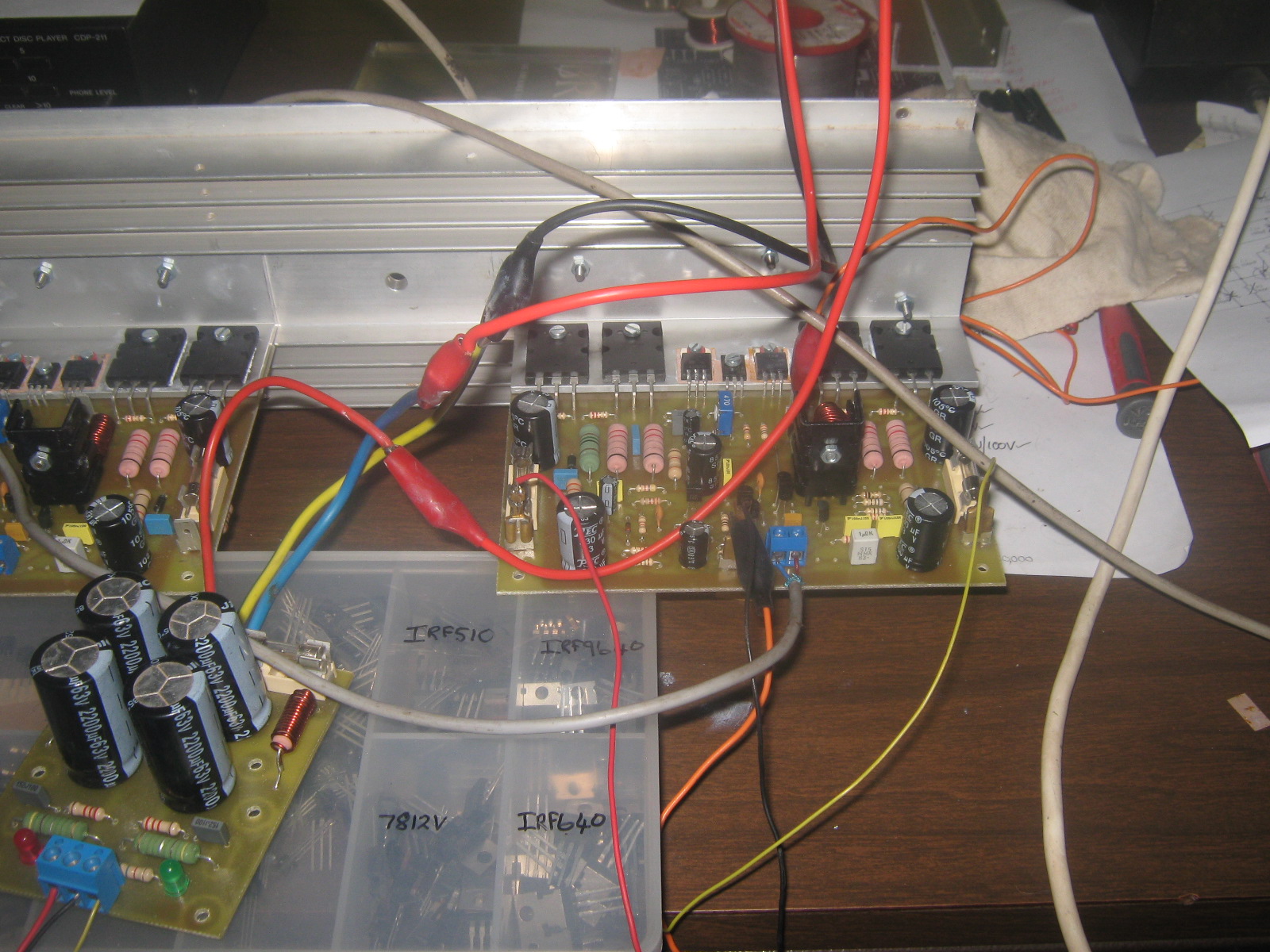

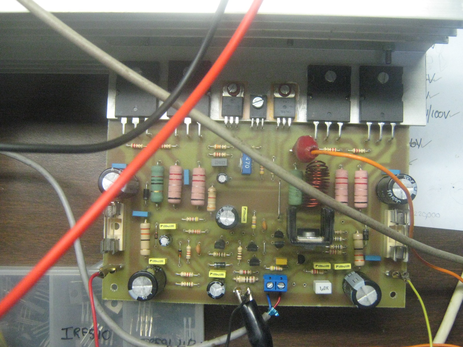

hello Uncle Charlie,
I did some mods last night with no success. I replace R20 with 680R and changed bias pot to 1K. Now I can set my bias current a bit lower but only to 5mV on the positive power transistors and I think my negative power transistors are in the uV region. I cannot measure this because my volt meter only goes to mV range. DC offset is still 200mV. I double checked everything. I compared every resistor value with my working channel and is exactly the same. Checked for shorts, nothing. The amp is playing lovely sound. Crystal clear. No excessive heat generated. My positive output transistors gets a bit warmer then negative but I think this is because output bias current is different. I think maybe my power output transistors are fake. Maybe I need to matched them before installing them. What do you think? How can I matched my output transistors?
Thanks,
MACD
My output configuration.....
Q7 = MJE15032
Q9 = MJE15030
Q10 = MJE15031
Q11, Q13 = 2SC5200
Q12, Q14 = 2SA1943
I am using ±35V supply to test my amp. Will connect to real transformer when every thing is ok. Is my supply voltage ok?
MACD
I see what you found dear Macd...but for sure, you still have a mistake
In your circuit...if you love the sonics is because you are generating second harmonics because of the mismatch you have.
I suggest you to continue to search for errors....no doubts that you still have a mistake, the amplifier behavior is not fine...it is absolutelly symetrical in the voltage into the drivers and output...means if you have 531 mV in the power output, the NPN one..you will have 531 mV or something within 20 percent in the PNP counterpart....also this happens to the drivers and you must be able to reduce much more your stand by current.
Check the bias control transistor and replace it to a BD139..... there you have 2.4 volts from colector to emitter and you need a NPN transistor..almost all transistors ever made, of course silicon transistors, will fit...others, sometimes, have different pin configuration... Rudi found one that has B,C,E inverted related the needed pin configuration to match the pcboard...this happens, and the circuit may operate (badly) with the inverted bias transistor.
In the reality, my dear friend, if you fix the whole thing you may have worse sound compared to the sonics you have, dispite you are having a dirty sonics because of "more" switching power, as a half of your amplifier is switching more than the other half cicle...you are having switching on and switching of, when you can have only switching off.... we adjust the units to be on (some current crossing colector to emitter).... the assymetrical sittuation changes the harmonic distributions and may produce such kind of nice sound some guys loves....but you should try, and listen with your amplifier operating perfectly, in order to allow you to compare...this is my suggestion..to continue to search for errors..i am absolutelly sure there are errors..one or more....and it is normal, common, standard, to produce mistakes and to watch them without see them..this is very normal..we humans are this way..we fail a lot...and our biggest failure is to believe we do not produce mistakes, what is in the main trouble...that belief does not let us search things with confidence..our eyes passes over inverted transistors without see them... we go checking.... we say yes and the mistake remains.
As a said before, i hope you believe in uncle charlie, this behavior is not normal, not standard, not common...this never happened here when building these amplifiers...so..there's something wrong on your unit....... or i have made 20 amplifiers producing the "fixing mistake" that made everything fine or your unit has a mistake because is showing strange signs.... seems to me i have better chances, because to produce 30 boards with the SAME mistake that made the amplifier stable (and hundreds of others made the SAME mistake i did)...or the mistake is in your amplifiers... statistically, it is more possible you have the mistake....you know... "fixing mistake" is because i am understanding the schematic is wrong..that you have build it fine and we all have made mistakes....funny, not very possible...but not impossible....just difficult to happens...everybody wrong, resulting perfect amplifier and you rigth resulting a non perfect amplifier....there are logic problem on that.
regards,
Carlos
Yes you are write Uncle Charlie.........I will still continue with fault finding.....I will test the transistors today....maybe there is a faulty transistor.....will keep you posted....can you post final schematic of Supercharged with all mods please.......want to compare with my schematic. I might have missed something...
Macd
