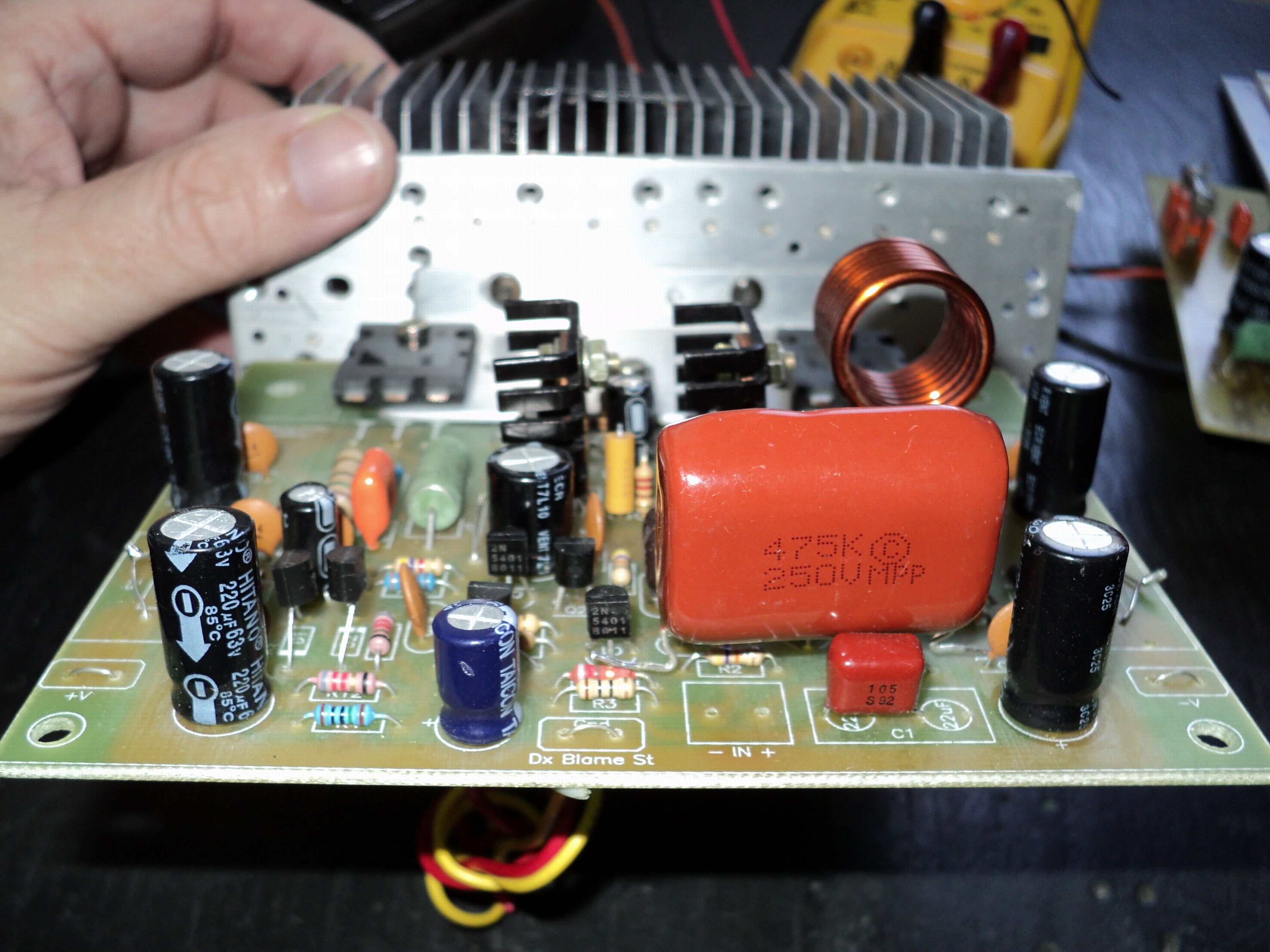

hello sir I'm not sure if you already fix the problem if you notice those 2 transistors need to be insulated and not touching the heat sink see image
the metal tap of the transistor is the collector the screw with watcher should not touch the metal part of the transistor I hope that is what it is a simple fix.
Regards
Juan
Is ok sir don't worried sometimes we forgot stuff I sometimes forgot wich one is the cathode on LED jejejejejeje it happens 😀
the BD139 should be fine is already insulated 🙂
they are some brands of transistors that they come insulated or
also you can use plastic insulators too so the screw will not touch the metal tap of the transistor.
Regards
Juan

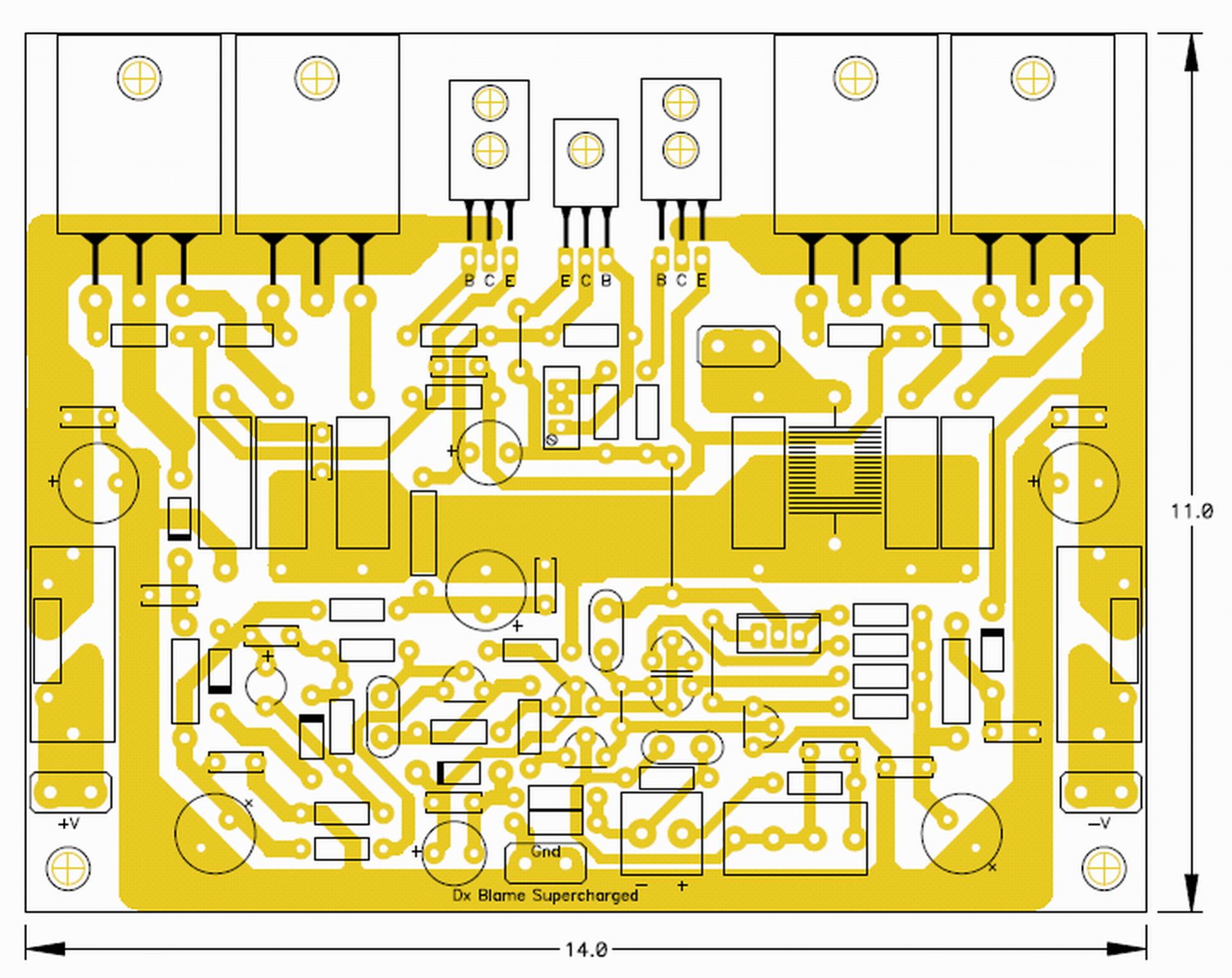

These pcboards looks strange to me
Maybe non authorized board.
Well, this does not mean we are not responsible by the circuit...of course we are...but we are not responsible by the pcboard.
Of course we gonna help you and others..but with half strenght, because we do not know what people did with the pcboards...i hope, at least, they have copied rigth.
And you Vargas, do you recognize these boards... are they from the Englishman that said gonna make a couple of boards to his friends and made much more😡 .. well.... maybe he has a lot of friends....maybe.....do you think these pcboards came from China dear Juan?
regards,
Carlos
Well I thought this one was one your designs so is not your designs Carlos ? hope is not China make, to be honest I thought was Rudy designs
please sir let us know if this from a group buy authorized by mister Carlos, we are happy to help but if the boards was made on the side or
was purchase from a piracy Asian market let us know but if the board was made by local for diy and not many boards let said 6 is fine
