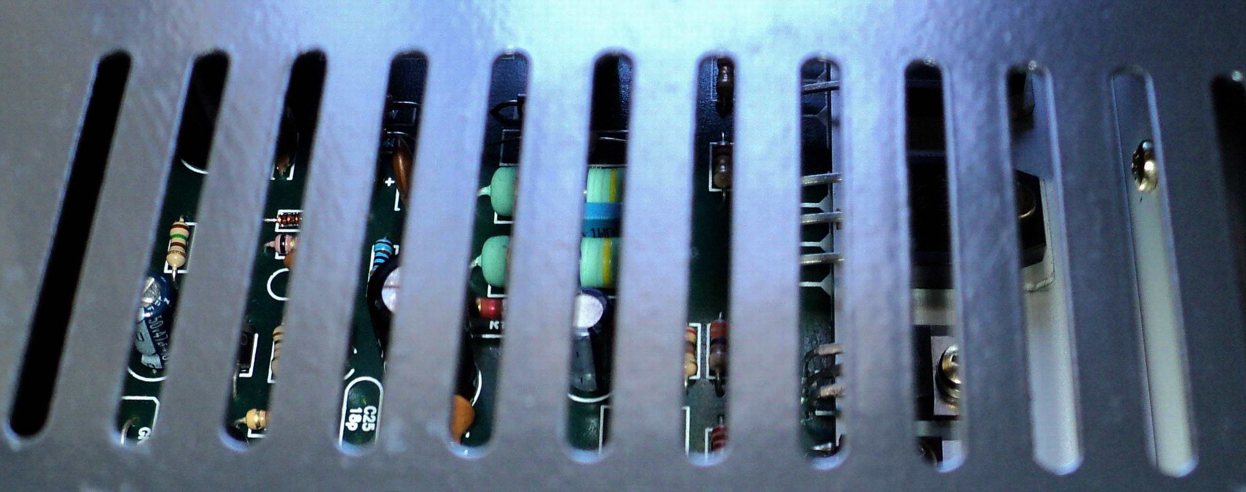

See through the enclosure gaps
boards inside looks nice.

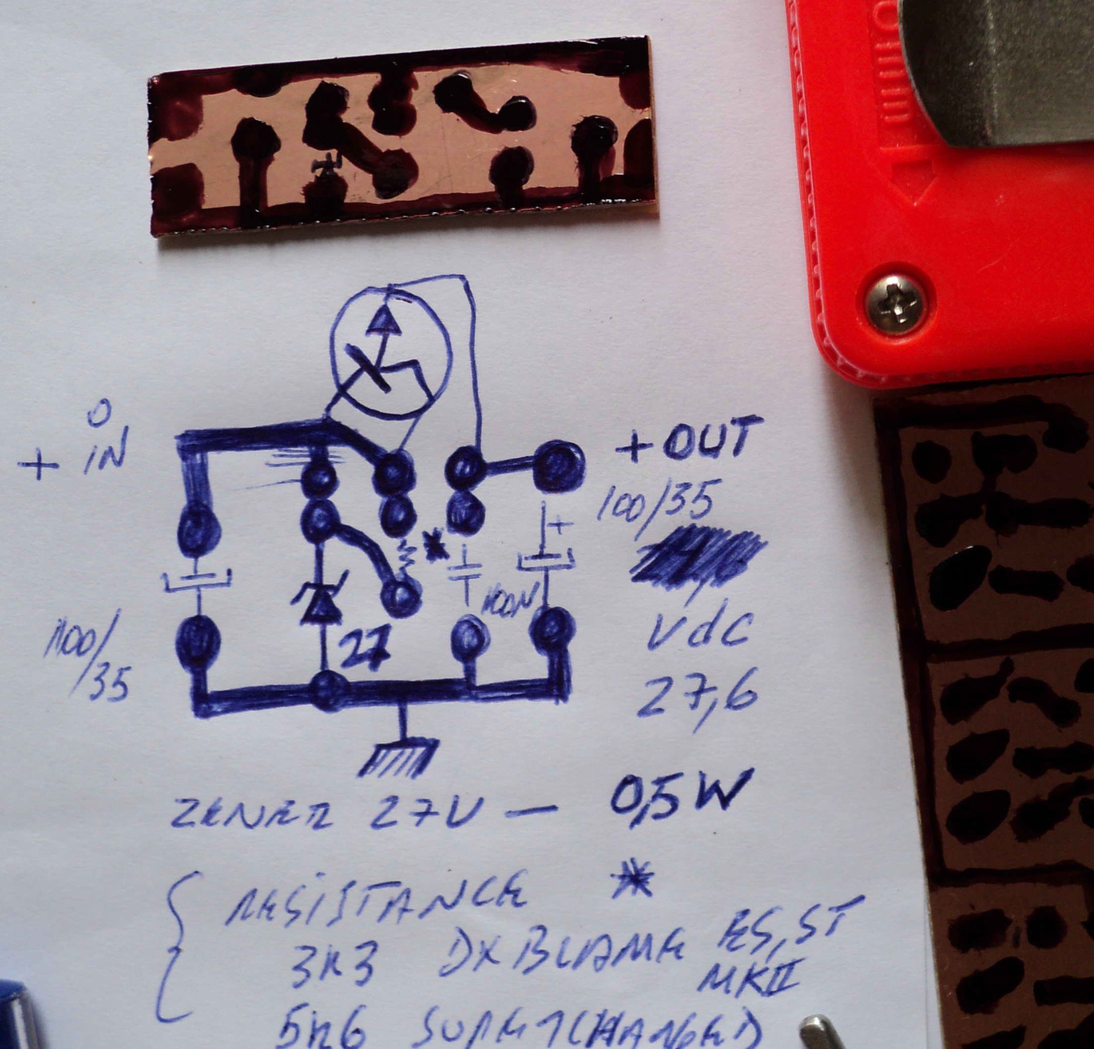

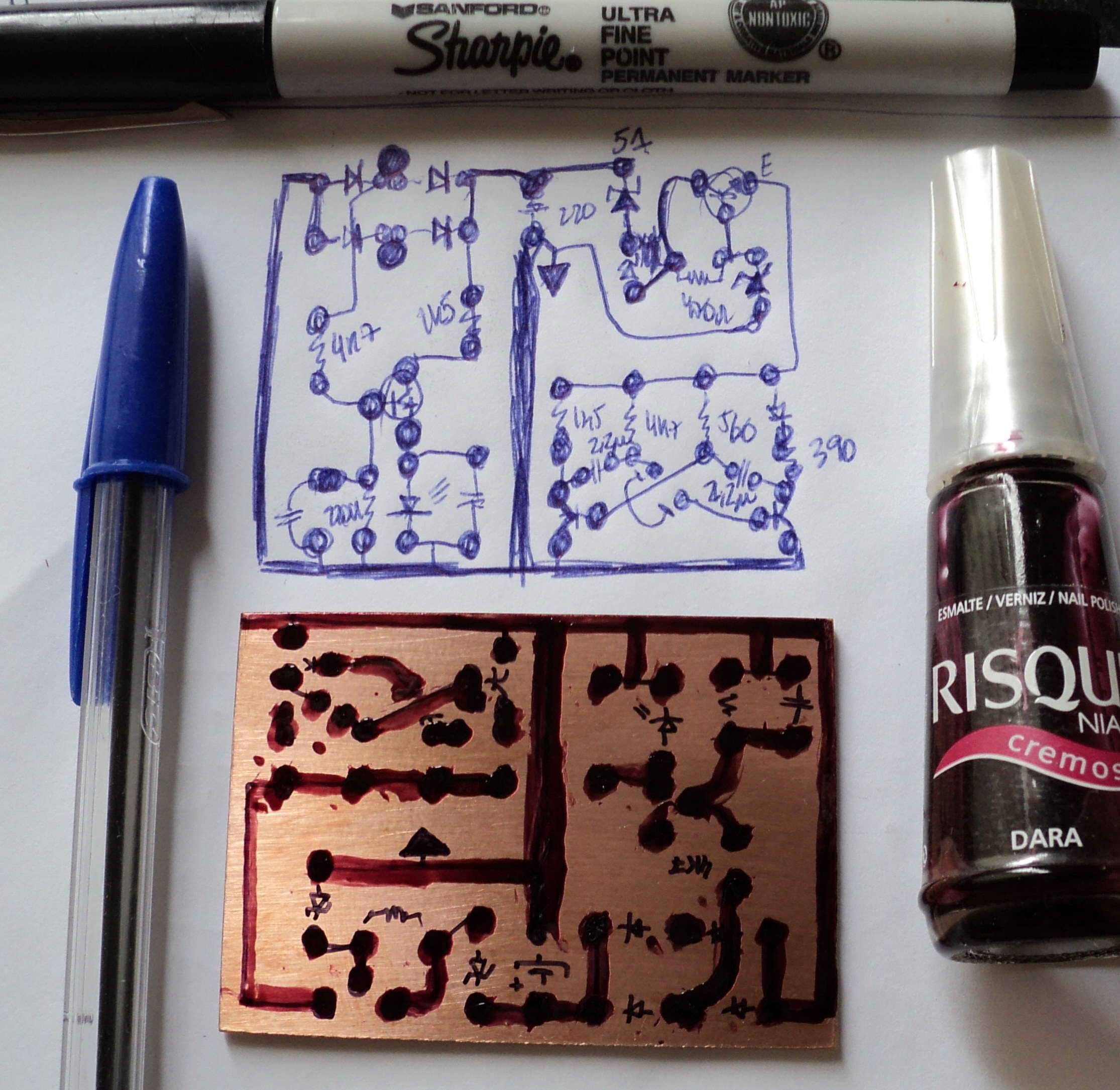

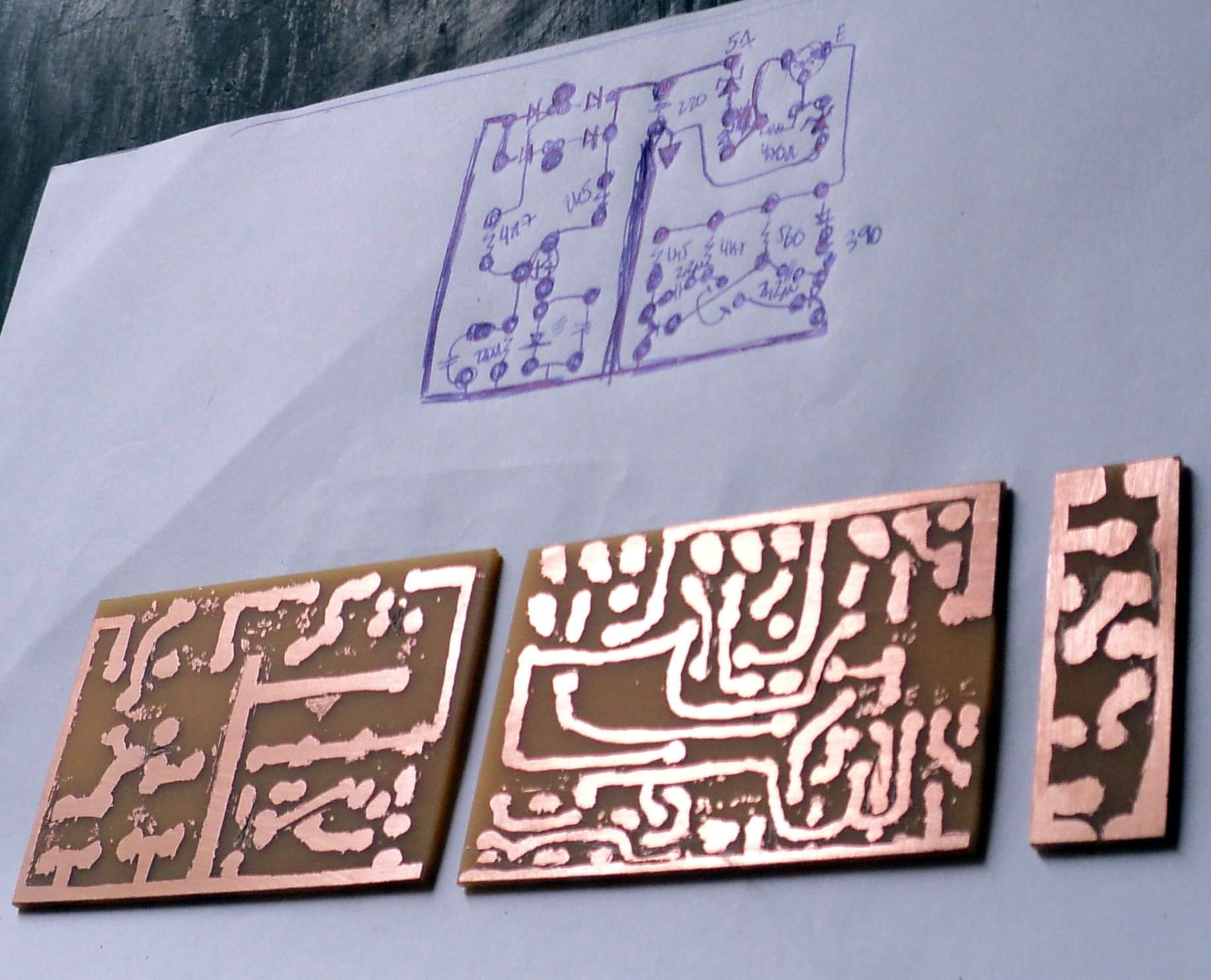

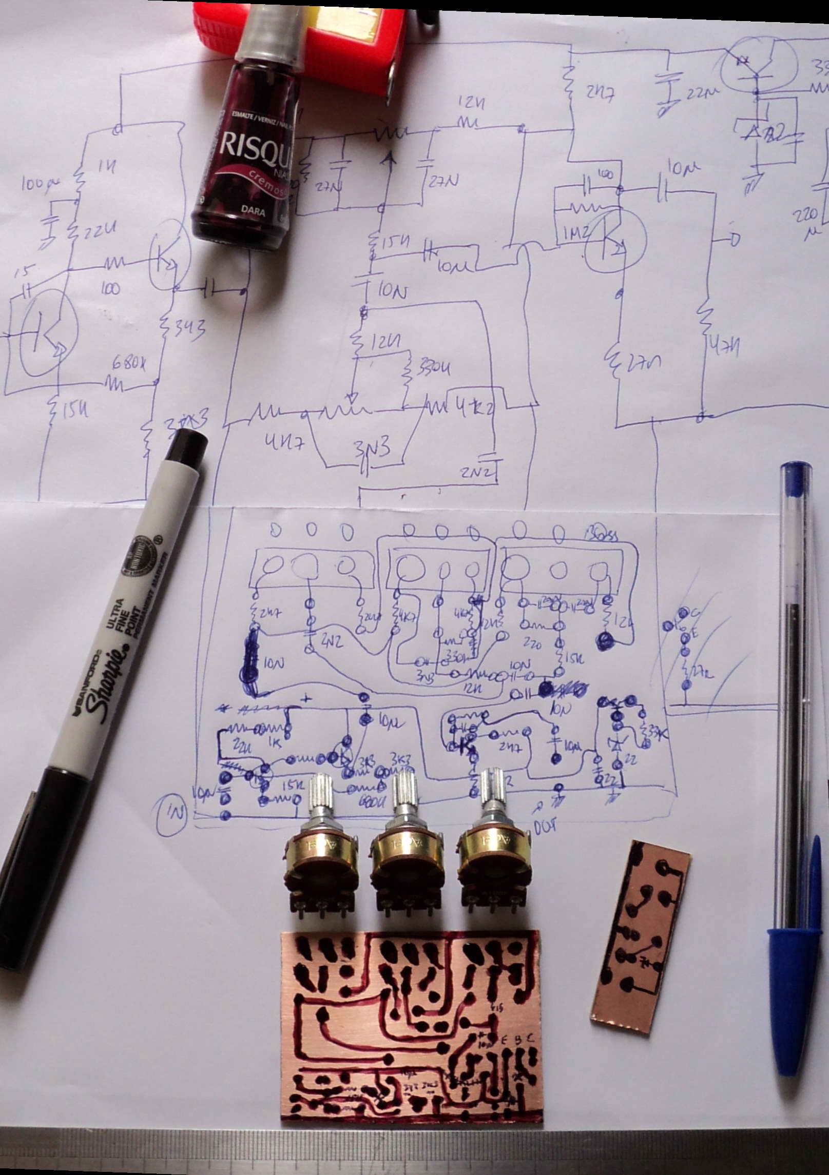

I am producing some prototypes...tone control to my daugthers
an interesting gadget for metering and an electronic step down voltage regulator.

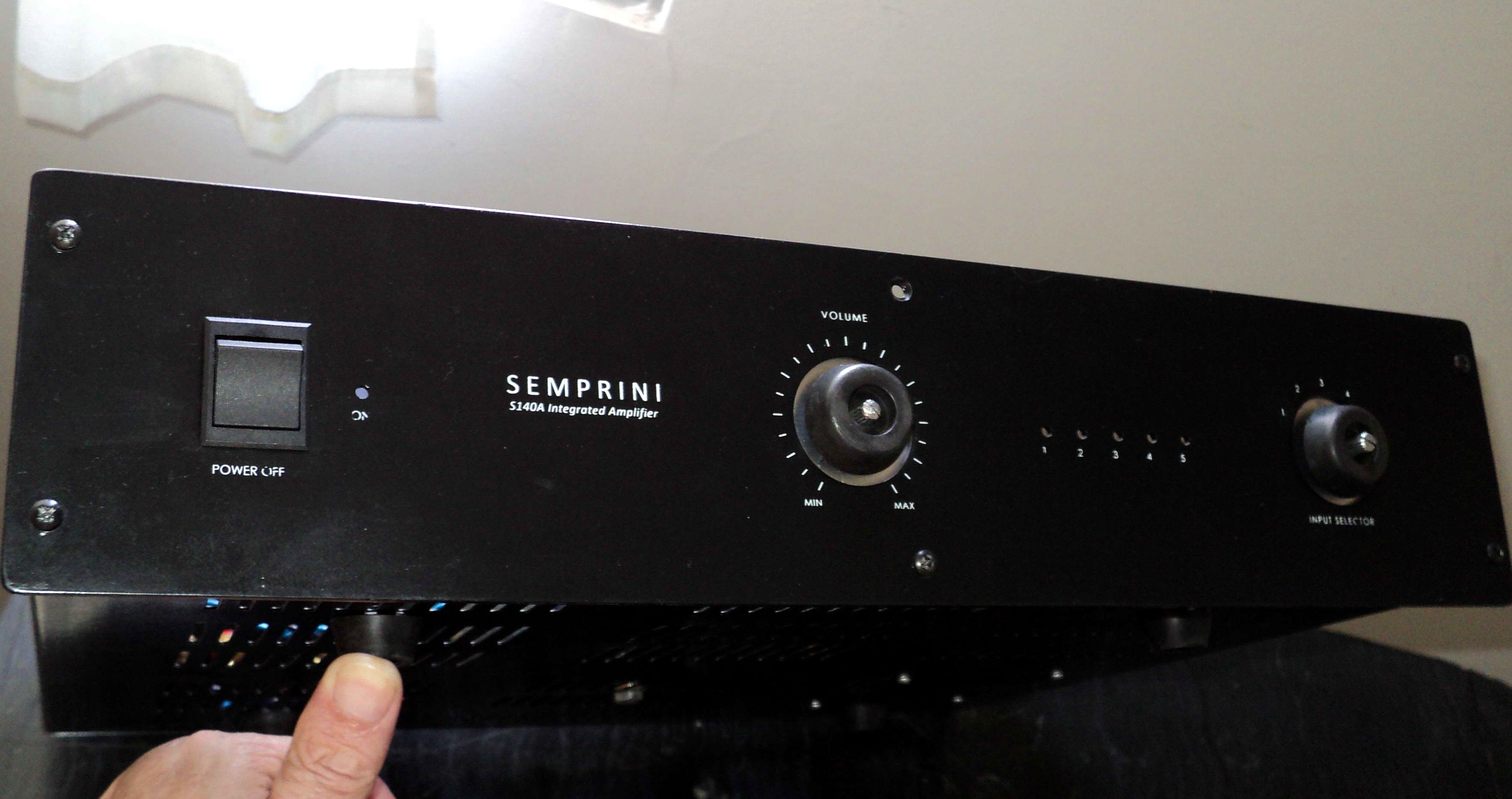

Knobs ordered from China never arrive
Then i have created a new provisory custom model...Semprini Buttoni is the name....hehehe....watch the rubber feets working as volume knobs.

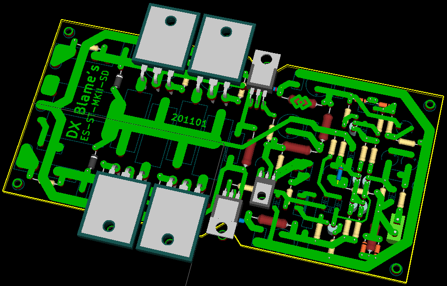

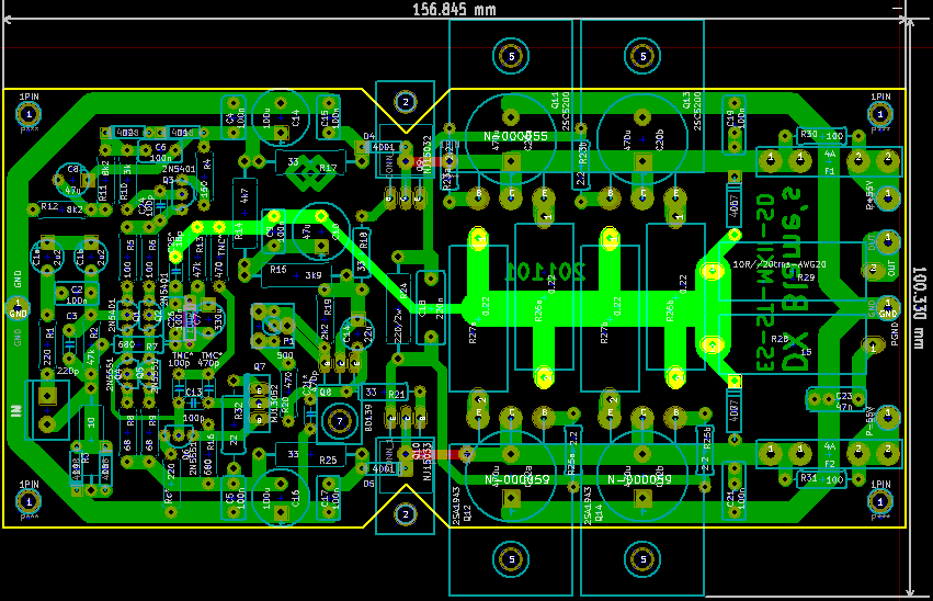

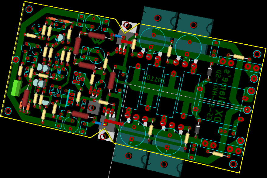

Optional PCB
Optional PCB for DX Blame series; ES, ST, MKII, Supercharge. option for 'TMC' too.
NOT BUILDED YET! please double check if you'll use it.
PCB file on KiCad format.
That layout "style" has performance written all over it. "wire with gain" style!! 🙂
