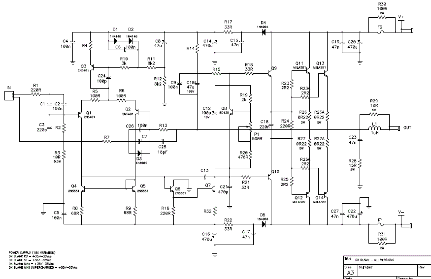

I uploaded the file to this address: http://www.nabucoeletronica.com.br/dx/files/Esquema-universal-english.pdf

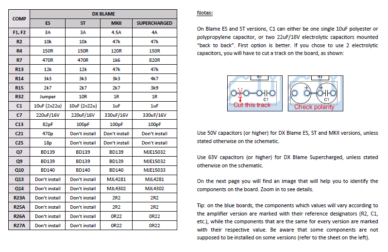

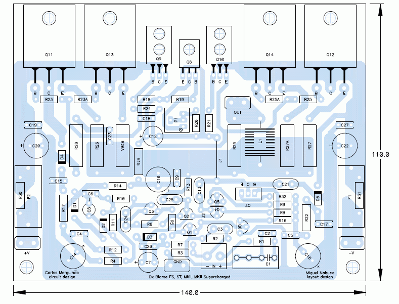

Files uploaded by Mitchel are pdfs showing Supercharged blue board
also the part's substitution chart to match each model and a schematic.
A nice work he made..this way, you can build the model you want and these pdfs will help a lot.
Here you have the images..but reduced ones..search for better images using the link Mitchel provided.
