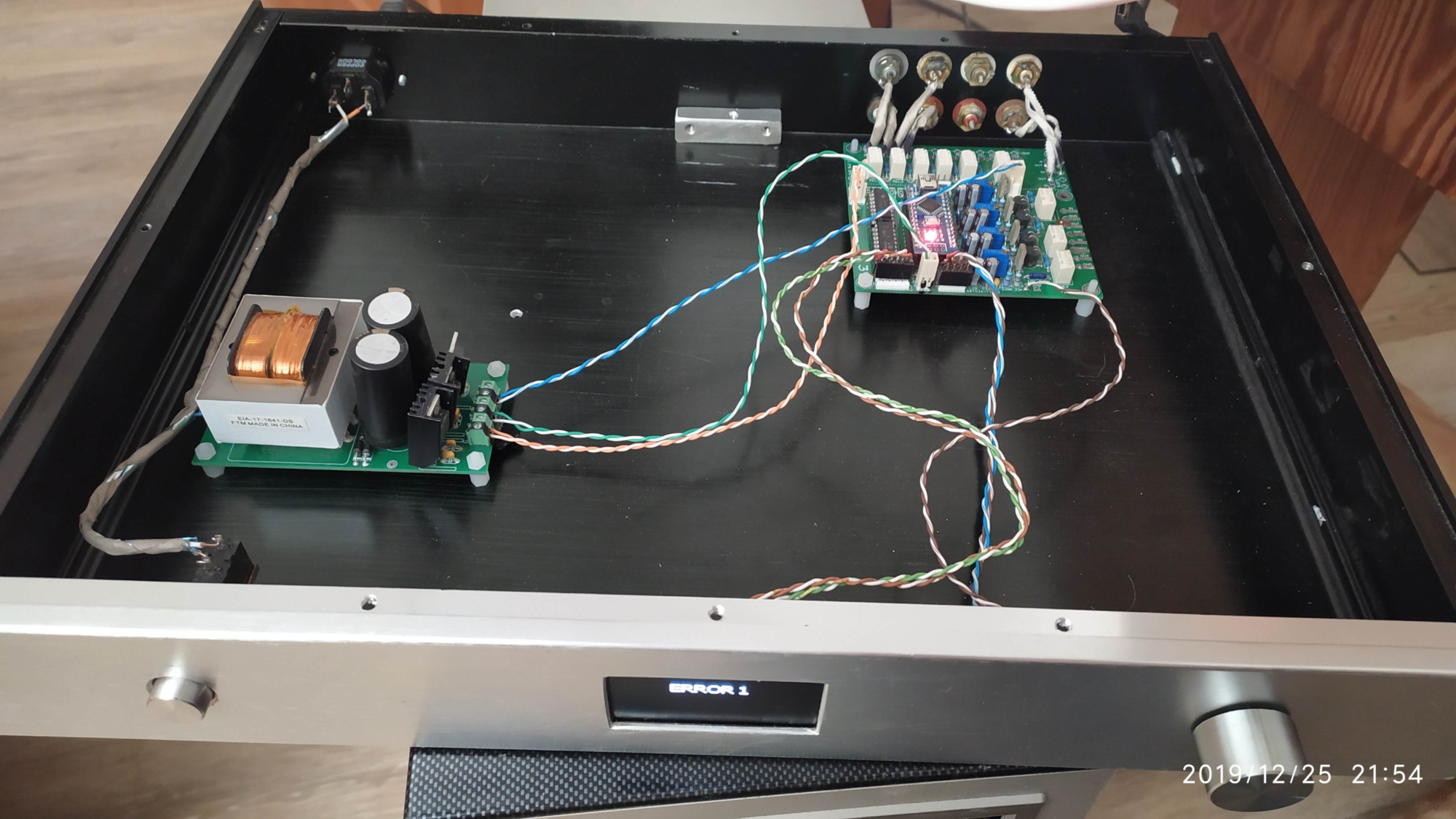

Hello, after many years I finally get the VxD preamp controller (pcb V1.8z) properly installed on a chassis, now I am learning arduino, I download software 1.8.11 Hourly Build, and opened on it the firmware VxD_OLED_4X2s.ino , since my display is oled SSD1309. Now I am stuck could'nt find on computer serial port to upload correct minimum LDR resistances, just first try, soon or later I will.
My main concern is after calibration I get a warning ERROR 1, even after adjusting the bias. Not only, when plug the micro USB to computer, display warns an ERROR 20.

I've seen Neb's google drive, inside readme file, youtube link instructions, then install correct arduino 1.6.9, fixed libraries, etc. now I have drivers and succeed uploading the firmware, as now is nicer display, it fades light down!
But still same warning: ''ERROR 20 LDR/relay power failure''.
Now I performed a calibration cicle and after 5 min, and 47%, it stuck and warns ''ERROR 1 left series could not be calibrated''
Check relay and soldering, or ldr too low
Thanks advice, too late night here europe, tomorrow dissasemble the pcb and check it out if three relays are powered and operate on startup.

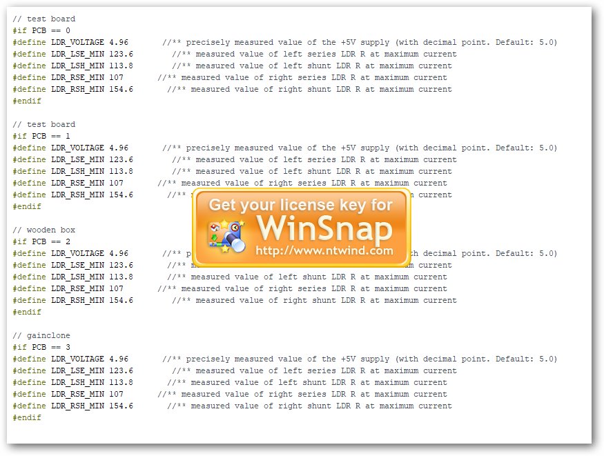

By now I measured LDR minimum values, I get: 154, 107, 113 and 123 ohm. I try upload that but my tests on the RCA shokets had same unadjusted values, as if I had not done properly. As seen in pic. attch. I write on all four 'test value' ( PCB 1,2,3,4)
I expected to see more balanced readings after upload.

Relay test Ok. and soldering seems OK. many calibrations cicles get Error 1, randomly also get Error 2, and one succeed to complete 100%, but after new biasing... again Error. By now it seems another calibration complete, don't wants to measure again anything, I leave it as it is, will try upload some adjustements into some days, before I need to recover from today amusement.
Well is a relief at least not only me, by no reason is misbehavior.
I thing, that must be stated in advanced on the thread, despite de warnings Error, and altrough still not completing the calibration routine, my VxD controller is in use, I am happy to say, it outperforms -more dynamic and everything- than my previous LDR (so called Lighter Note). So no complains after all.
By now I concealed the warning error 20, I increased line 115 from "#define LDR_FULL_MAX 200" to "#define LDR_FULL_MAX 5000000".
And then I bought a replacement for a somewhat high LDR at 159 ohm minimum resistance. I will post if that fixes.
