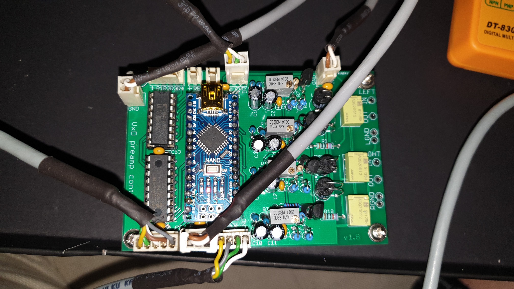

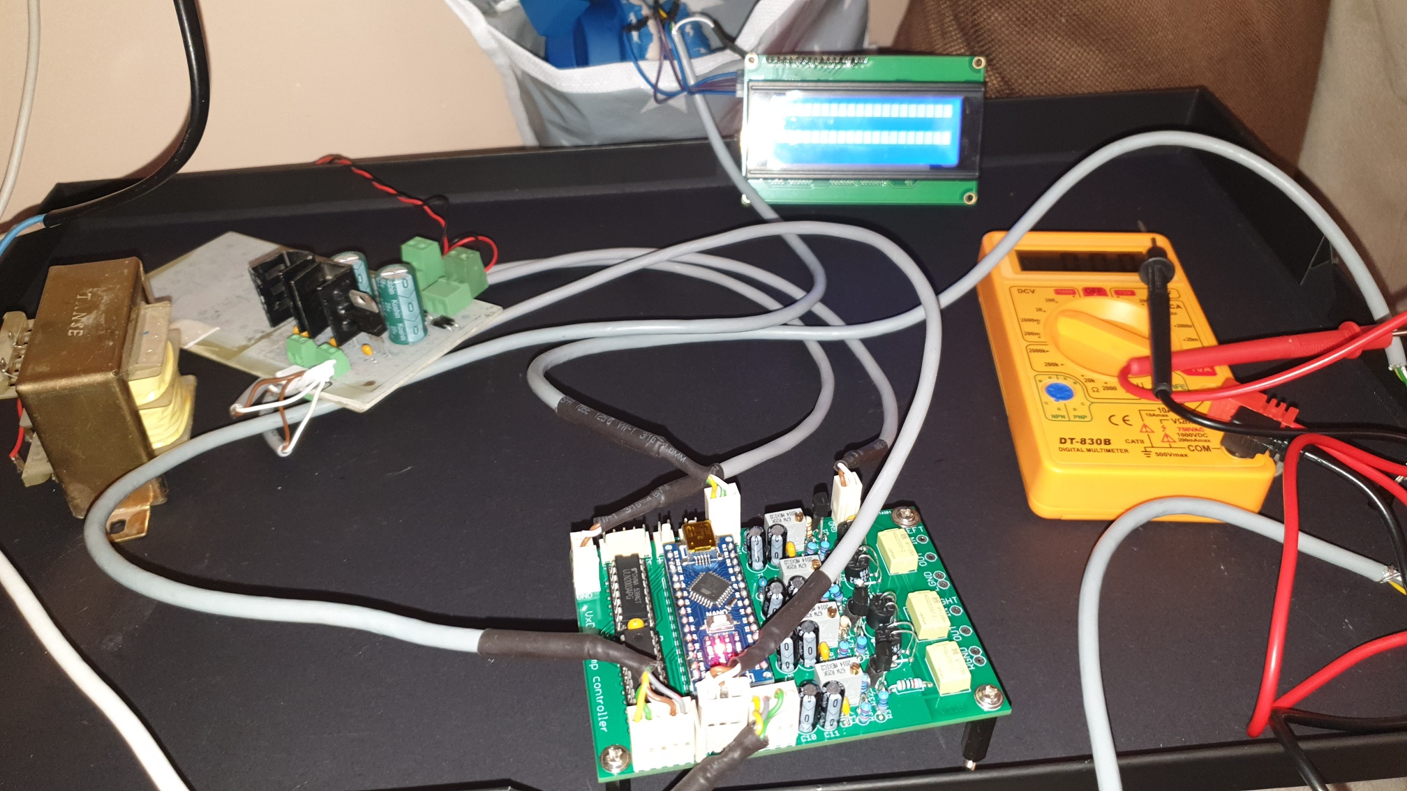

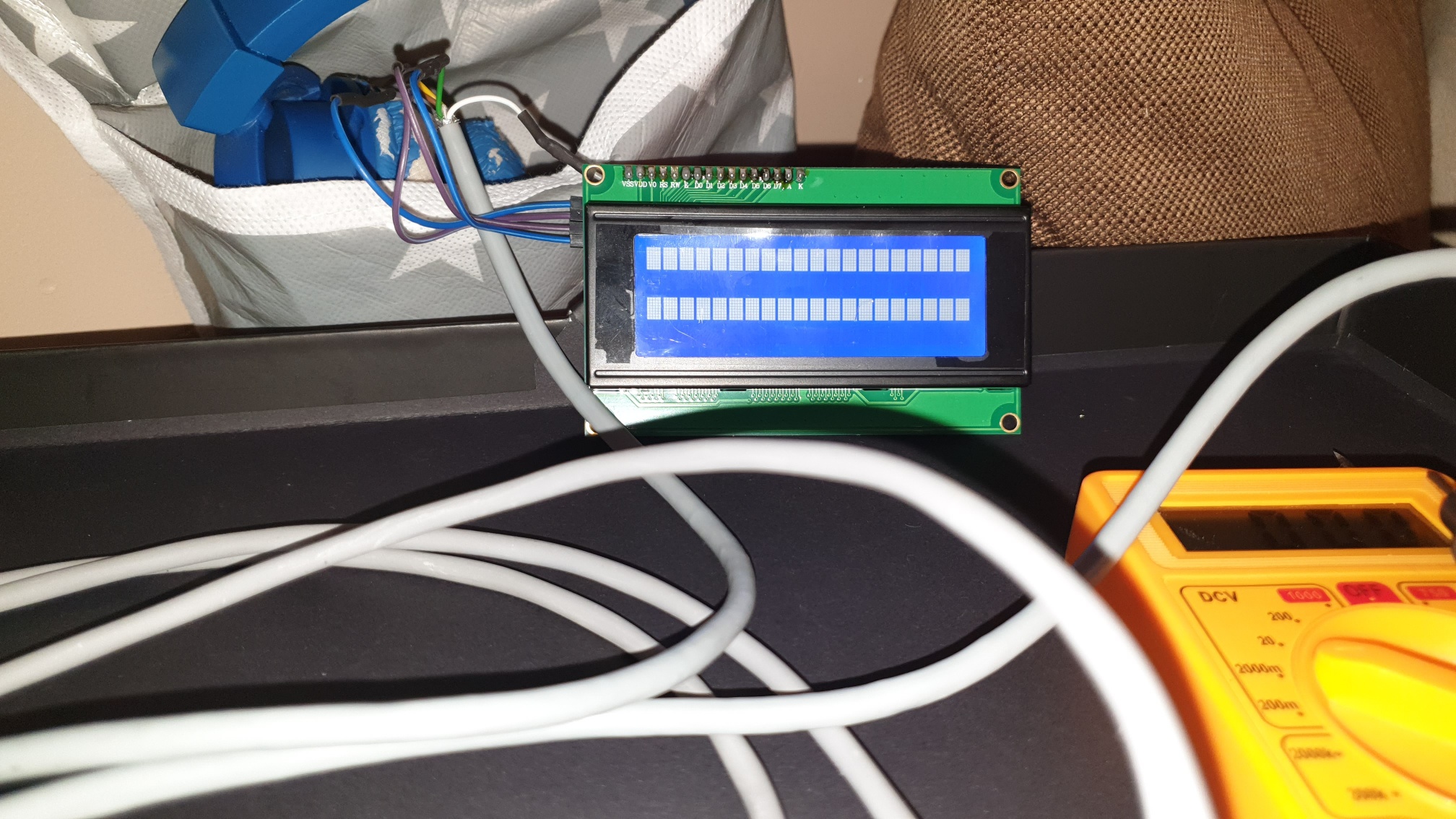

Hi
after a long time finished ldr controller but I have a problem. Nothing appears on the screen. I used vn2222ll-g instead of 5ln01sp except that all parts are the same.
what could be the problem. I checked the links many times. When I measured the ldr outputs, I could only set 1. ldr 700k, others do not read the value.
vn2222ll pinout is different to 5ln01sp. Did you take that into account? Did you modify the source code to suit that display?
I checked and changed the pin connections. Frankly, I did not make much changes in the source code part, I have no idea how to do it, I need to examine it a bit.
Ok thats normally an issue with either A+ or R+ supply rails according to the troubleshooting portion of the manual. You can find the manual in the zip archive in post 1 of this thread. Can you double check this please?

wineds i am using firmware from you
I corrected the codes as you wish and set the impedance to 10k.
I changed the input and output configurations. I'm testing it as 1 input and 1 output for now.
After doing the calibrations, I will have to correct the codes line 1349 to 1355 for remote control.
