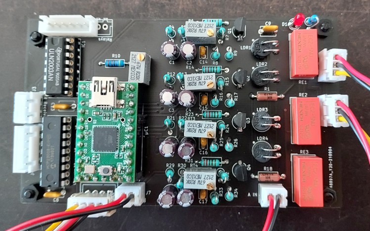

Teensy based
Couldn't resist to build one with a Teensy:
- 4 PWM channels up to 16bit
- Easy Arduino IDE integration
Can't wait to try it 😀
Thanks to all those who contributed so far!
@fvzeppelin this looks amazing! Were you able to test it yet? 😀 I was actually curious as to what it would take to create a version of this using the Raspberry Pi Pico and implementing the code in either CircuitPython or MicroPython.
Thank you 🙂 The attenuator itself works great 😀 Nevertheless, my system still has a light hum issue and I haven't found the time yet to fix it 😡
Thinking of your idea, the first thing that came to my mind besides the re-programming, is the 3.3V IO voltage of the Pico: I guess it would require different FETs and resistors.
