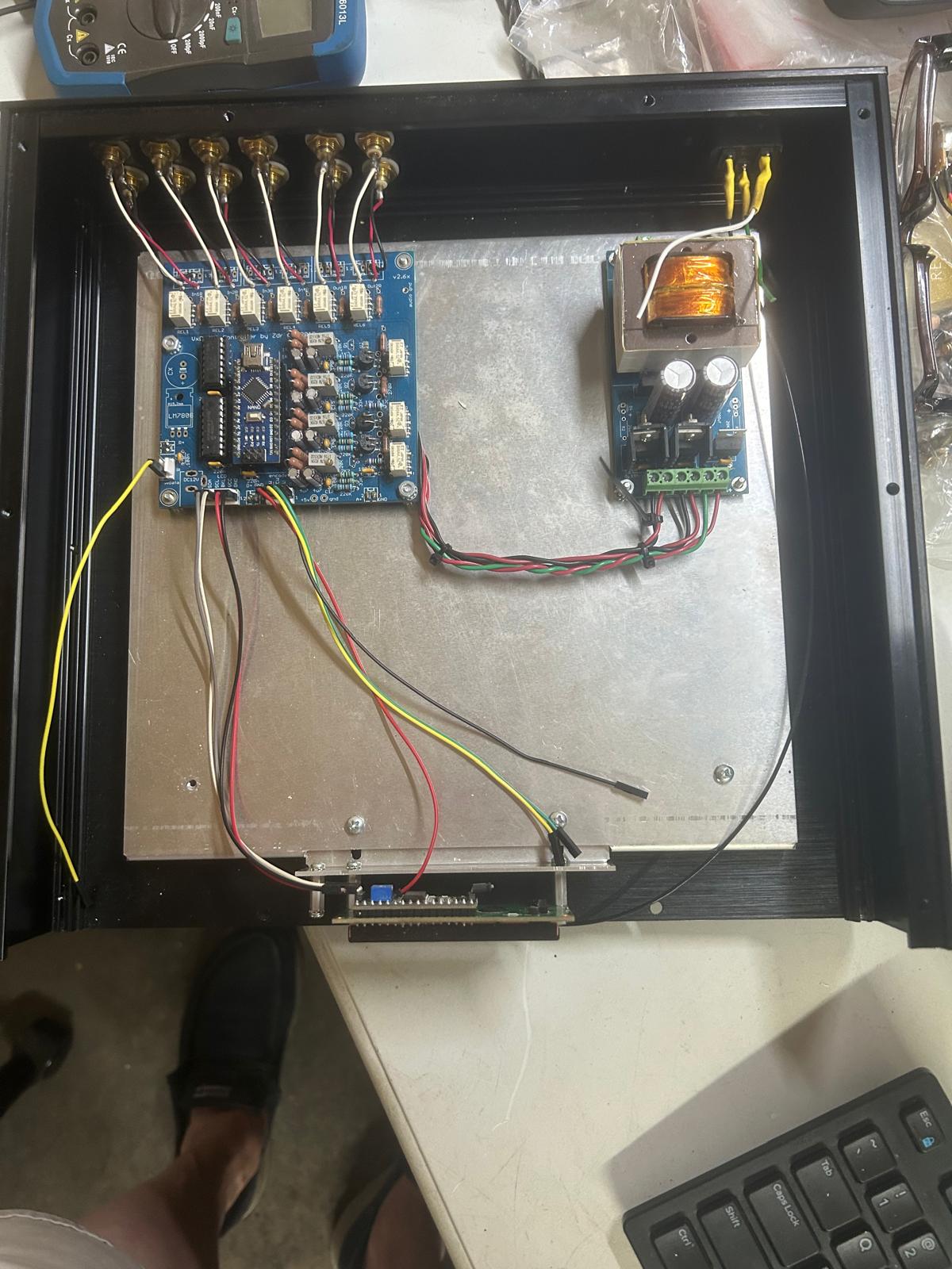

Hello,
I started this project about 6 years ago, but life got in the way. I hoping to wrap this up in the next few months, my issue is I've changed computers and I'd like to know where I can find the source code for this project.
Bonanza
