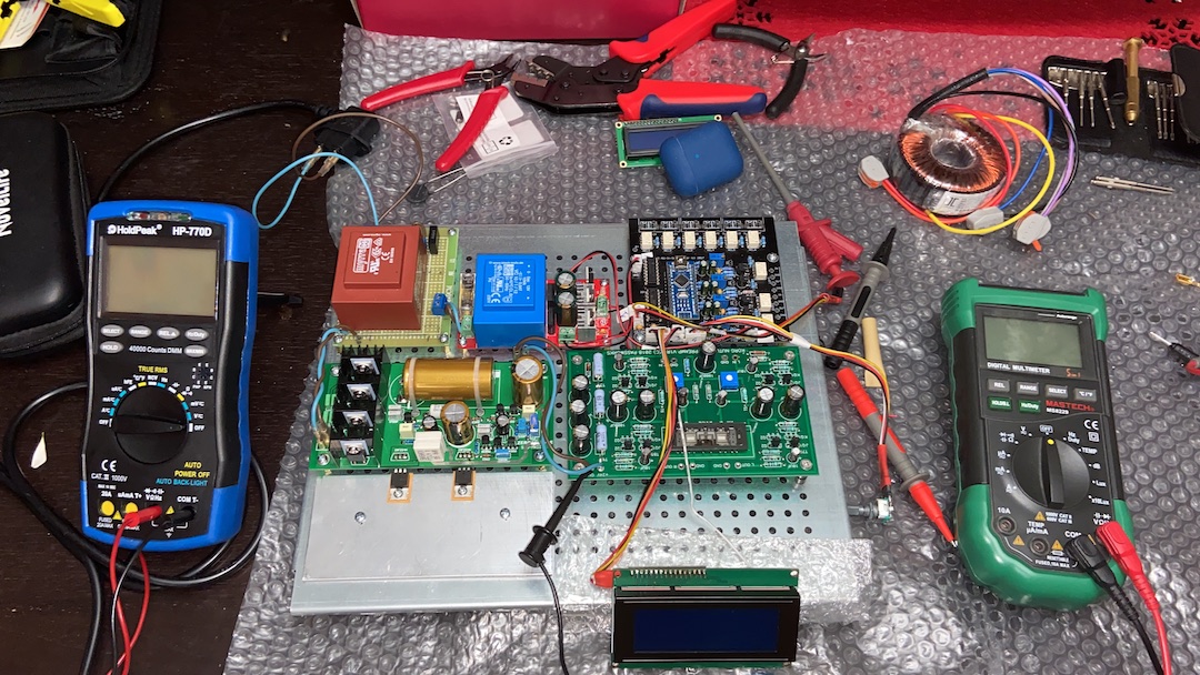

Hello again
As a result of a few days of effort, it gives error 20 in the first opening. When I look at the error code, I get 12V when I measure R + and A +. There is no problem with the supply. When I turn it on, it opens when I hold down the encoder.
When I made the adjust bias measurements, I was able to set LSE, LSH, RSE to 700K, but although I set RT4, I cannot get any value from RSH.
LSE 71.4, LSH 80.2, RSE 61.5, RSH do not show any value in Measure LDR's measurements.
do i need to change something in the software below for this

I also get an ERROR 10 error when I try to calibrate.

I think you have a problem with RSH. You need to find out why you cannot set RT4 for 700K. Check for solder bridges etc. Check the VN2222 driving RSH. Check orientation of RSH is correct? Maybe try replacing RSH?
Once that is resolved you need to complete this section with real measured values as detailed in the manual :

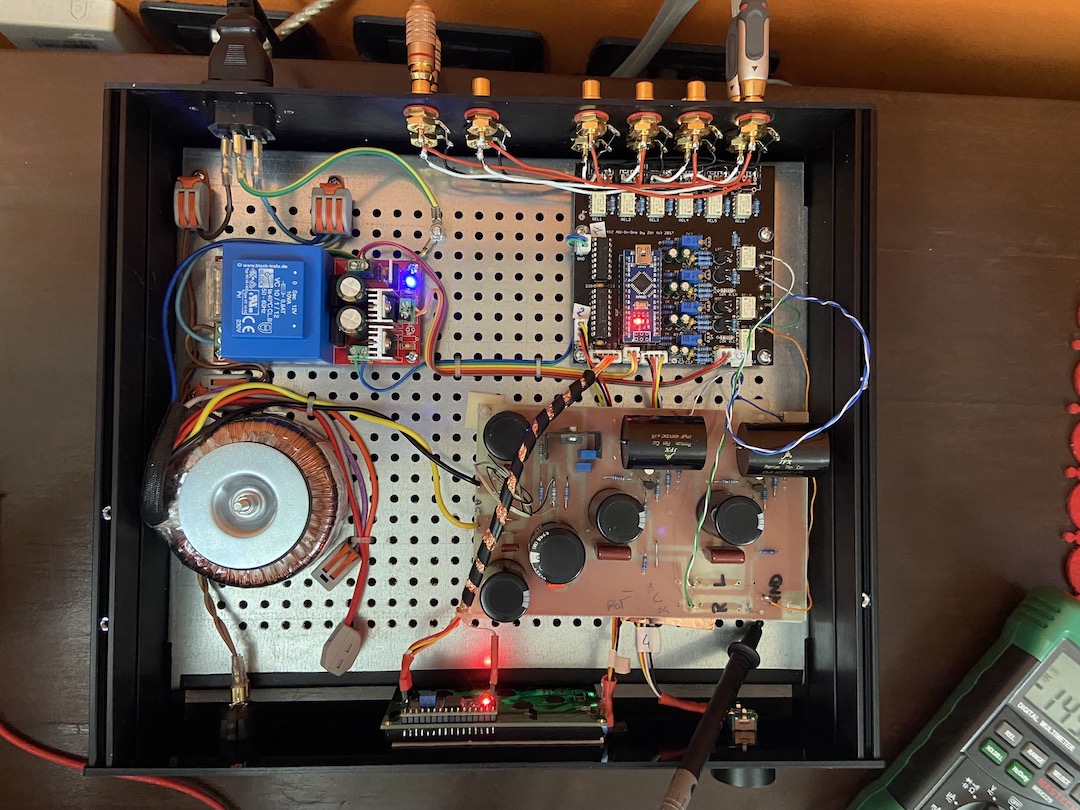

Hello there
After a long time I tested the complete circuit. but I have a problem.
It has 3 inputs and 1 output but I only get one channel output.
There is no single channel output from the arduino system.
also moaning at inter-canal change

Dear all,
I have an LDR Pre MkI made from zdr complete with lcd that I had taken for a project but it was never done until about a month ago when I took the board to make a preamp with the Nelson Pass B1 with the korg nutube. Unfortunately I can't get them to work together, in the sense that if I make them work alone, they are perfect, if I connect the preamp to the right of the pcb the sound is completely distorted, the volume stops working and has a strange behavior when the volume changes, distortion varies and when it is at its maximum, the signal disappears. I tried to change impedance, resistance range, volume amplitude (50 to 30) but always without success. I tried to put the pre in series with the output and it works perfectly, at this point I am wondering if I have to configure something at the software level, so here I am asking you how you connected and configured your LDR Pre MK1 with an active preamp.

It works fine when not connected with the B1? Then the issue is not with LDR. I have mine connected with rmi-fc100, no problems at all.
Does your b1 work with a simple pot? What are the signal levels you are feeding?
I made a few attempts, I assembled the B1 with a potentiometer and it works without a problem and the card with the LDR works perfectly by itself, I feed them with a normal dac, so I think the maximum output amplitude can be around 2V.

I am attaching a couple of photos of the realization, maybe I made a super mistake that I can't see.
Also, maybe even this is needed, after two or three hours of operation, I noticed that in the power supply of the LDR board the transformer and heatsinks are quite hot, nothing to worry about, I can touch them with my fingers, but find a transformer that is not cold in a card for low signals had never happened to me.

What is the exact version of firmware you are using? Why did you change it in the first place? You received arduino with firmware already in.
Upload a close up photo of the ldr board.

Here you go for couple of pics
