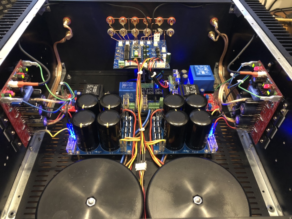

RMI-FC100 is class A until 8W so there is some heat dissipated, but it can be biased for less dissipation. Better to ask for details in the FC100 thread.
I thought it was only class A until 2w? viz :
Class A power: 2W rms into 8ohm with Iq=0.6A (maximum Iq for optimal B class bias)

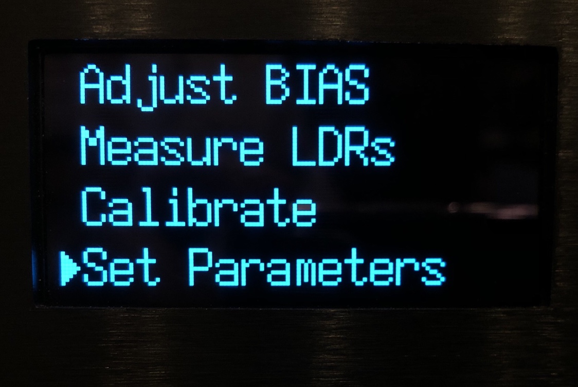

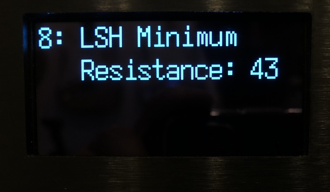

Is there any easy way to test for ldr failure since I can't get past error 20 to measure them. I am getting approximately 5V across the three relays, which should be enough for operation. I am using the NSL-32R3 in this build; which I believe you have said in past posts were slow on calibration but should work.
Roy
Roy
Roy, did you check that the LDRs are orientated correctly? On my last build I had error 20 due to an incorrectly orientated LDR (white dot had worn off).
Yes, all my dots are in a row. I have one that has the top engravings reversed from the others but I have seen that on other builds that operated correctly.
Measure the resistance of each ldr, I think they should still be in ON state during error 20.
Indeed, i confused watts with ohms😉
