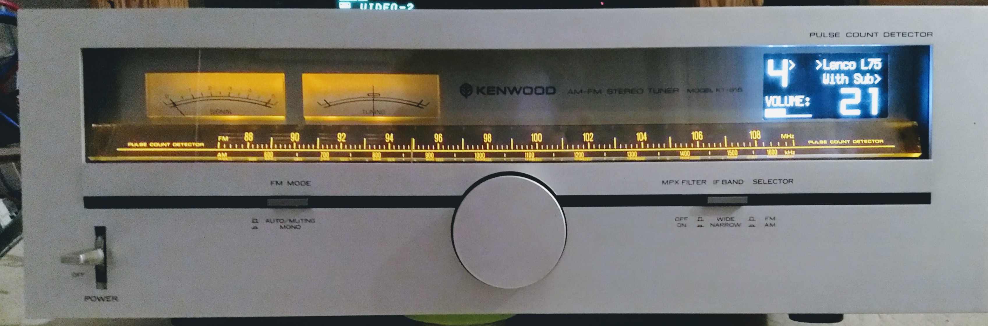

Hey there,
here is another casing option for the LDR controler, i put it i an old Tuner Case and i think it fits quite well.
might not be for everyone but i like the "classic" look.
The big knob drives the encoder (and still the tuning bar 🙂)
The fm mode Button does the same thing as pushing the encoder.
i dont seem to be able to find how to dim the display, i used the latest 4x2s code.
And there is a font included in the file, modern_h which only cosists of numbers, does anyone have the matching (size24x32) letters?
Thanks!

NICE! No letters, sorry.
Thanks Neb!
the extra size of the tuner case also allows me to put the crossover and my two Sub-Amps in there.
The Letters are not really that important, just a nice to have...
I wanted to use Kapital letters instead of the input number. like PC,BT,
I also tried to include Fonts from the Adafruit_GFX.h Library, but thats above my skill level with arduino.
Do you have an idea why my Display is not fading?
it always stays lit fully, i used your latest code for Oled_4x2s, the Display is same as the one you posted earlier in this thread. IDE is 1.6.9, but my board is not your newest V3, i got the "previous" Rev.
You put an amzing amout of work into this!
Thanks again for all your help!
