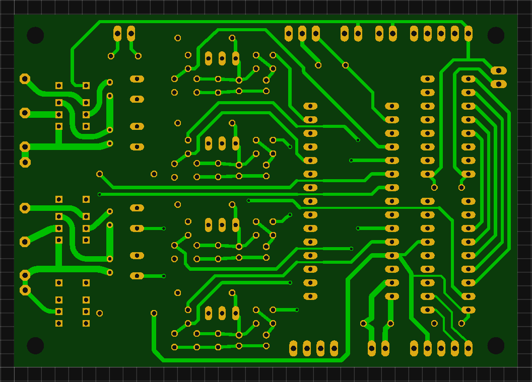

Because the 5LN01SP is no longer available in TO-92 package, and I haven't ordered the boards yet, I decided to try and replace them with an equivalent in SOT-23 (FDV301N).
Could someone please check if I made no huge errors? Had to rebuild copper plane and from what I see all pads that are supposed to go to ground still do, and I have no floating copper.
There is no problem to make it work from the arduino point of view. You need to make sure it works from electrical perspective, as the load impedance will go down when you drive two inputs.

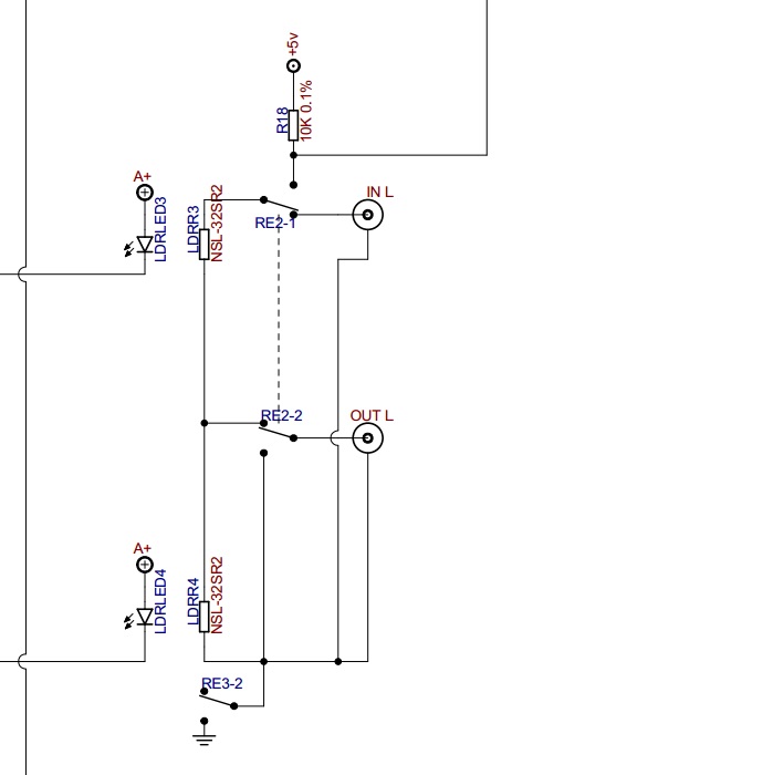

It's not a firmware issue, it's hardware design issue with original boards. All-in-one 4x2 boards have separate dedicated output relays that can mute without pop as they do not switch any DC (unlike calibration relays used for mute in original boards). There had to be a change in firmware to accommodate hardware change though.
The only remaining little annoyance is the volume "bump" when VxD is switching between low and high impedance mode. I compensated it as much as I could in the firmware, but it still can be noticed with white noise.
I didn't realise this. Thanks @ZDR. But I can't see how the calibration voltage can appear at the output as the relays must be break before make? Is it not more likley the pop is due to RE3 connecting the output to 0V on mute?
All I know is that there is no pop on my boards and they also mute outputs by connecting them to ground - the code just does not touch calibration relays for muting purposes. So I guess it must be the calibration circuit. It's not a good design anyway to flip the calibration during mute, but I guess it was due to limited number of relay control pins. I remember that someone in this thread blew up MCP23008 by flipping mute too often.
Also don't forget that entering calibration mode connects audio gnd with digital gnd, which is another bad idea during mute and a very good candidate for audio "pop".

OK I had a look at your code. If I cut a track and run RE3 off Rel6 instead of Rel0 would that work with your code?
Don't touch calibration relays. My code does not use them for mute, but they are still used for calibration. You need to take the one for power on delay instead and use it as second output relay. See pin definitions and compare them to original code, that will give you an idea.
