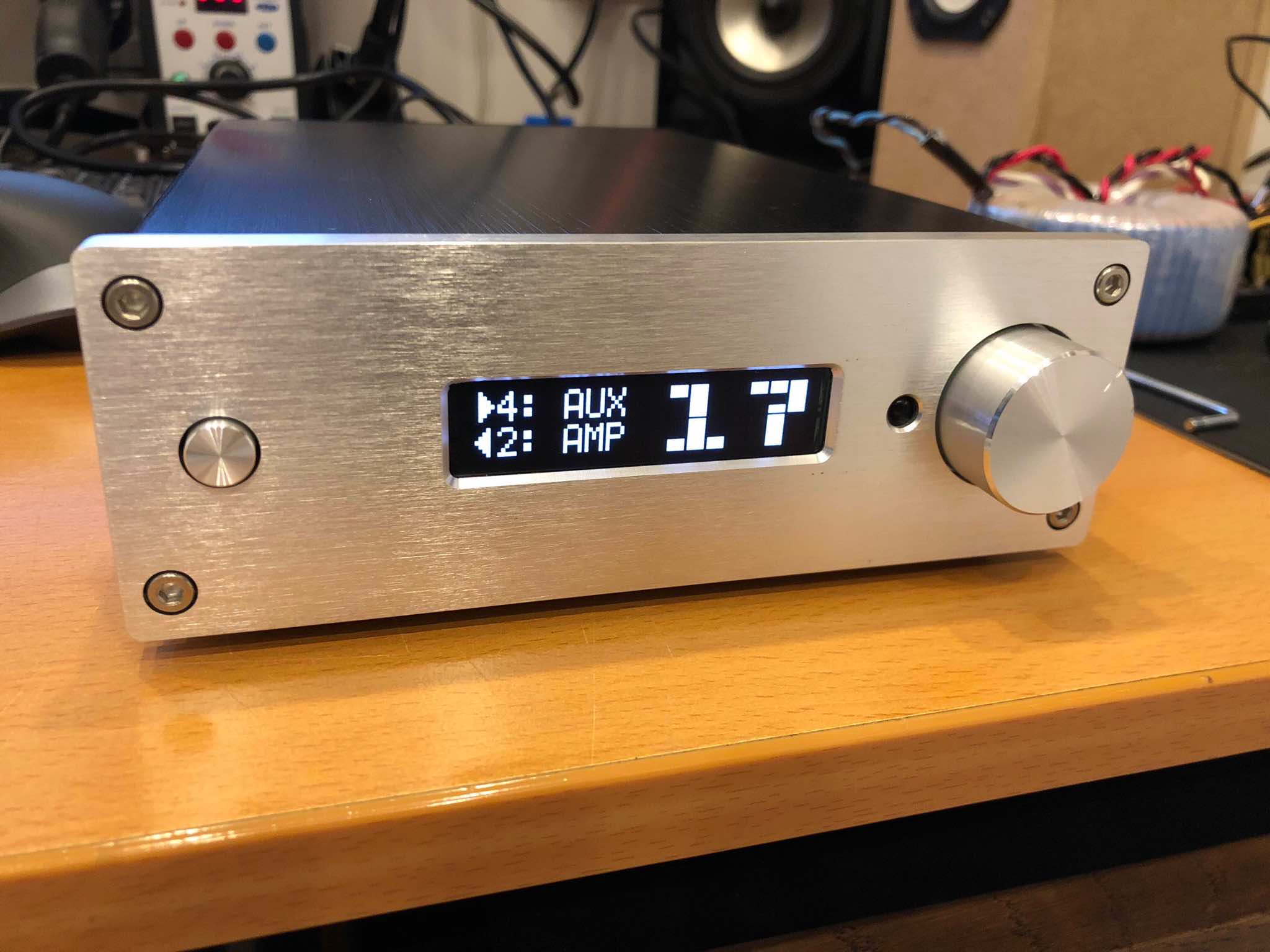

OLED 1602 is perfect fit for F6 châssis from AliExpress:
