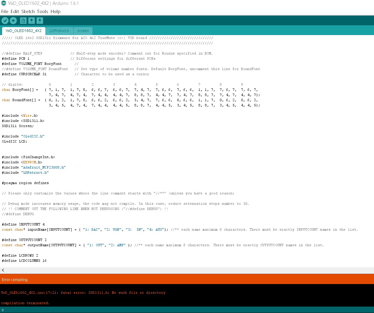

VxD_OLED1602 Error Message.
Thanks to the help of a gracious member here, I was able to learn more about using the Arduino ide.
Just for kicks, I downloaded and unzipped the VxD_OLED1602 files from Neb's Google Drive page.
When I try compiling everything I get a error message about half way through the process.
I posted photos of the 1.6.1 ide as well as the error message itself below.
Can anyone tell me what I may be doing wrong here?🙁

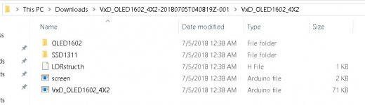

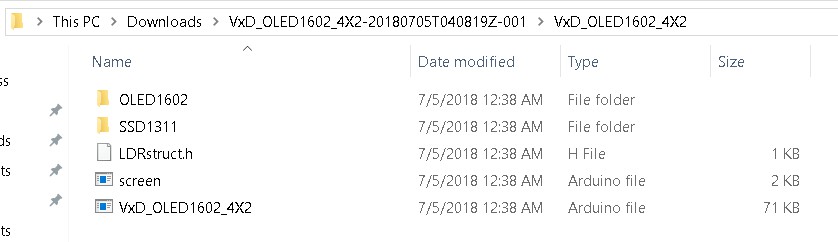

I don't follow what you mean by copying the ssd1311 folder into the 1602 folder.
In the image I posted above, it clearly appears to me that the ssd1311 folder is already in the OLED1602_4x2 folder.
I don't know where else you're suggesting to copy or "include" to.
The problem I'm having is the Arduino software can't find the ssd1311 file when compiling.
PinChangeInt.h Error.
You are missing ssd1311 library which I included in 1602 folder. You might need to copy it to library folder.
