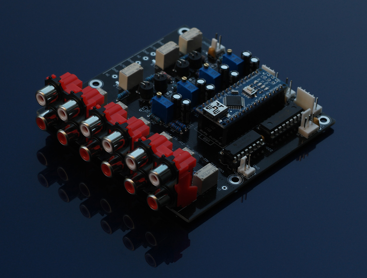

Inside the menu and volume control works fine. The only problem is at the welcome screen
Hm, interesting. It's not in the code to print anything below 2nd line, not sure where it got lost. I guess no one used last two lines up to now😉
I updated the VxD_LCD_4x2, try it now. I don't have LCD 2004 so cannot test.
Unfortunately the code doesn’t work it doesn’t boot at all.
I also have another problem can’t set bias at RSH it shows 64ohm. I have changed the ldr then the Q3 but nothing changed🙁
compare DC voltages between Q1 and Q3.
I just tested LCD code and it works fine in both 2004 and 1602 modes. You need to set it here:
#define LCDTYPE 2004 // Specify the LCD type. Only 2004 and 1602 are supported
do not change LCDCOLUMNS and LCDROWS directly.
I changed the lcd address and works although a bit darker but at the 3rd and 4th line appears the message that is at the 1st and 2nd line.
Please explain me how to measure the voltage between q1 & q3
Measure voltage between S,G,D pins and ground, and compare them to other transistors.

Gate and source have the voltages of source and gate of the others.
Q1 and Q3 should have similar values on all the pins. If one of them is off, you should troubleshoot from there.
Found the problem at the code and now works fine.
Please update it at your google drive.
