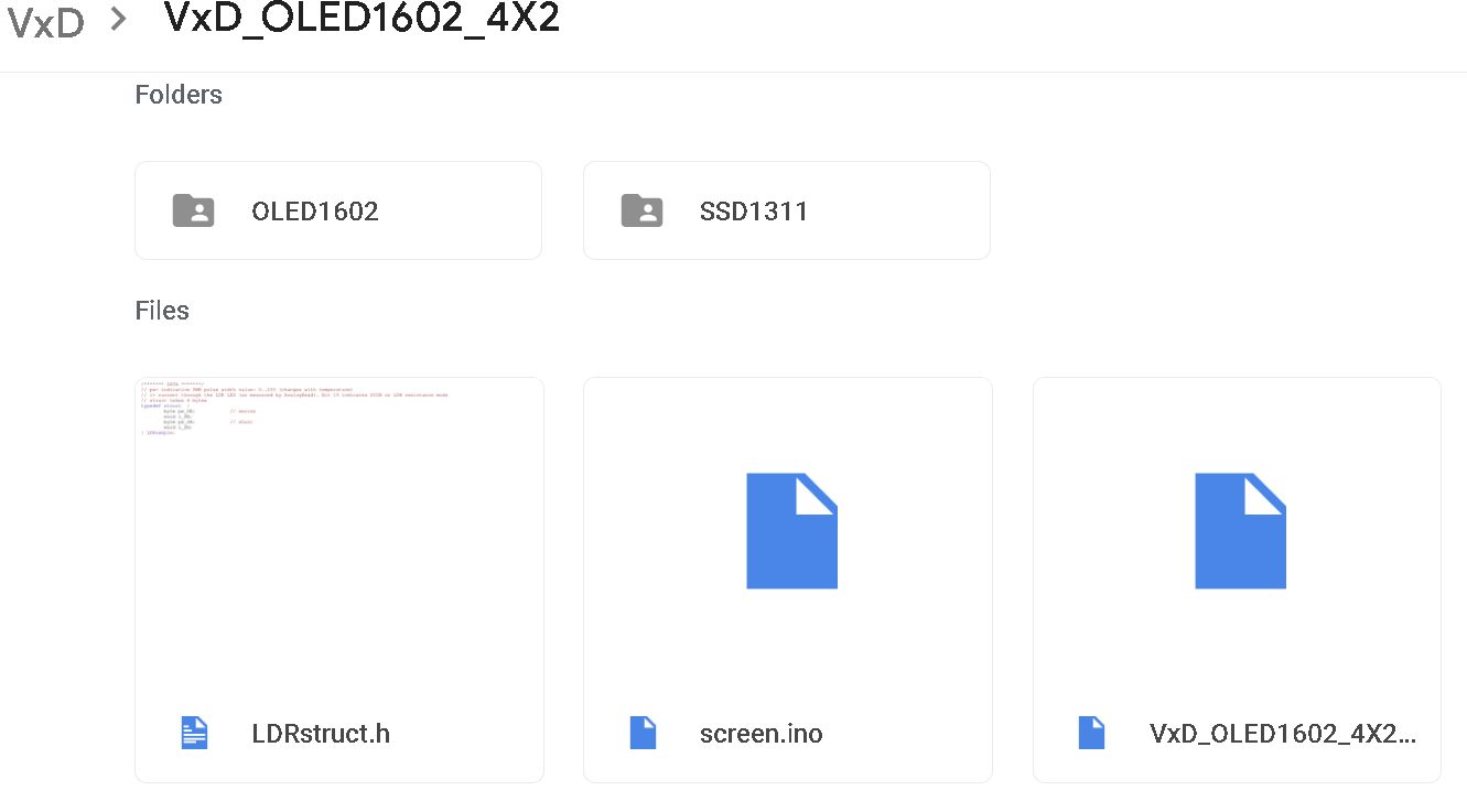

Newbie question here since I've never worked with any Arduino products or coding before.
In your list of files for the above eBay OLED display, I see 3 different files that end with the .ino suffix after clicking on the OLED1602 folder.
screen and VxD_OLED1602 as shown in the photo below and then there's a file called ExampleSketch listed.
Which file(s) should be used with eBay OLED display?

Looks like several people have built this attenuator, yet nobody can tell me which files should be used with the 1.6.1 installer?🙄
Neb, it would be informative if you could do a short YouTube video showing people every step to implementing the files in the link in your signature.
The files appear to be in zip(compressed) format. Extracting them is easy enough, but just what to do with them after that is anyone's guess I suppose unless your knowledgeable in Arduino products and coding, which I am not.
Also what isn't clear is getting the files from the installer downloaded to the Nano.
I'm sure there are many others out there like myself who don't know anything about Arduino products or coding.

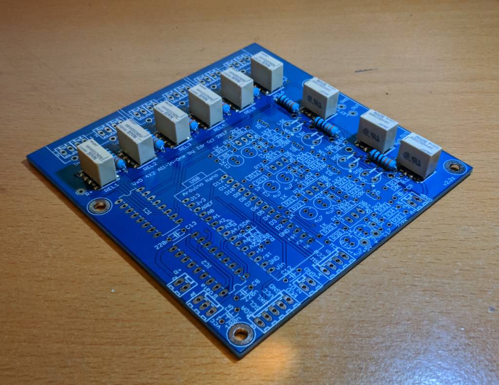

New boards just arrived, better and more complete than ever🙂 I have included new RCA footprints available widely from AliExpress, and also LDR test points.View attachment 682887
Hi ZDR,
How much for a single PCB shipped to Canada, Montreal?
Do
Is it possible to buy with relays but not soldered on PCB?
They are all soldered I'm afraid, so the answer is no.
