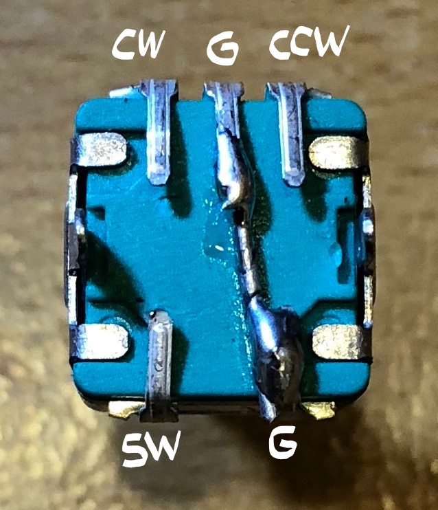

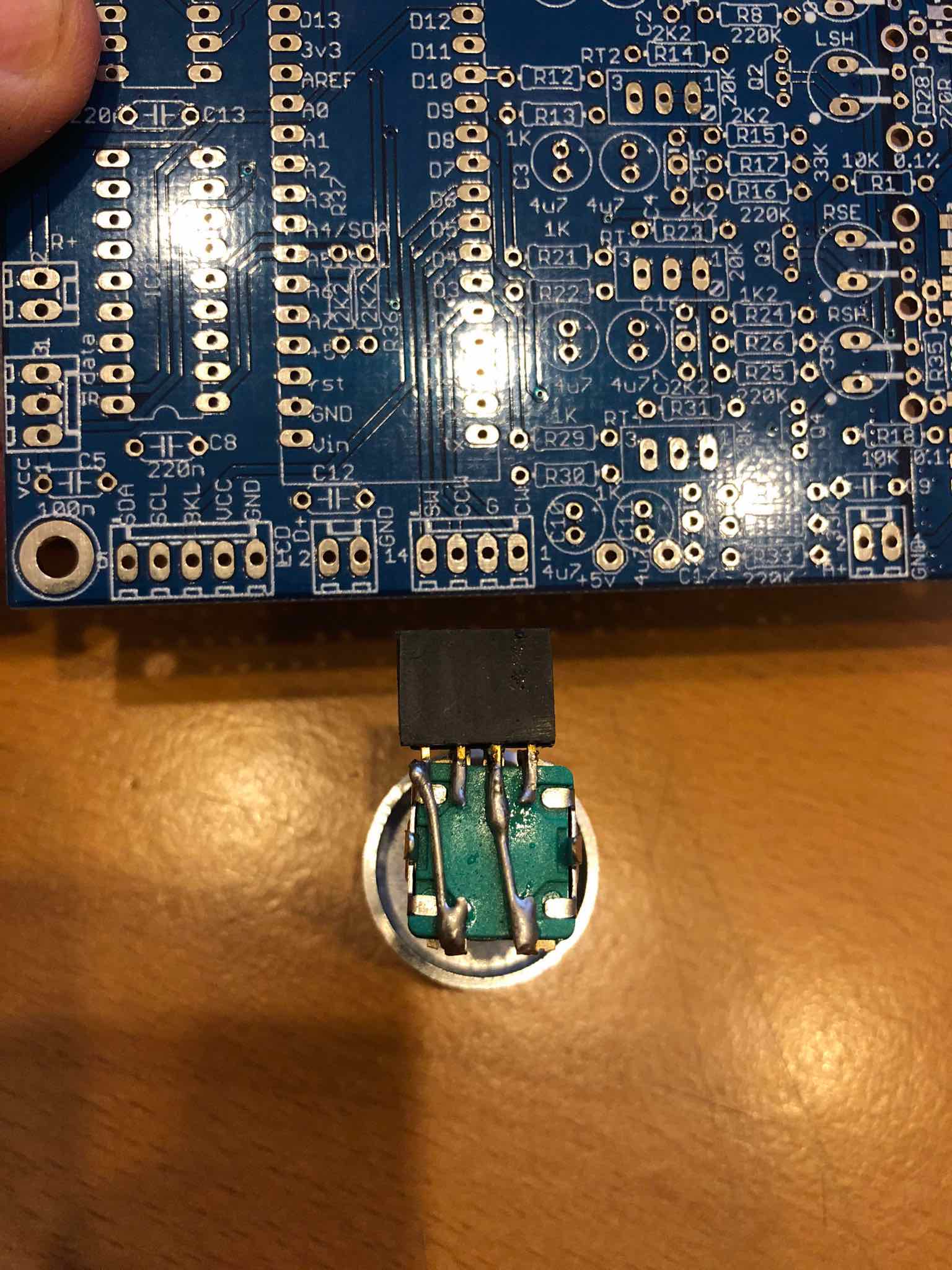

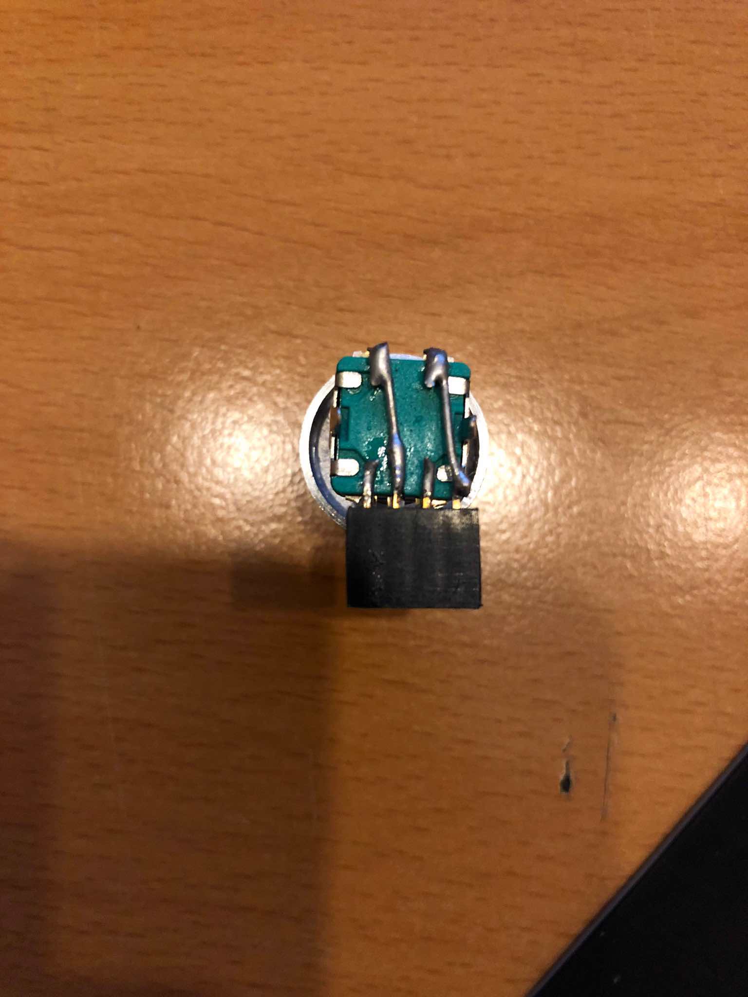

I don't understand how to connect the encoder to the board. I see 4 pads on the board-CW, CCW, SW and GND.
Looking at encoder's datasheet I see 5 terminals on it, none of which coincide with the board's connections of Clockwise, Counterclockwise, Switch and Ground as shown below.
I'm assuming the 2 connectors on top of the encoder are for the switch like shown in the datasheet.
Do I connect those to the SW and GND pads on the board?
How do I connect the encoder's Channel A and Channel B terminals to the CW and CCW pads on the board?
