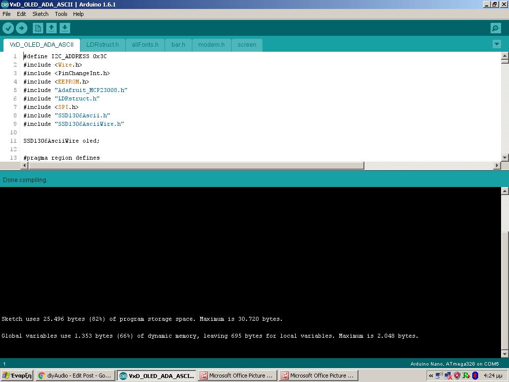

Done Neb ...
thank you so mush ...
this code fit to 1.3" OLED 128x64?

Nikosokey posted some OLED displays earlier, but those are quite small. I'm sure there are larger (2-3" diagonal) ones available too?

I found this 2.4" OLED from eBay: I2C 2.42 OLED 128x64 Graphic OLED White Display Hole( Arduino / PIC / Multi-wii) | eBay
According to my understanding this should be compatible with zdr's OLED code?
