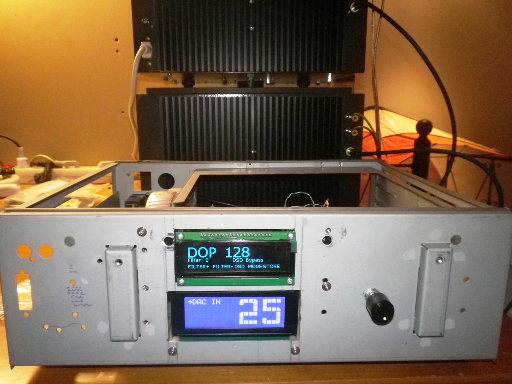

I have now one fully assembled and operational VxD with SR3. It failed to calibrate on first attempt, but calibrated on 2nd with 50 volume steps. There is no volume bump in the middle like I have with other two setups with SR2. It seems that LDR resistance is more unstable at >500K range, but VxD is not operating in that area anyway afaik.
Sent from my SM-G935F using Tapatalk
I tried with 60 steps, and the hump moved to step 29-30. This looks like a problem with the middle step.
Hi Neb this humb do you see it on the Osc only ,or do you heard also ?
I see it only on the Osc.
Also, the noise problem I had solved, i forgotten to put the Gnd from PSU to chassis.
