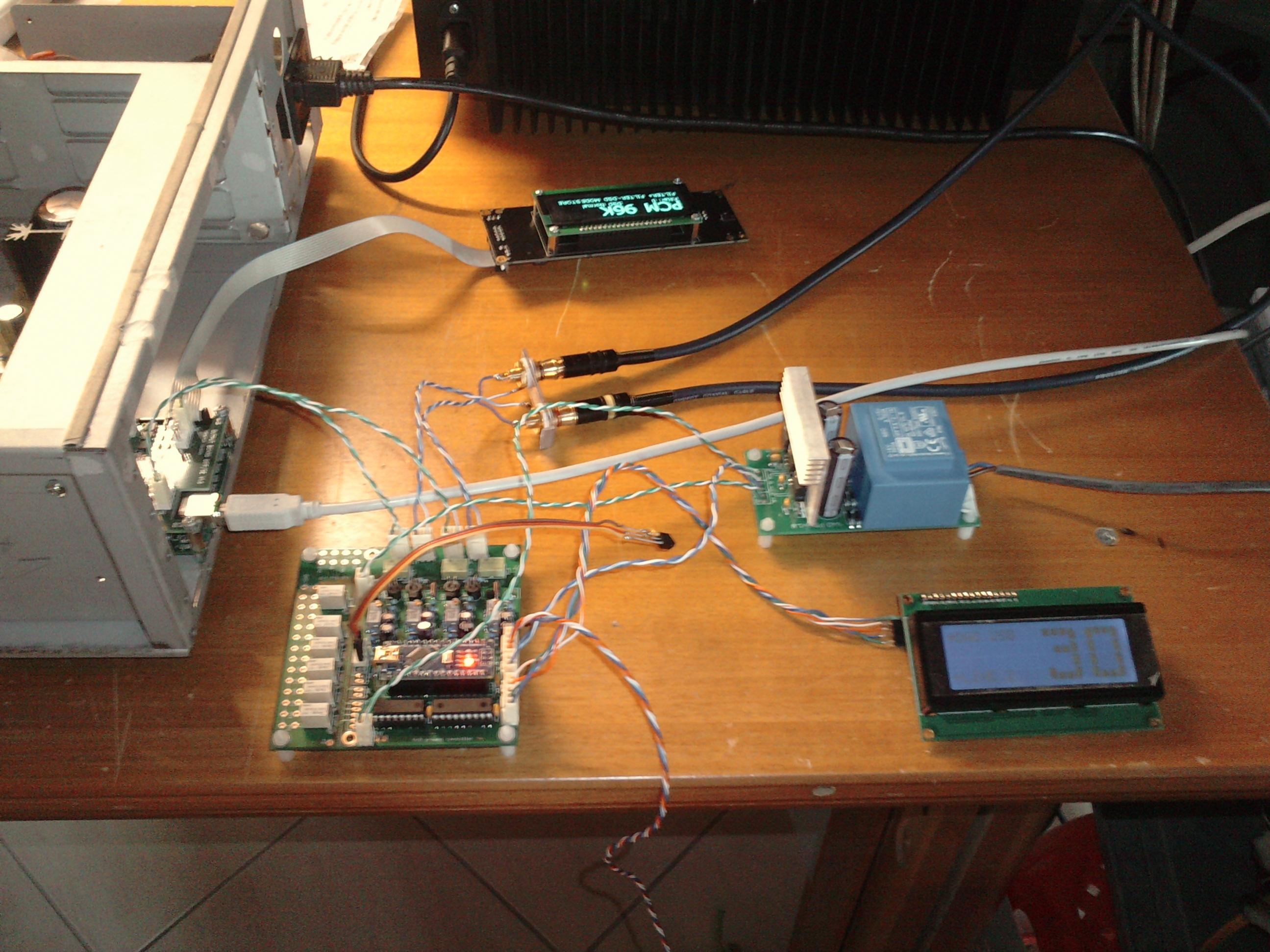

Is this with 25 or 50 steps?
I tried with 60 steps, and the hump moved to step 29-30. This looks like a problem with the middle step.

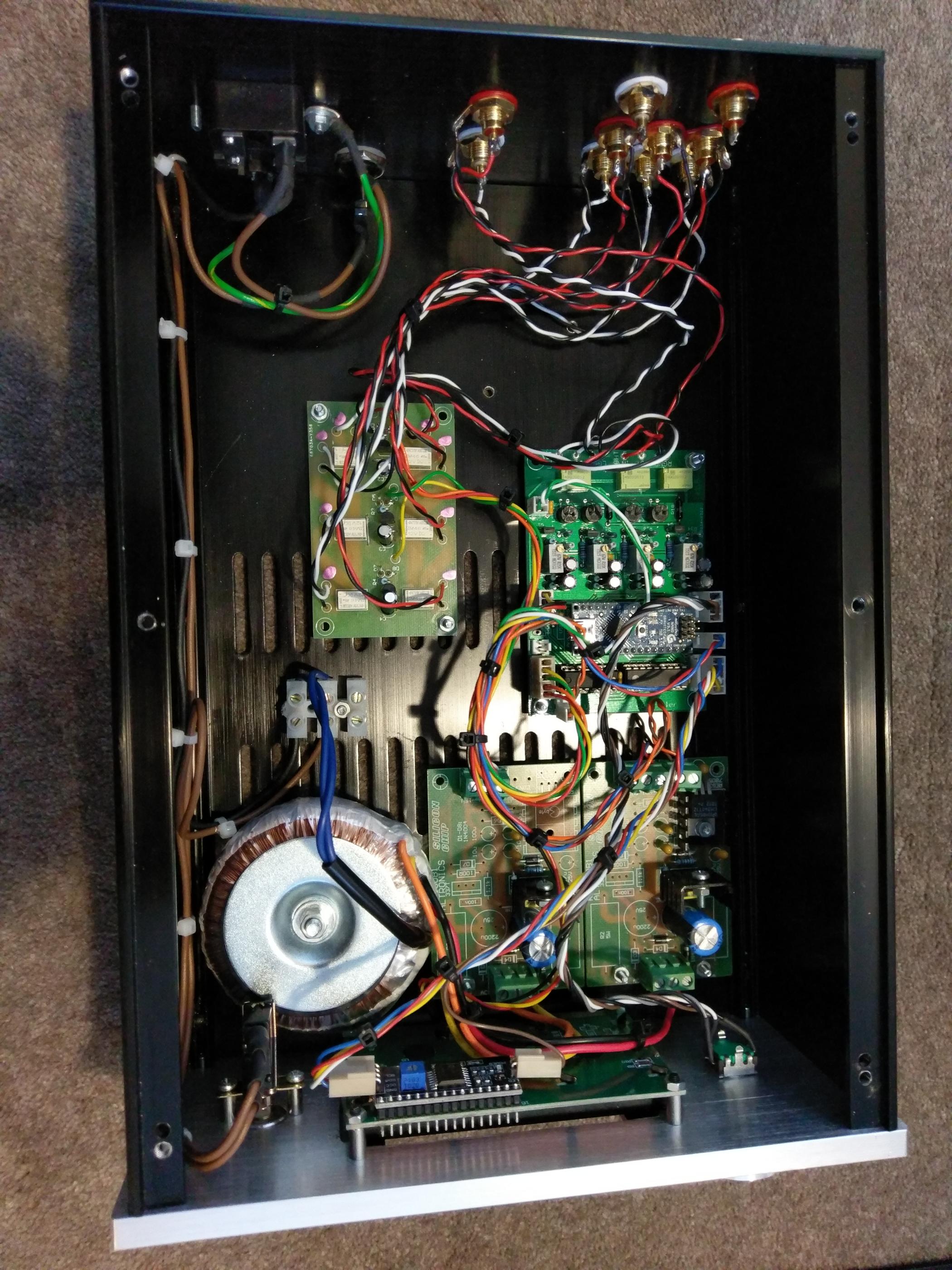

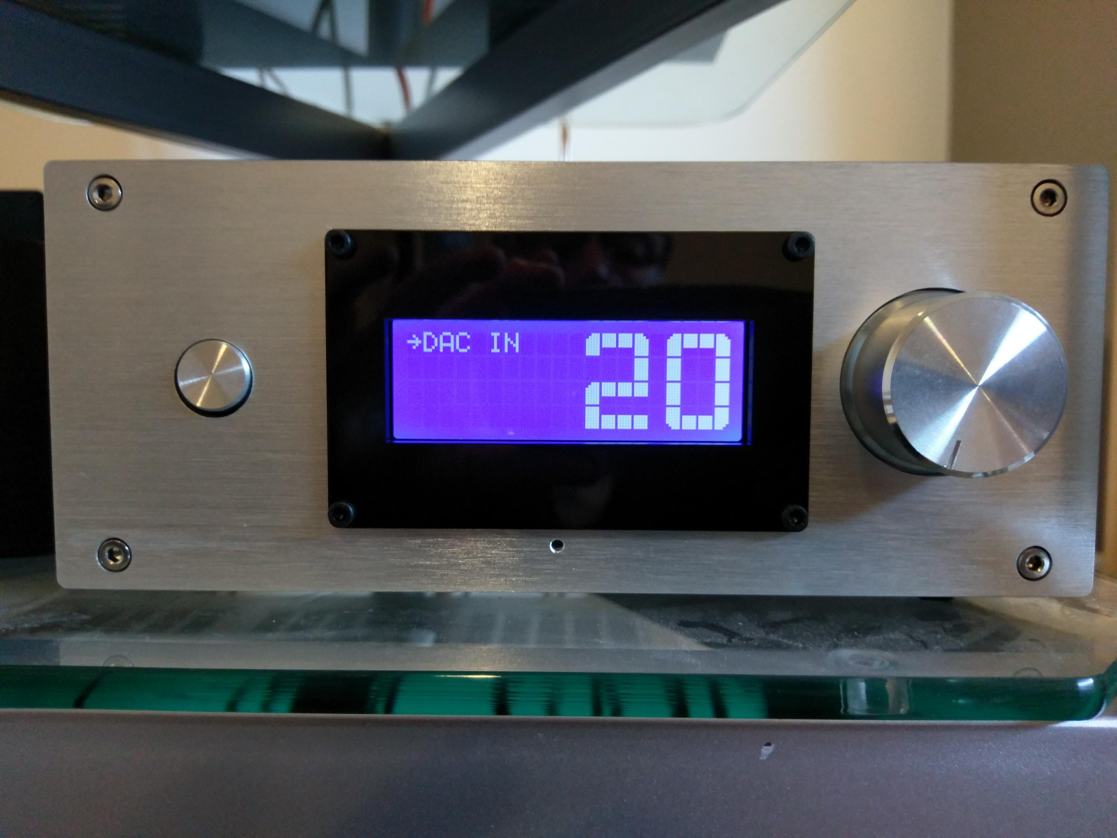

Nice work Nikos! Did you get it working with 5 inputs and 2 outputs?
Hi Paul
Yes it working good now with 4 inputs and 2 outputs.But i have little noise at the middle 30-35 of volume i think something happen with the way i pull out the Gnd input -output ,i think must pull out the cables from the same spot of GND.

I managed to write a very fast and compact OLED VxD code using SSD1306 Ascii library. It seems to have even faster refresh rate than LCD.
