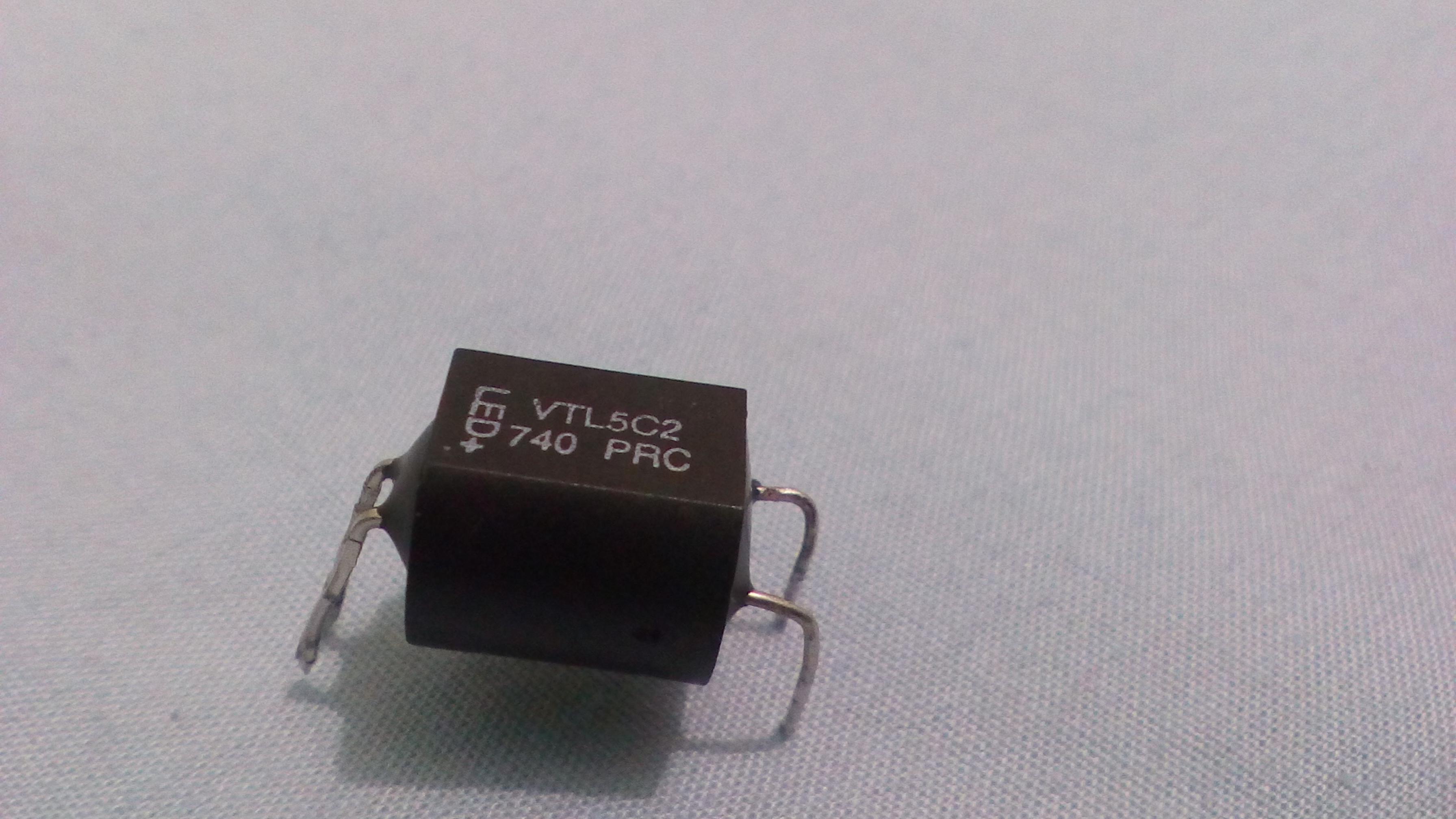

Arduino based LDR volume and source selection controller
The VTL5C3 and VTL5C4 could be better options since their resistance can go down to 1.5 ohm and 75 ohms respectively.
Don't believe it, I think it's a huge misprint on their data sheet.
I have 20 samples they sent to me of the VTL5C3's and the lowest I could get from all 20 was 500ohms at 50mA!! and 900ohms at 20mA
And their max rating is 40mA at less tha 25c for no more than 24hrs, with no input on the ldr side which would add heat.
Cheers George
