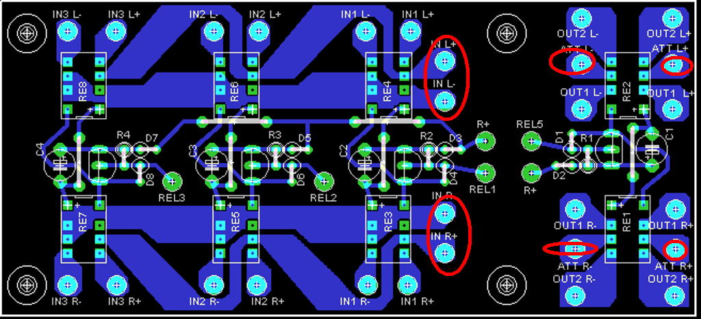

Hi
I have made my own pcb 5X8cm for my own relays Nais TXD2-L45 - 4.5V Latching DPDT that I had at my disposal.
the spots IN L+ IN L- and IN R+, IN R- go to the main controller in spots IN L ,LGND and IN R , RGND ?
The spots ATT L- ATT L+ and ATT R-ATT R+ from output relays where they are going;?
