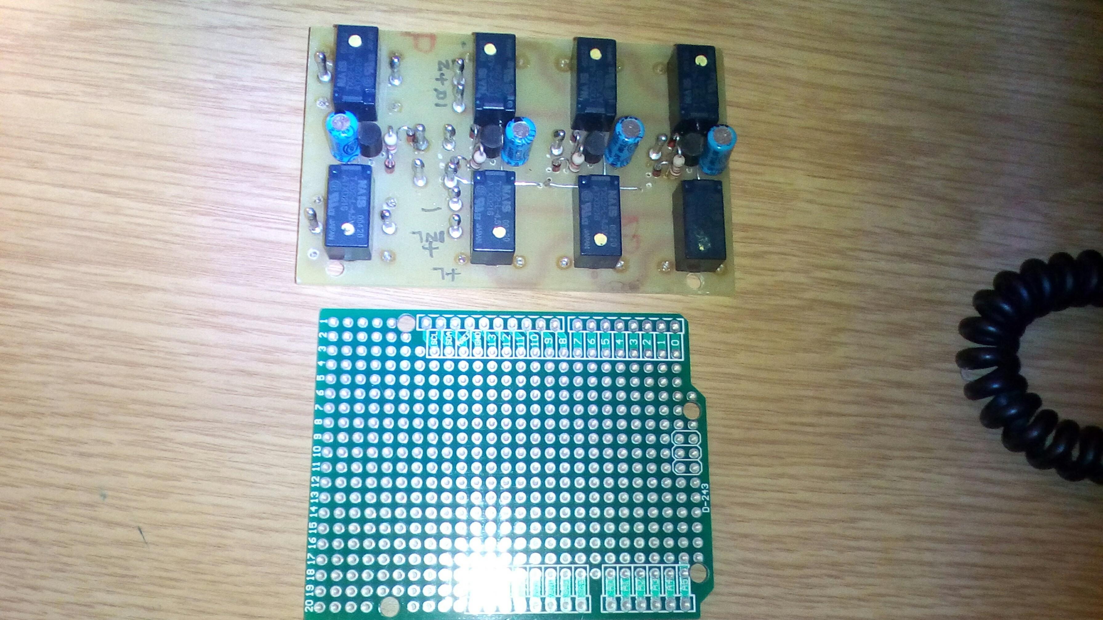

Pcb
My little board ....

I searched in the program and the documentation and i saw that i can't use IO boards for my use.
Can i use three controller modules in parallel, with a single module connected to the display and the three modules connected to the encoder ? Will it works ?
You would need one controller board as a master and another 2 as Slaves. But the current design does not support this. You could possibly use the Arduino Nano TX and RX pins to get multiple boards to talk to each other but you would need to modify the code to do so.
