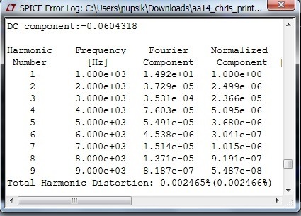

Hi. I added emitter resistors to the differential stage for better phase margin.
  • aa14_chris_printnik_vbemultiplier_bias setting to 60mA 4R__22Vrail.asc
Reactions: chermann

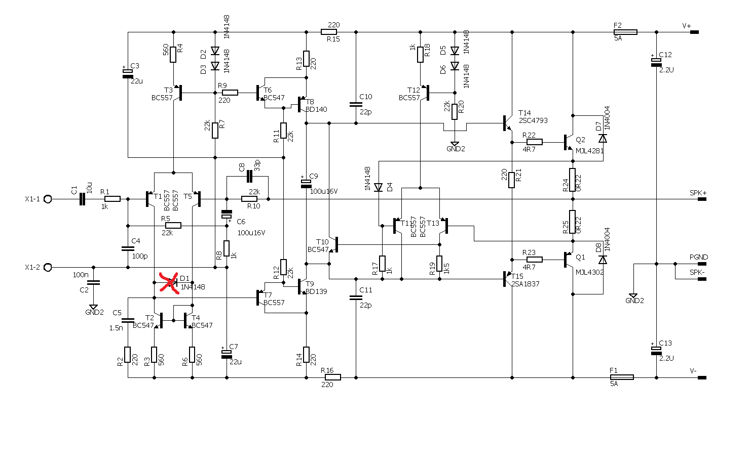

then i realized that the onsemi 1381 NPN is with hfe about 150 too much for the "auto biasing function" because if i change to the BD137 and BD136 which i had in the box- both amps are working and the ocp is not get on.
bias is starting with 1,44A @ 24 Volt and goes on one amp quicker then the other down to 1,250A
okay fine. but...
i had on the speakers measured the DC offset and i got at start up of the PSU 15Volt !! and then it gets more or less slowly down to 5V.
****.......this is bad!
so enough for today...
chris
"had on the speakers measured the DC offset and i got at start up of the PSU 15Volt !! and then it gets more or less slowly down to 5V."
I have the same problem with DC=18V. You can try to remove diode D1.
After removing, the amp started to work great and DC offset was 2mV.
Small signal transistors are BC550/BC560.

which transistor do you use for Vbe multiplier? is the TO92 as printnik supposed enough for class a biasing?
ok..thx.
you just remove the D1 and keep the auto bias transistors? or do you remove the auto bias circuit (abc) completely. i am asking because minek told that it has with abc the amp has bad THD.
what is your bias actually?
