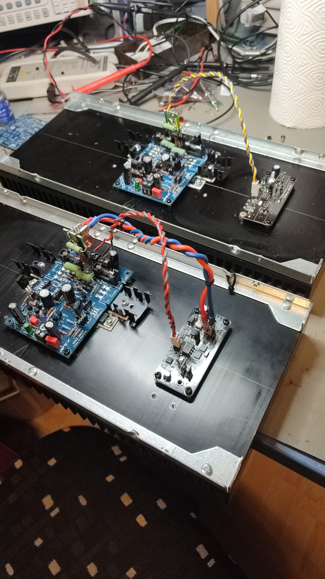

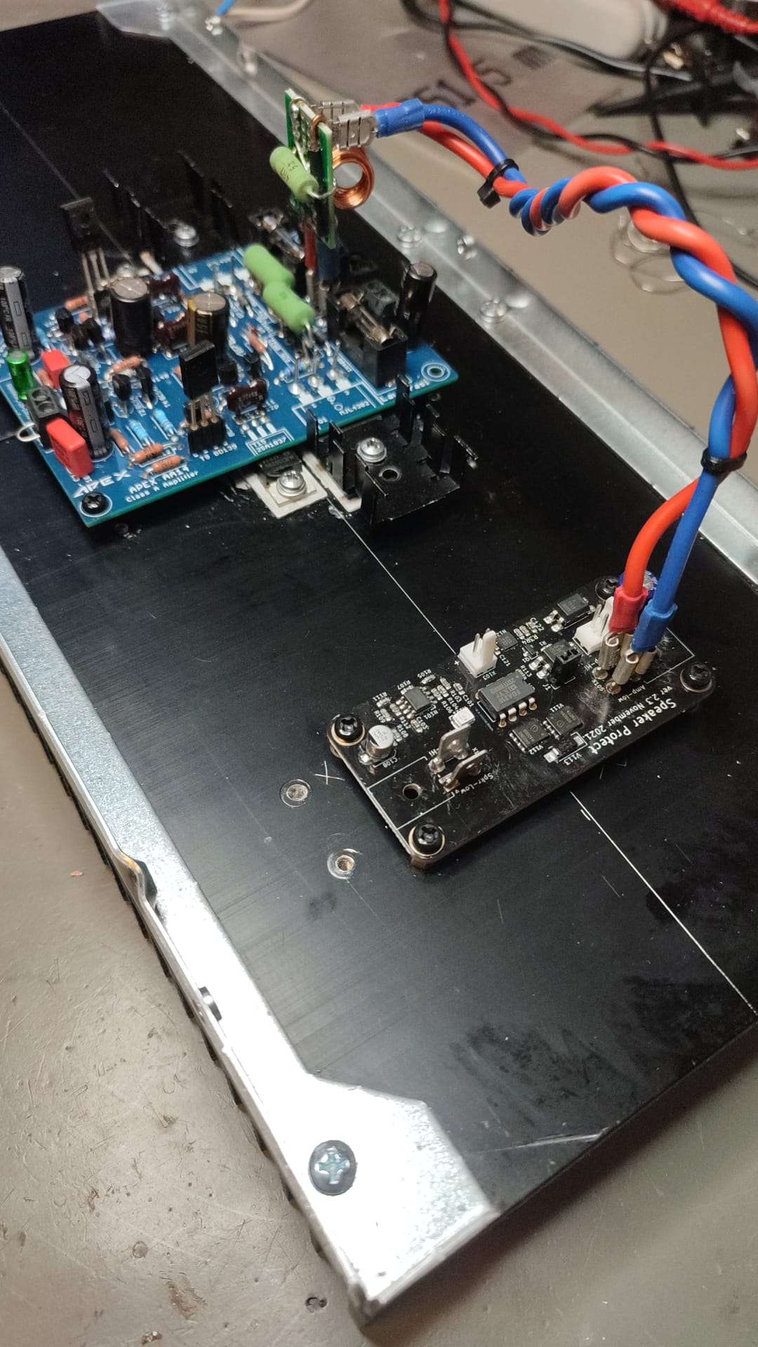

Hi
2nd Channel is working the same as in post above. same working amp like post 155.
that is fine.
i am happy to say that this amp is now ready for a case and listening...never hear a BJT amp.
open issue...
chris
that is fine.
open issue...
- is the switch on pop...i see about 2Volts peak on scope.....i will recheck.
- build a thiele network for the 2nd channel
- LT spice..OLG...i think i am really a noob...
chris

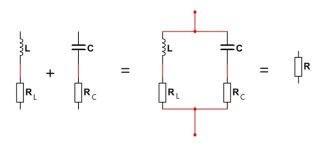

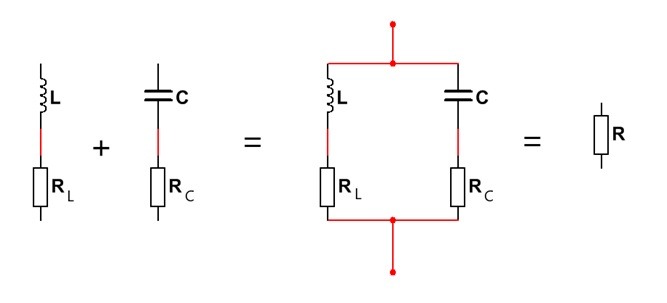

I always thought like this:i wonder what "Thiele Network" is meaning....if i look at such a network i think Zobel/Boucherot is the same ? Or is there any difference ?
"Thiele Network" = this is an electrical circuit L/R
"Zobel" = his is an electrical circuit RС
"Bouchero" = French mathematician's equation L/R=RС
when pulled wires across the Atlantic at the beginning of the 20th century - they all researched the same thing somewhere in the physics section to improve the quality of signal transmission...
Later, the applied value of these circuits appeared with the development of audio amplification.
Yes.Wonder if Mr. Thiele is the same in Thiele and Small parameters ...
Both the Zobel circuit and the Thiel circuit are used to a large extent in acoustic systems to increase linearity - this is relevant there. In amplifiers - of an applied nature only.
the Thiel circuit protects the feedback circuit from the capacitive nature of the load, and the Zobel circuit corrects the increase in output resistance due to the current through the coil flowing in the opposite direction.

The author wrote, everything seems to be correct, but he forgot to attach the Thiel coil to understand how the Zobel circuit works.Hi,
found this, but in german language, month ago. https://www.elektroniktutor.de/analogtechnik/zobel.html
Also began to write well with the study of wires, but I created a model for analysis unsatisfactorily; it was necessary to compensate for the linear resistance of the wire in order to study the influence of the linear capacitance and inductance of the wire.
article at the link - "befriedigend" ))) in general terms it seems normal, in a specific case it’s not entirely clear.

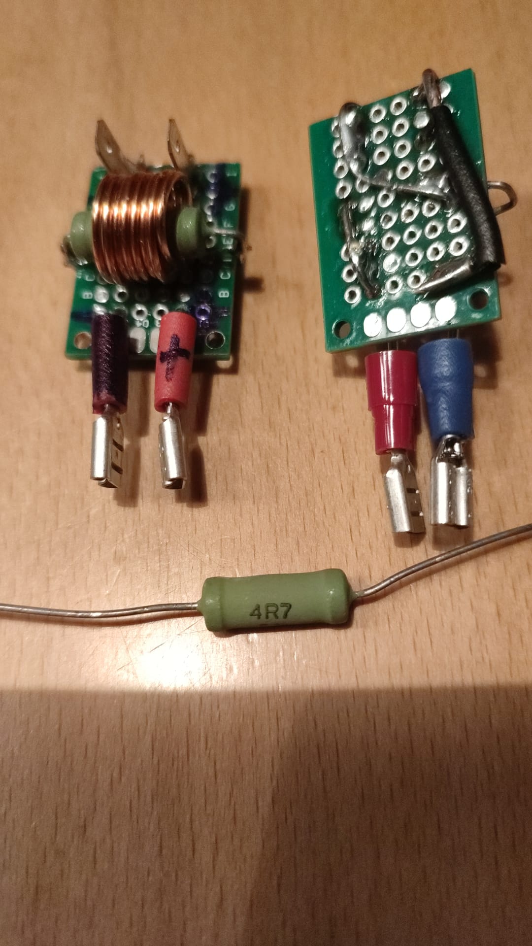

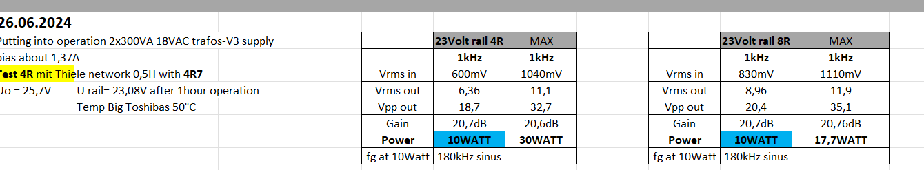

Hi
Because i do not find the other 3R3 for the Thiele Network 2nd channel i have to change it to 4R7 for both channels...
so i have got more damped network.

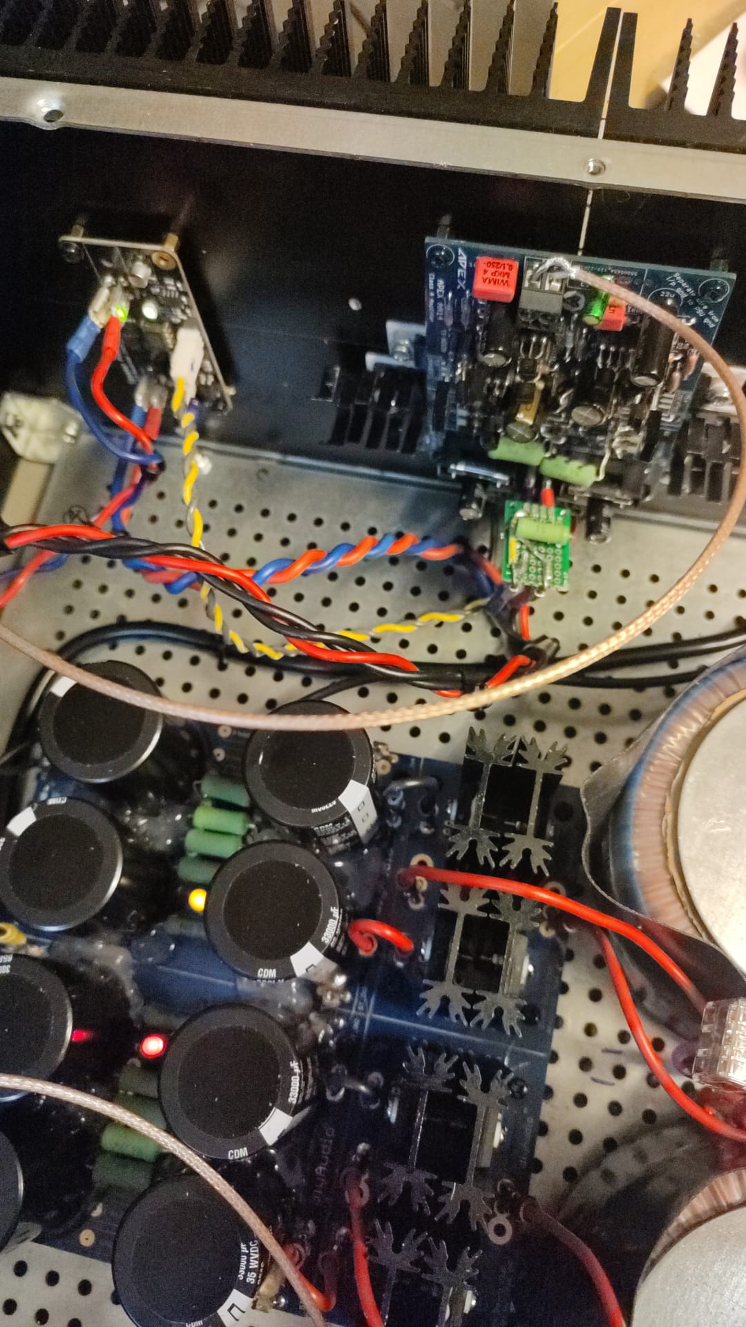

next step is to use the M2 chase where i have the defetct ecdor transfomer. i want to listen to this different (edcor vs Hammond 109N)audioformers then i will use this housing for the AA14.

A resistor parallel to the inductor in the Thiel circuit must be connected to the outside of the turns.Because i do not find the other 3R3 for the Thiele Network 2nd channel i have to change it to 4R7 for both channels...
There should only be air inside the inductor of the Thiel circuit.
