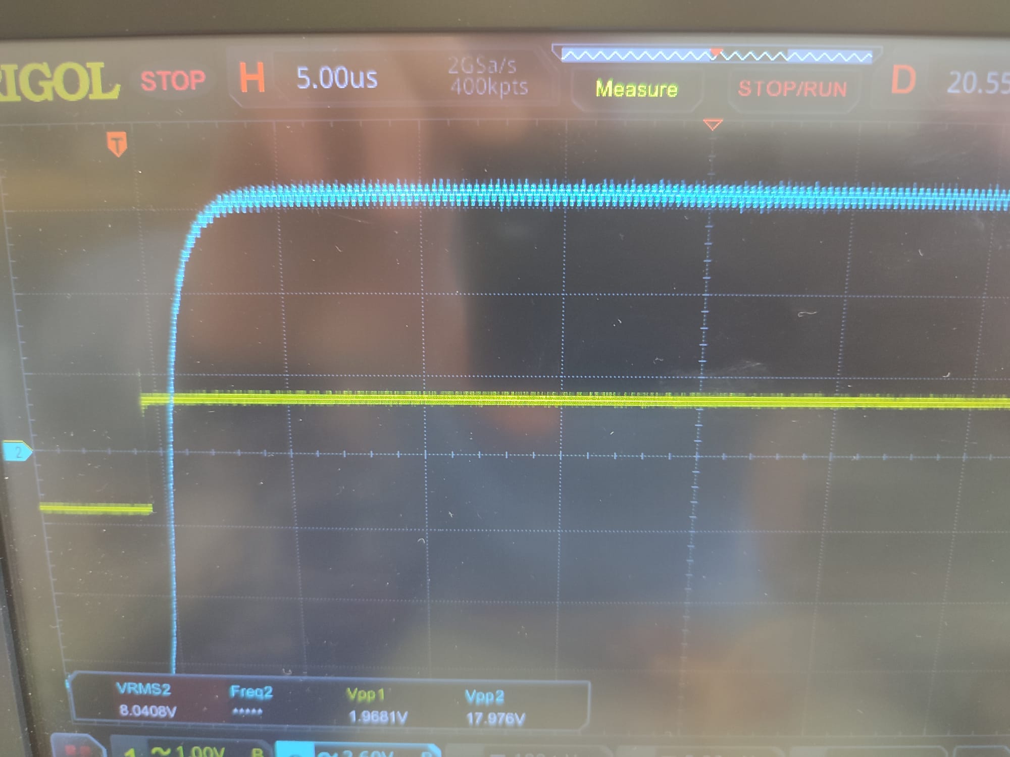

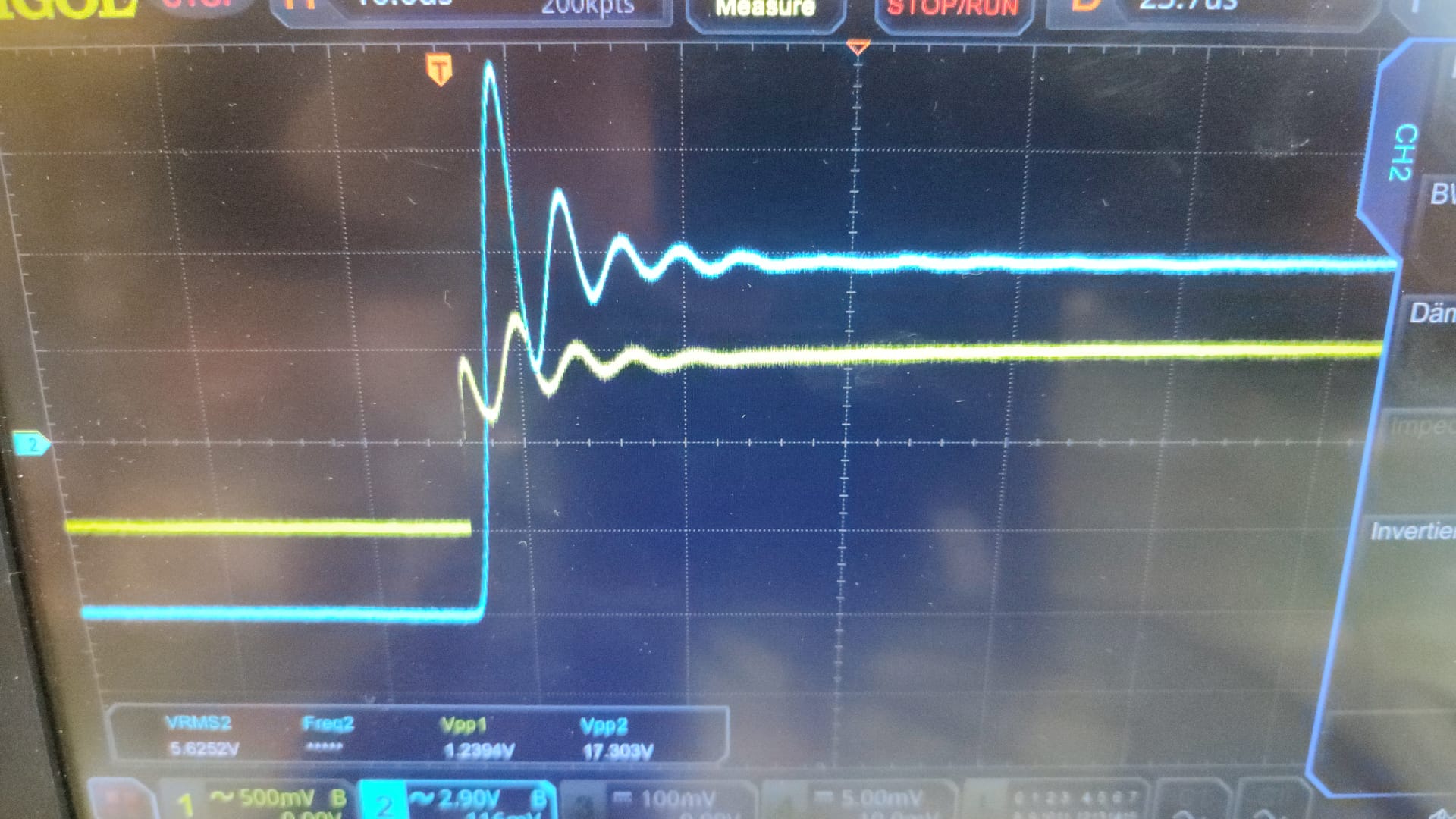

nope...its not so good...47nF is still oscillation...not big.....but...

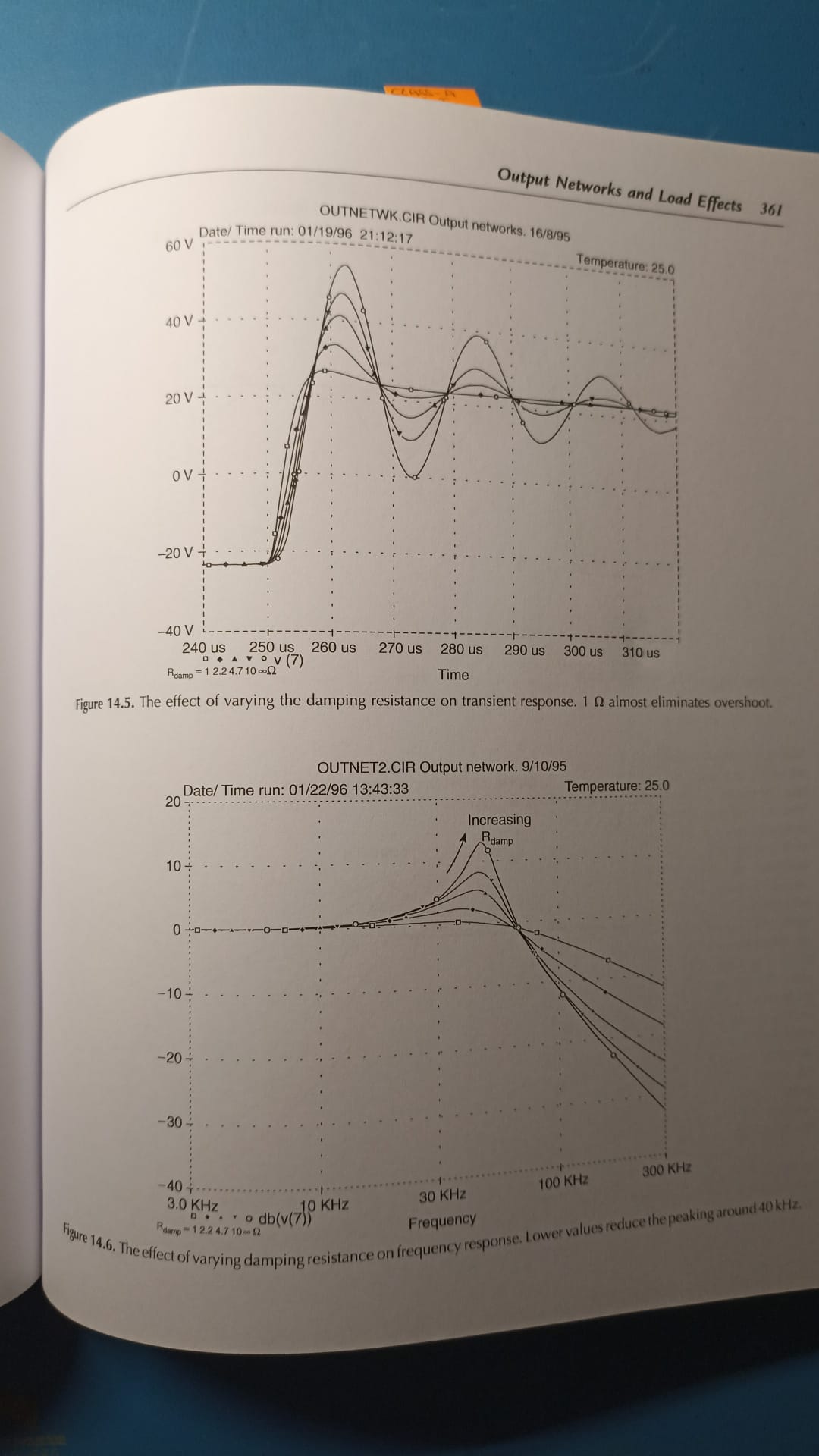

I have got the page from my brother because i do not own that book.
here :

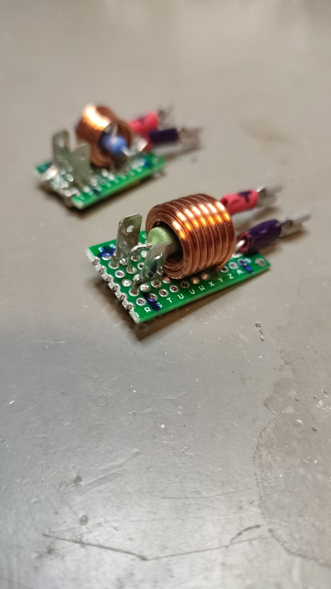

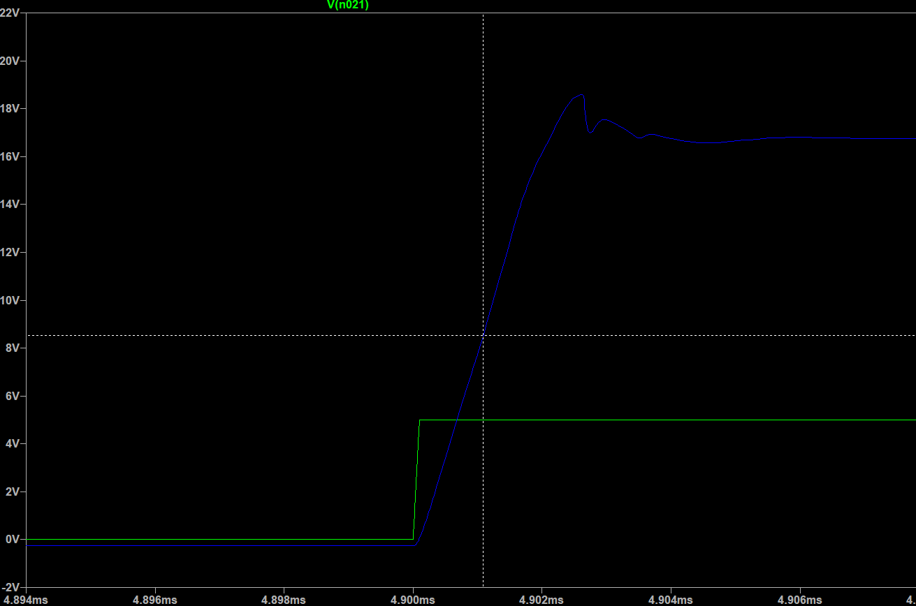

next try....1µH and 6R8 (good to know that i had some old AVR´s..)
the simulation is looking more worse then the real amp...
in the simulation i realized that i have done a typo...if i made a comma it is not working and therefore i use 5µH(typo)...this is nonsense.
if i check and try out some values i found that with so with 4ohm its about 1µH and 2R and its fine...with 8R its a bit worse.
i will check at the real amp and post it in the next hours.

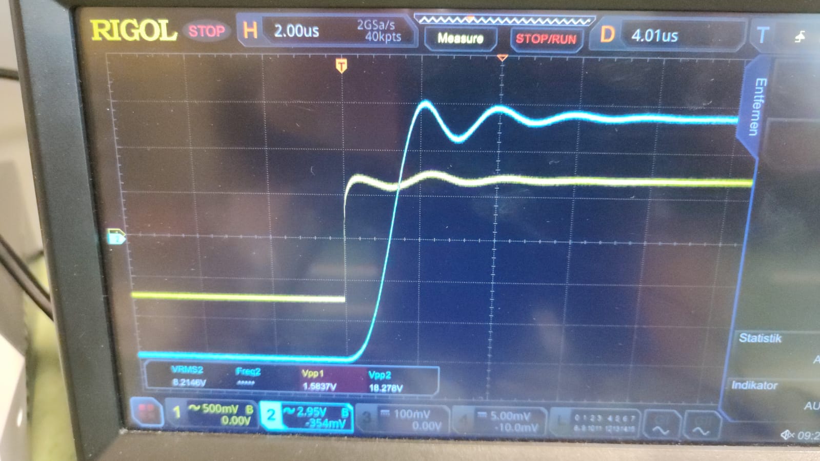

test with 220nF looks okay...and i have to switch off this lamps
square wave 5W into 6R
with 470nF it is not really nice..
what do you think?
is that okay...or enough damped?

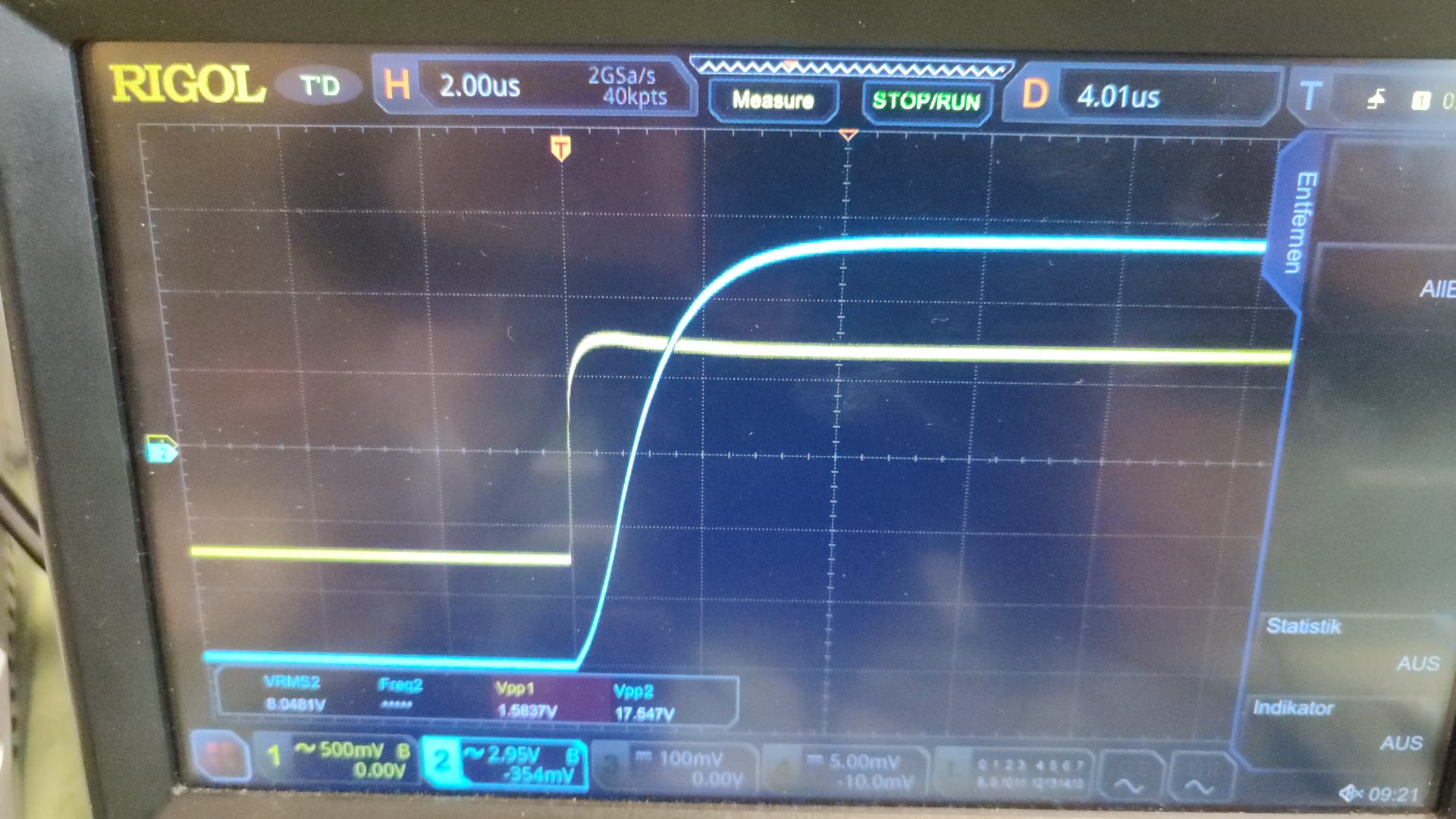

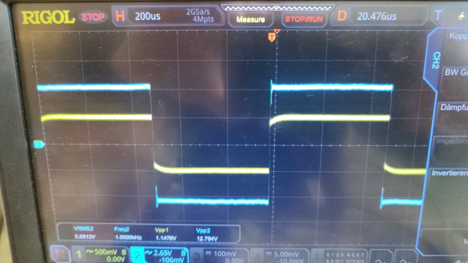

i measured the slew rate with the stronger Thiele and its just about 4,3V /1µsec
with the smaller filter - 0,5µH//3R3 i have got 8,85V/1µsec

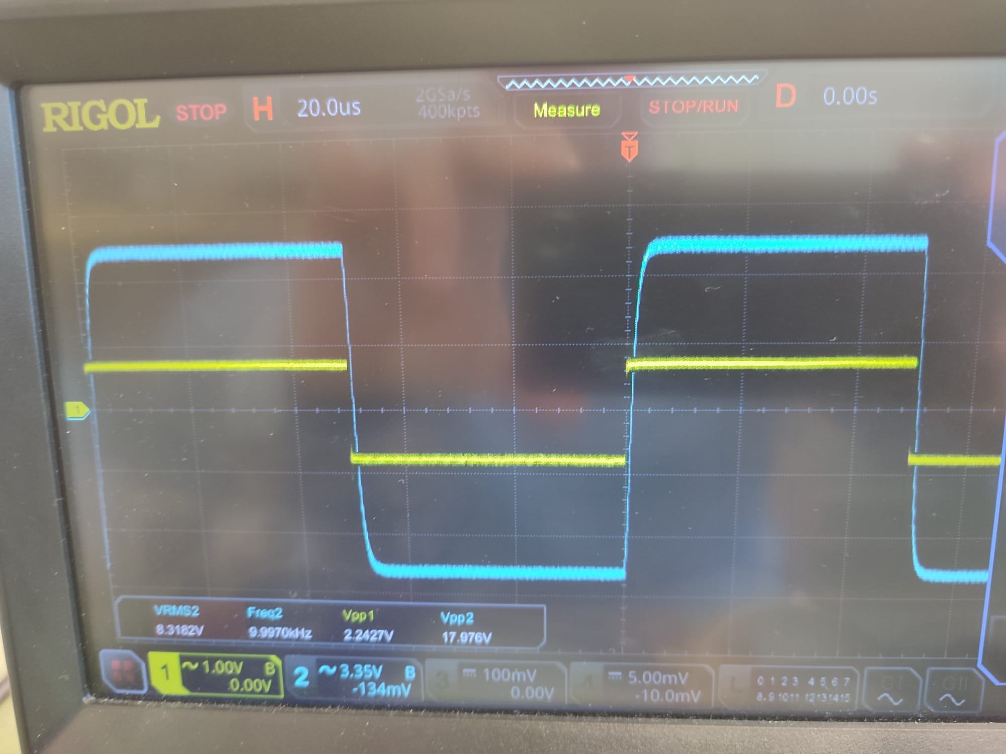

i did the measurement again with a other cable to couple the signal into the amp and i have got better results.
you see it on the scope that the yellow line...input gets with bad cable a ringing too.
here you see the smaller Thiele network with square wave 10khz and 220nF...for me it is very good.
second pic is the slew rate with 20Vrail and no cap load...just 6R

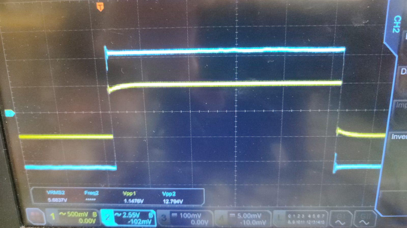

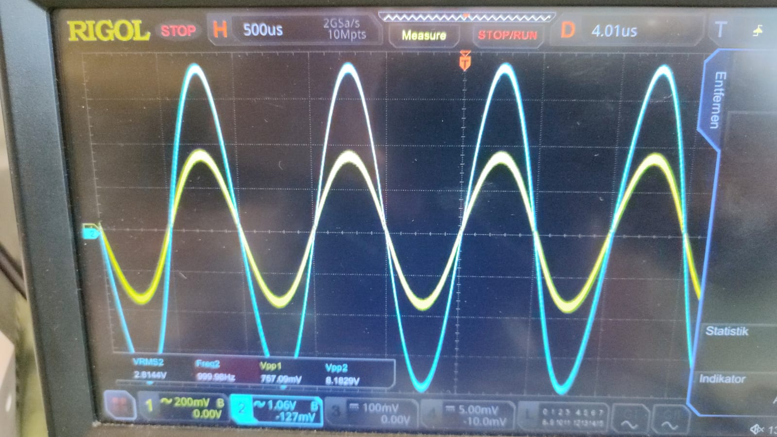

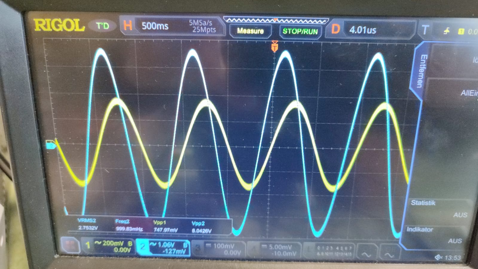

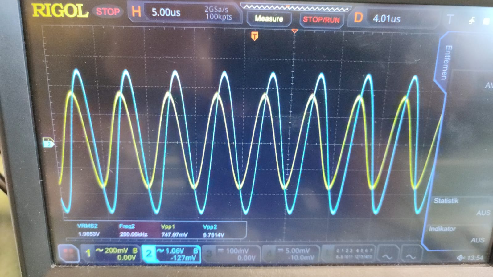

i did a short fg check....with 700mVrms input i got 2,8Vrms into 6R so it is about 1,3WATT...
with 8,2Vpp at 1kHZ its about 5,8 at upper fg
low fg is under 1Hz...top is 200kHZ

chermann, I have read before that it is better to mount the resistor on the outside of the inductor, a while ago.
