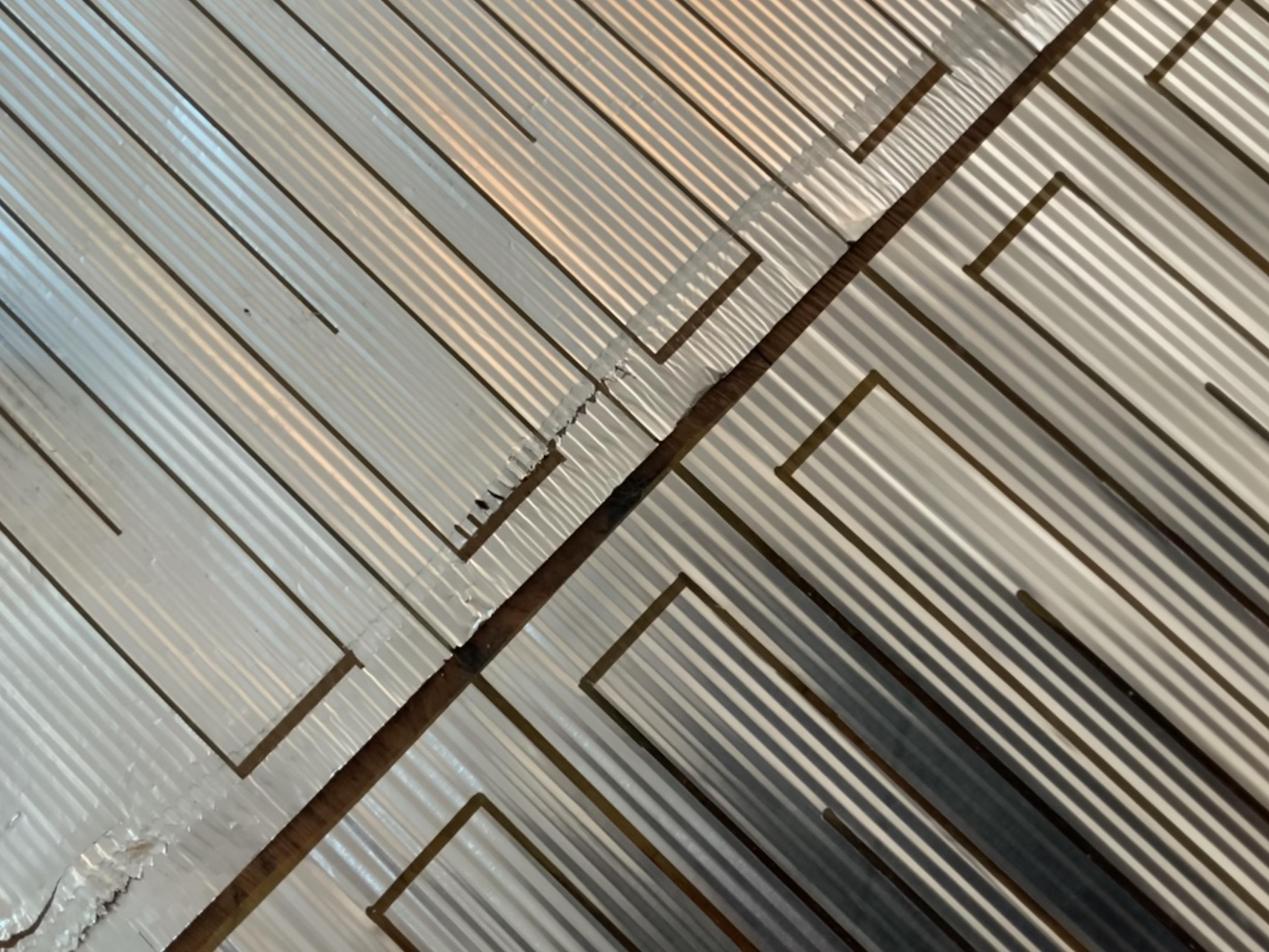

All this talk of refurbing Apogees got me re-interested in finishing my Scinnies bass panels...anyone know where I can get new Mid/Tweeter ribbons for Scinnies? Also would be interested in trying a DIY effort for an experiment...

So here is the corrugation and its not like you can find an abundance of choice out in the market on what will work.
We do want a cheap solution to work with.
Even though it doesn’t match exactly, the actual height is in comparison is the same although it looks higher.
My cuts are bigger and that will more than likely result in less output but every frequency graph I have seen on Apogees shows huge bass gain relative to the rest of the spectrum.
The Scintilla being one of the worst at 10 to 15 db so maybe a good thing in the end.
Time will tell and a new template with thinner cuts is possible.
This is the first panel attempt I made so go easy
This i so impressive. I have worked on a corrugator for many years and I have not been successful so far. The problem I have experienced is that it misalign during the corrugation. I am now working on a new one. Could you share a picture of your corrugator? I am at the moment using uncorrugated aluminium and foil witch works, but I am wondering how a properly corrugated will sound. By the way I am using a DIY Krell KSA100 II (Jims Audio) with a little modification with 12 output transistors pr. side. Fully biased into class A and it sounds wonderful. 1000VA Toroidal trafos pr. side. This only shows the potential of this type of speaker and the ability it has to surprise you time and again.
