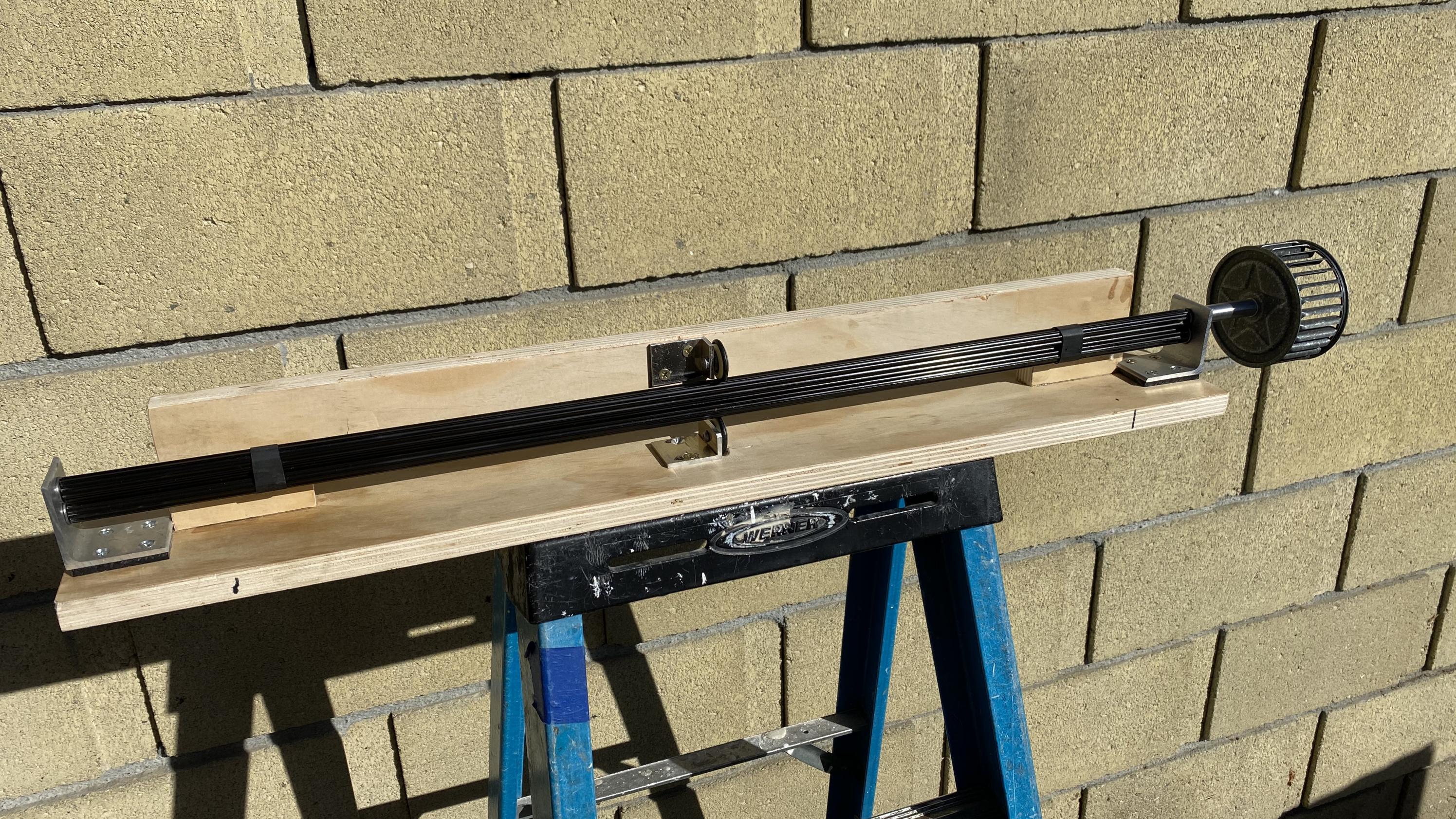

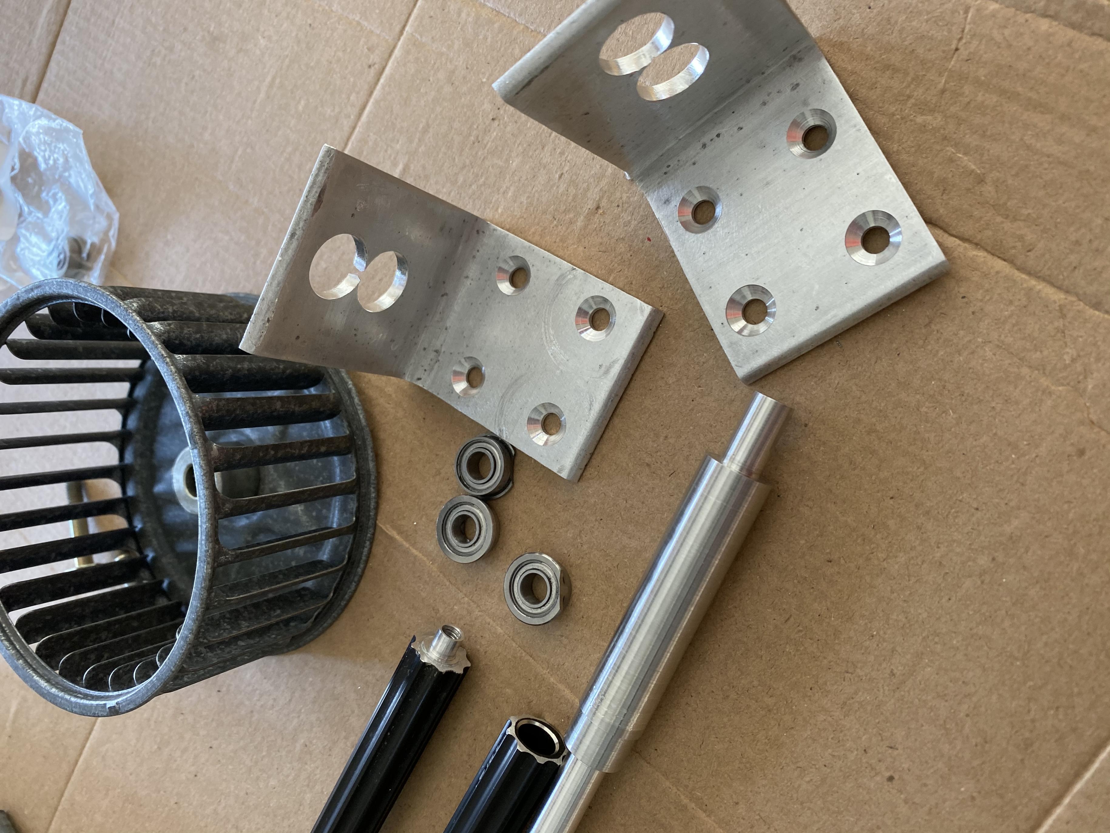

The rods you can get at DRP performance (off road) supplies. Anodized aluminum
They do sell an 1.125” diameter rod BUT it has same 9 peak profile as the 1/2” shown here and would be spread out even more and why I didn’t use the bigger version.
You will notice that the peaks and valleys do not follow a perfect 1 to 1 ratio as you would in say , straight cut gears in a racing transmission for instance, but anything in this length is difficult to find and while not what I would want ultimately, it is what it is..

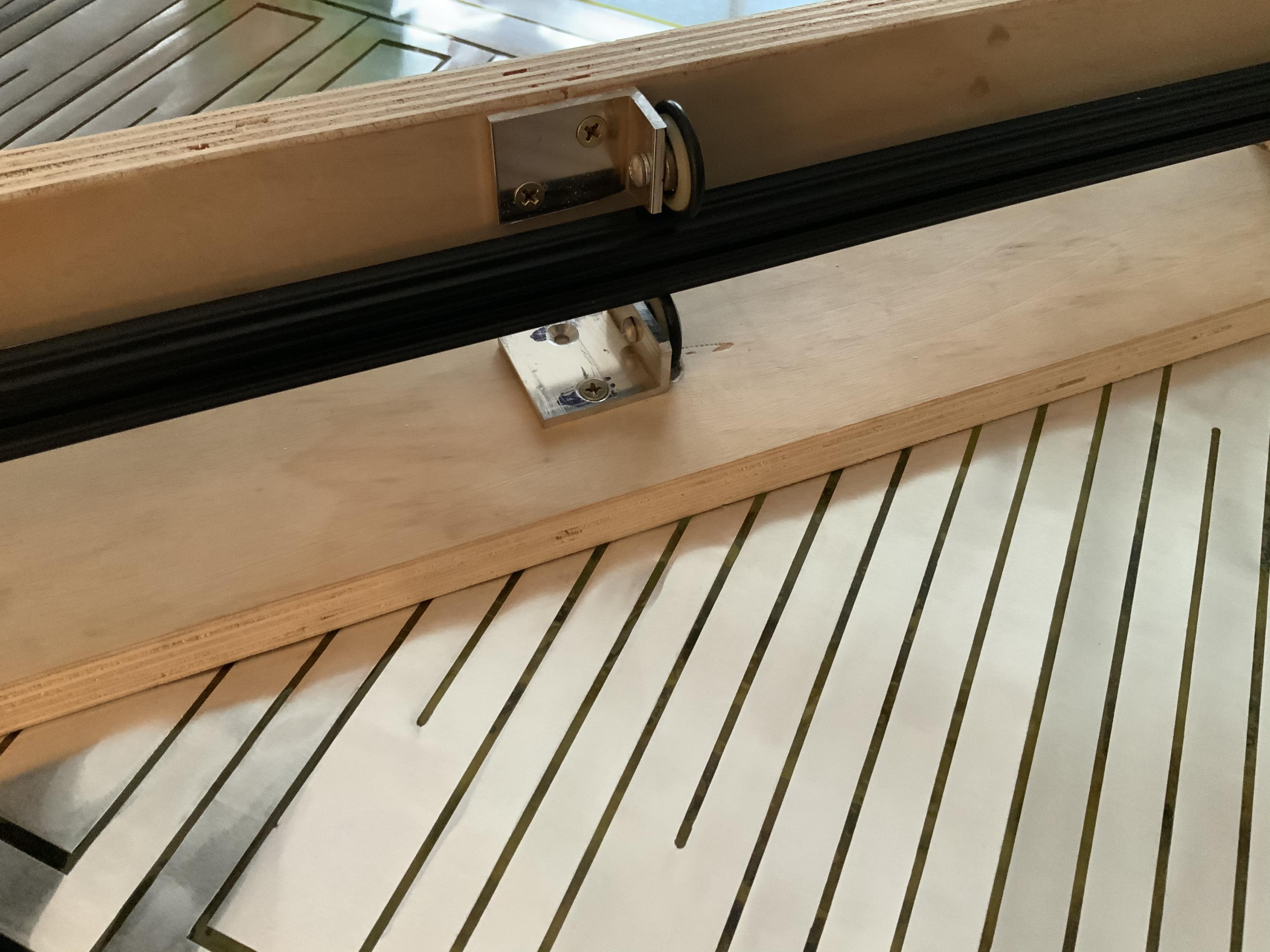

From “L” bracket to L it is 30” long with a 20” cutout area
I did place some cutoff inner tube bands for a little more pressure on the rods
With a little spray lube to rotate easier
Less than 50$
I did think about a spring pressure upper rod with slidable greased plates on the outside L brackets
and might go this route since I would like to try the bigger diameter rods on another set
of wave cut foils

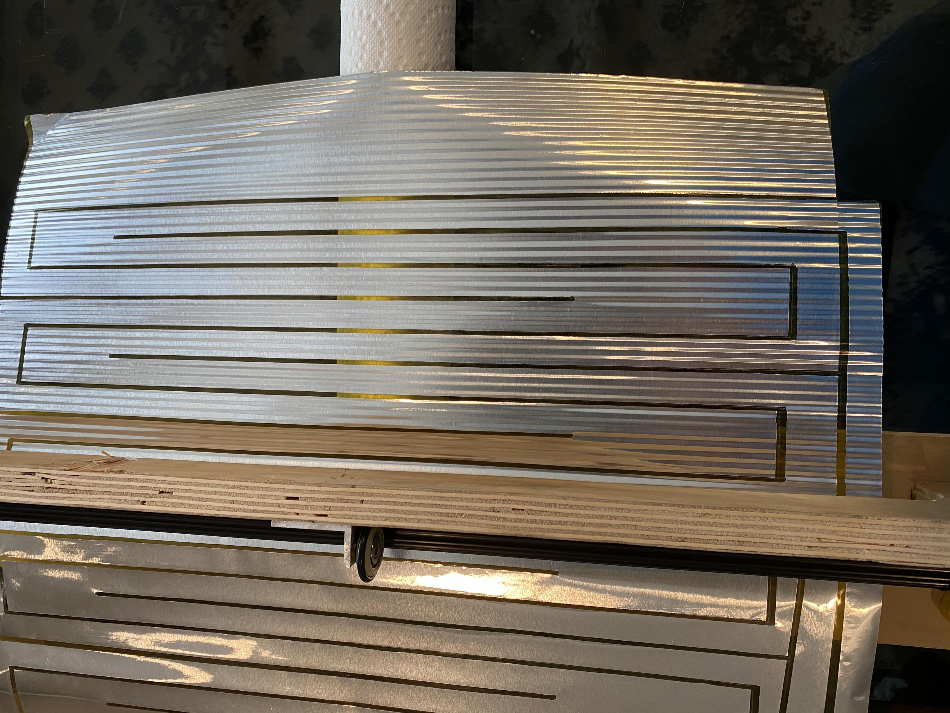

Post #118 is a comparison to a stock foil vs my version and 119 is the
complete panel
The peak of the corrugation does touch the valley depth but it doesn’t follow it perfectly
because the valley width is wider than the peaks profile
Not perfect , but close enough for a bass panel
Drp performance has all widths and OD diameters and made of 6061-T6 anodized aluminum
