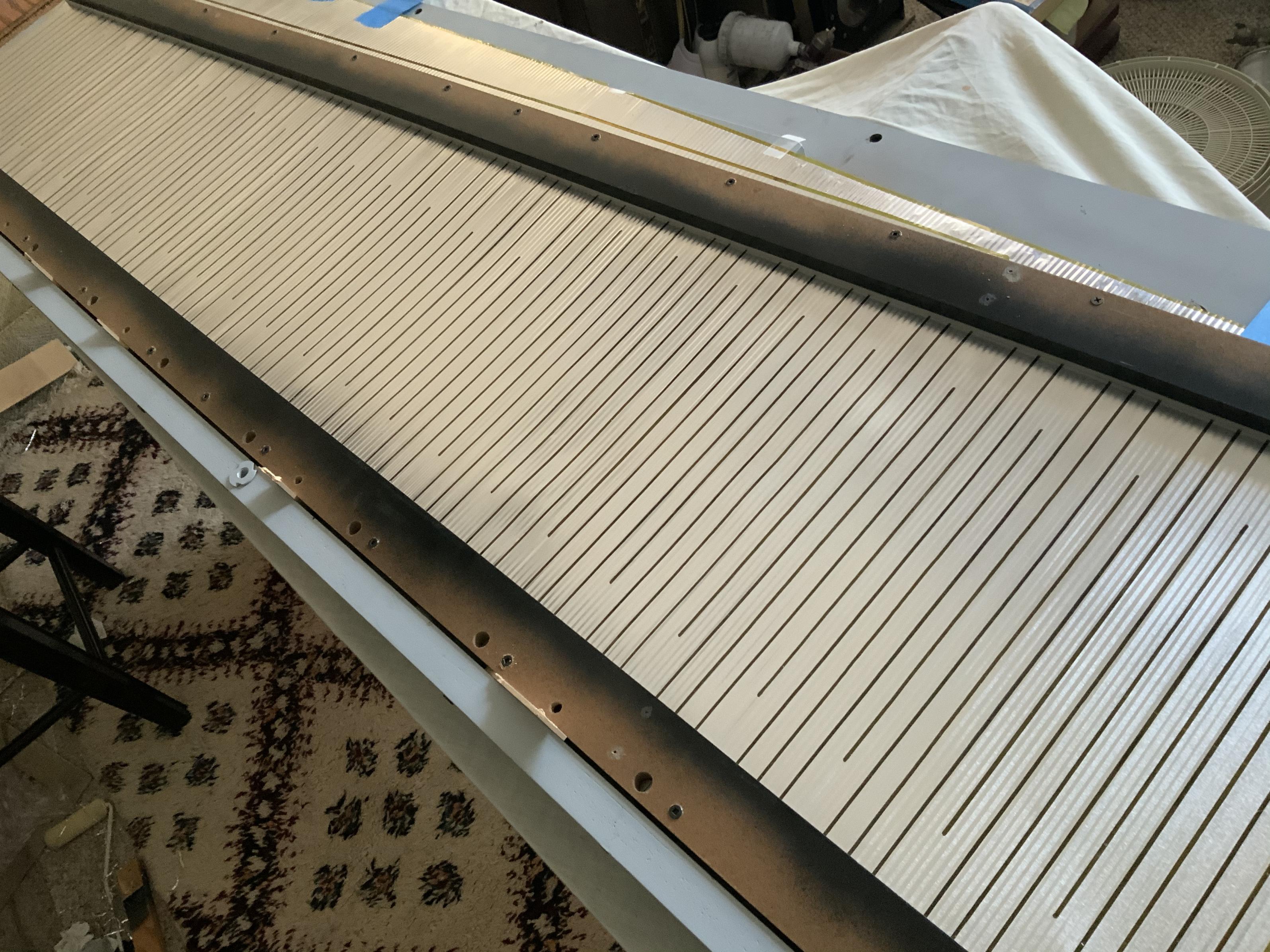

Just glued it up and a 24 hour dry time for the silicone to dry and then tuning the panel.
I ran a stretched fishing line underneath down the center of the magnets to keep the panel sag to a minimum while it drys
This equalizes it somewhat before you stretch it horizontally to keep it consistently straight.

BREATHTAKING!
If you go back to post #76 where I started, I detailed everything done to get to this stage and it’s not exactly an easy affair.
