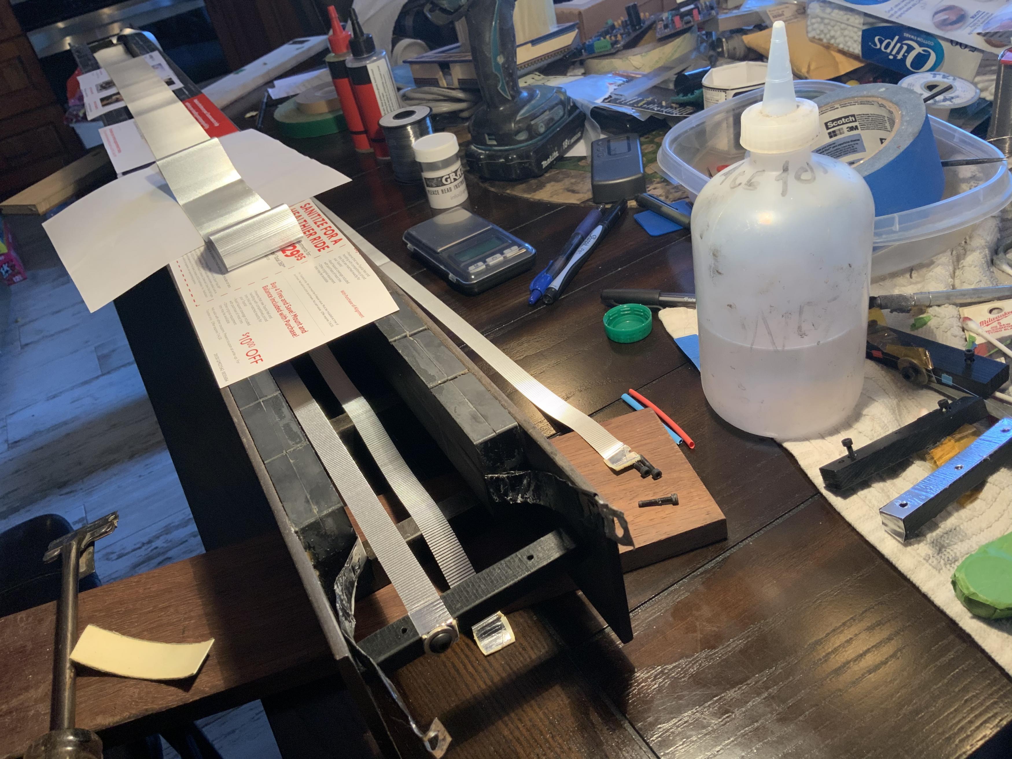

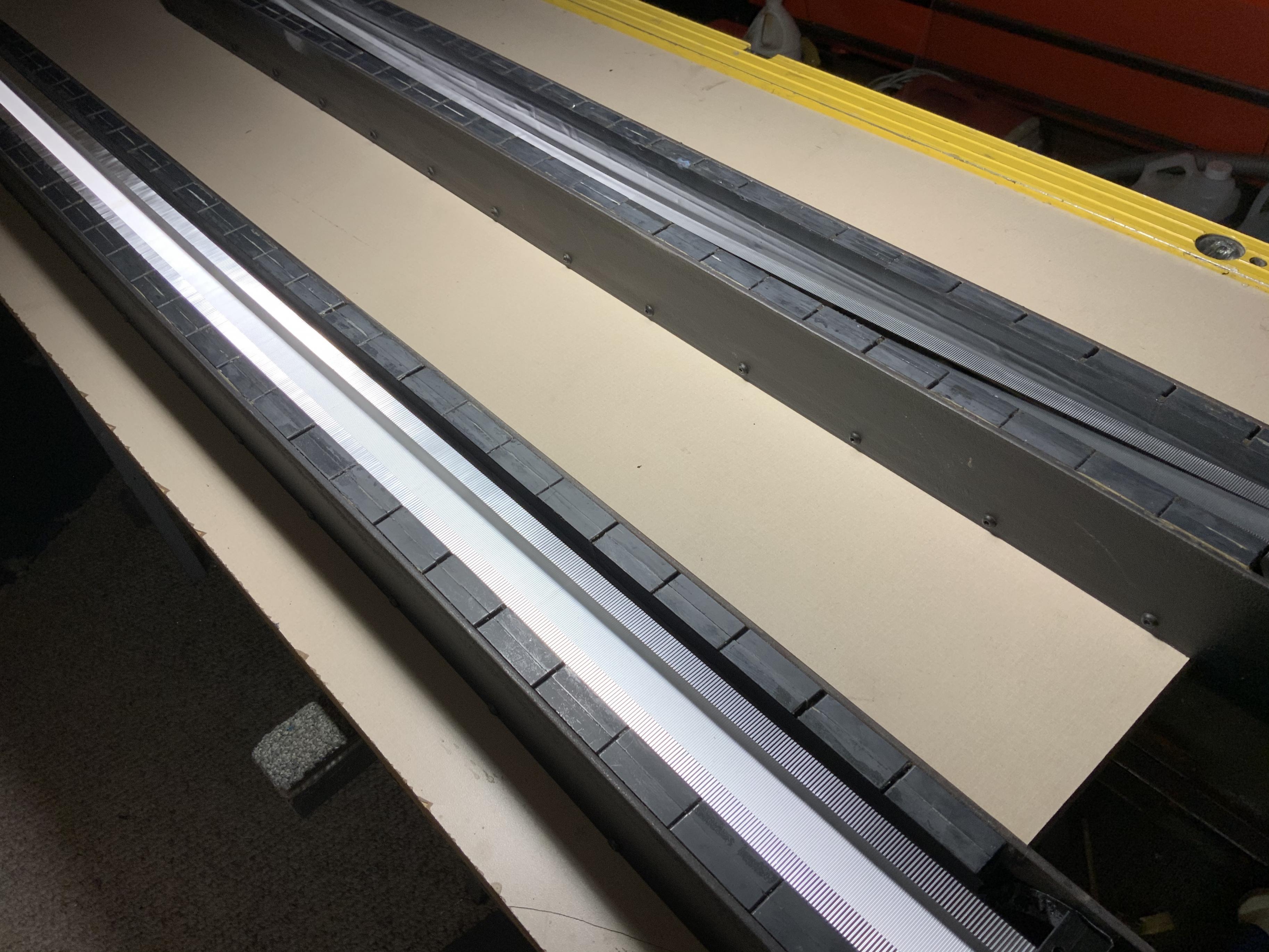

Was able to retension and realign all tweeters and mids to factory specs. They were all slightly stretched although when vertical appeared ok.
Made an adjustable arm with a roller and fishing line taped to each ribbon and a specific gram weight for both types

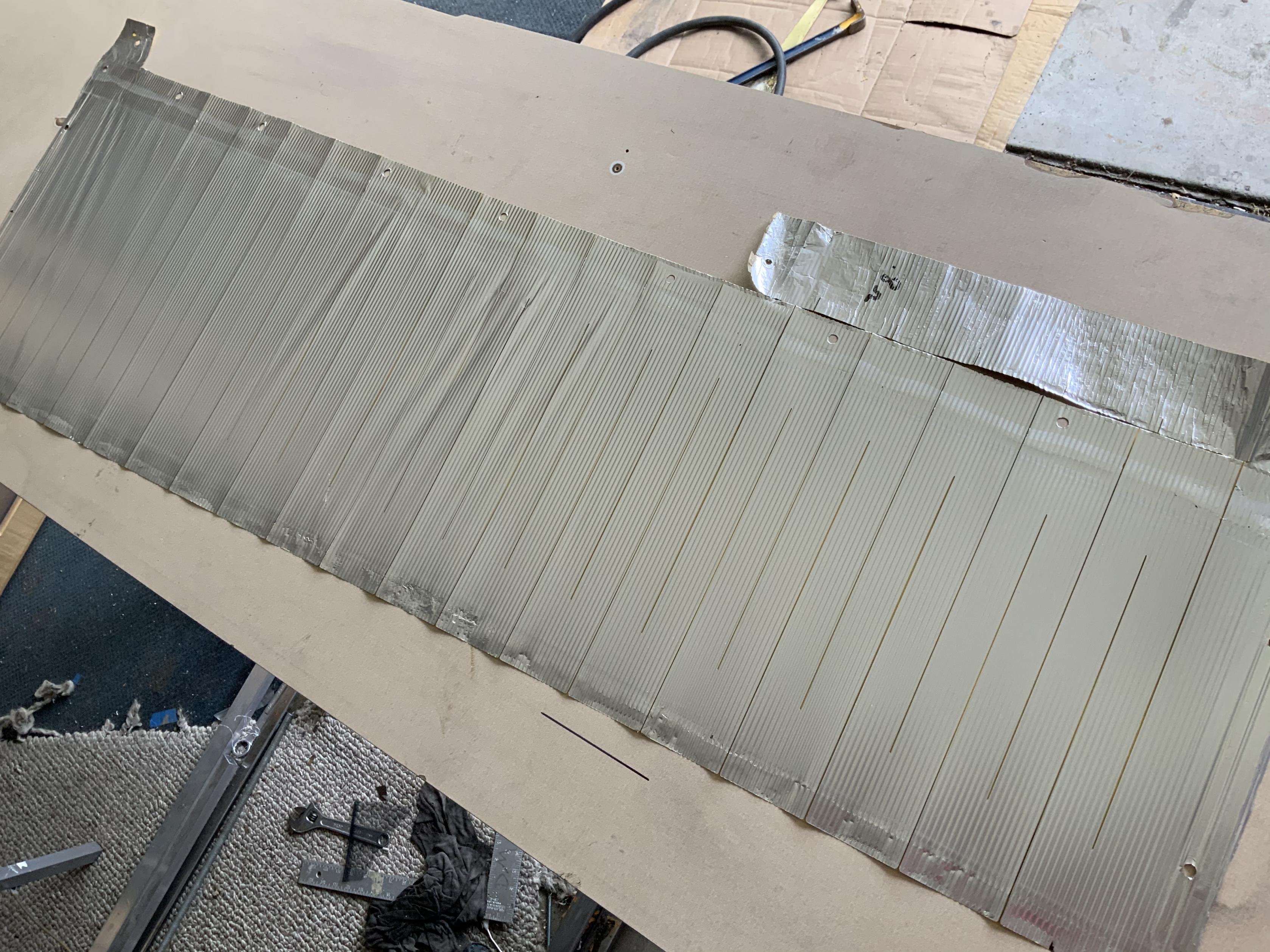

And the bass panels were installed I believe in 2007 thereabouts at True Sound works with new bass panels.
It might be possible to save these for now as they had some shipping ripples and a slight break that might not affect performance but in the end will probably make new panels for these also
Thinking about a CNC waterjet cutting template this time around...
One thing I noticed is an asymmetrical crease to these bass panels , the outward bow is wider than the downward crease suggesting maybe the outside roller might be pressing on a soft rubber surface roller or maybe not even a roller at all, not sure.

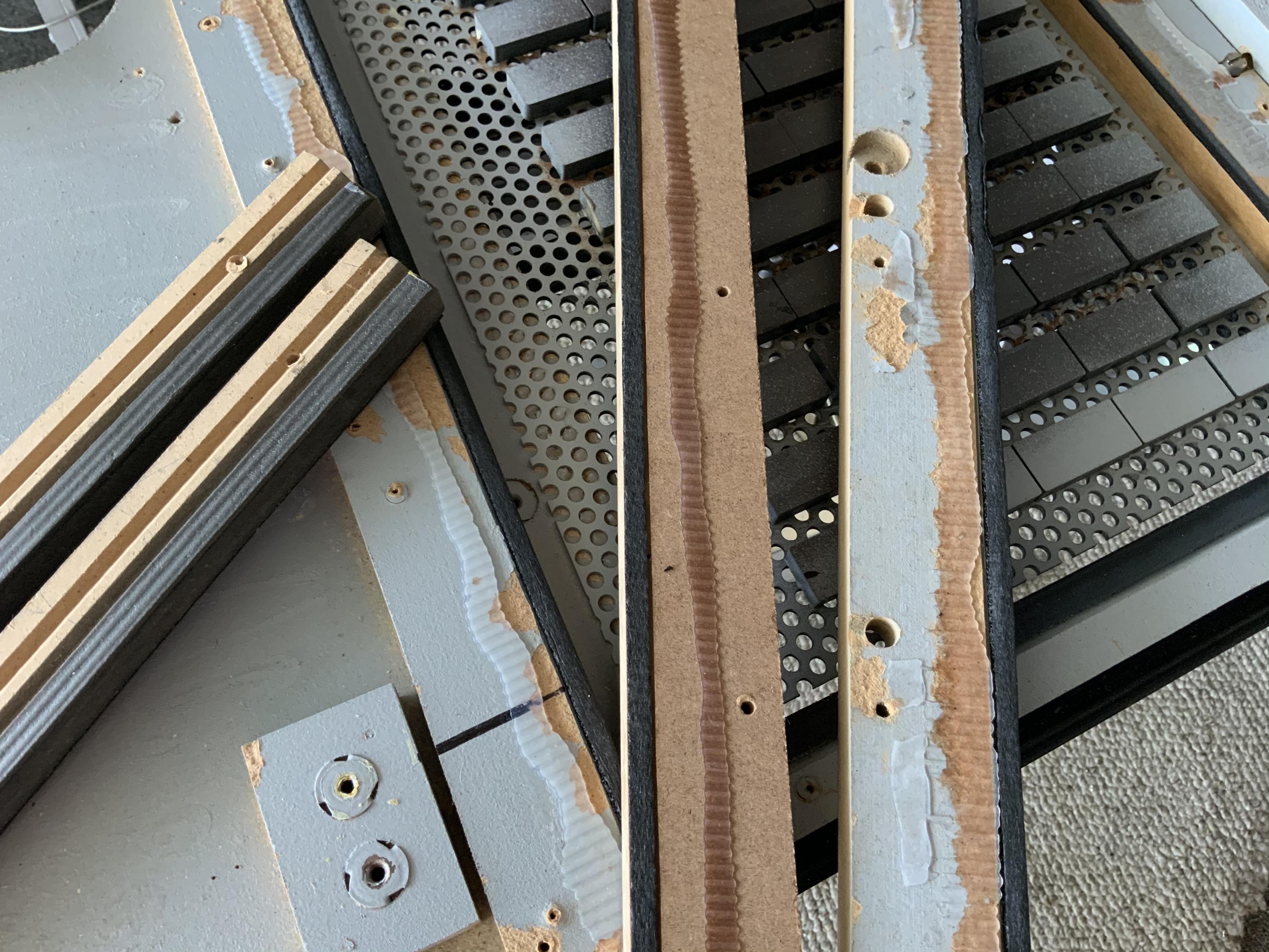

Is that the pair in Fountain Valley advertised as a project? They were moved, damaged, sent to True Sound Works but rejected due to rotted frames.
Yes but the damaged external cover was remade and all the internals , MDF chassis magnet structure , etc was undamaged with new bass panels installed that got lightly rippled because of a move.
A basket case to some is a gold mine to others.
That ad described them as below for $1200. If you paid close to that, I don't think the frames are good.
"Got several great years out of them, then they ended up in storage due to baby. Movers didn't handle them right and caused the woofer panels to get warps / dings. This caused a rattling sound.
Sent them to True Sound works for new woofer panels to be installed. Wouldn't do it w/out a full new frame being built as the diagnosis is that the original particle board was rotting away.
A fun project speaker that I'm willing to let go for cheap. You could have some DIY fun with them, or send them to true sound works for a full re-do."
No , again , there is no rotting of the 1” internal chassis mdf on either speaker.
Were these built with the fine grain MDF we see today? No , this is the courser grain structure
Fiber board with a rough edge structure. No swelling or cracks anywhere
Just a cheaper grade but no issues
The Diva chassis frame (3/4”) has the dense fine grain MDF we see today and would have been the better choice on the Scintilla ,yes

John , you can retension all the ribbons with a simple roller setup and a gram scale if they are in decent shape.
Each tweeter to not exceed 40 grams and the 1.950” mid no more than 60 grams
Factory used 5mm sag
You can see before and after results
Never expose these ribbons to a windy environment such as near an outside door or window drafts
