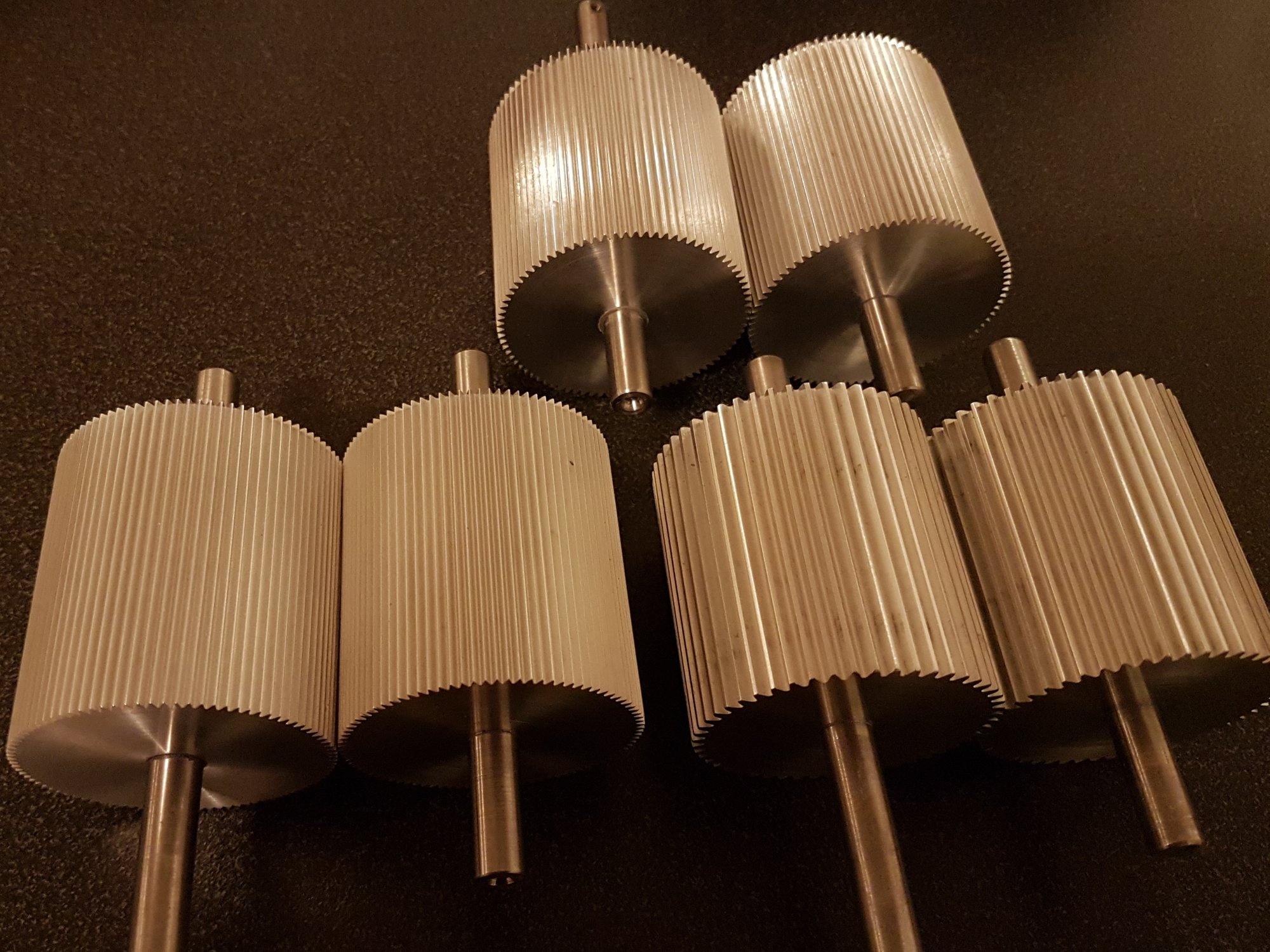

How do you reuse?I will corrugate the bass panels but the mid/twt ribbons get cleaned and reused
Usually when you replace you damage the very delicate tails removing them from the double sided tape.
Also are you re corrugating the MRT?
Acetone and it wasn’t fun either. There was a slight crinkle on the back side twt and I
will either stretch it slightly or first try and fix the area the best I can. At the worst just buy new
If I can find some .0005” foil that is tempered then it would make sense to redo them all but not sure where
I can find a fine pitch corrugator
here’s a picture I found years ago that would be ideal. This might have been a member on diyaudio
but it’s been a long time since then -

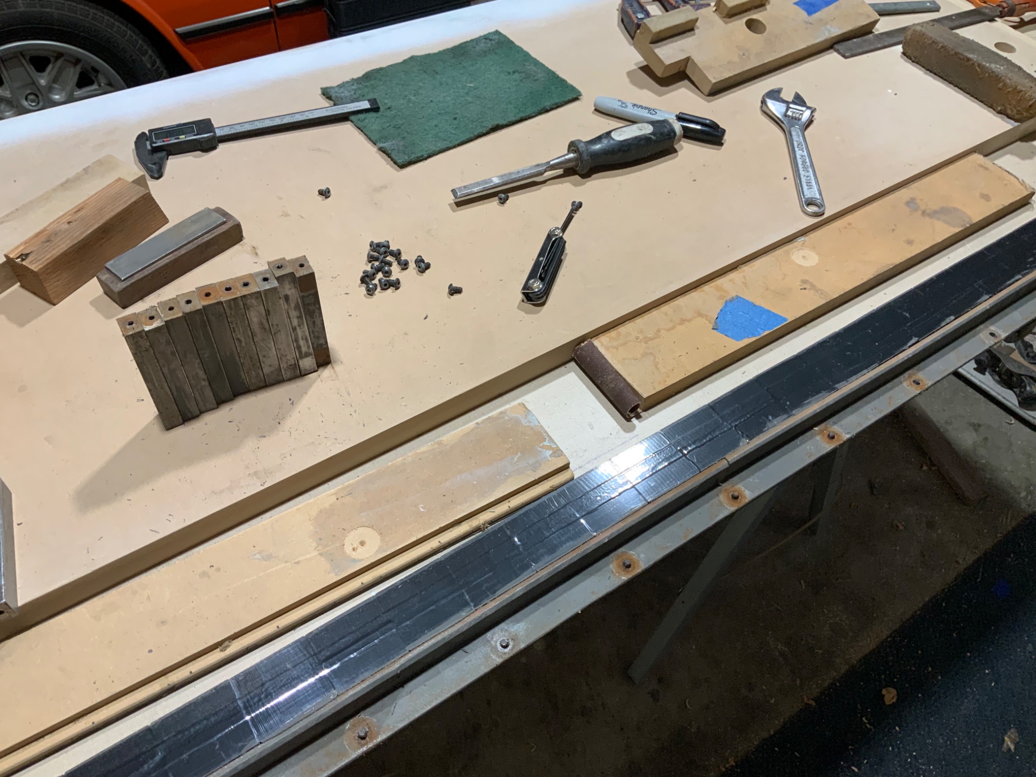

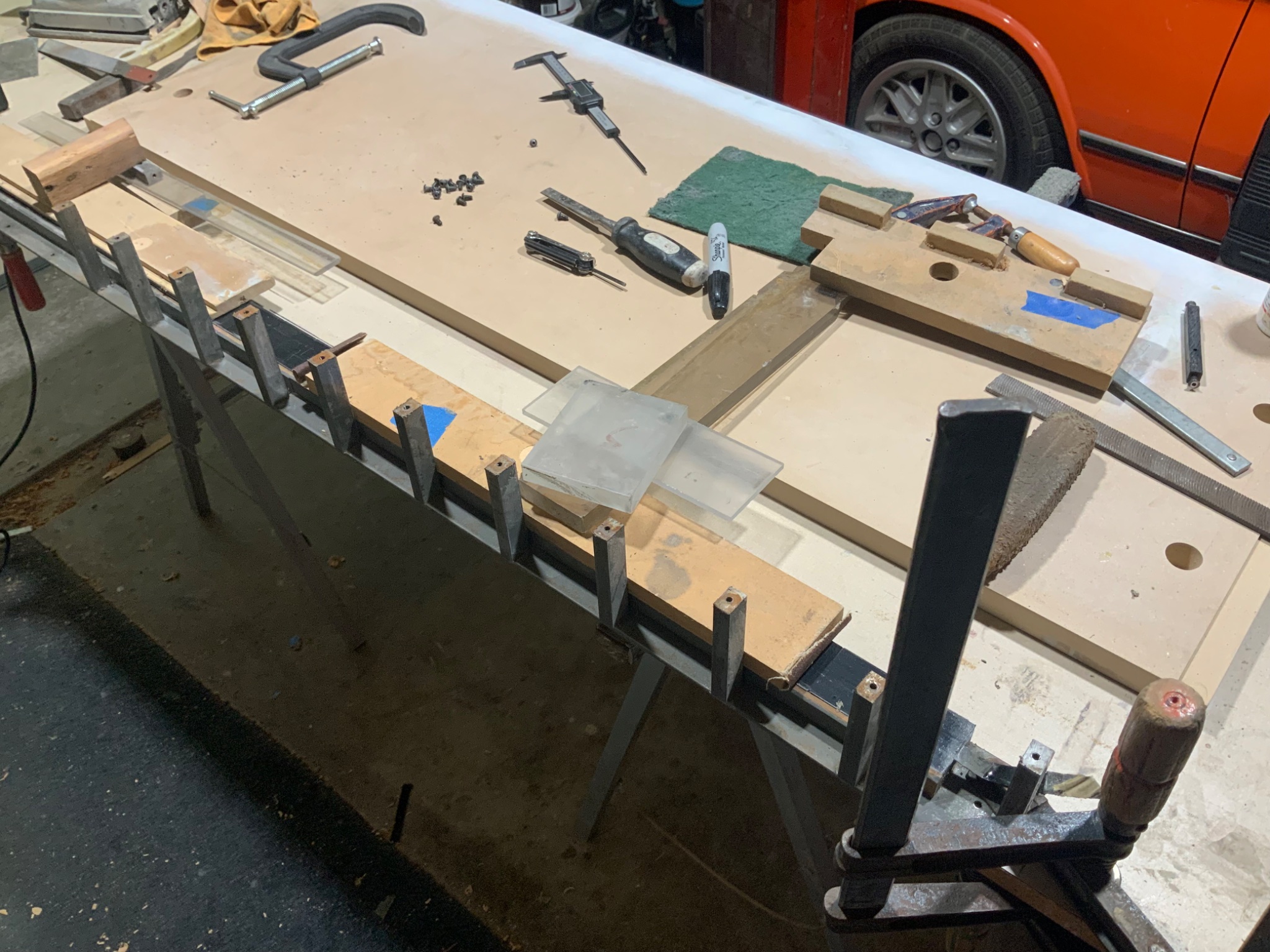

To get to the minus return strips properly so I can replace with copper foil and get rid of the rust at the same time,
decided to split the magnet sections.
They are in attraction and best way was to support the magnet width first and remove the allen screws on one side and pull straight up
like a hinge on top of those rectangular support posts
Putting it back will be another challenge..

Why bother replacing the AL foil returns?
The difference is insignificant and it allows AL-AL connections.
I plan on soldering the connections instead of the bolt & stainless steel washer interface
plus I have 3X wider copper foil than the stock .0035” alum. strip so why not while I,m
there getting rid of all that rust ?
I think Clarisys does the same thing from pictures of certain models so I’ll follow their
example
example
