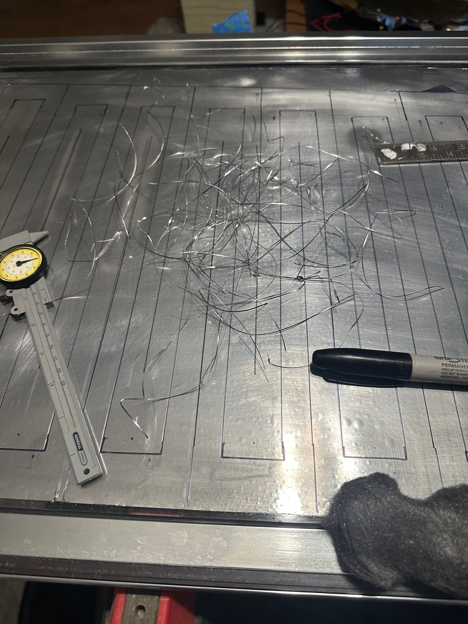

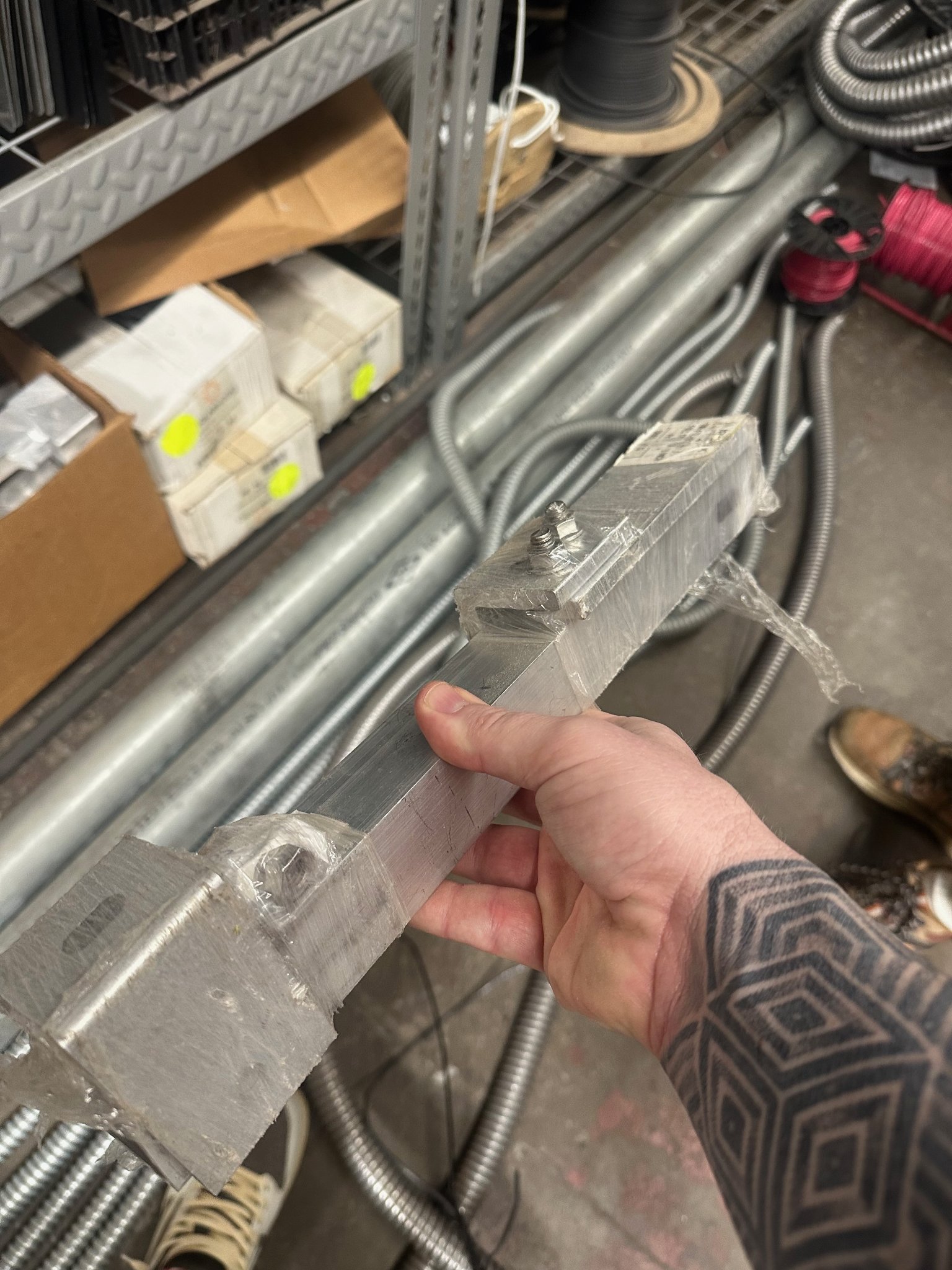

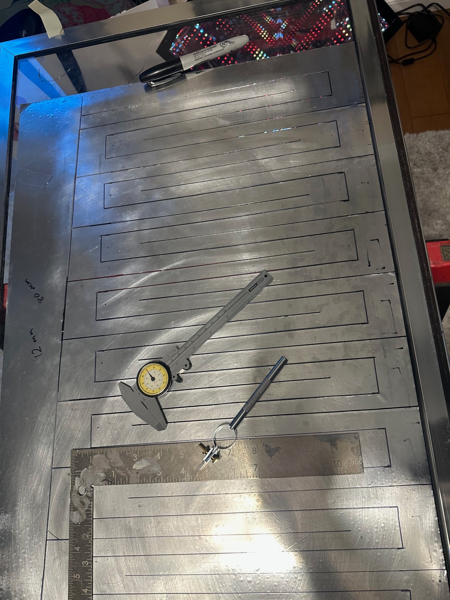

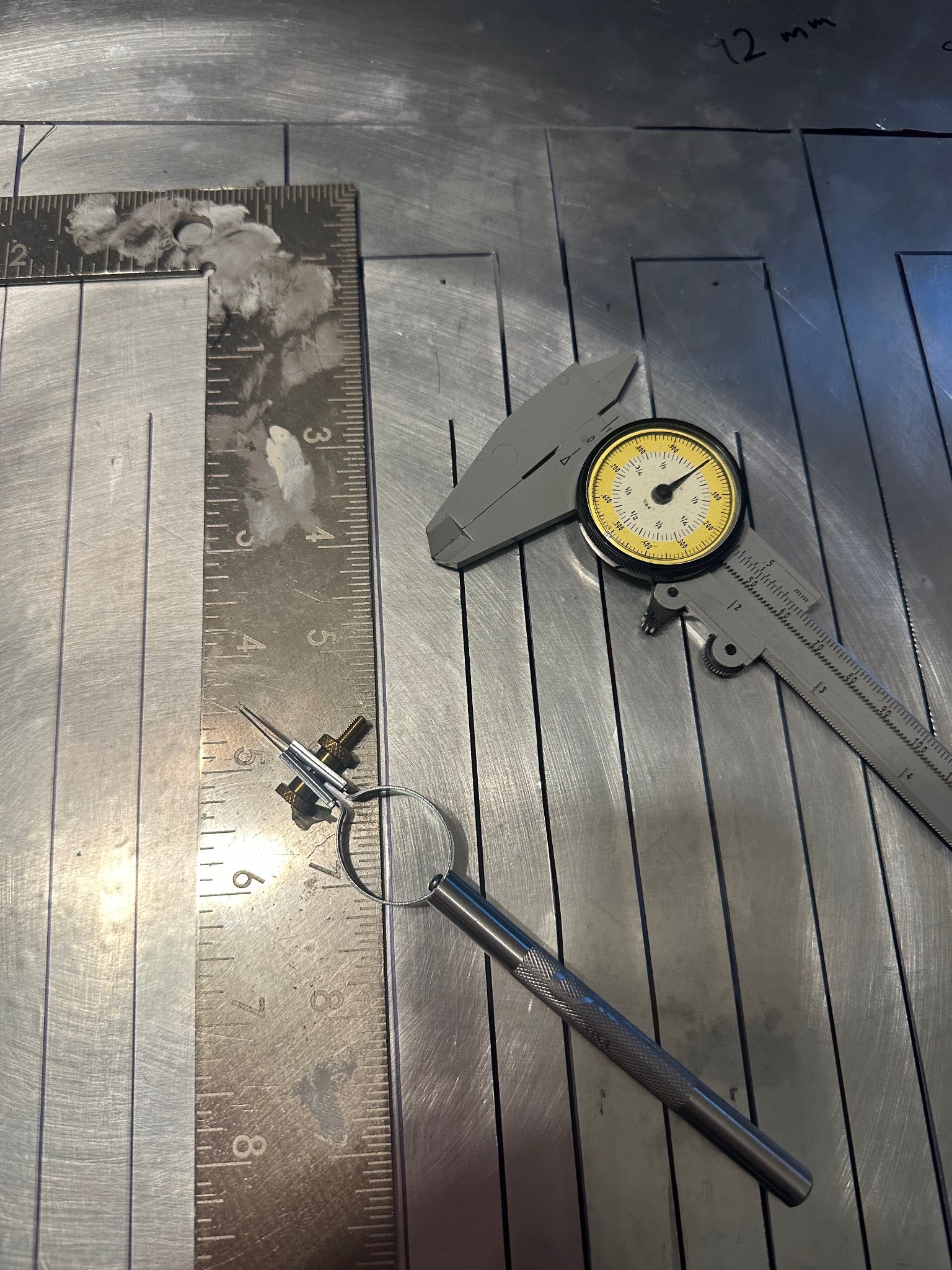

My first attempt and making a foil panel. @AVWERK thanks for the inspiration... found this neat double-blade that makes cutting the traces much more precise and easy. Long way to go. This is the DVC version from the earlier Scintilla. The last photo is a possible foot / leg when I rebuild the frames / covers.

Heej there narkotic 🙂 i think we had a conversation about this ! well corrugation is usually the hard part 🙁 getting a nice one. people tried printing one , but it usually does not work that well and even when they work a long/wide one is often a problem 🙁.
anyhow i wondered what do you mean by DVC? dual voice coil ? anyhow the dual blade works fine 🙂 i used back in the day sometimes just a thing 1 mm magnet and two blades, but this looks nicer!
About my corugators before you ask, the ones i use are used for rolling out dough, but the companny do not sell these anymore, and the person that pointed me to them and gave me 2 (and i bought 2) and made even couplers on his lathe (to make them 46cm wide), passed away a few years ago, "Craig Hill" me he rest in peace !

Ya man thank you for the chats and confidence! Glad we made a connection and appreciate the confidence boost - being the master of DIY planar!
I will be copying AVWERK's "corrugator" using similar parts. Lucky for me we are somewhat local to each other so when it comes time to corrugate, he will be assisting me. I do understand that is a critical process to get right and was being coy but honestly one has to have that sort of attitude to jump into such a project. Every single step is daunting and the deeper one gets the more fragile things get. So many moving parts.
1. Finding the materials
2. Figuring out a way to get the foil to lay flat on a surface to work with (WD-40 for the win)
3. Figuring out the "trace" patterns. Getting the lines / traces right. Yes, this one will be a replica of the original "1+4 Ohm" scintilla woofer foil, so DVC (2 trace patterns) so can wire it in series or parallel. Much harder to cut than the 1 Ohm version (just horizontal lines vs a combo of veritical / horizontal) and twice the traces.
4. Figuring out a "style" to cut the traces. Everyone has their own style here, different blade types, jigs, etc. It's an art form. Etching / CNC would be awesome but not really in in the cards for this DIY effort
5. Figuring out a way to carefully "lay" the kapton down without any creases / bubbles. Will use a frame and copy AVWERK's idea here (smart!)
6. Corrugating!
7. Then getting it into the frame... scary. Building an entirely new one from scratch here, too. Cost for 1" 4x8 sheet of MDF = $70.
8. TIG welding an aluminum frame / lattice / foot structure
9. Tuning
10. Going fully active 6 channels with DSP (why not)
etc.
This is more of a project to keep myself busy. If it actually sounds good I'd be surprised. lol. It does really build respect for the original Apogee designs.
Reactions: AVWERK
I have some friends helping, i.e. someone with a CNC router to cut the frames for me, going to do it in 1 piece vs. two pieces like OEM. New clamps probably out of ply instead of MDF. Welcome suggestions on foam to use for the membranes. so many choices... kinda dig the Clarisys "piano felt" style stuff if someone has a suggestion online? Since I'm making new clamps I can cut the rabbit as much as I need to.
The knife is shown in a few pictures I posted earlier.
I think we have good news. Each voice coil measures around 1 Ohm so in series I get 2 Ohms. For some reason I recall people saying apogee wired it in parallel but not sure why, that would drop it to .5 ohms right? I am getting 20 ohms between traces so there is something shorting somewhere but that doesn't sound too critical... thoughts? Now to lay down the kapton!
